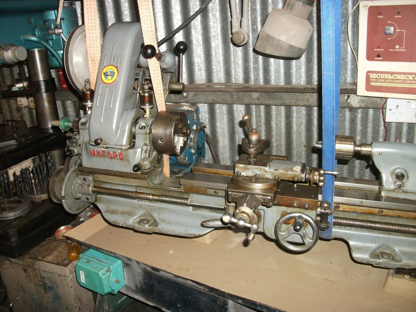

Can't find a thread, was it about something else to start with?Have a look for Mr fizzy's recent thread on the issue or ask him to point it out to you.
Long and short of it is that the four way indexing toolpost is tightly integrated into the topslide, in such a way that the stud cannot be easily removed and the casting reconfigured for a QC post. If you really want one, it might be better to buy a slab of cast iron and make a whole new one.
