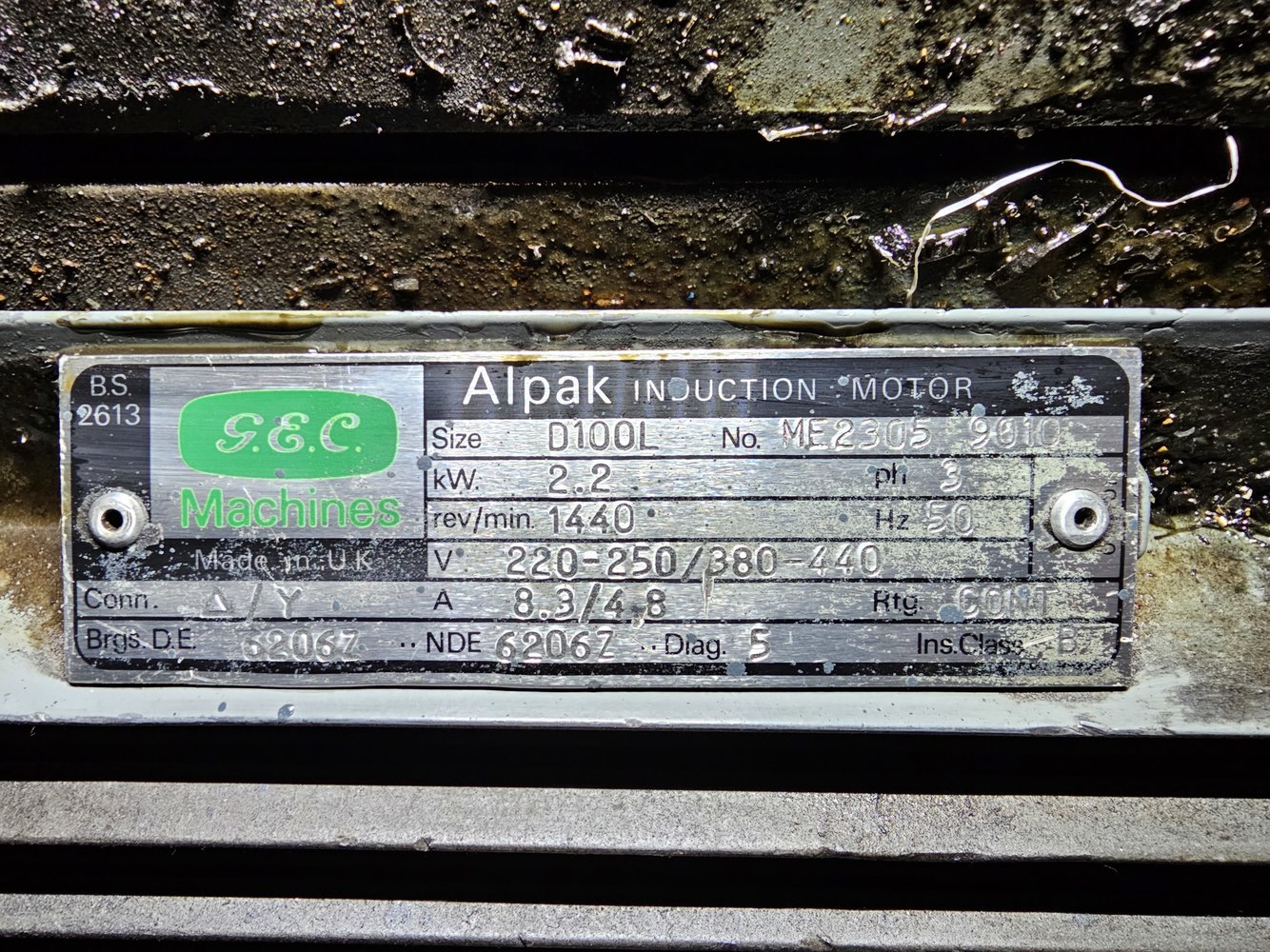

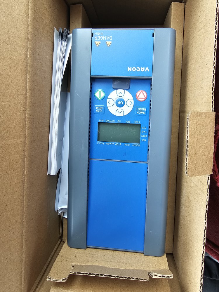

That's the plate there Dave, please go slow, Im not that clued in to machine electrics and never heard of a vfd until amonth ago when I started researching lathes Ta, the VFD plate helps - yes, definitely 400v input/output, next question: can you see / get a pic of the motor's plate? that'll indicate whether you can run it in delta on 240v, if so you could substitute a reasonably-priced 240 to 240 VFD and make you life simple - likely you can swap the incoming control wires like-for-like and have a working lathe! After that comes programming the 240-240, you can probably do that by powering the Siemens (it'll show undervolts, but the user interface generally works, at least on ABBs it does) and getting the configuration settings up on its display, transferring most to the new one with adjustments to the motor voltage and currents as per the motor plate for full-load Amps, base voltage, power factor etc.
If the fitted motor's 2HP or less, you could try the hack to run the Siemens inverter from 240, it would really help to see the motor plate - if it's dual voltage it's likely one of those is 240 3-phase (and t'other's 415), the alternative is 415/690 and that's unusual in anything below about 7HP! Are you SURE the motor's 3HP?
Dave H. (the other one)
Thanks Dave,That's cracking! that'll run off 240v with an inexpensive 1p 240 - 3p 240 VFD (they go as low as about £75-80 but the cheapest aren't the most reliable. Secondhands are are available). Note the A 8.3/4.8 marked on the motor plate - for 240 and 415 respectively these are the rated full load current (to get your 3HP), a 240v VFD needs to be able to deliver *at least* that 8.3 Amps, it never hurts to go a bit OTT but never under!
Inside the connection box on the motor there are six terminals - for 415 three along one side will be linked, this is star connection (think Mercedes badge, the join in the middle is where the three ends of coils are linked), the other three terminals will have 3 phases connected - the points of the star. To go to delta, all you have to do is take out the links and reposition them to straight across - like a three-stripe = sign - this links the ends of the three windings into a triangle or Delta - this puts 240v across each winding, from your shiny new (but not too expensive, Ni!) VFD.
On 415 mains because of the phase difference you'd also have 240 on each winding but 415 betwen star points (yeah, that's confusing, but you can represent it by drawing the Mercedes star with each spoke 240 whatevers long, then measuring point to point it'll be... 415 whatevers if you draw it neatly!).
Next up is the VFD "programming" - not as frightening as it sounds, it's mainly telling it which terminals have buttons, switches etc. connected and what they mean, plus entering the details off the motor plate. You can probably power the 415 VFD from 240 to read off the settings for start/stop buttons, or just trace the wires back and see what's normally closed (your meter sees a short unless you push button) or normally open (infinite resistance until you prod). There may be VFD settings you can either leave at the default or read from the old VFD and enter in the new one, or you can ask on here, loads of us have done this sort of thing (so not quite "shaved monkey" but not rocket surgery either).

Can anyone recommend a decent vfd?

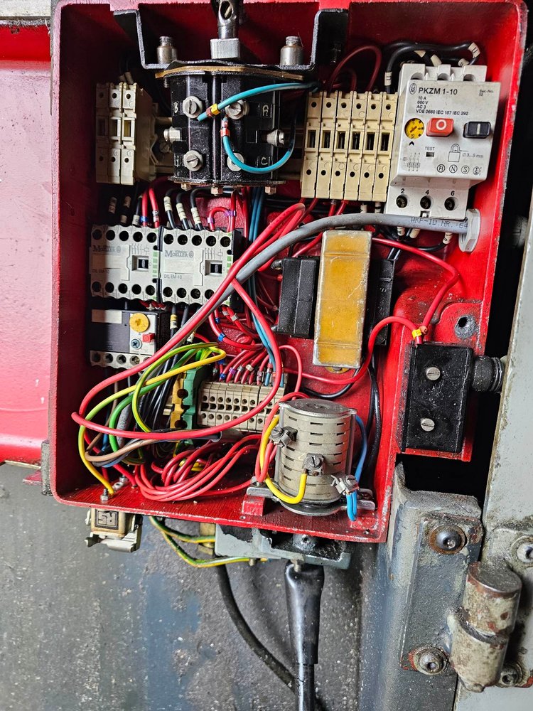

Overload and motor contactors will be replaced by the 1 to 3ph vfd.
Have a look at the 24v supply to see if it is a multi tapped input so you can swap it easily to 240v in. Emergency stop system I would also run low voltage.
