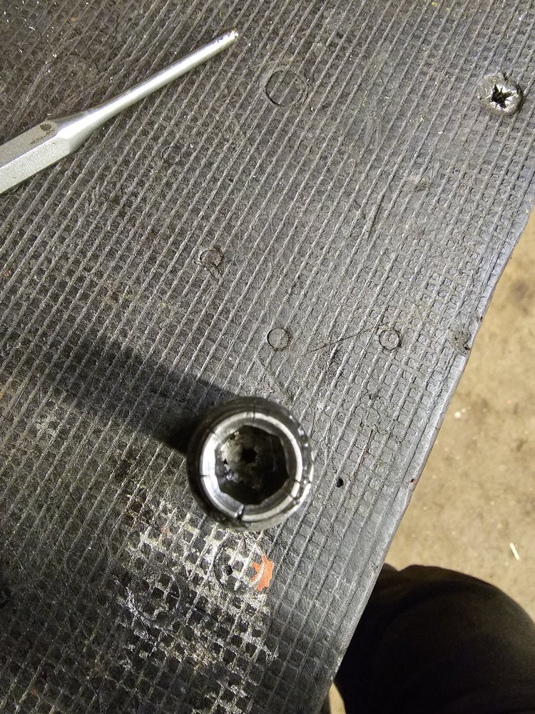

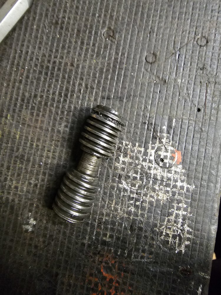

Cheers for that Dcal, I didn't think you would get a grub screw with that pitch, I think its 4mm pitch but I could be wrong.You've got a lathe now so just make some.
It was the first job I did when I got my Boxford.
Same problem and I was able to get some grub screws the correct size and used a parting blade to cut the slots.
Still works years later.

...didn't think you would get a grub screw with that pitch...
That's what I was thinking, but wanted to see my options where, buying new is not an option at the price they are!His chuck may have been different to your own. The threads on yours are not vee-shaped, more square.
If it is only the hex socket on yours that is cracked, perhaps it would be possible carefully to braze or silver solder it up and then tidy up with a dremel. A piece of graphite filed to fit the hex socket would contain the filler material somewhat.

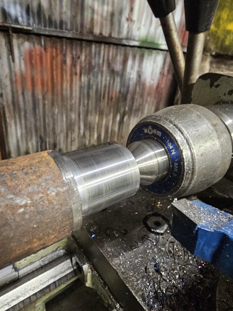

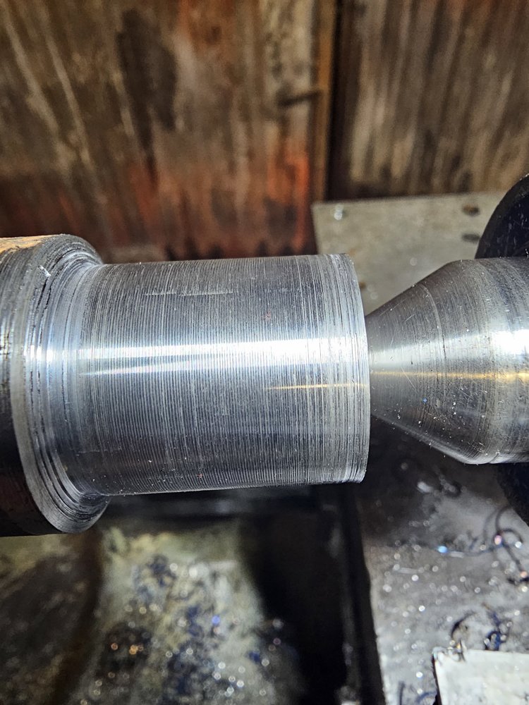

Did you sharpen them to known clearance angles? My experience of off the shelf brazed carbide is that it needs grinding. There may or may not be clearance ground in.I bought a set of blue things from RDG tools.
I didn't grind anything lolDid you sharpen them to known clearance angles? My experience of off the shelf brazed carbide is that it needs grinding. There may or may not be clearance ground in.
For general work, pick an insert style and try those. I use ccmt09t304 or the polished non ferrous inserts ccgt... There's a world of different shapes, sizes, pos/neg rakes to choose from. Depends what youre going to be doing with it (hobby, production).
Grind themI didn't grind anything lol
Yea it's a tad confusing all these tools and what they do, mainly just hobby work, I weld to so I want to turn bushings, bosses, pins and that kind of stuff.

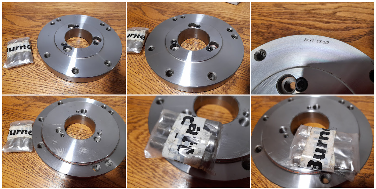

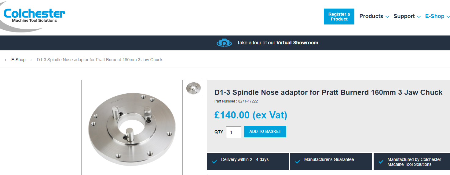

If you find a chuck (I just sold several...) I've got this adapter that could be of interest. I think you mentioned your lathe is D1-3 mount.Hi,

Pm me a price with postageIf you find a chuck (I just sold several...) I've got this adapter that could be of interest. I think you mentioned your lathe is D1-3 mount.
