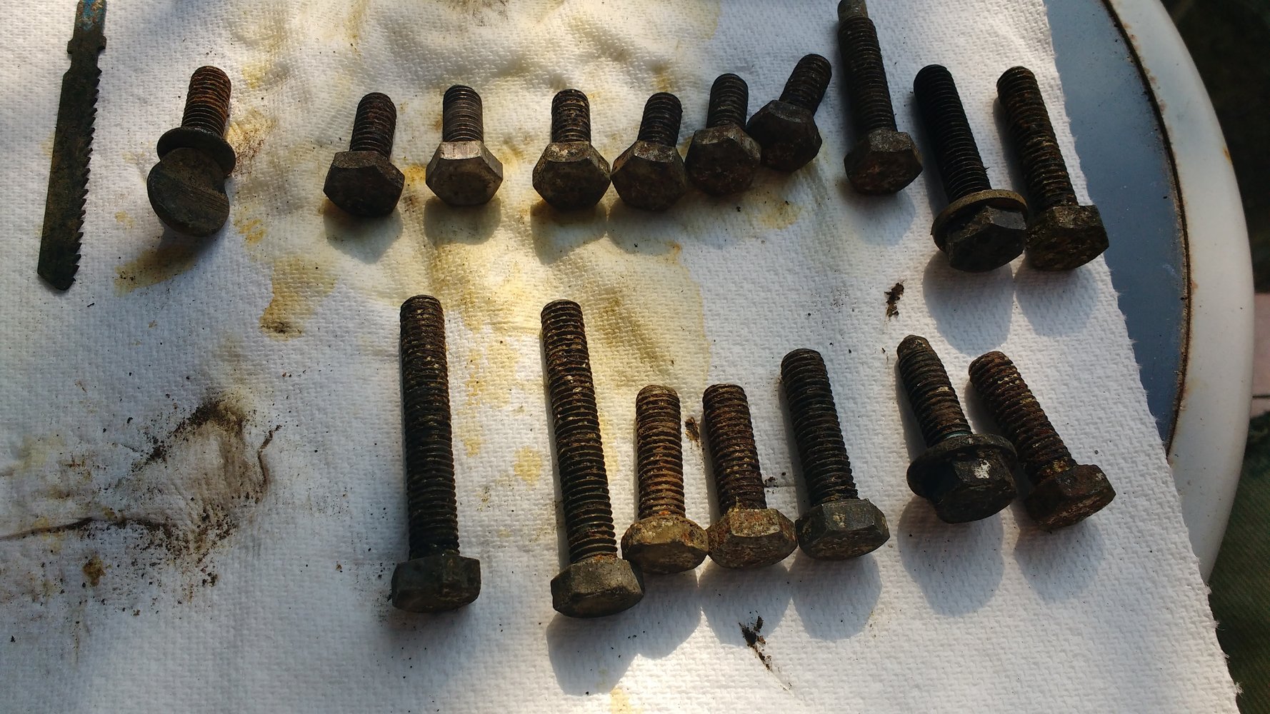

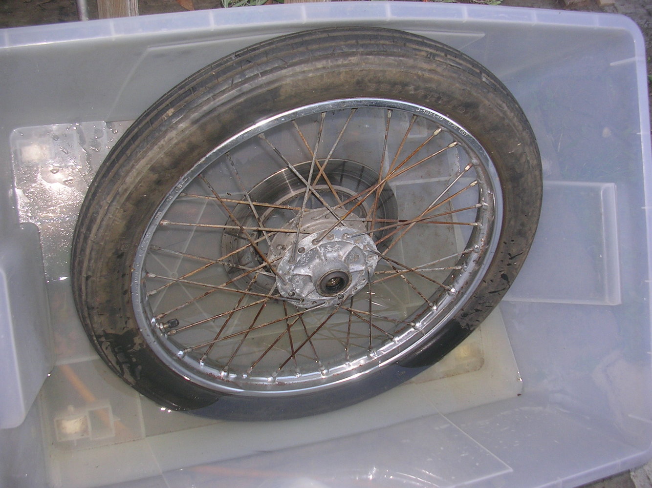

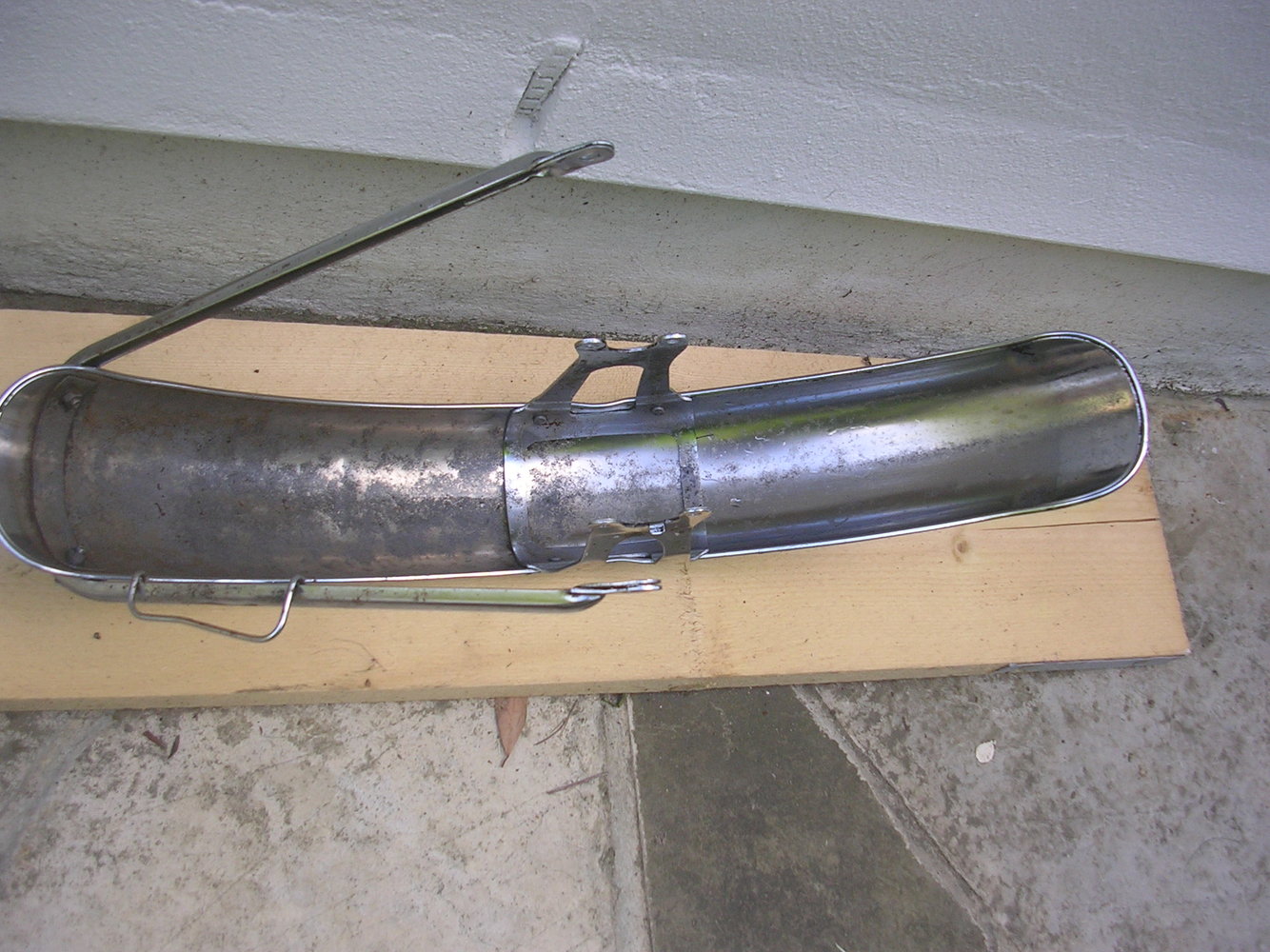

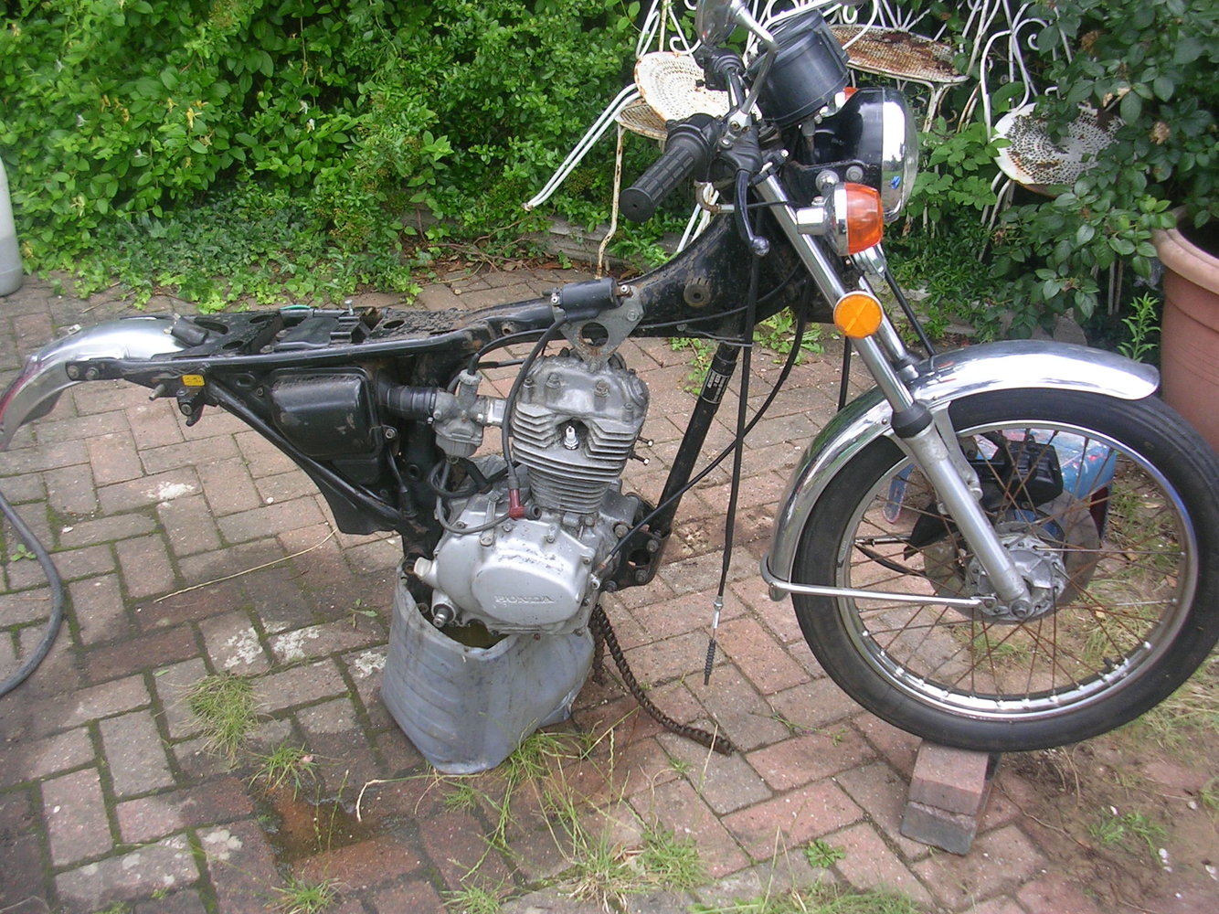

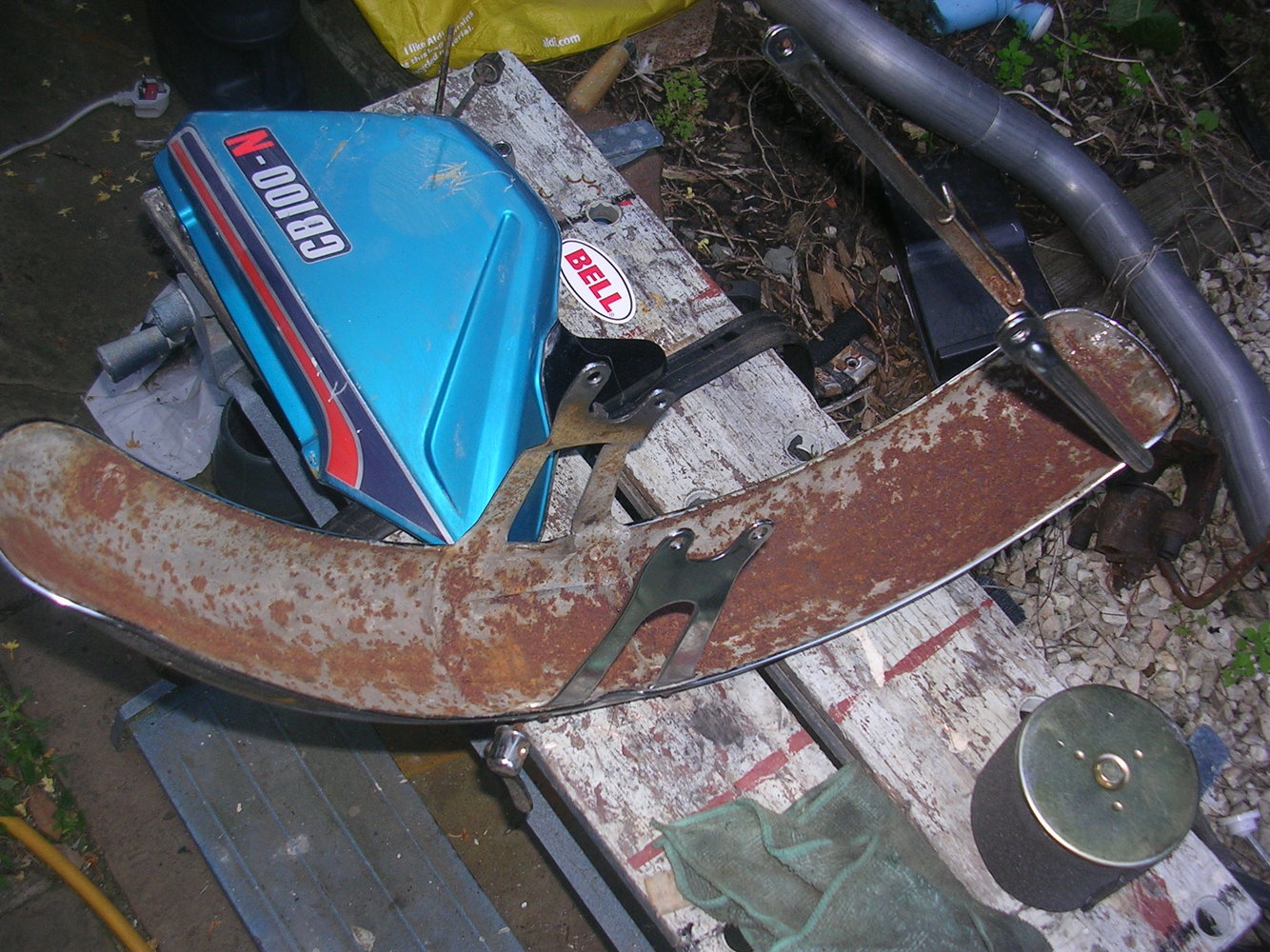

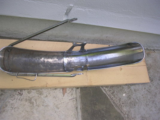

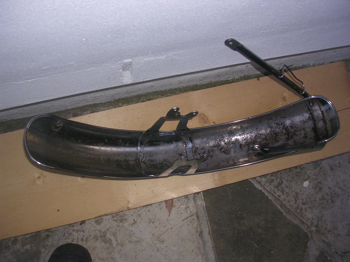

I've spent the last 24 hours doing acid... on some of my my old Honda's chrome.
I filled a bucket with hot water and added about 1 Kg, mixed it then poured into a handy big plastic bin.
I did the front wheel, 60 degrees at a time:

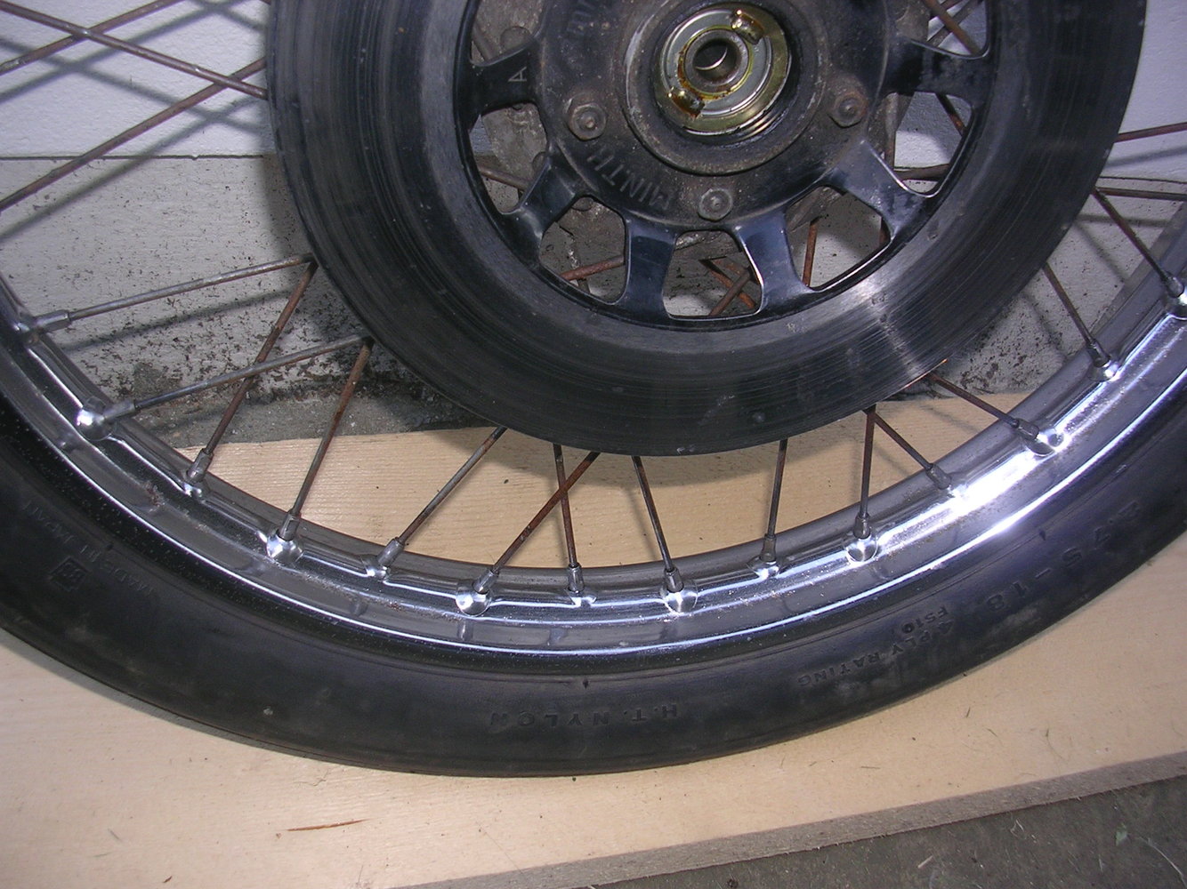

And today, the front mudguard:
View attachment 300978 View attachment 300979

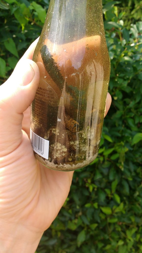

and you can put citric acid on pancakes if you run out of lemon jiuceShame you didnt have a warm vinegar one running side by side so we could compare the results! I like the vinegar idea because it seems less likely to cause me damage because i put it on my chips neat too!
I've used that before.Did you try the ball of tinfoil and vinegar trick ?

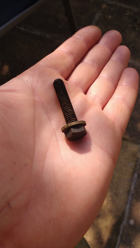

Yep, I didn't use the usual 1:4 / 1:19 powder to water ratio I usually use.I think you need to up the conc. there. They should be nice grey steel in an hour or so.
Good question; I believe that citric does get between particles of rust and help 'soften them up' even before much dissolution occurs.Will citric avoid me having to use a slitting disc? I will find out on Wednesday.
