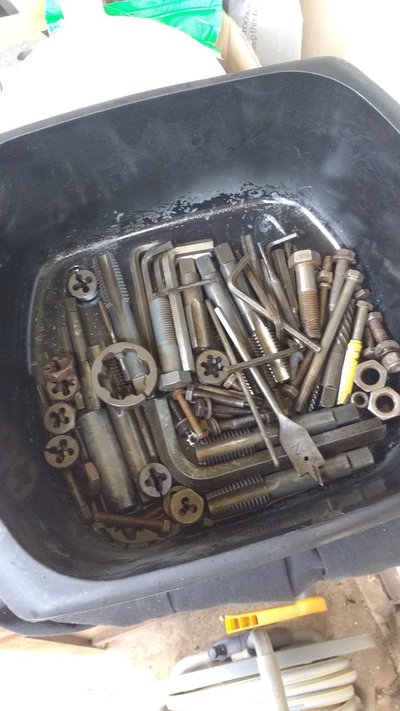

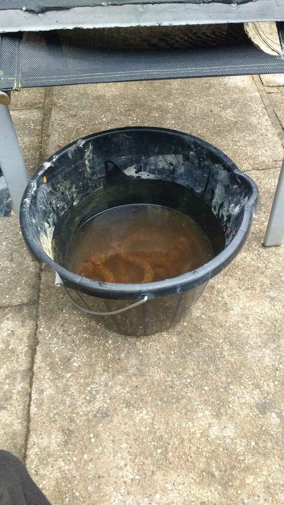

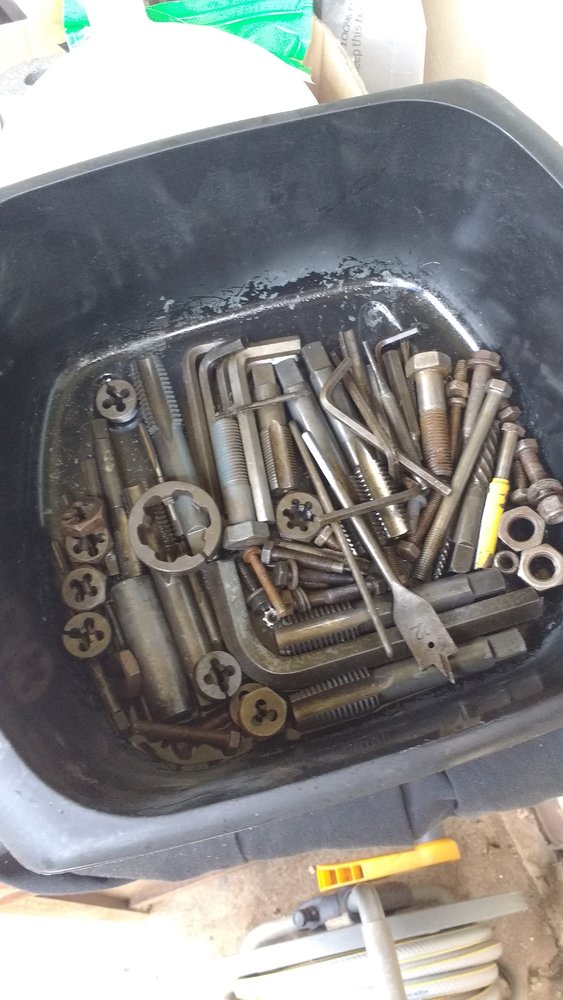

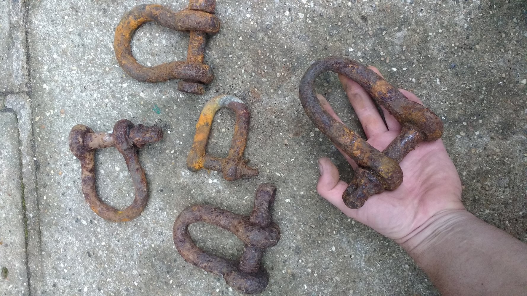

The whole business of de-rusting things has elements which are hard to fully control. Ideally, you'd start by thoroughly degreasing everything, so that the citric reacts uniformly, and everything would be fully immersed so there are no electrolytic effects at the liquid surface, and agitating/stirring the solution would be good for a variety of reasons. Adding chloride (in whatever form) will speed things up, but may well encourage rust to return. The whole thing also depends on temperature and the surface area (of metal) to volume (of solution) ratios.
I must get around to experimenting with central heating protector to see adding a drop will inhibit citric form attacking metal, but anyone else should feel free to try that idea![]()

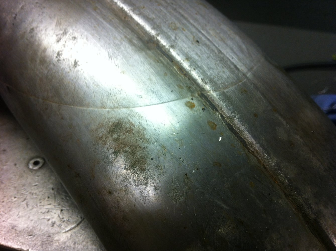

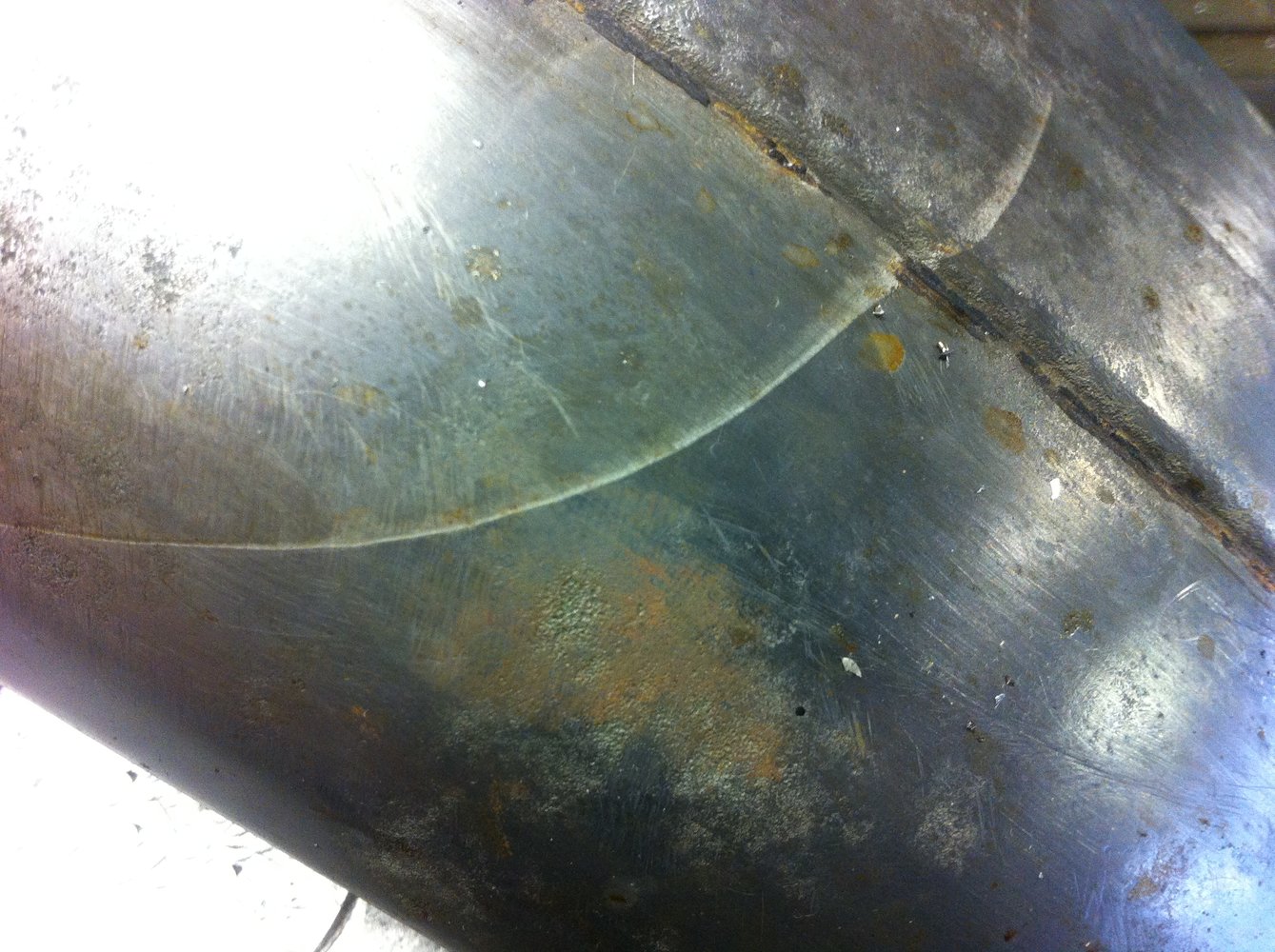

Just got my citric acid delivery, never used it before, going to de rust my Jag petrol tank interior after blasting to remove the worst of the lumpy bits,
