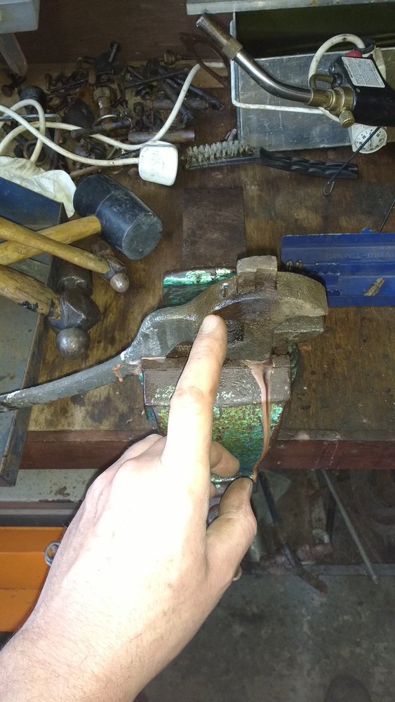

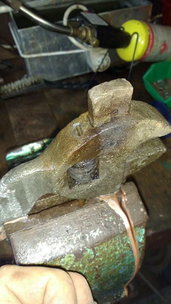

50% old oil.This one's a test! The neighbour's adjustable is putting up a fight. Been in a hot citric tank for a couple of days, taken out, wire brushed, rinsed and put back in.
I heated it with MAPP gas, dripped candle wax into all the grooves, 3 in 1, penetrating oil etc.
Now trying the impact driver. This should unscrew as normal i.e anti clockwise?
If no go, what's the next step?
50% old oil.
30% diesel.
20% paraffin.
Leave to soak for a few days.
Remove, warm and bash the area.
Repeat.
