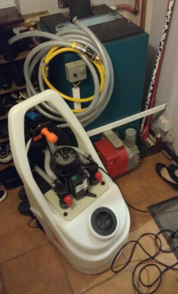

I recently flushed my central heating system with one of those bfo Scalebreaker pumps borrowed from work.
To give things a little boost in the cleaning department I mixed 1kg of citric acid in 3L of water and added that. It didn't half loosen up more stuff.

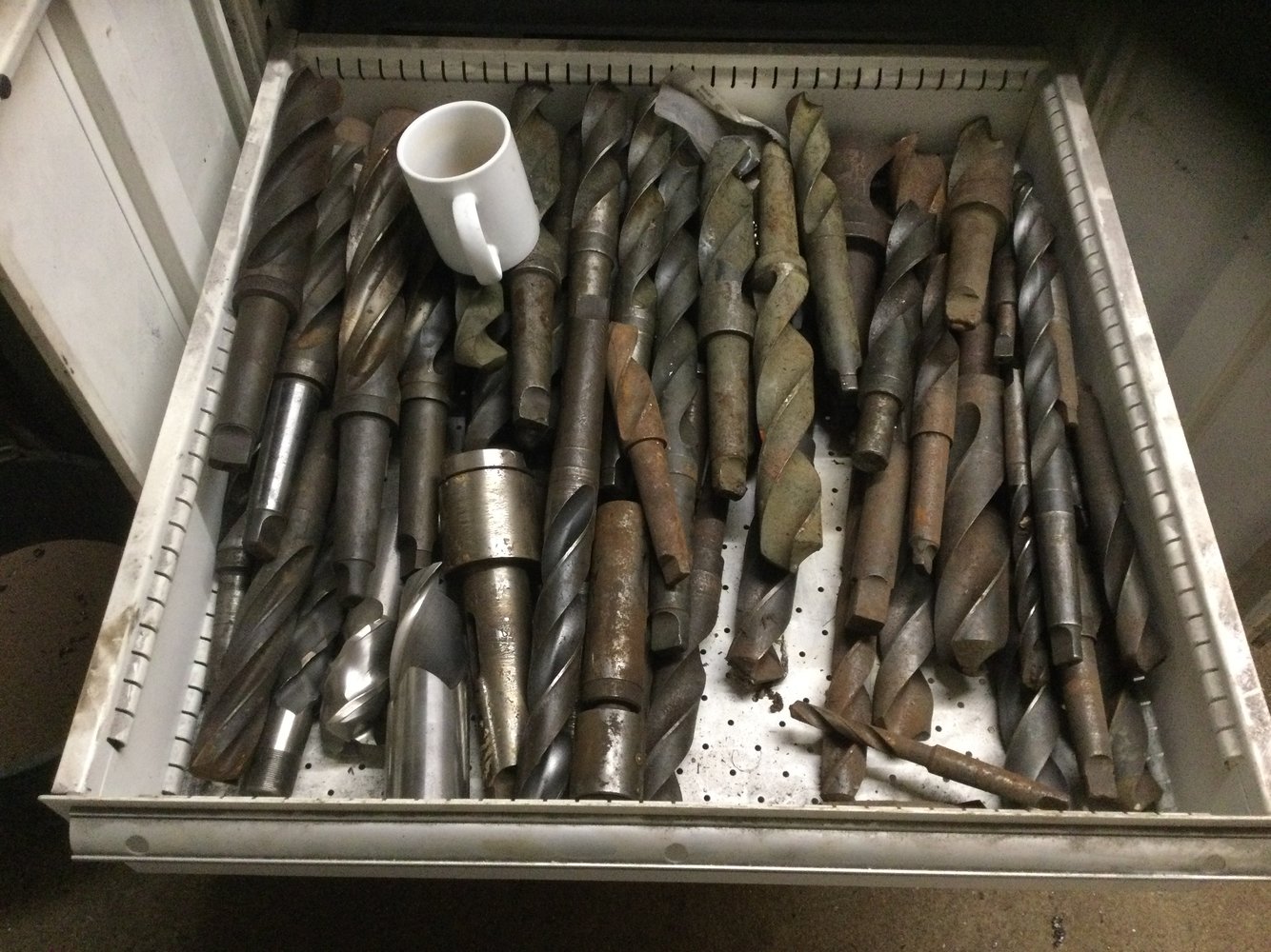

How did it go?OK chaps this lot will be going in first, can I chuck them all in at once or is it best to do a few at a time?

Has anybody used oxalic acid as opposed to citric? That’s what I’ve always used although I can’t remember what started it off. How do they compare?
Oxalic acid will remove all iron not just rust, so it will eat into your partHas anybody used oxalic acid as opposed to citric? That’s what I’ve always used although I can’t remember what started it off. How do they compare?
It's the compound which makes Rhubarb leaves, and green potatoes, poisonous.Not 100% sure, but think oxalic might be slightly toxic.
