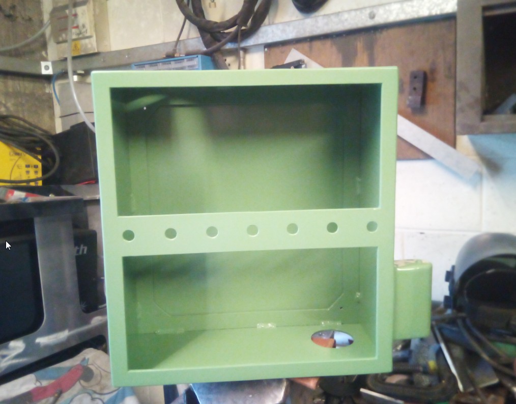

I got the cabinet finished last night and  took it  to the Coaters today to see if they could do it in RAL 6011,  the guy pointed to a couple of parts hanging on a rack and said, what like that
 There were a few parts for some sort of machine, possibly a lathe that he had just done the previous day.
I should get it back Monday or Tuesday so hopefully all will go well with it and it will be a bit more respectable than my painting
