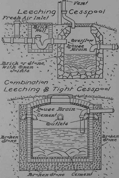

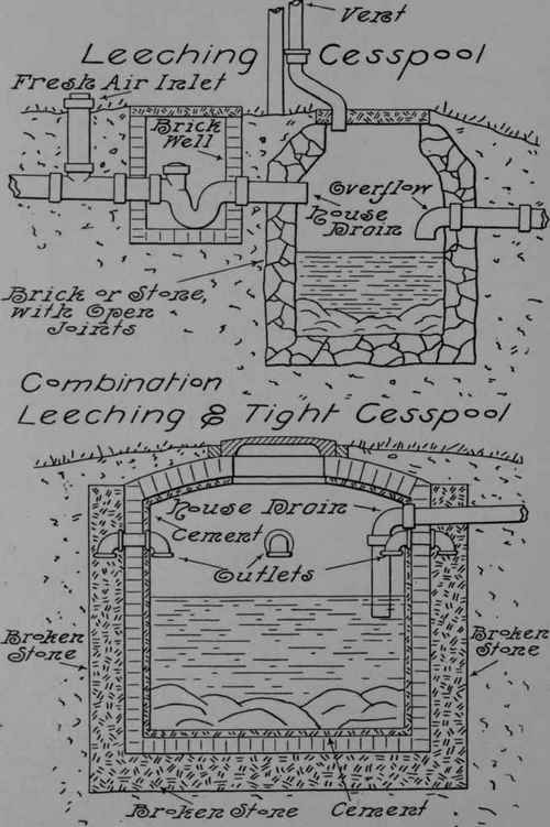

this is what you are dealing with
if your dealing with the top cap dont drill downwards on hammer use a grinder
you can drill sideways at an angle but you do not drill downwards you will crack it and if enough cracks it will fail and colapse
if you intend to upgrade where it stands and you can do then you can use a grinder to cut into the sides of it though is a mucky job a drill will crack and spread the bits all over the place in lumps this is the thing you dont want as you will then have to reline it
a grinder only spreads dust not chunks
so whilst your doing the cap fit a mushroom vent on it at the same time as renewing the cap
for other info mentioned
as goes for the cap one can be made easily with other info for building out of bricks
and yes concrete can be used as well
