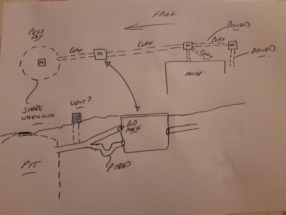

Well my cess pool/septic tank, pit 'o **** filled up quicker this time. Plenty of ladies time of the month products down there despite me telling the female members of the household and visitors not to!
So it's pumping time again. Rang the same nice folk I used last time to find that the guy who last came in 2019 succumbed to cancer just before Christmas. Seems his treatment was delayed during lockdown and it spread!
Anyway they (his wife),are coming back to me on Monday with a date.
He was amazed back then, that in 20 years, up until then it had never been emptied.
There's a series of man holes down the garden connected by clay drains. Basically this:
I hacked a path where the drain line is next to those rubble bags.
The rusty manhole cover is an inspection pit. That has a couple of holes in that must allow heavy rain in:
This is the cover over the pit. Lift that and you're straight into the brown stuff. Built in the 50's, the pit is about 8' diameter and brick built. I'd estimated about 4250L by volume. The top is bricks gradually built into a dome and rendered. A few holes in that too. The ladder is a safety precaution!
Hacking through the brambles again got me thinking once again about a treatment plant so I got the long tape out and did a rough sketch.
Any thoughts welcome as to position, make of treatment plant etc as I've not got a clue as to a starting point. The centre of the cess pool is 1500mm off the lhs boundary. The boundary came long after the cess pool was built when some of the land was sold off.
I know a few folk have the Vortex unit that they're happy with. Most say avoid ones that have mechanical workings submerged in the poo soup as maintenance is horrible.
Rough sketch:
