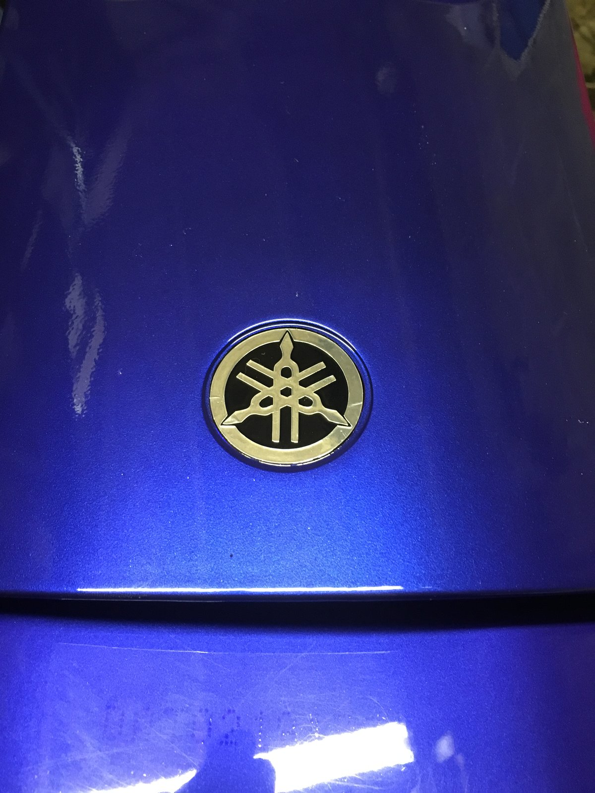

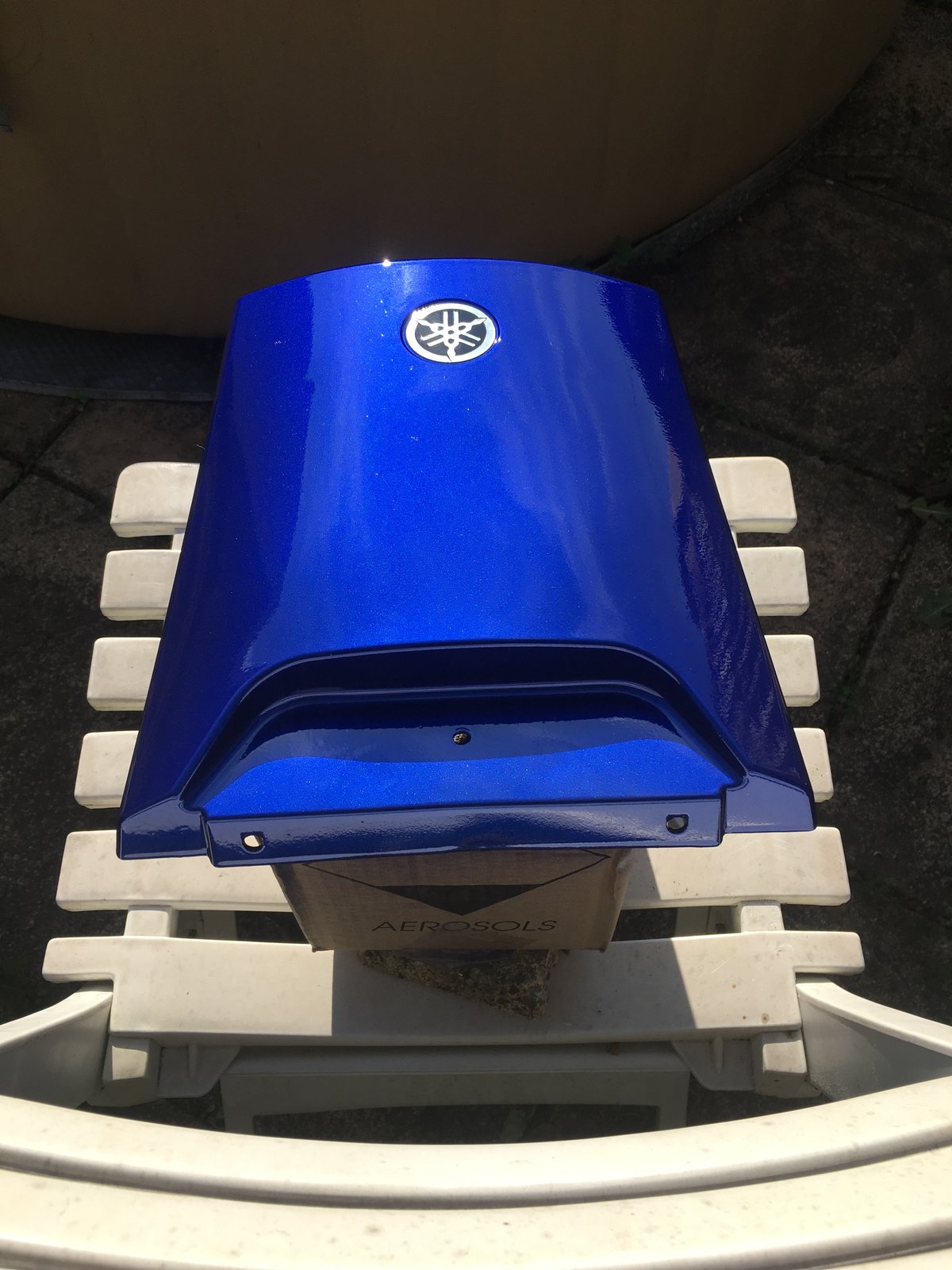

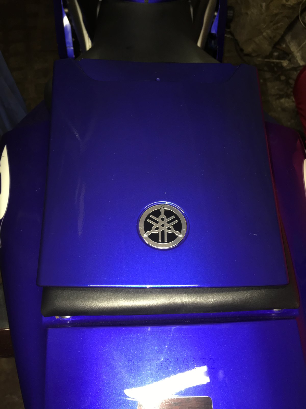

  1. Got fed up of looking at the Chinese seat cowl as I'm a little anal and wouldn't use something the wrong colour, so went down to Carpaints Bridgend with the bike and cowl to see if they could match it.
    It cost me £55 for 3mm lining tape and 3 x 400ml aerosols of base, metallic top coat and 2 pack lacquer in a rattle can. Not cheap but the colour is good and it can be machine polished in 24 hours so I put a load of lacquer on it.

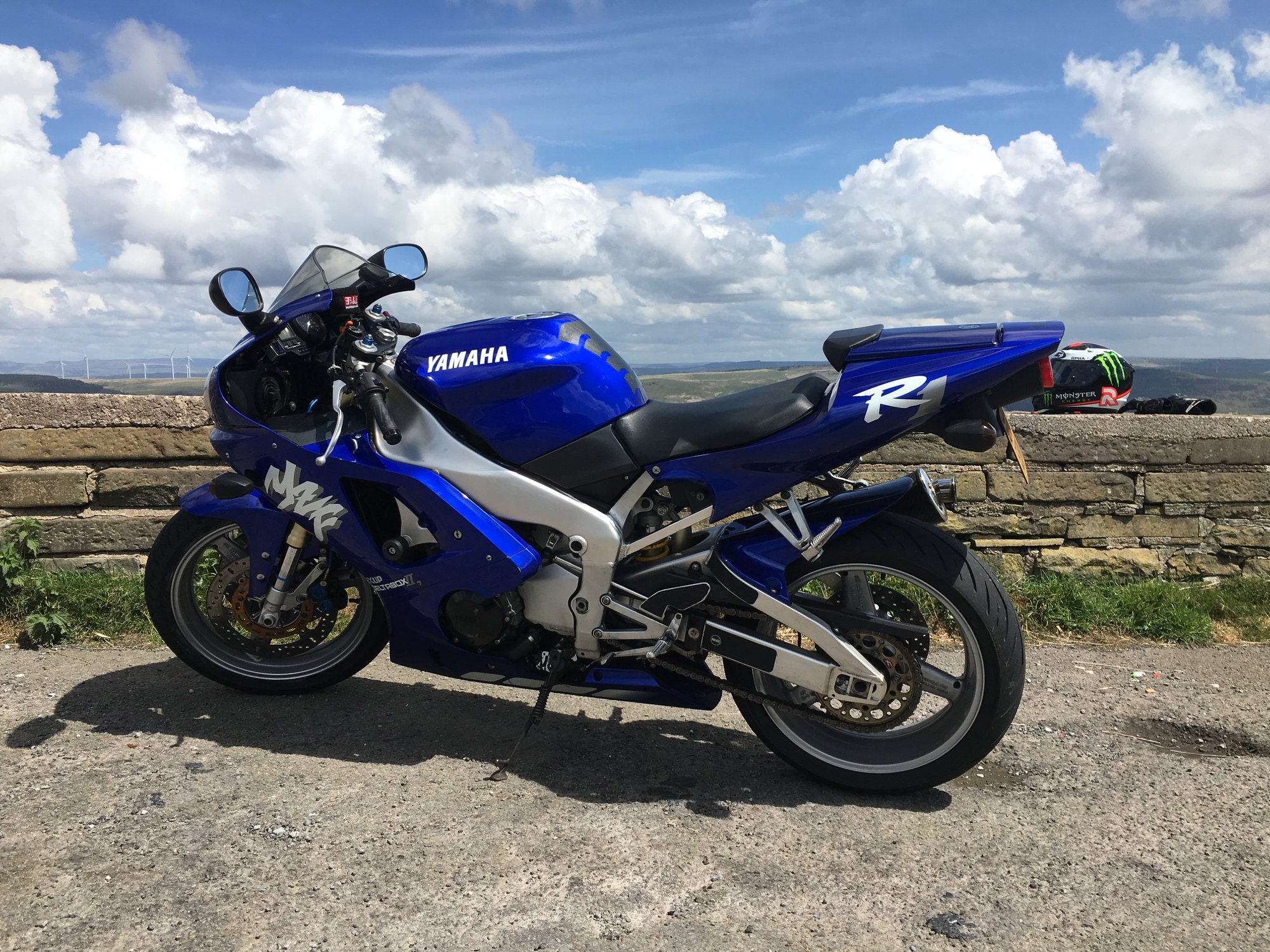

  2. Out this morning. Pic taken overlooking Tower Colliery, one of the last deep mines to close. Just dodged the weather coming home. 80 miles and it didn't miss a beat.

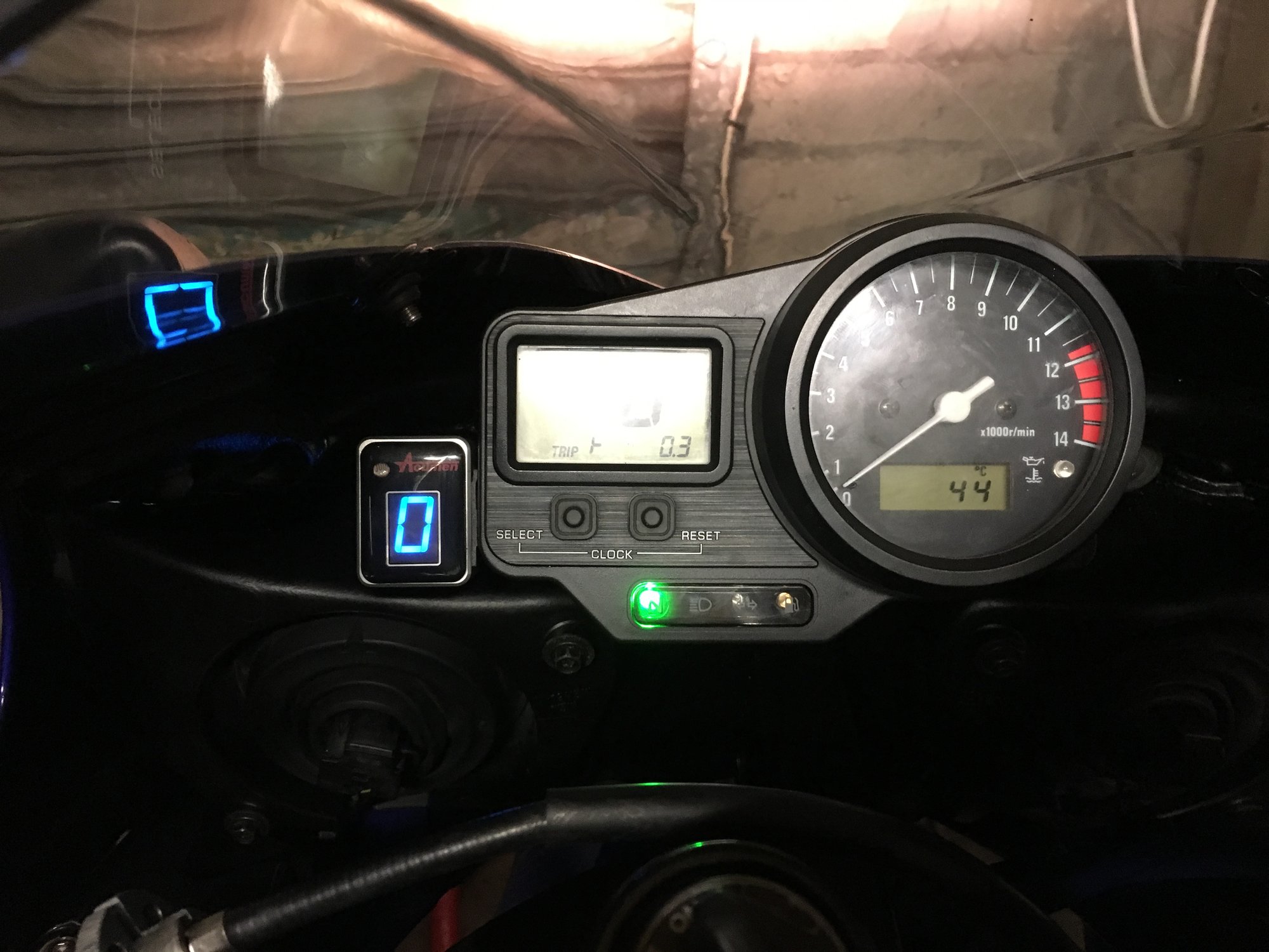

  5. My used Acumen Gear Indicator arrived late this afternoon so I went back up the garage, fitted it and set it up. Not overjoyed with the position but the fairing brace is in the way so it'll do.
    roofman likes this.

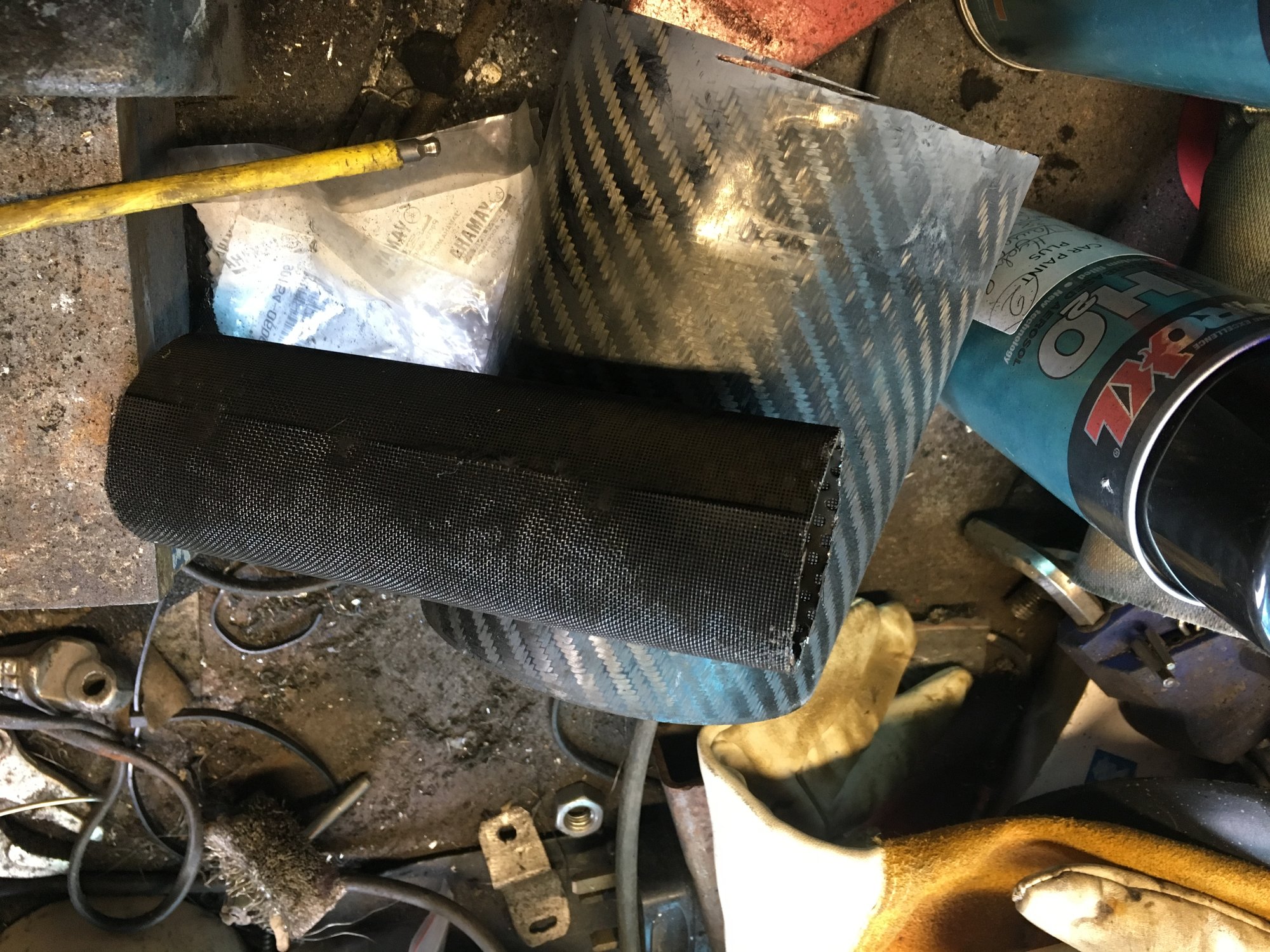

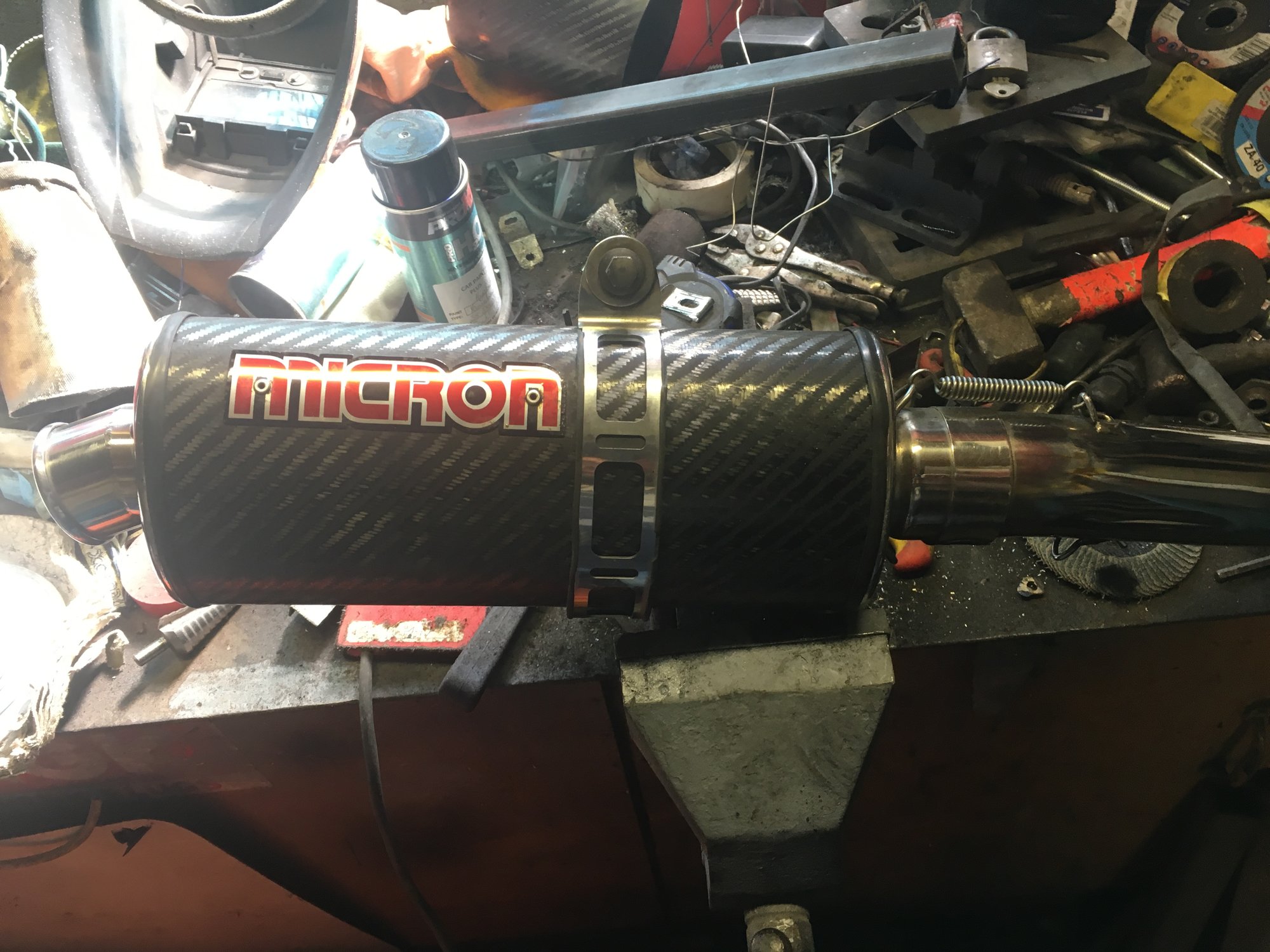

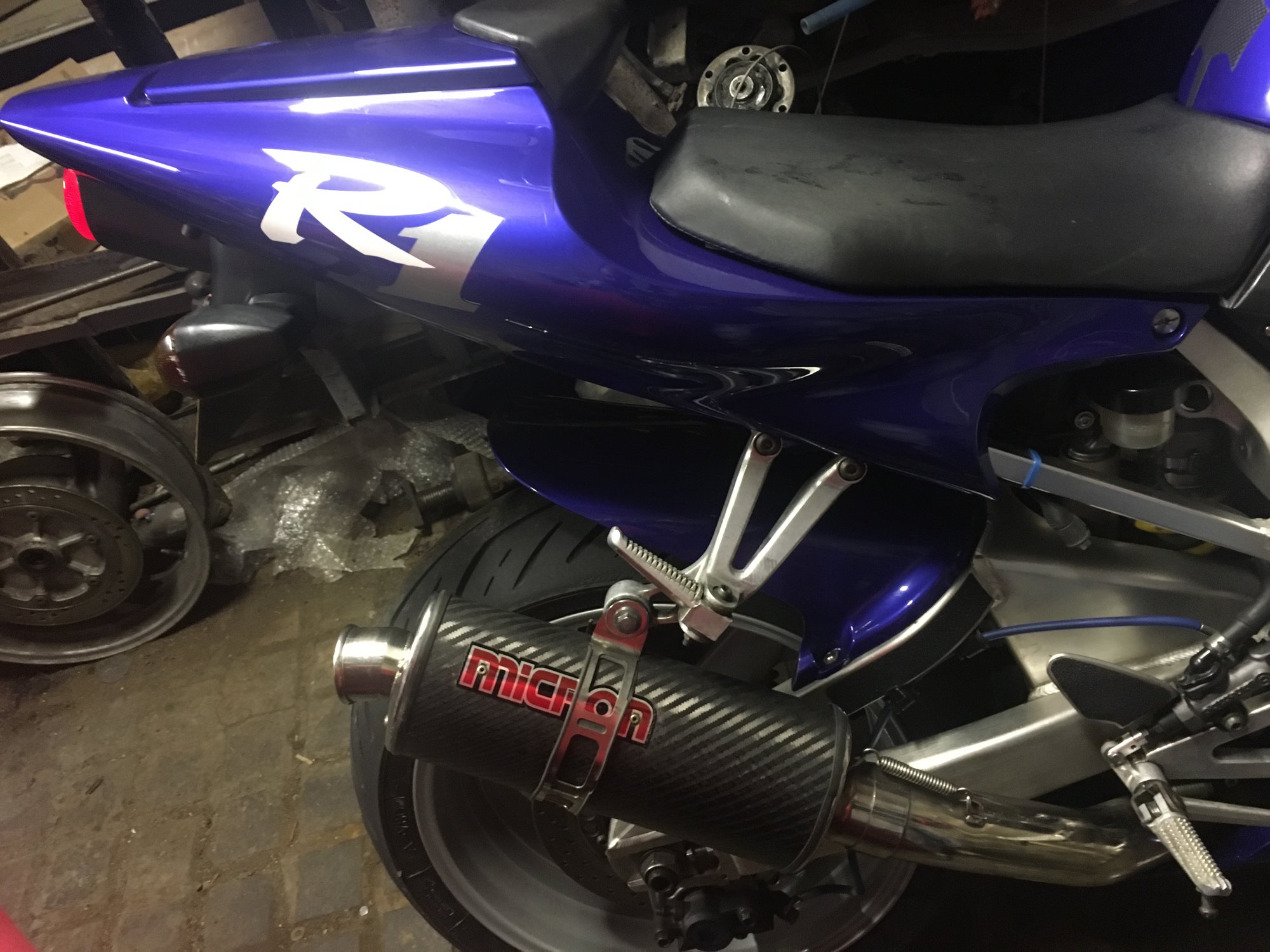

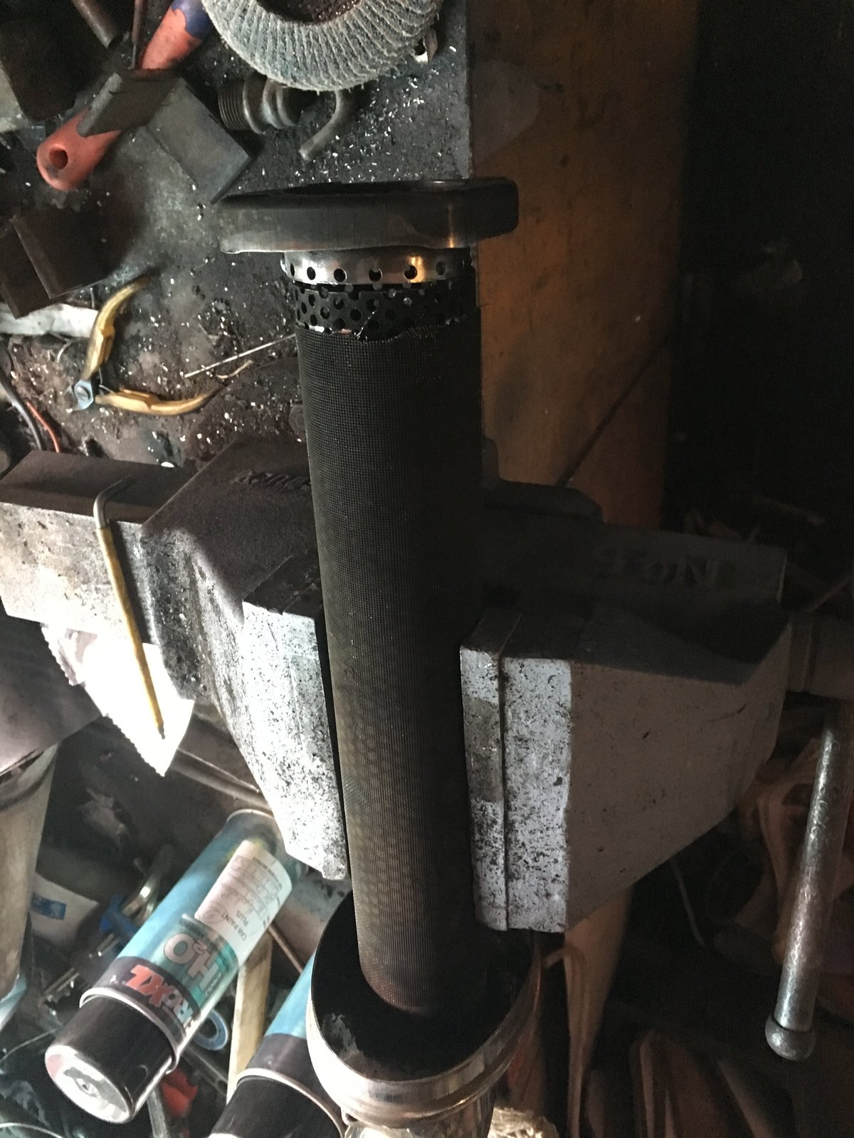

  6. With having a medical condition which stops me spending money :) I decided to hack up my Micron can.
    4 x bolts removed from the end cap allowed me to pull off the cap and withdraw the carbon sleeve, next a 1mm slitting disc saw around 180mm removed from the sleeve (well it was looking a little damaged from the strap anyway) a similar amount was removed from the perforated pipe and the end plate cleaned up to re-attach it.
    10mins of Mig action later and a further 10mins of re-wrapping the inner core with the packing and wiring it on there with some mig wire saw it was looking like this.
    Can't wait to fit it now.

    Gear indicator? Last time I saw one of those was on old Suzuki's!
    Exuptoy likes this.
  8. Haha, this is an old Yam. ;)
    Wallace likes this.
  9. roofman
    roofman Purveyor of fine English buckets and mops
    Messages:
    6,371
    Location:
    North West
    God loves a good old fashioned stubby as its written in the scriptures..."Daniel slayed the pipe and under a hot sun took a toothed sword and cut the head from its limp body unleashing fire,noise and destruction":D
    Exuptoy likes this.
  10. Haha, I like it.
  11. Just fitted it and it sounds very nice. Not half as obnoxious as I was expecting.

  12. Shox Dr
    Shox Dr Chief Engineer to Carlos Fandango
    Messages:
    13,645
    Location:
    East Yorkshire
    Nice I was going to ask if you were cutting it down. You can't beat turning petrol into noise:laughing:
    The AT has a micron it must have been 3 foot long before I cut it down, increased the engine braking alot. I've a Werks stubby on the triple, the flames on over run are entertaining in the dark:scared::laughing:

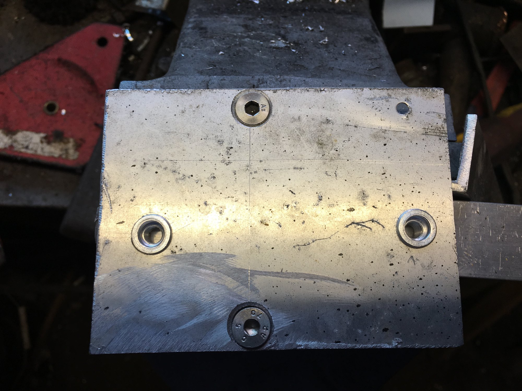

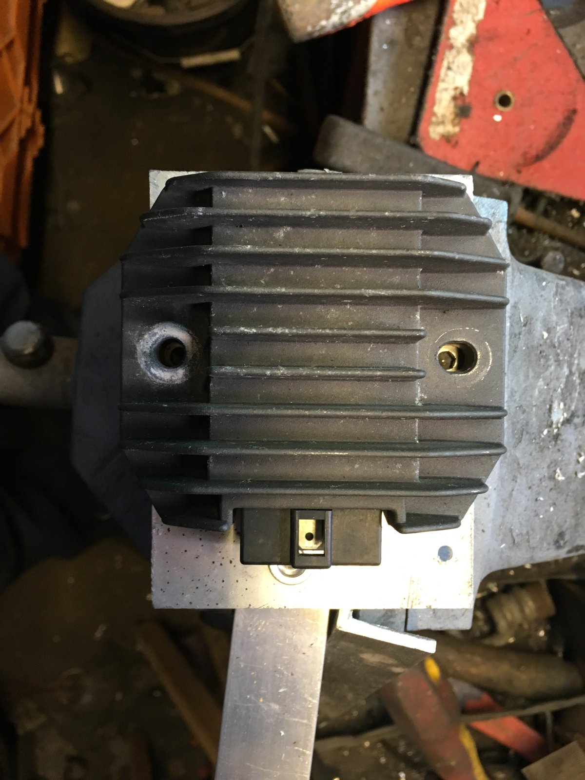

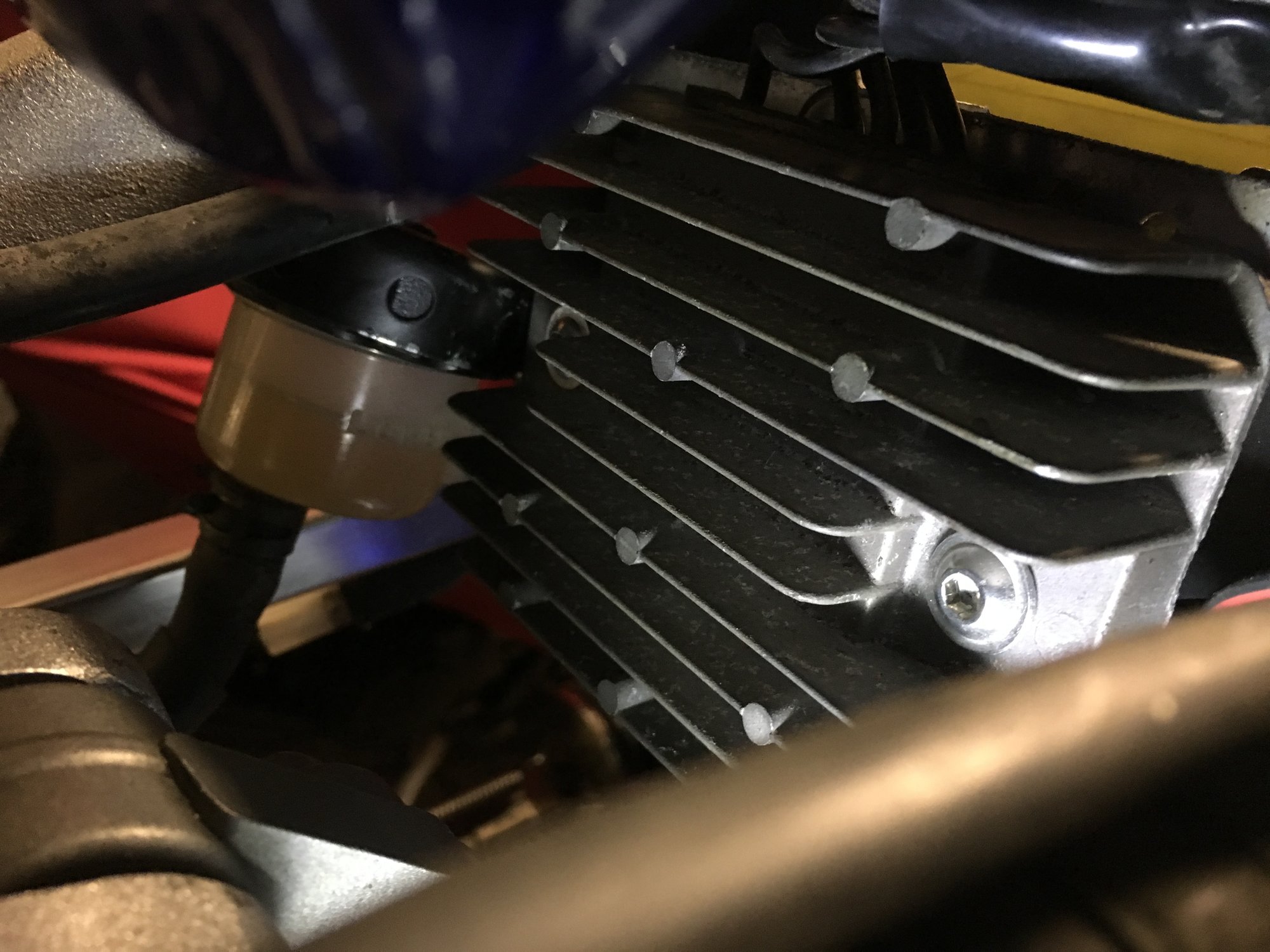

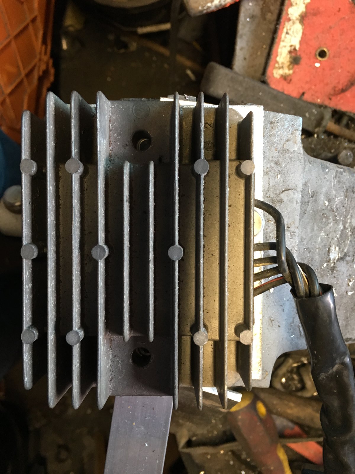

  14. After setting the carb balance and adjusting a little free play out of the throttle it seems like another improvement. Did 80 miles today but noticed the clocks doing silly things now and again like going off and the Acumen playing up too.
    I got about 0.5 mile from the house and when pulling up to a junction with the clutch in and as soon as I pulled the brake lever the clocks went off and the bike cut out. It started immediately but any input like brake lights or even indicators it was affecting the clocks.
    Got it home and put a meter on the battery to find around 11.9v and barely scratching 12 when revved. I knew I had a reg/rec sitting in the garage from when I killed my K3 Gixer so I fished it out and plugged it in and sure thing it's fine. Only issue was the physical dimensions were out so it needed a mounting plate making. I found a piece of ally and cut it the same size as the Suzuki one then transferred the centres from the regs.
    Then drilled and countersunk x 2 holes then drilled for the new one and fitted clinch nuts.
    Much better! Being bigger hopefully it should cope a little better too.

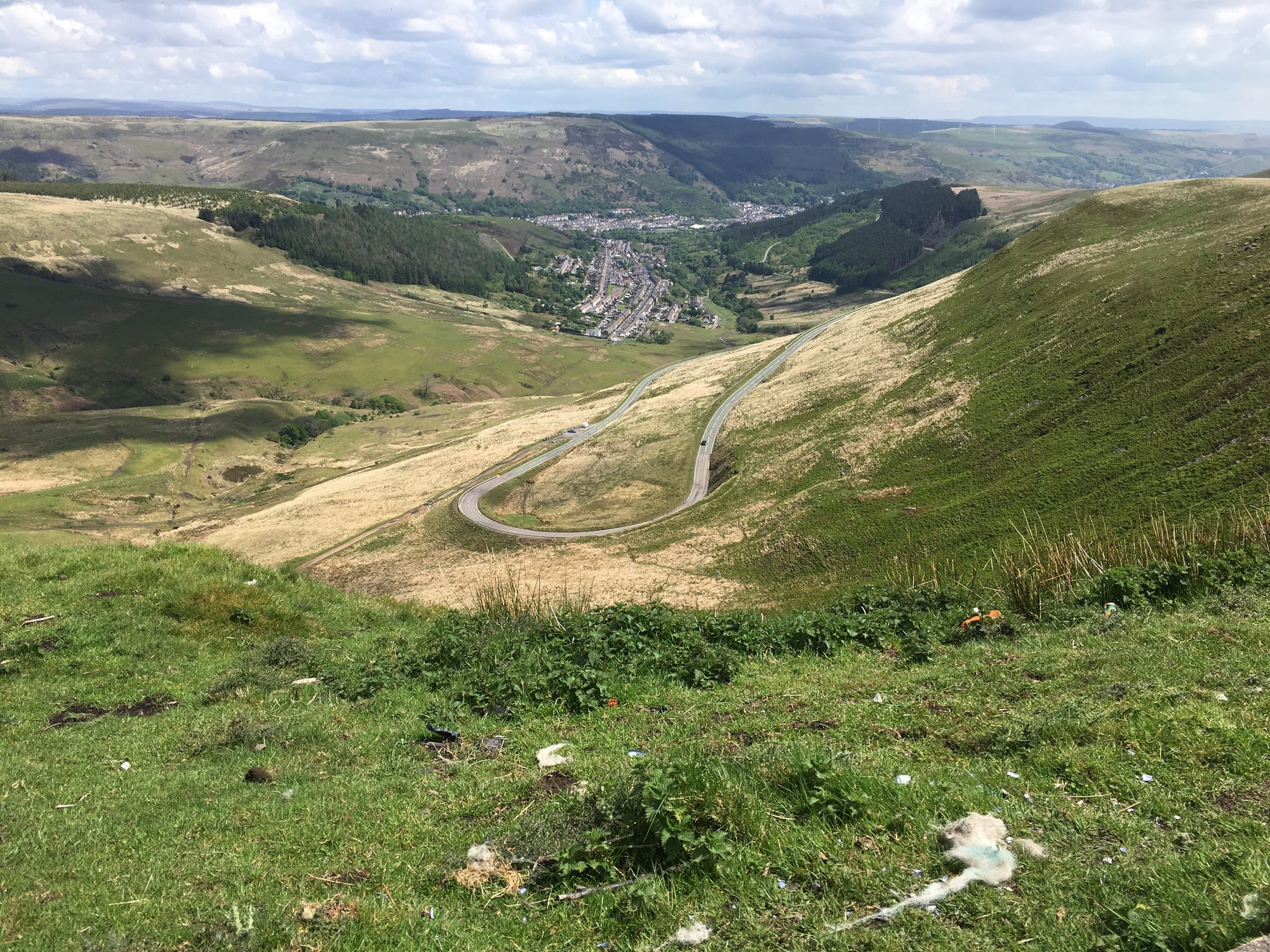

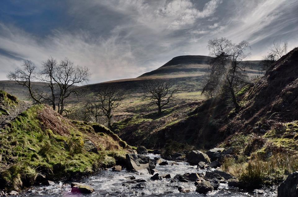

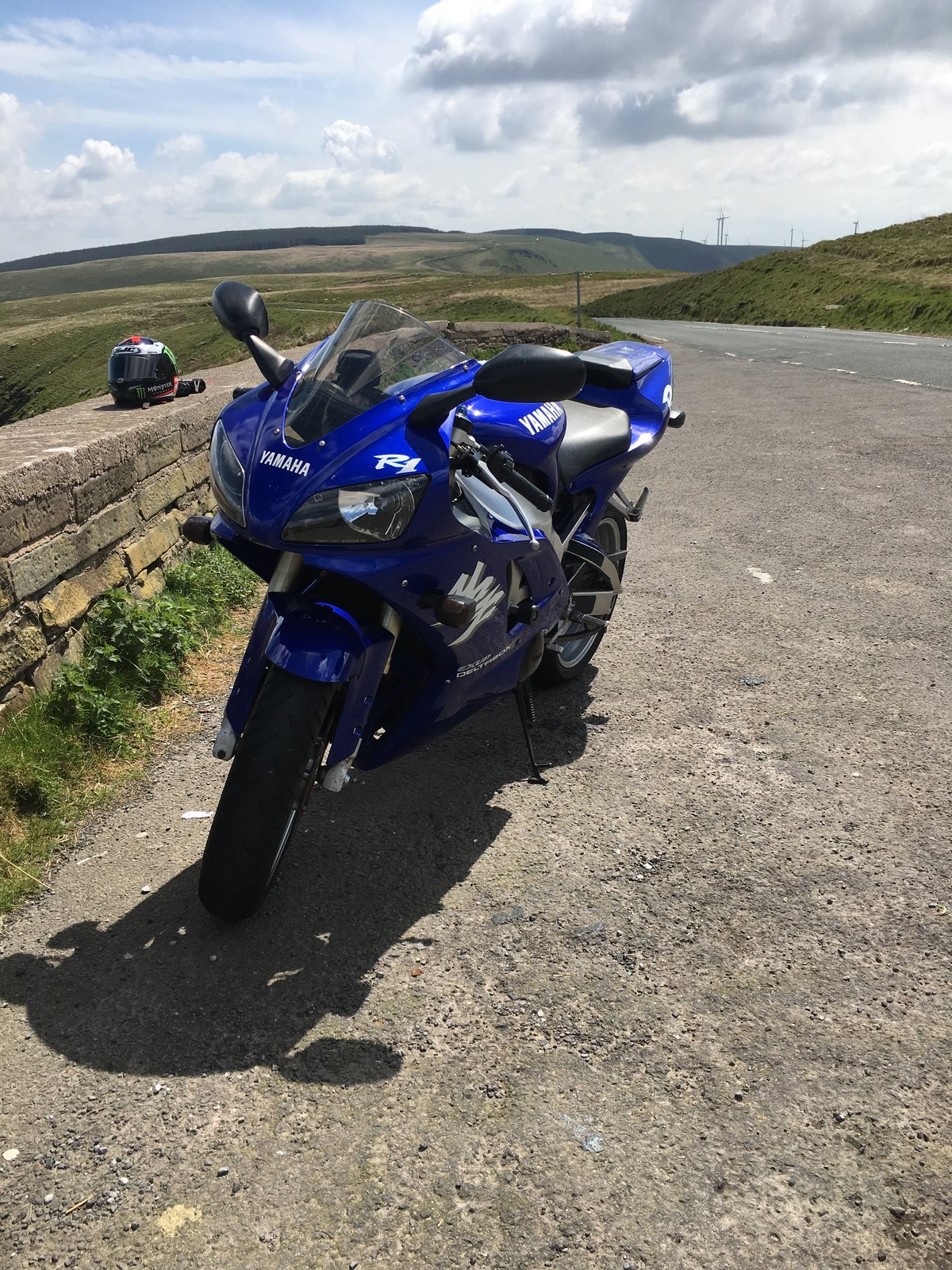

  15. Got a few pics today from up on the Bwlch mountain.

  16. zx9
    zx9 Member
    Messages:
    3,416
    Location:
    South East London
    I take it that you have just ridden up the road on the last pic. :thumbup:
  17. Yeah, lovely roads but the tarmac in that pic is in sh!te condition though.
    zx9 likes this.
