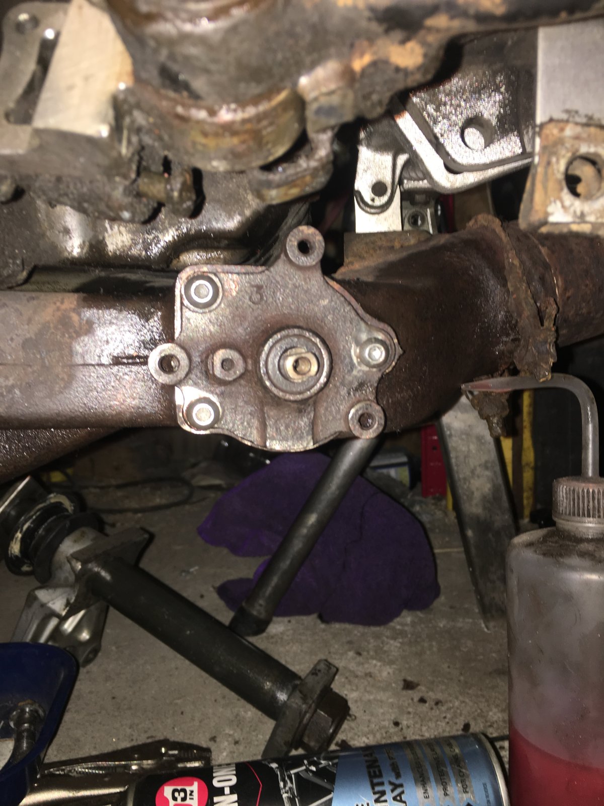

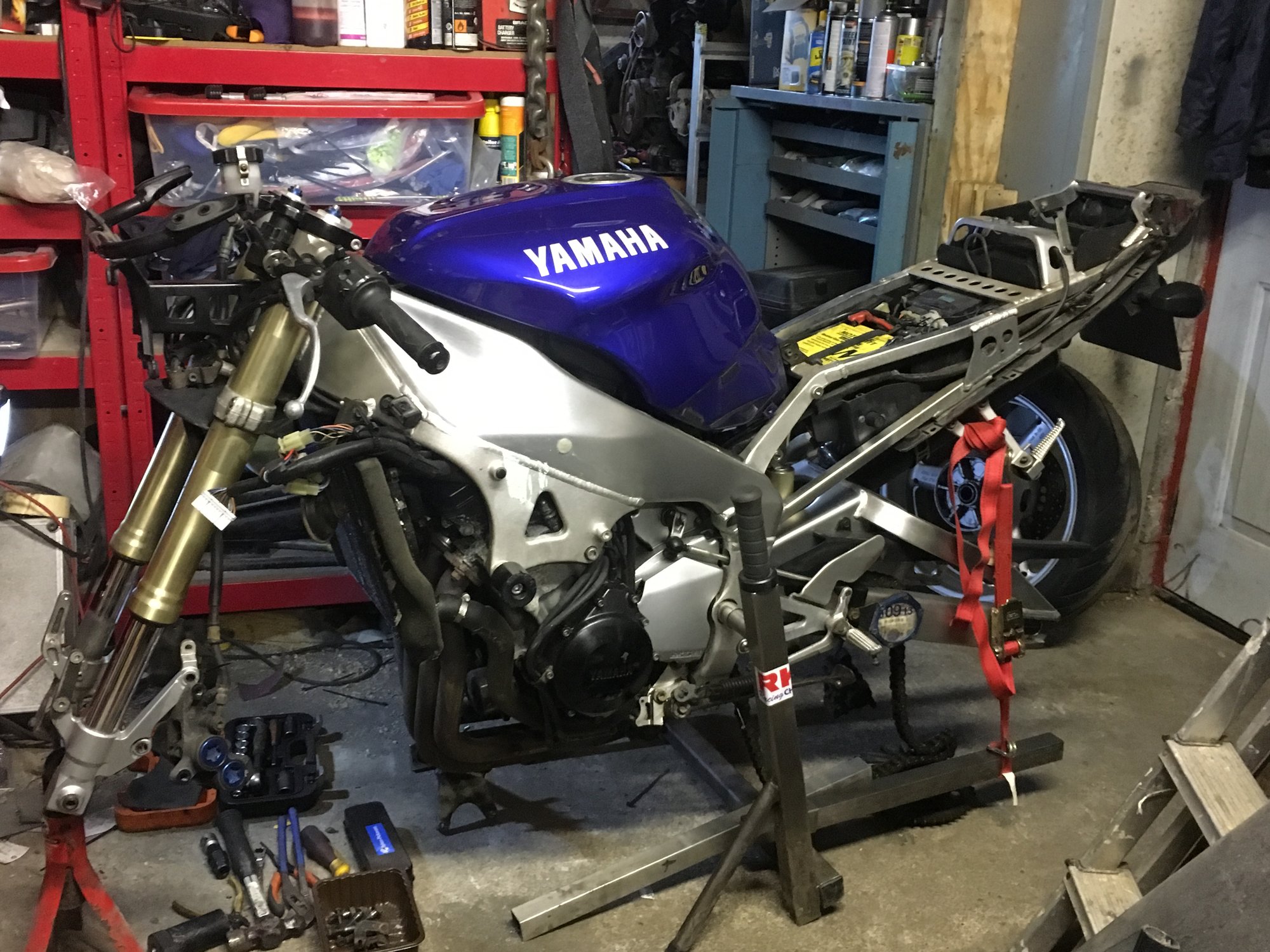

Spray brake cleaner around intake rubbers on idle..if no change in RPM then ide be looking at pilot jetsRight just been up the garage to look at the failed Exup valve, I've no chance of getting the bolts off the Exup valve as there is so much rust delamination they look like they've been stripped with a potato peeler :lol: I'll find a used manifold and grease it all up and change it out at some point.
The good thing is it must have been maintained by someone as the valve is free to turn with an 8mm spanner once the pulley wheel is off (thank feck it's the only bolt they used stainless for!!!). The cables do move a little when revved (maybe around 3mm each way) and the servo is clearly operating the cables, could that just be a cable adjustment issue?
Anyway aside from the Exup issue I managed to video and upload the vid. Whether the valve is open or closed (open in the vid) it still make this popping sound. Anyone have an idea??
I'm thinking maybe a valve clearance issue or carbs? Air leak?

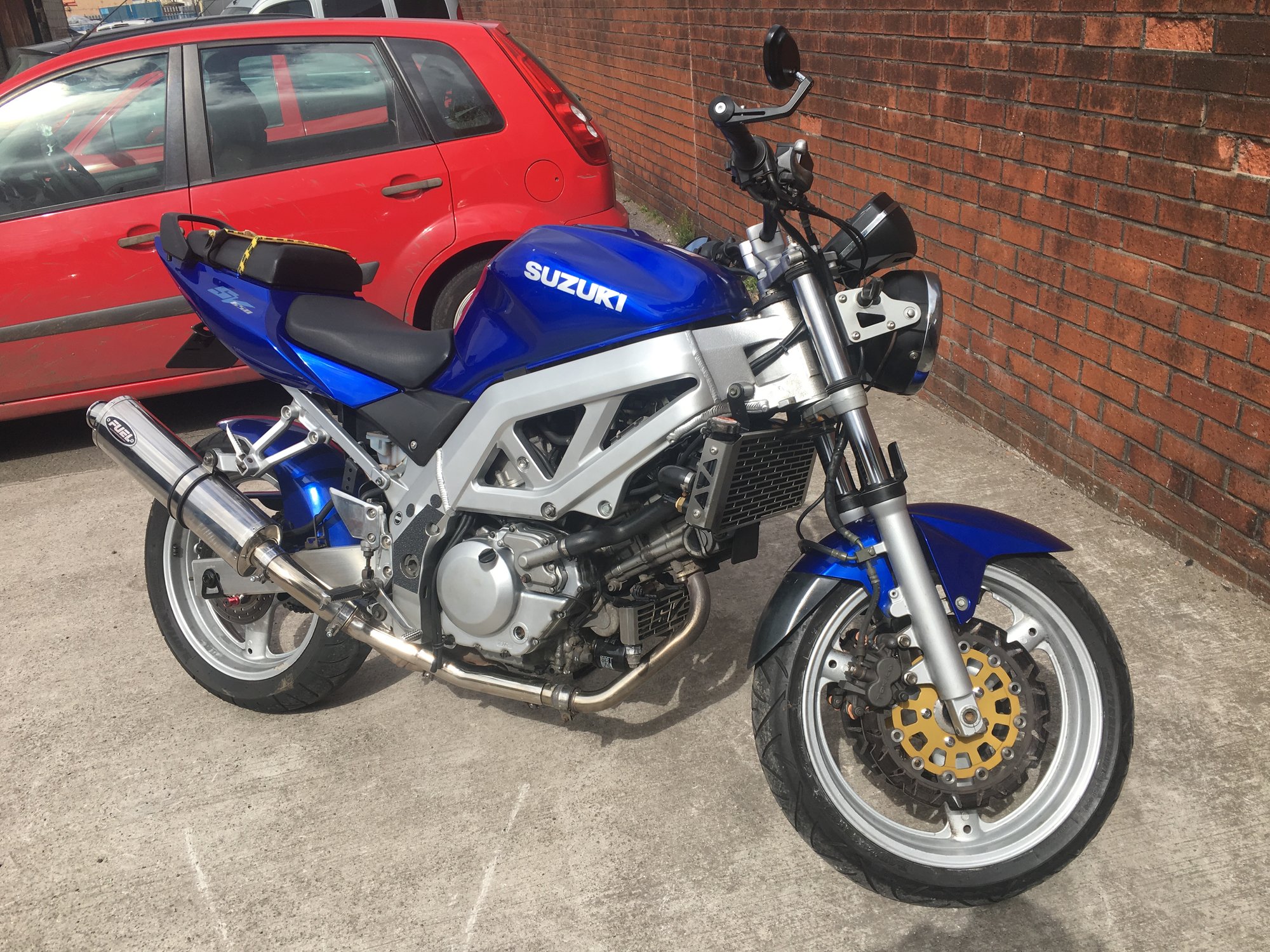

That sold fast...was it the bay of pigs?Quick update on the SV.
Just passed the MOT this afternoon.
Managed to repaint the oil cooler and fitted the stainless oil rad guard the other day.
The new owner collects it tomorrow.
