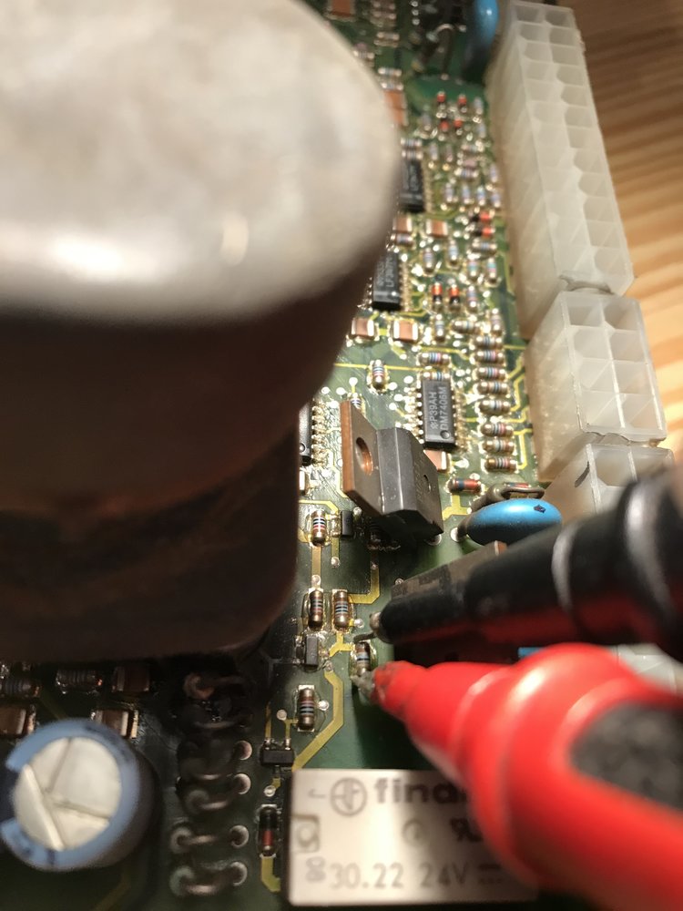

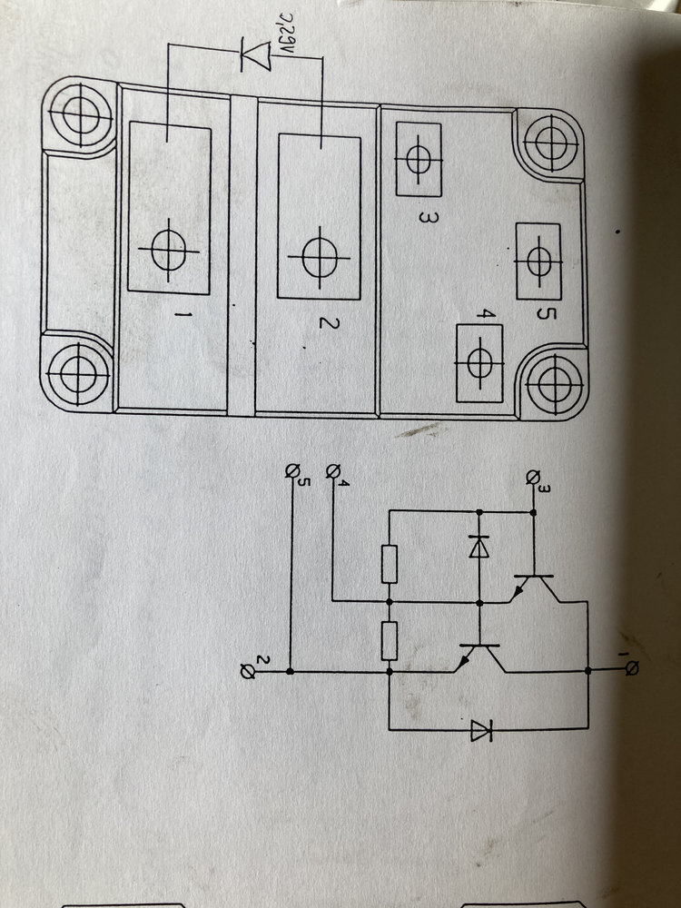

A search shows these two in Poland:does anyone have an alternative IGBT to replace the Fronius 41.0003.0145 My castotig 2002 has bkown one.

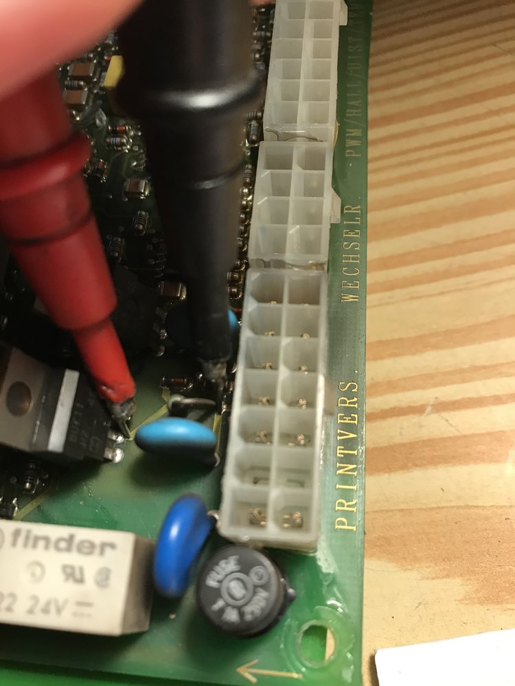

Thanks @., very much appreciated1,0v in circuit , unsoldered open circuit

Then ... post picture and location on the welder, with reference on your IGBT.
We might provide equivalence if known here.
Thanks eddieA search shows these two in Poland:

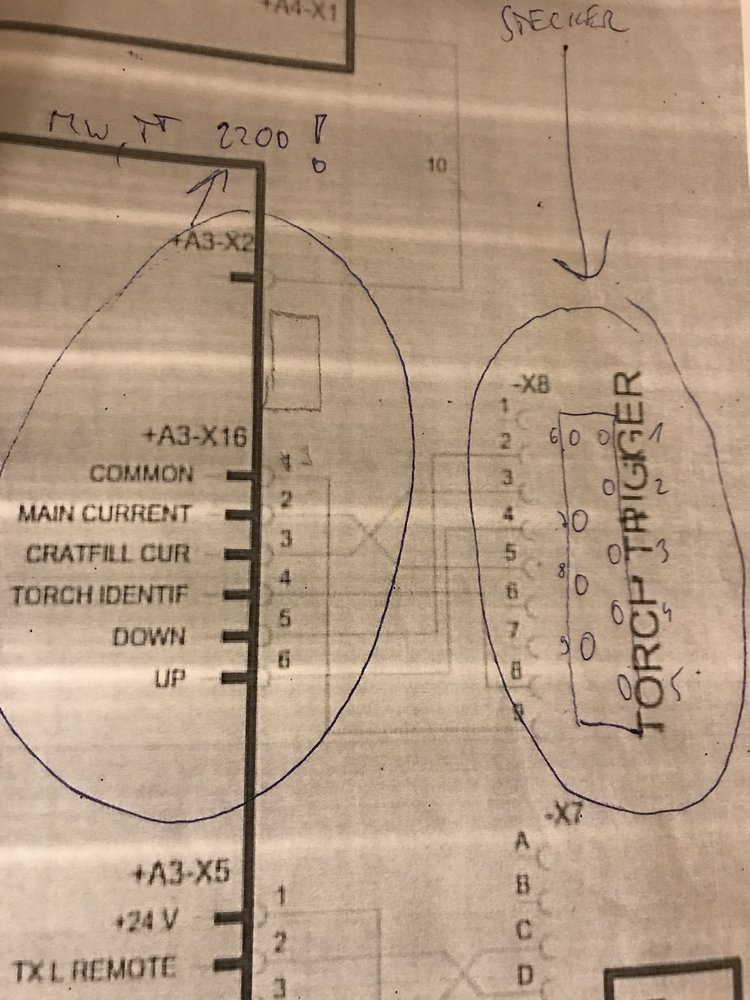

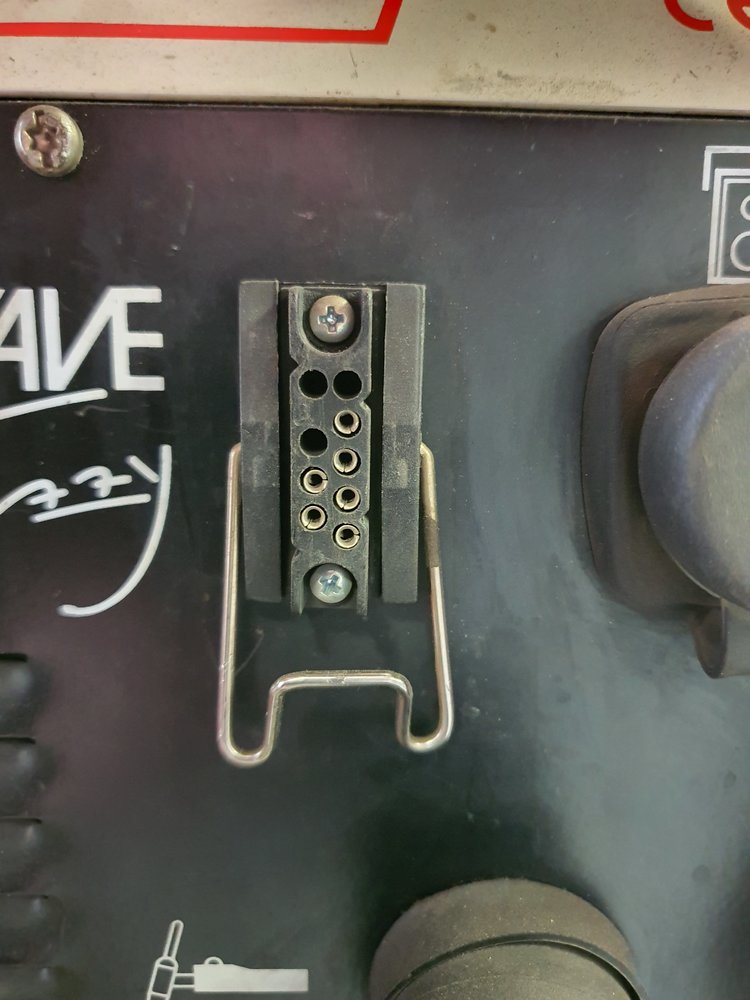

. please which two pins starts welding arc? Common+Torch identif?if you are to cheap to buy a connector you can simply stick copper wire in the pins , solder cable to it and make a connector body with hot glue or epoxy clay . ( like playdo )
View attachment 306823 View attachment 306826
