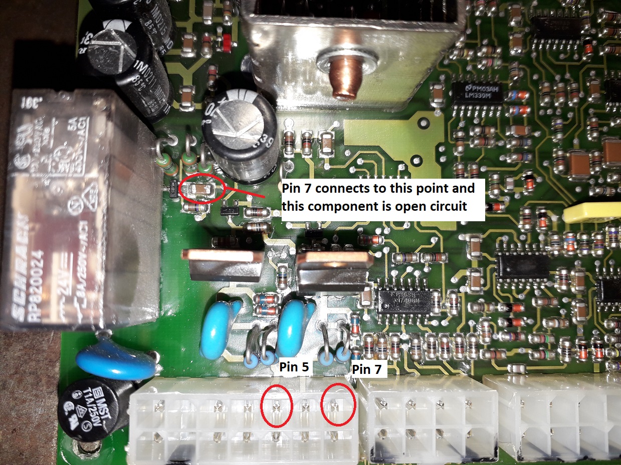

Takes only a few seconds digging into my gallery.
Wondering why this one is oc.

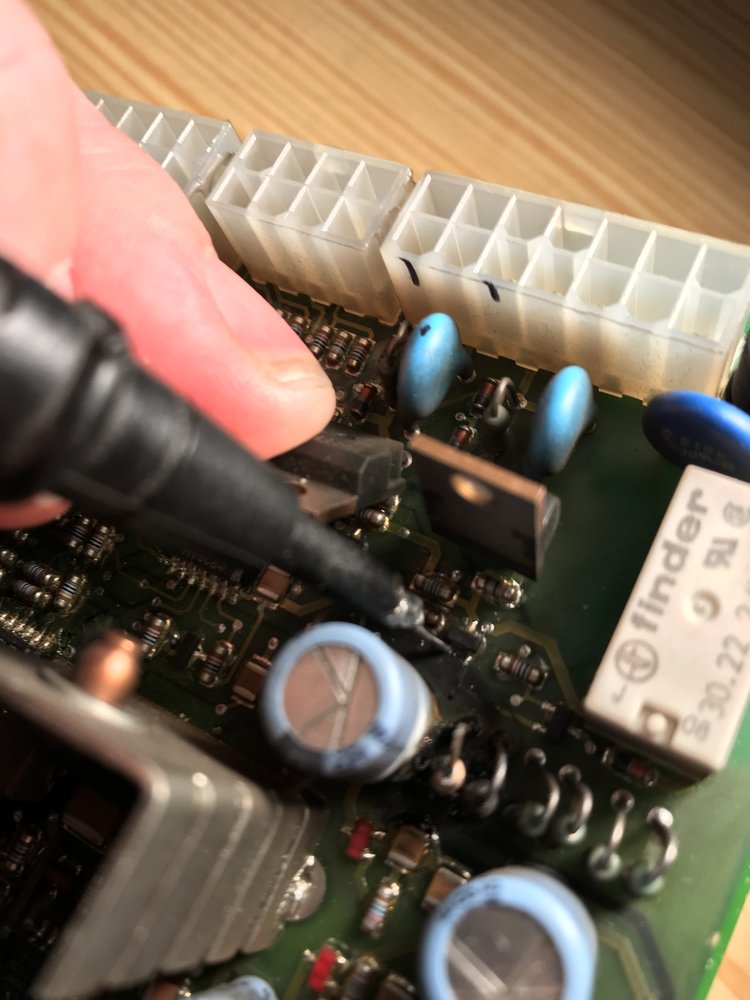

I even found a picture of this part of the board in my computer.
33 Ohms 10%.
And there is - in my folders - a similar picture of the same burned resistor, found somewhere on the Net.
Root caused to be investigated.
