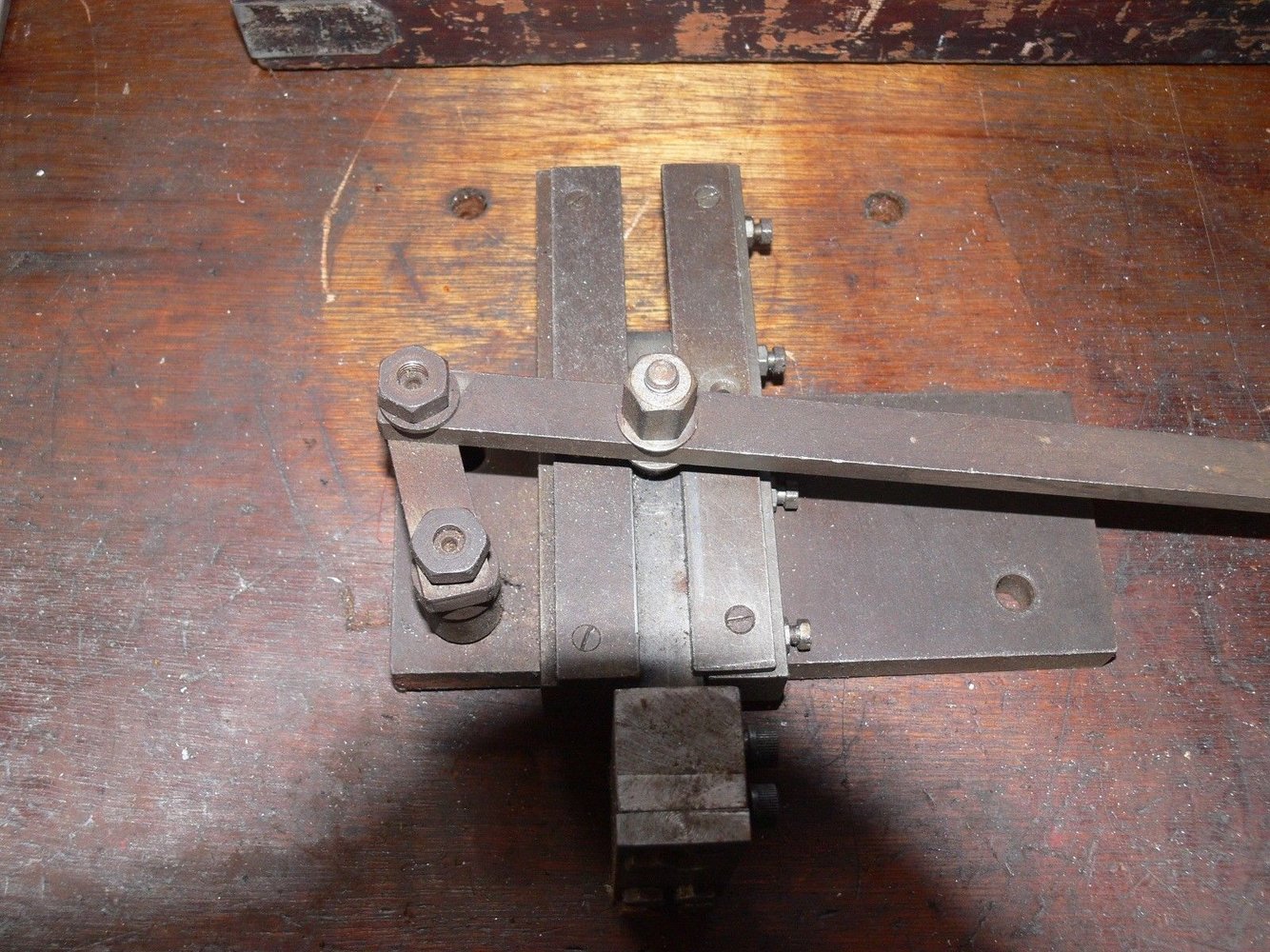

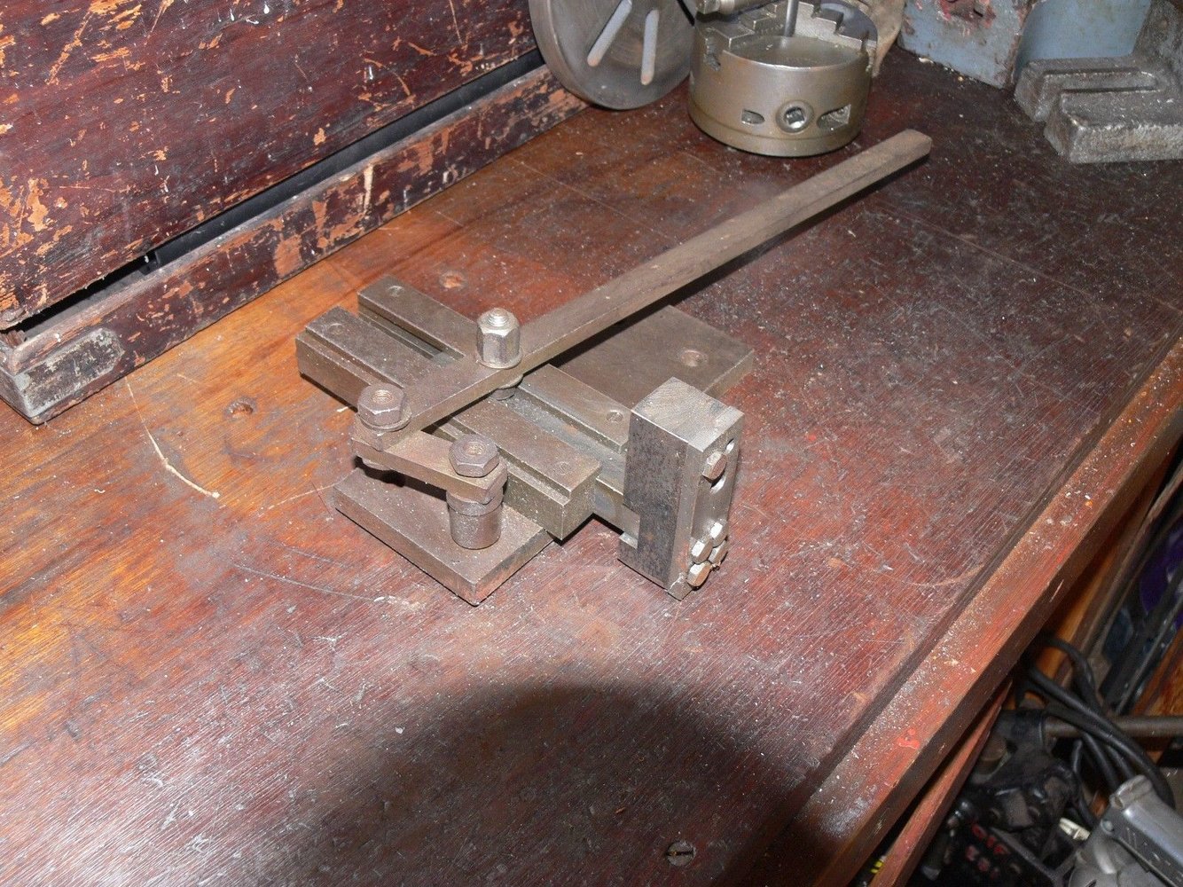

a quick shaper build for the lathe
View attachment 333040View attachment 333041
