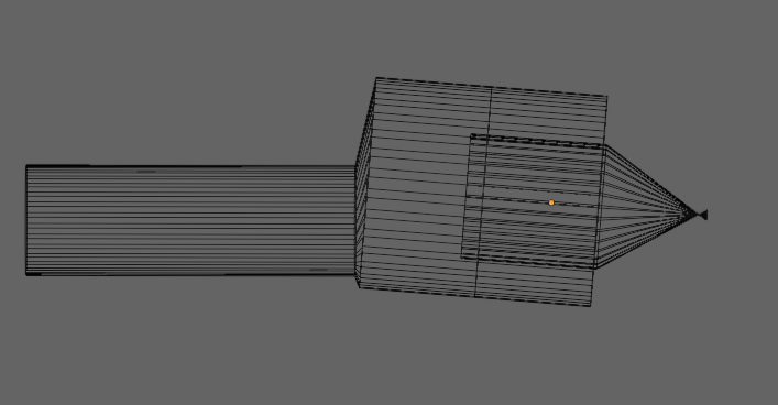

I made mine out of and old live centre, as they were advertised for silly money (£400). Cut the Morse off and welded it back to get the wobble, which is made up of offset and angle. The end of the tool is central with a ~5deg angle. Not pretty, but neither am I. Bought cheap set of allen keys, cut them down and ground them up. Rough but works well. Don't have any splined broaches.I seem to recall This Old Tony has done an episode on making one of these?
