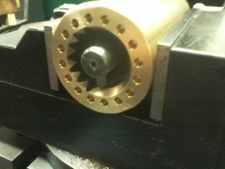

You make your cutter and centre drill the back end deep to hold a ball bearing. The wobble tool is just a piece of rod with an off-set hole also drilled for the ball bearing. Put the cutter in the start of the hole, wobble driver in the spindle and bring it down so the ball bearing is trapped between them, start the spindle and push it down using the quill handle.
IIRC using rather than making.I seem to recall This Old Tony has done an episode on making one of these?
I didnt realise wobble cutters were that simple?! I will have to try it!

They really are, pal made one out of scrap too be able to make some hex driveI didnt realise wobble cutters were that simple?! I will have to try it!
