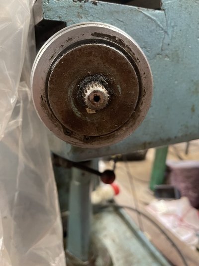

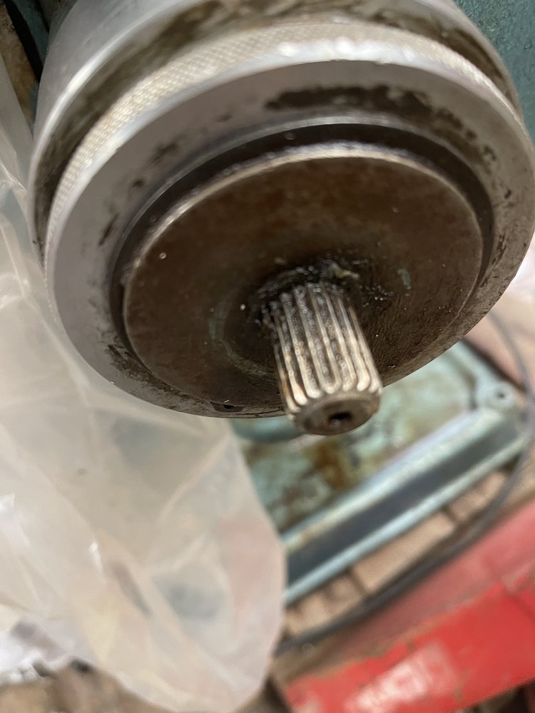

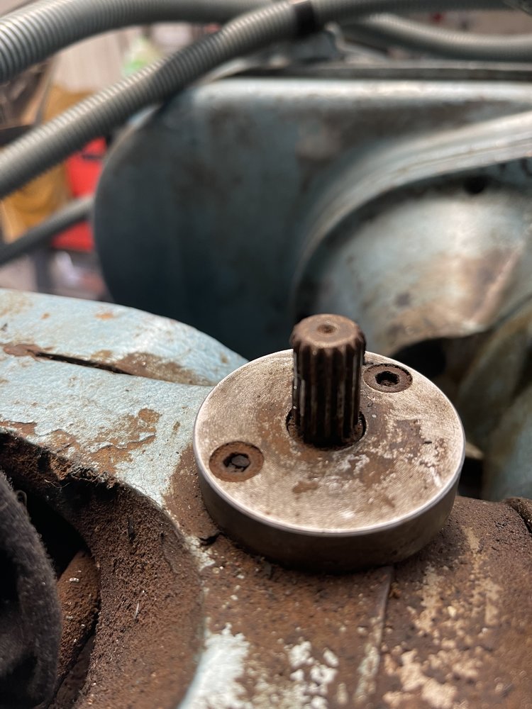

I'm a bit of a bodger....so this is definitely a bodge.
Stick a steel sleeve round the spline (with a bit of a gap) and fill the gap with low temp ali brazing rod...then work your handle off the steel outer sleeve. Would also work with epoxy I should think too.
But as I said...I'm a bodger...it can be improved upon with a keyway etc but still a bodge.
