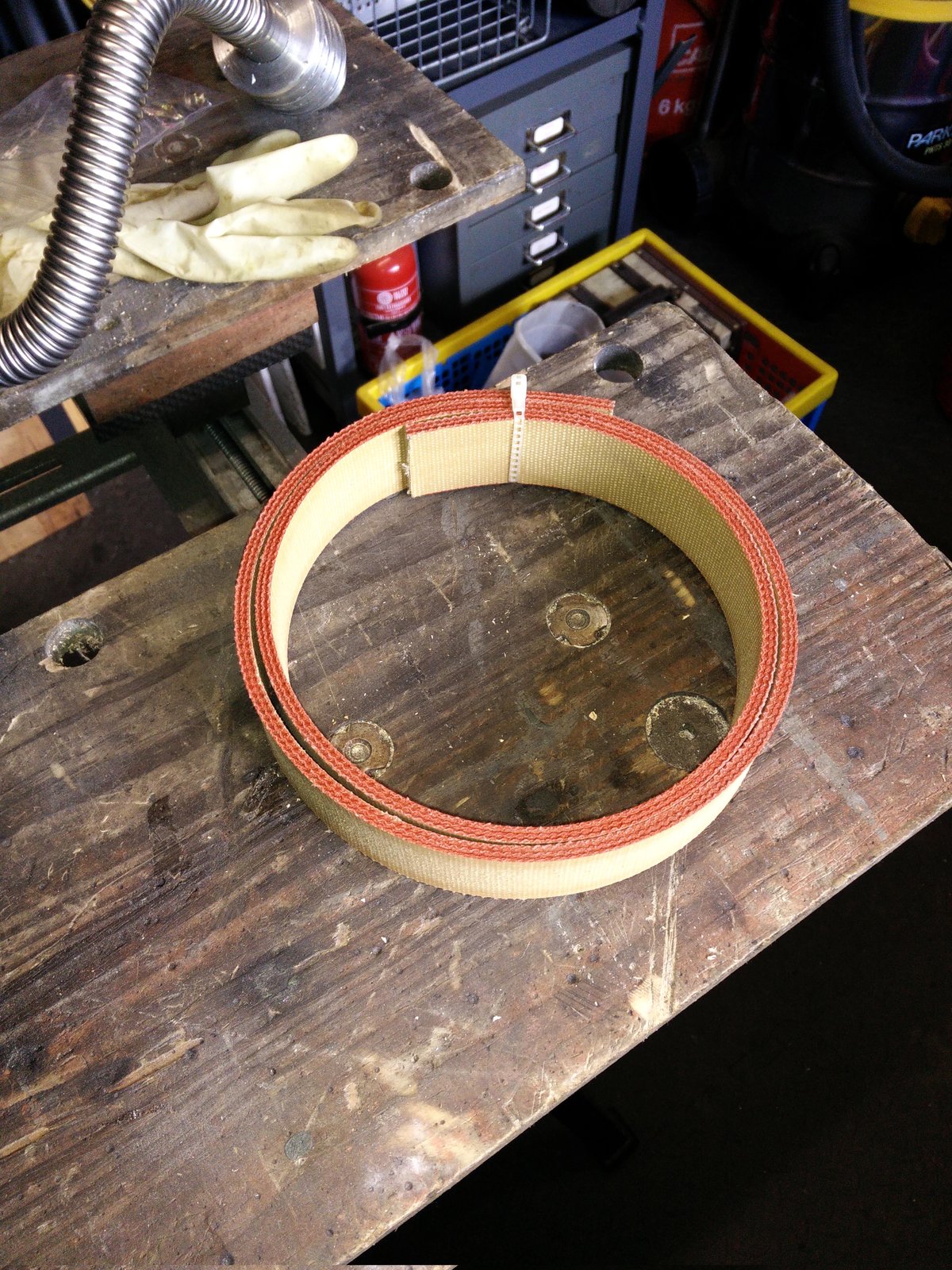

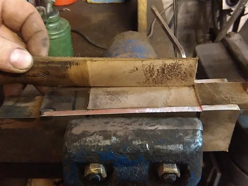

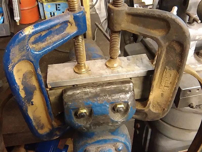

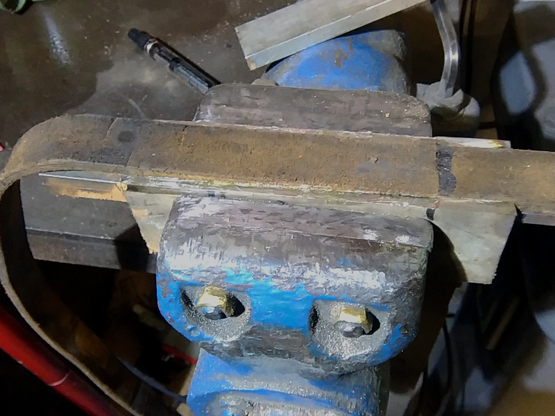

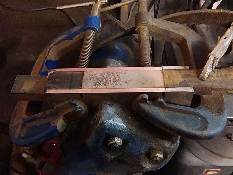

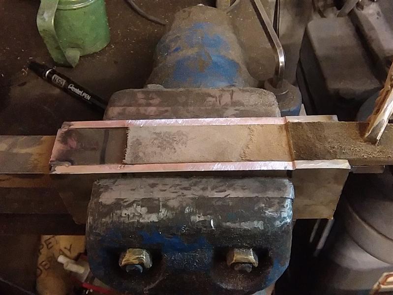

I make a jig using two side plates and a piece in between fixed at a shallow angle. Clamp the belt to it and grind/sand/file the belt to a taper with a step at the end. Do both ends and then clamp the ends together in the jig. I used either evo stick or polyurethane glue
That's great thanks, I'll have a look at rejointing like that.
