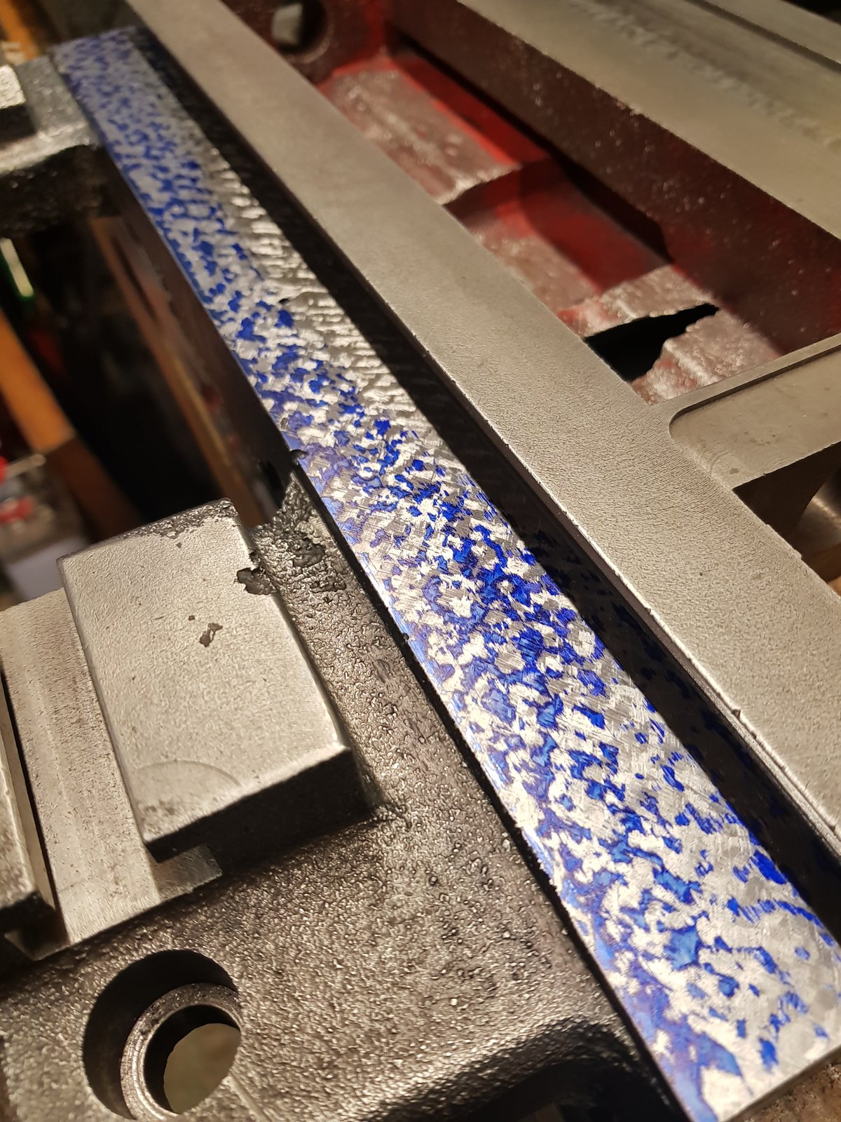

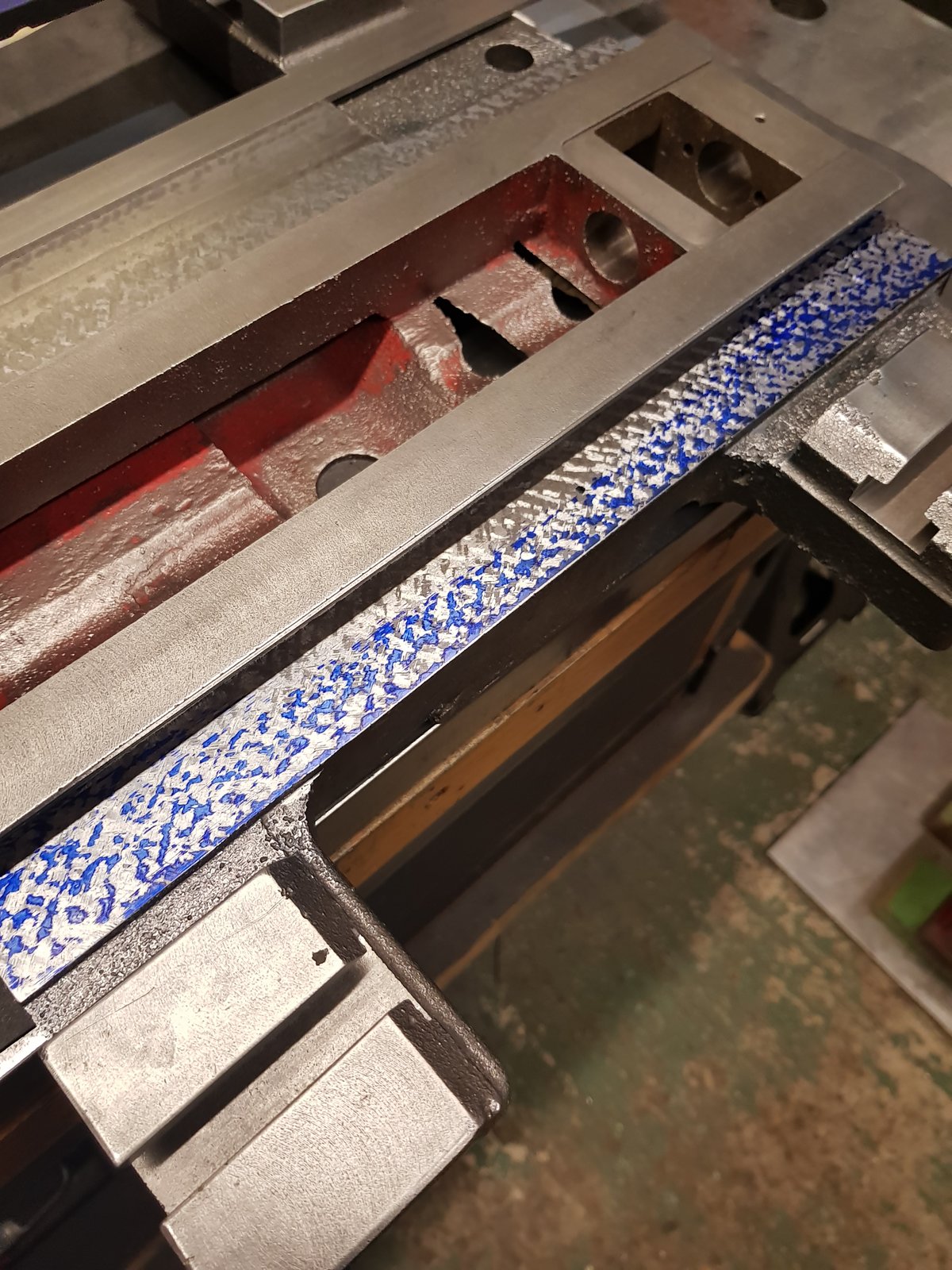

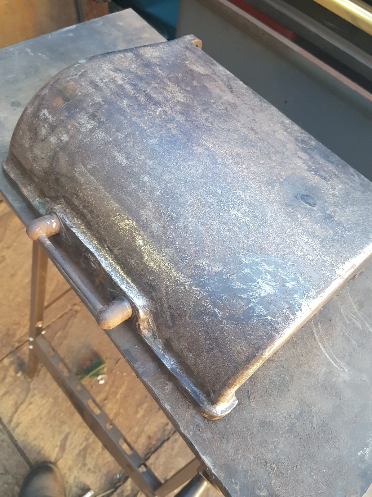

A couple of updates. Still progressing with the scraping of the carriage. Long job this one as it was totally out of shape. But am getting there. View attachment 164729 View attachment 164730
You can buy them . I had these ones made. My ones flex a little and that helps . I have one streight and a swan neck.Making good progress there. Not sure if you have mentioned it already, where did you get your scrapers from? I'm struggling to find somewhere that sells a proper machinist scraper!
Sandvick . When I did it for a living company was to tight to buy them so we had to braze carbide onto a holder. Small ones for light tickling were made from gauge plate. Only charge hands had biax or old cable drive wobblersMaking good progress there. Not sure if you have mentioned it already, where did you get your scrapers from? I'm struggling to find somewhere that sells a proper machinist scraper!
