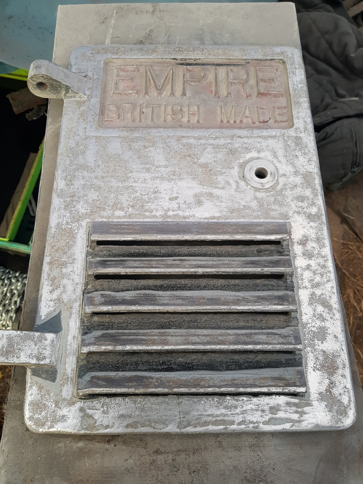

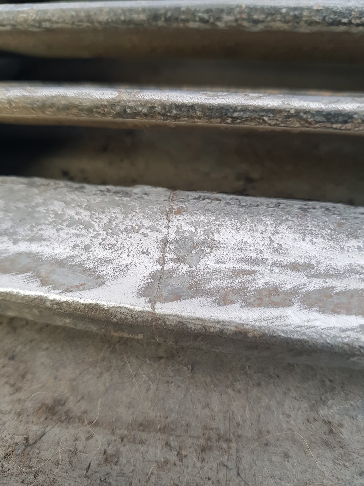

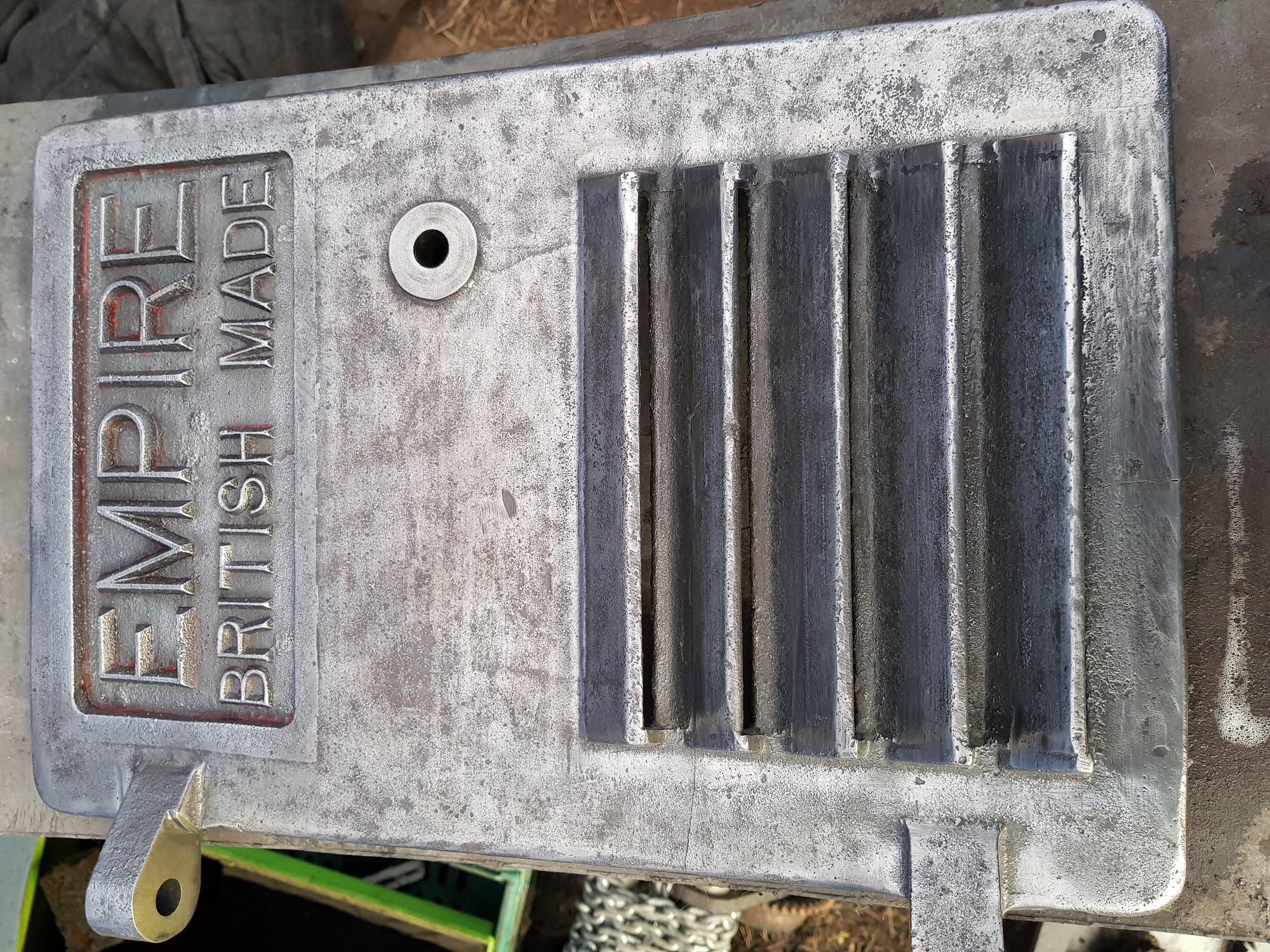

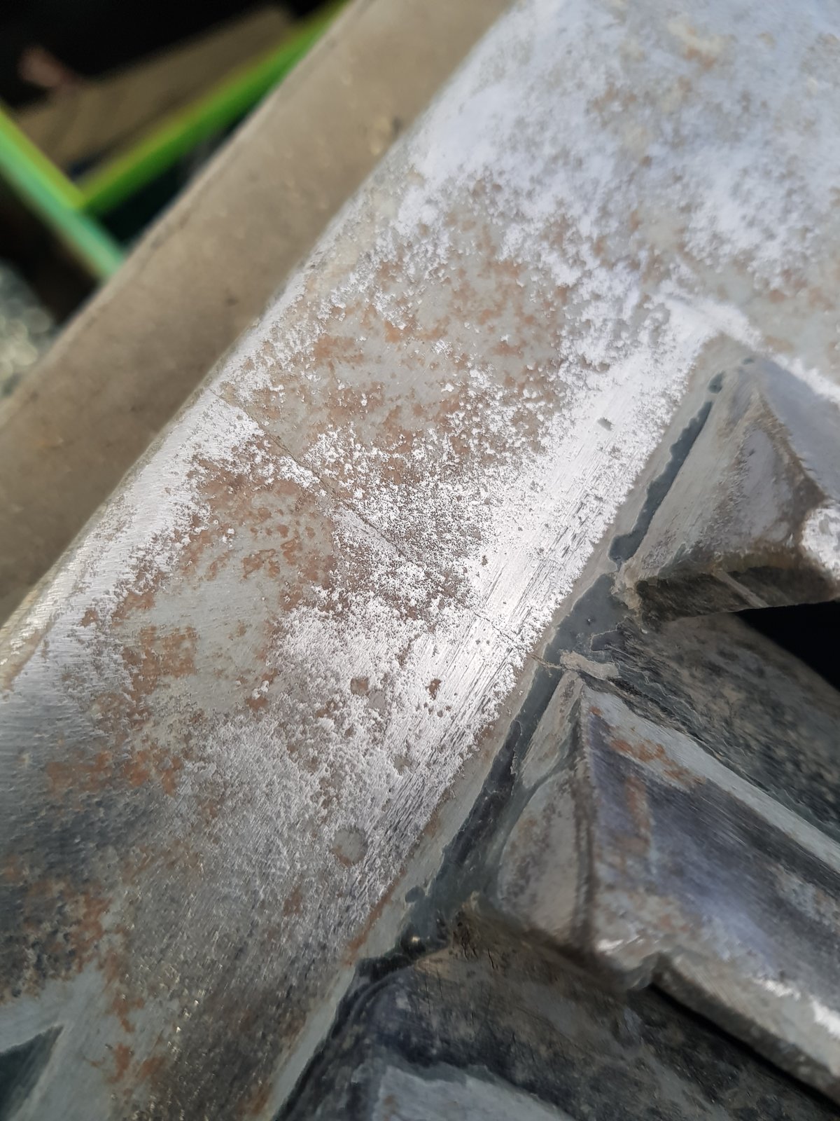

Today's task.
Make a start on the doors. Basic filler removal. This will be done in a couple of stages. Also have some cracks in the casting. Nothing to serious but will need sorting. I will v the cracks and nickel weld these.
