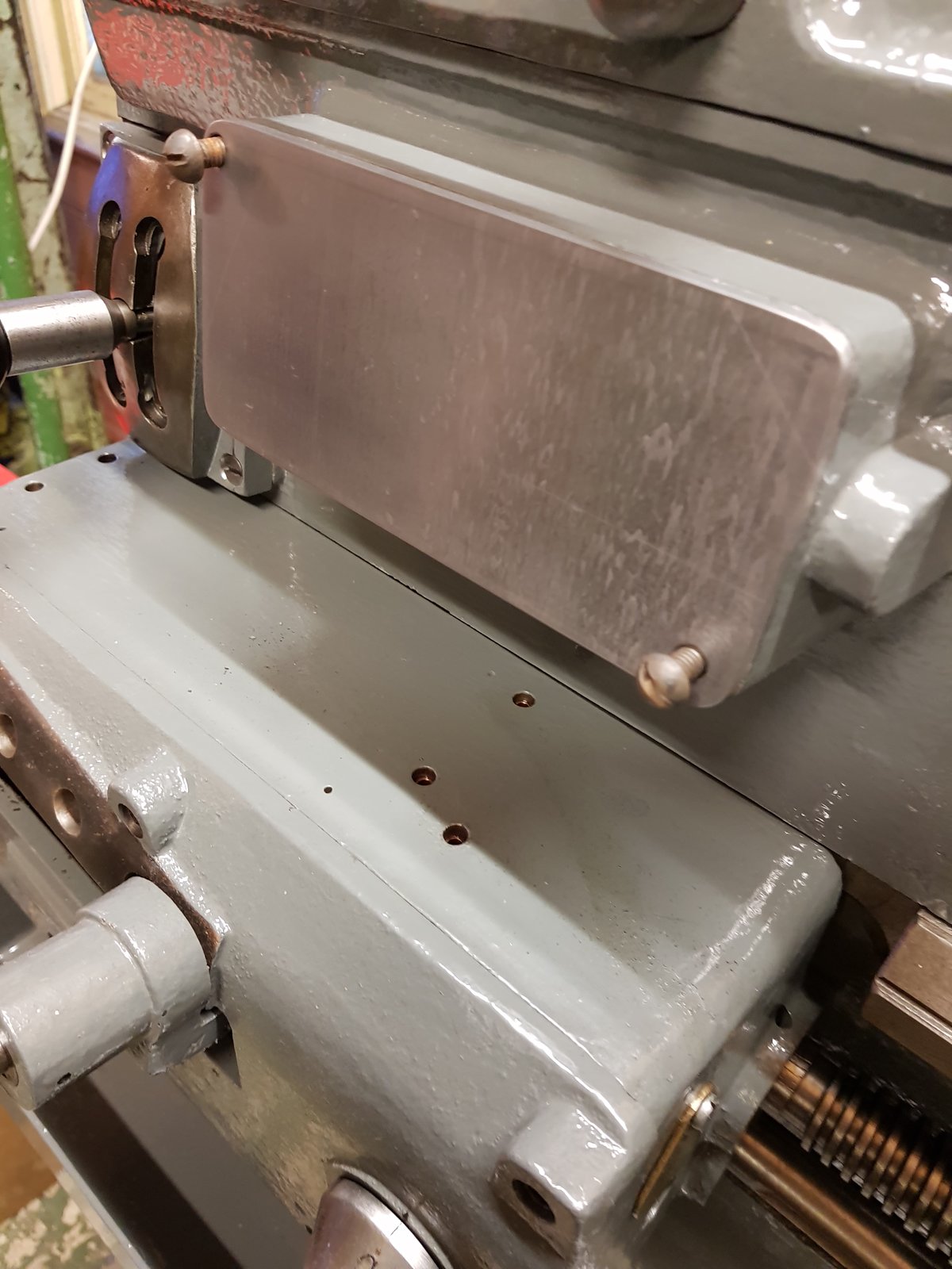

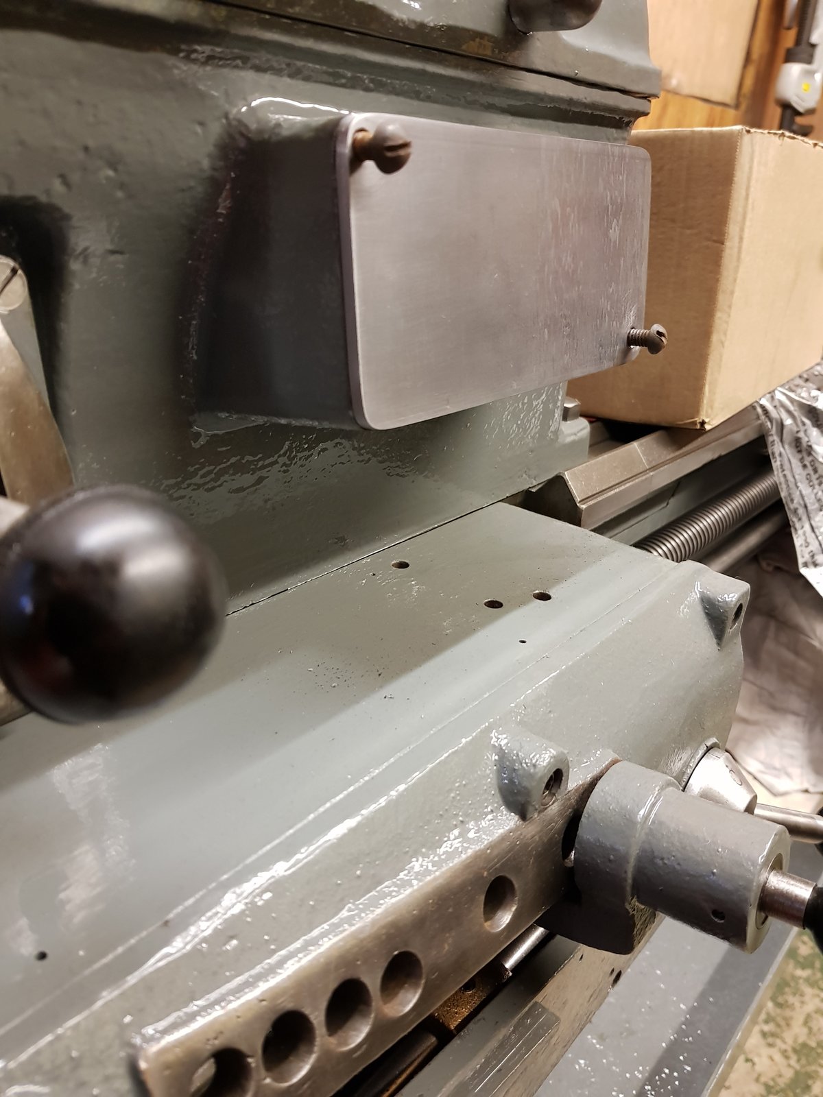

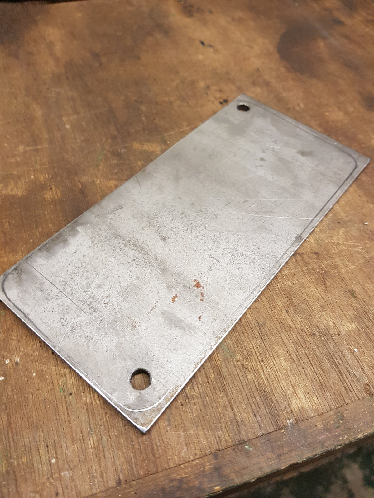

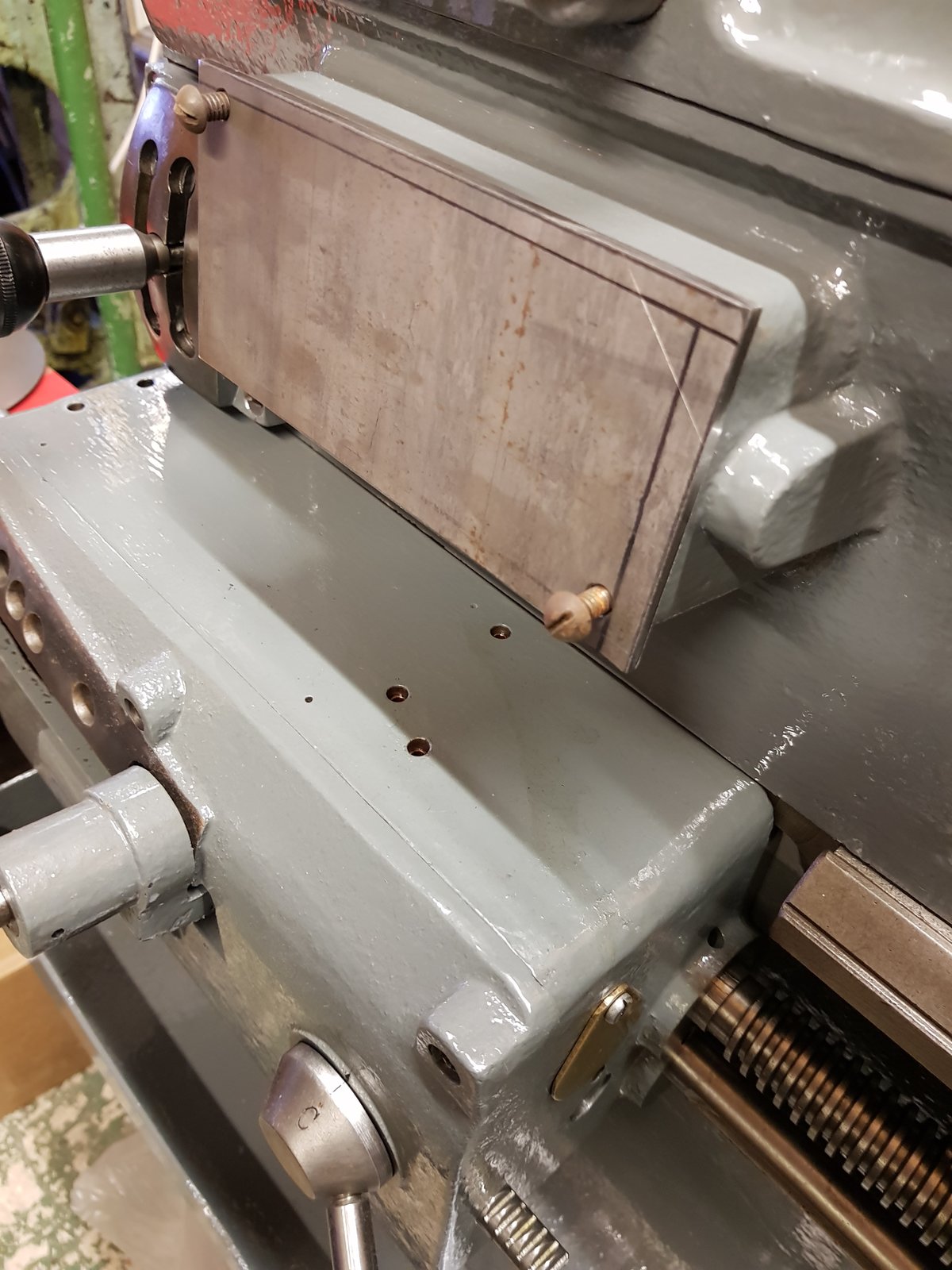

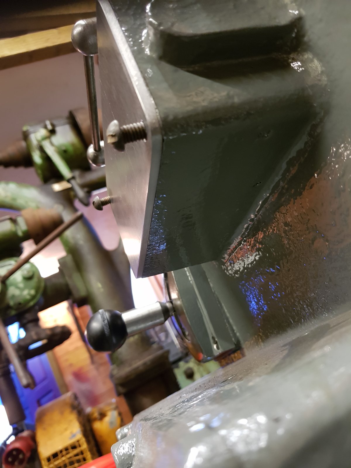

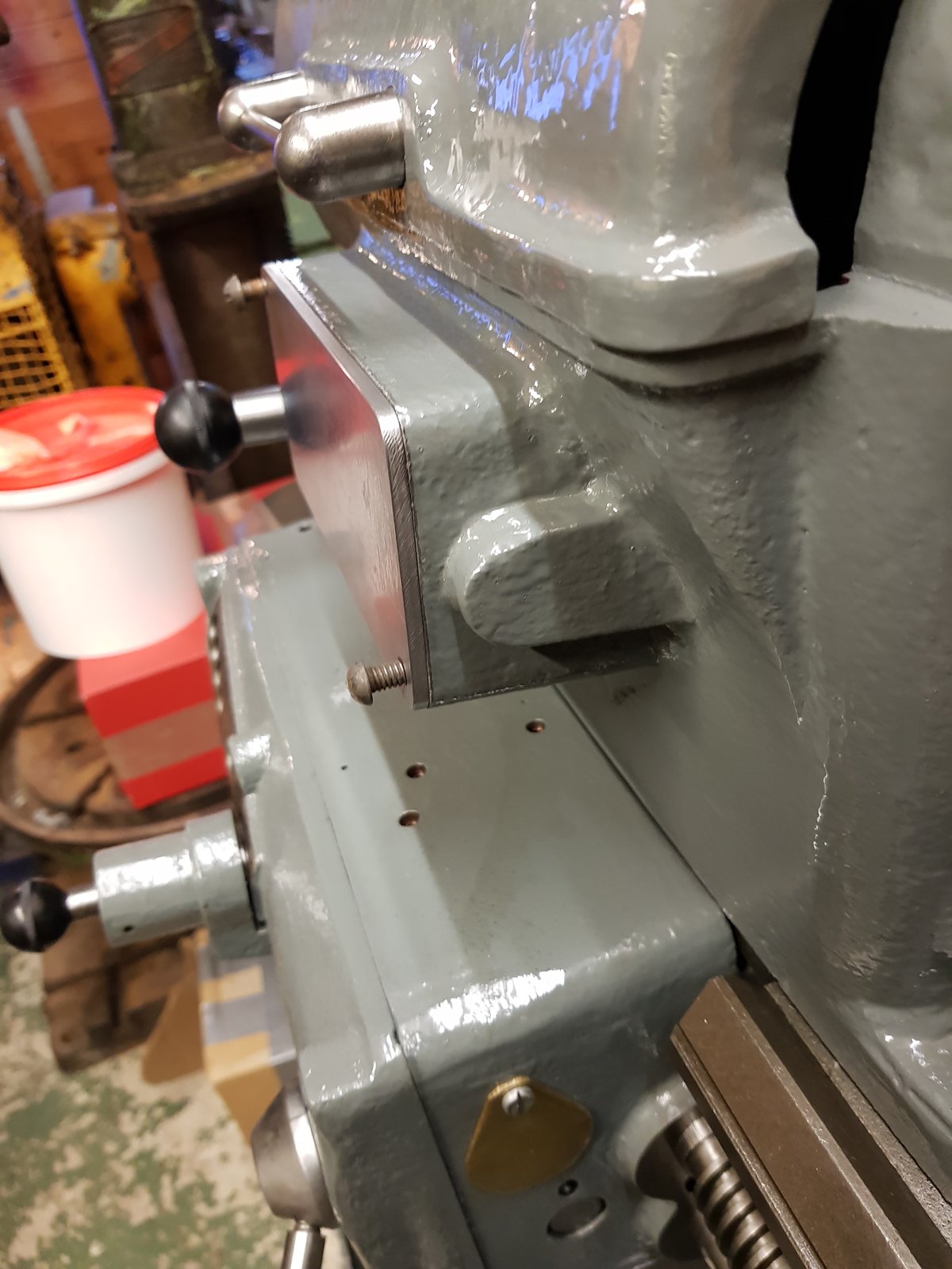

If you cut a radius in the steps it will be a whole lot easier to use, you just loosen the bolt and turn the plate to release it. With the huge steps you have in it now it will be a chore winding the nut up and down.
Or you could put it in a 4-jaw and cut the radius both ways in your lathe.
