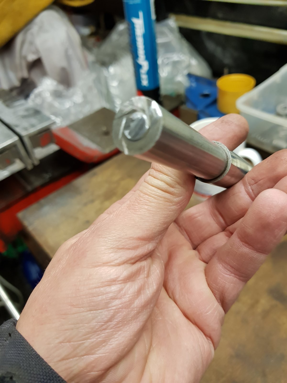

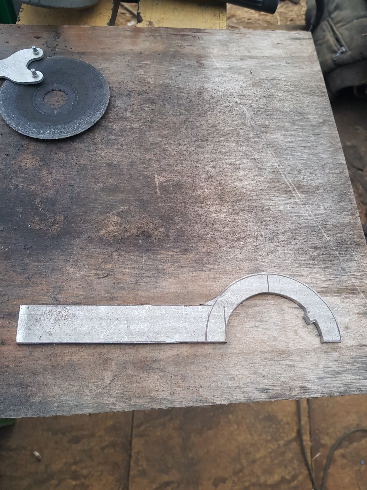

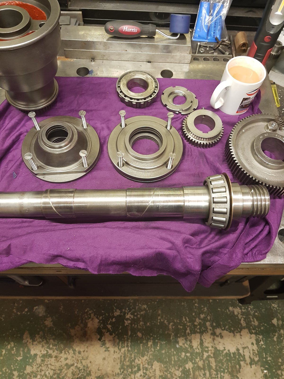

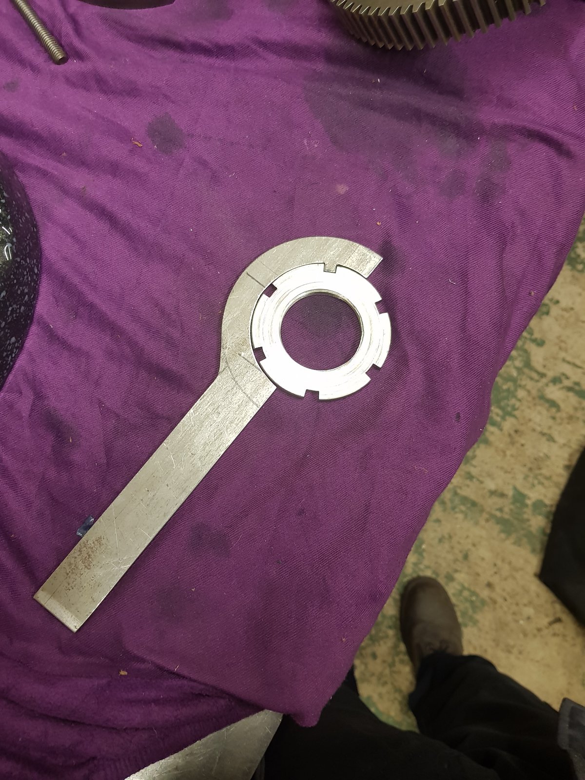

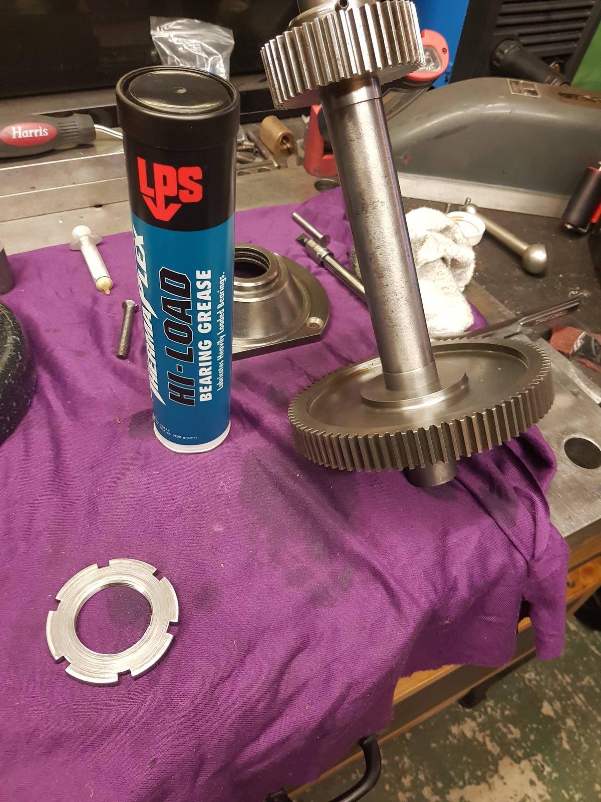

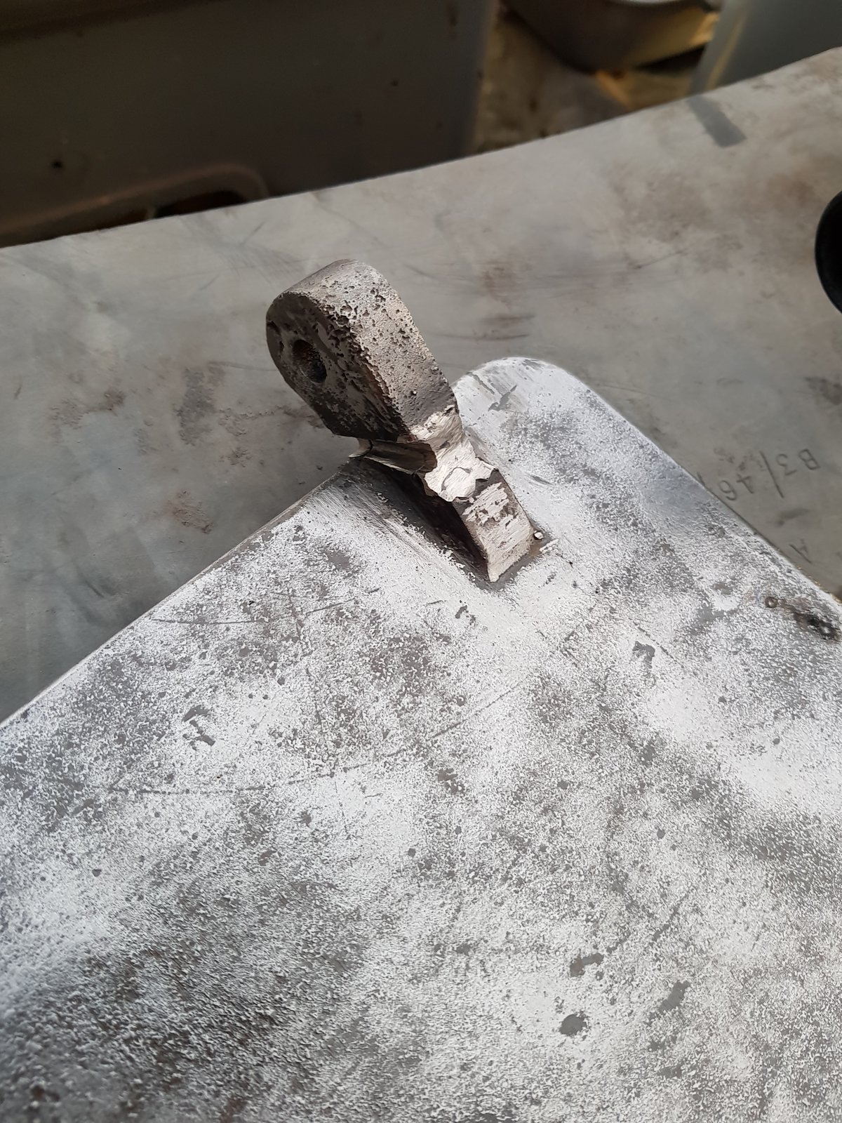

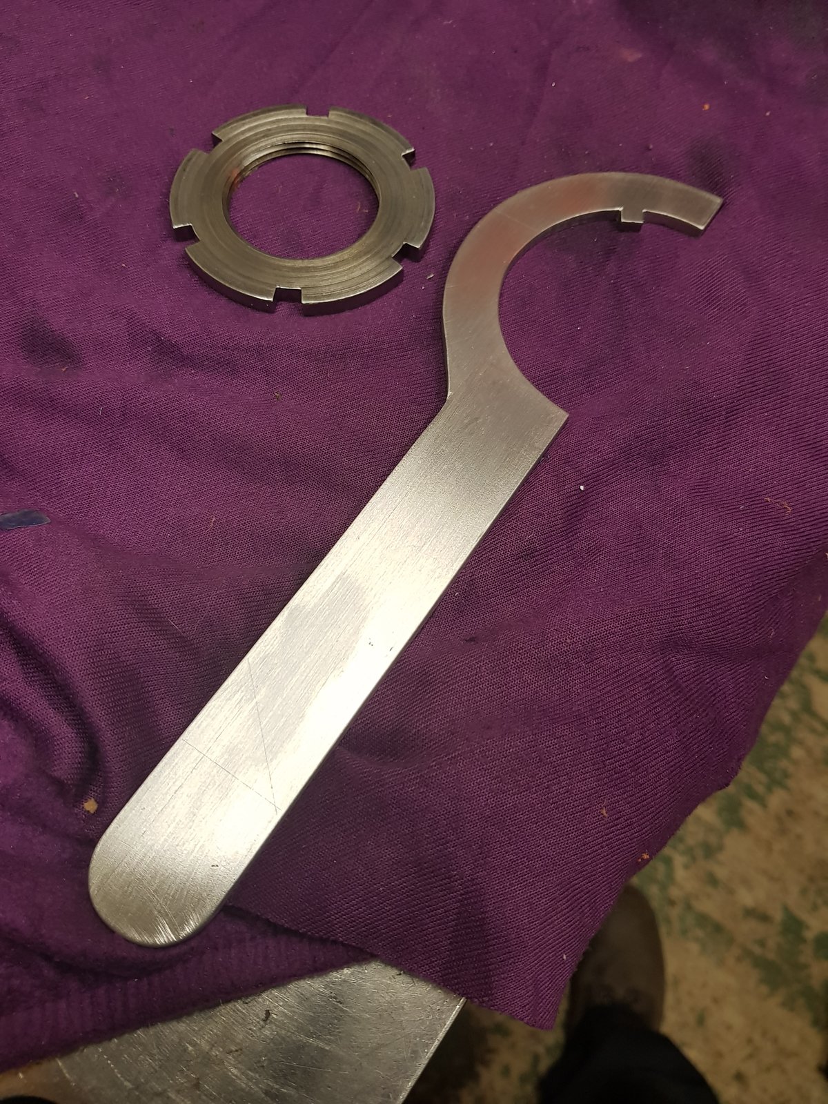

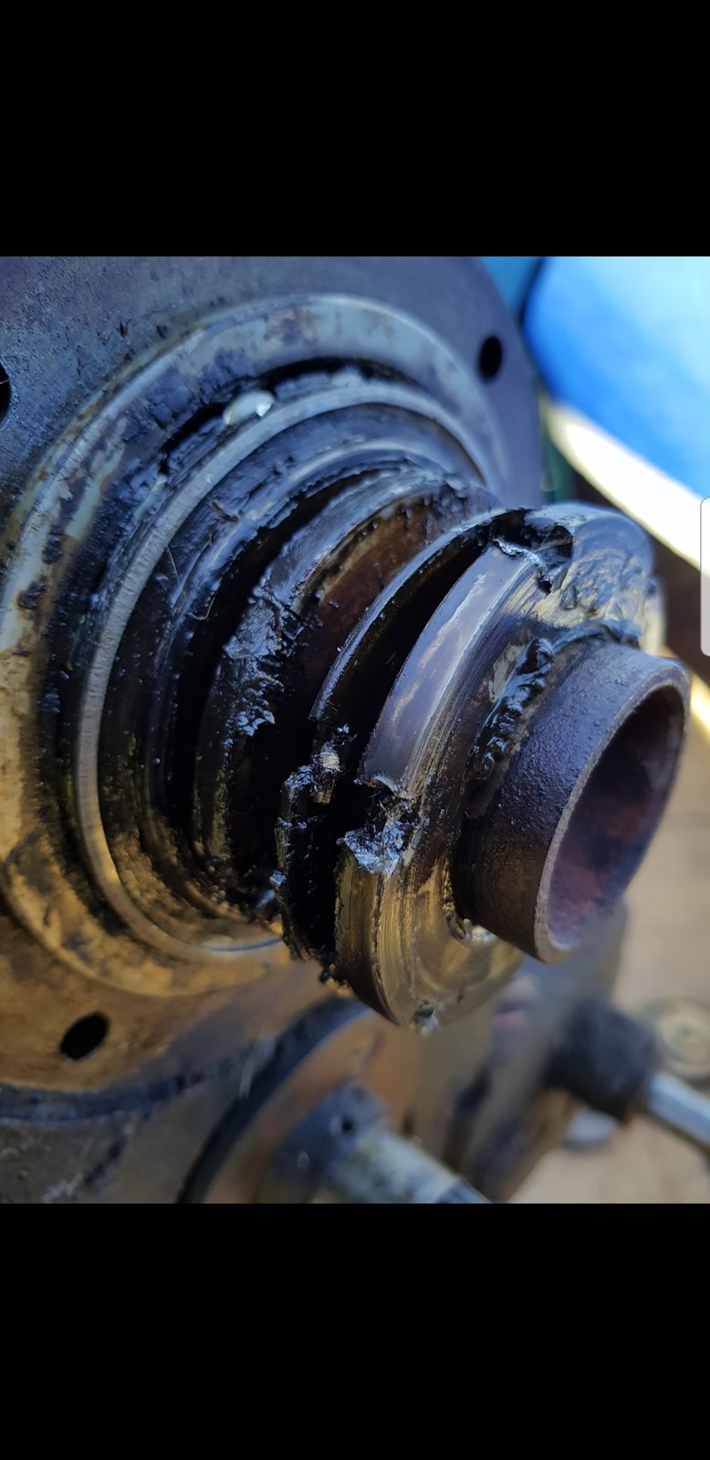

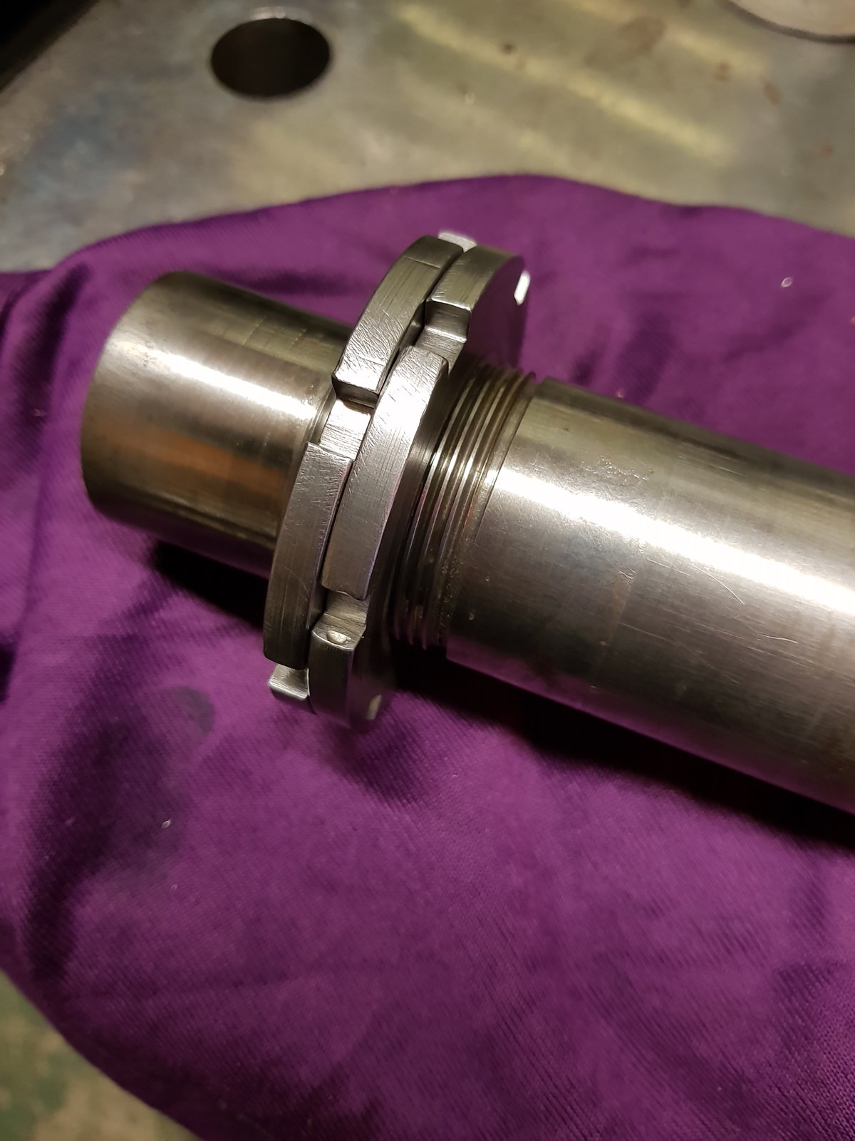

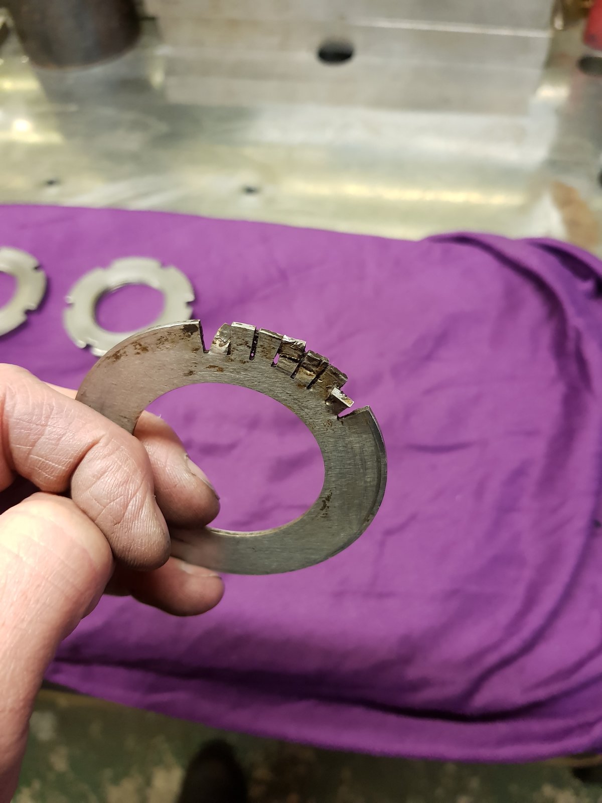

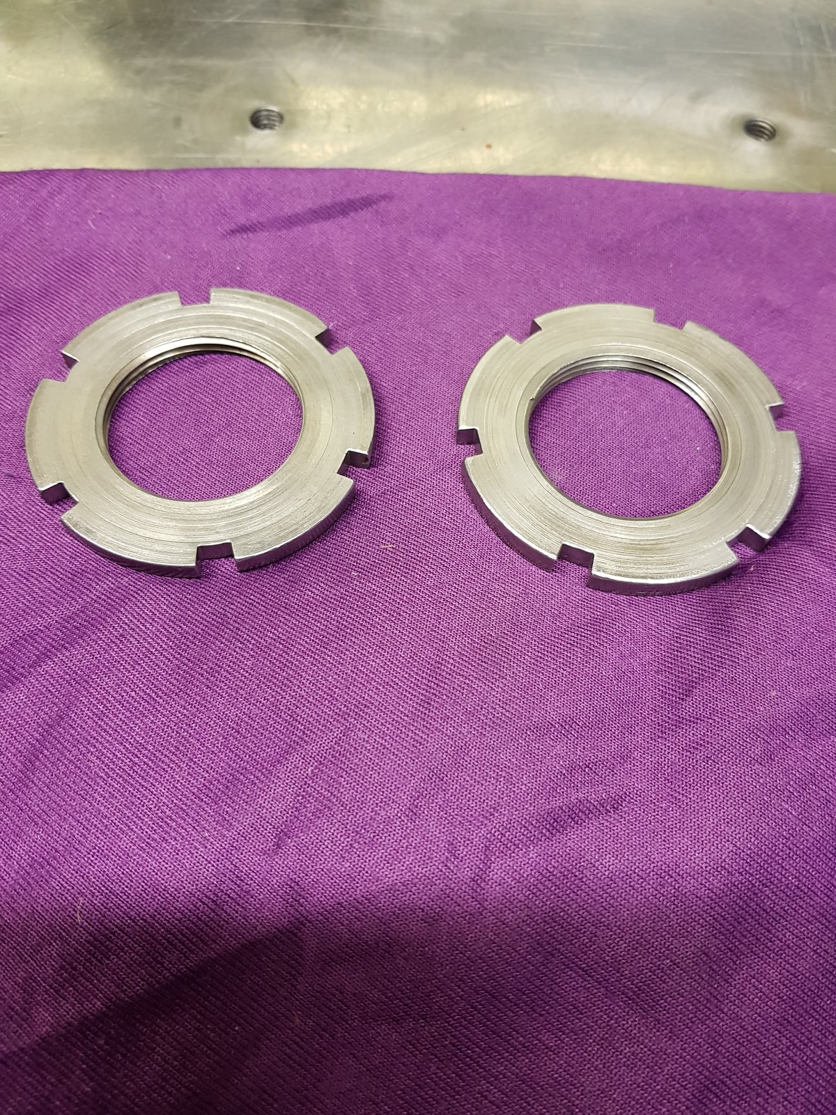

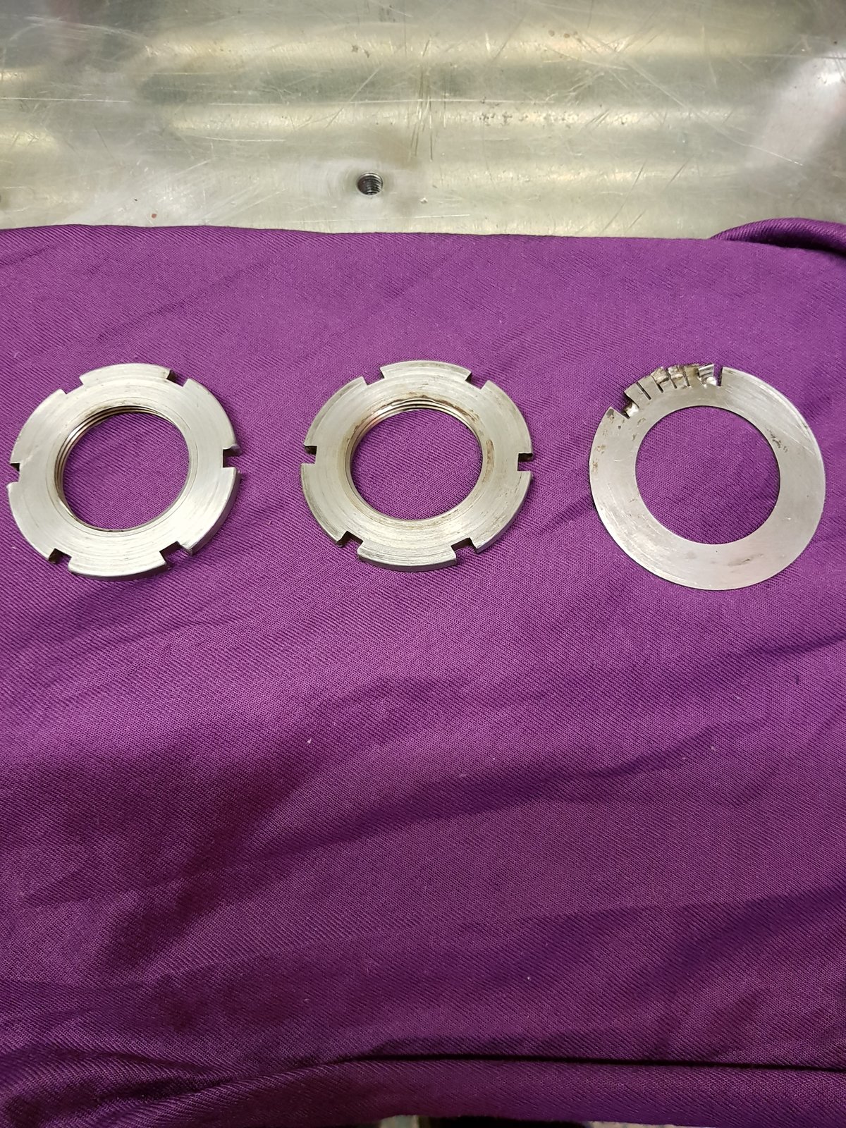

Should there be a lock washer? Looks like the locking nuts on the steering stem and I have never seen one of them with a lock washer, the whole idea is the nuts lock against each other.Today my list is to clean up the spindle collars. These have had a hammer. Nothing a good file session can't sort. And make a new locking washer. This was someone's vain attempt to lock both collars together. Why I don't know. Will figure out a different idea to that. I will also make a tool that fits the slots on the collars properly. View attachment 170780 View attachment 170781 View attachment 170782
