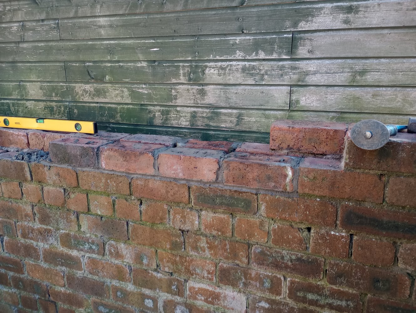

Pointing looks eroded. Was the wall built in lime? Lime is a handy system that keeps the bricks dry and reduces spalling. You do need to repoint every 100 years but if you forget to do that then the bricks can be cleaned up and used again. You can get NHL 3.5 from builders merchants. Shame to ruin it with more cement.

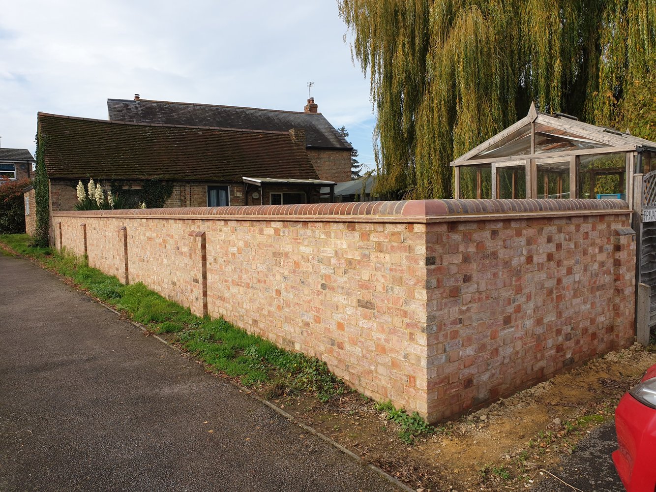

I built my own wall (another 10K quote). That took ages.
Nice wall mate...
