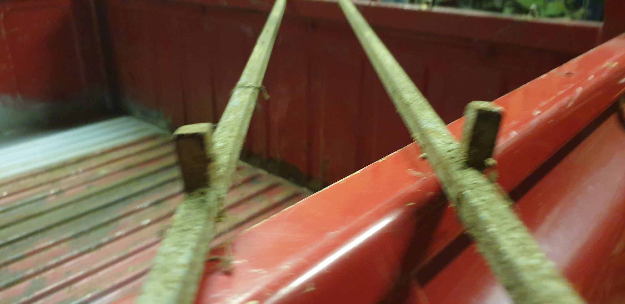

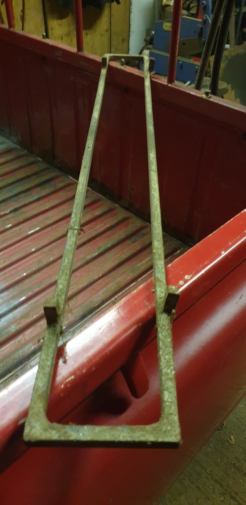

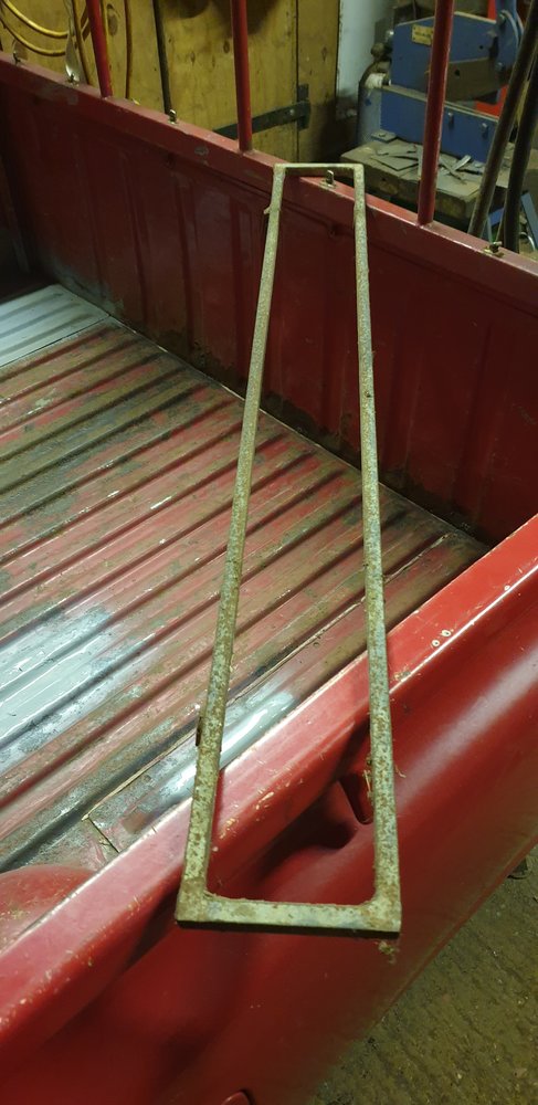

when a bricky puts the muck/ cement on the bricks he will then levelish it before he puts the bricks on to aid father and myself to keep a constant gap between each layer of brick father made a a 12 mm oblong frame I think it about a metre long and the width of a brick . you then place the frame on the row of brick put in some muck/cement level it using the top of the frame as a guide remove the frame and put on the bricks give them a gentle tap and repeat the next number of bricks if I remember I will get a pick of it tomorrowWhat's a muck frame?
