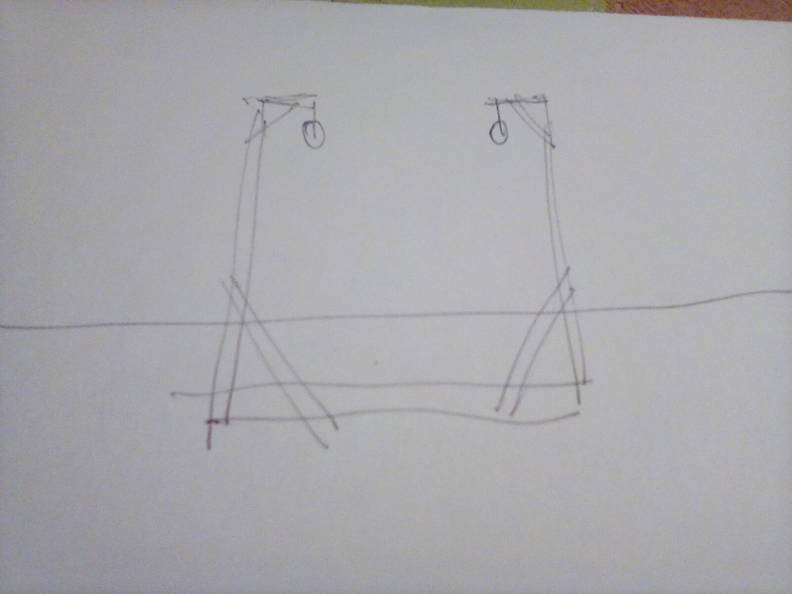

Having worked in a boat yard for many years I have lifted quite a few boats.But you dont know the whole reason why i want to do it. aswell as a project its more than that kida. If you want to safely and quickly lift a boat this is easier and quicker or boat yards would just use blocks etc
If you do not want cross beams, to stop the two uprights meeting each other under load, do you have enough room for guy lines even if installed only when lifting?
If it is only for this specific boat, concrete in a steel socket a lot closer to the hull and only install the uprights when you want to lift something. That way, the uprights do not need to cope with as much bending stress caused by the 1m overhang.
One winch each end with a couple of jockey pulleys is cheaper than two winches each end and means you only have to control two items, not four, to ensure it lifts level.

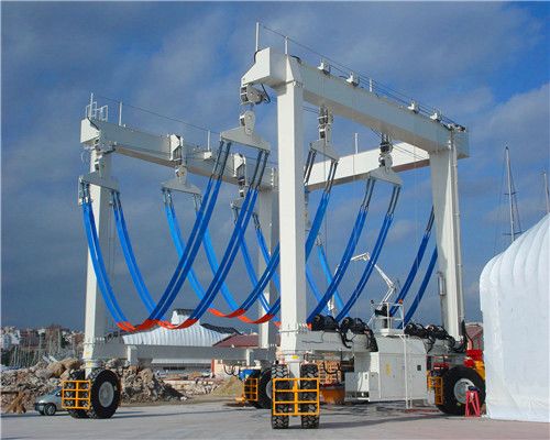

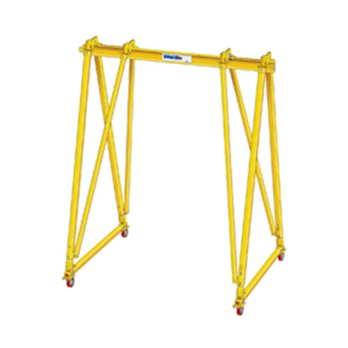

Although an overhead gantry crane / frame is a cracking idea.
Don't reinvent the wheel, copy existent ideas...
Really can't comment on the depth of foundations, depends on how solid your ground is I guess?I have one and sods law it a wee bit to narrow lol, i was going to make another to match.
I thought it wasnt a new idea, only difference i can see is it fixed and not mobile. So my only concern was how deep for the foundations for the uprights. Which yet nobody has said how big they need to be.
that depends on if your in to solid clay for how far down. you could weld some t pieces on the bottom to stop any rotation of the poles pulling in and widen the trenchI have one and sods law it a wee bit to narrow lol, i was going to make another to match.
Ok idea, use removeable top cross members, reason i dont want the uprights so high is it is forward of the house front line.
So what size cross member ?
a scaffie pole
