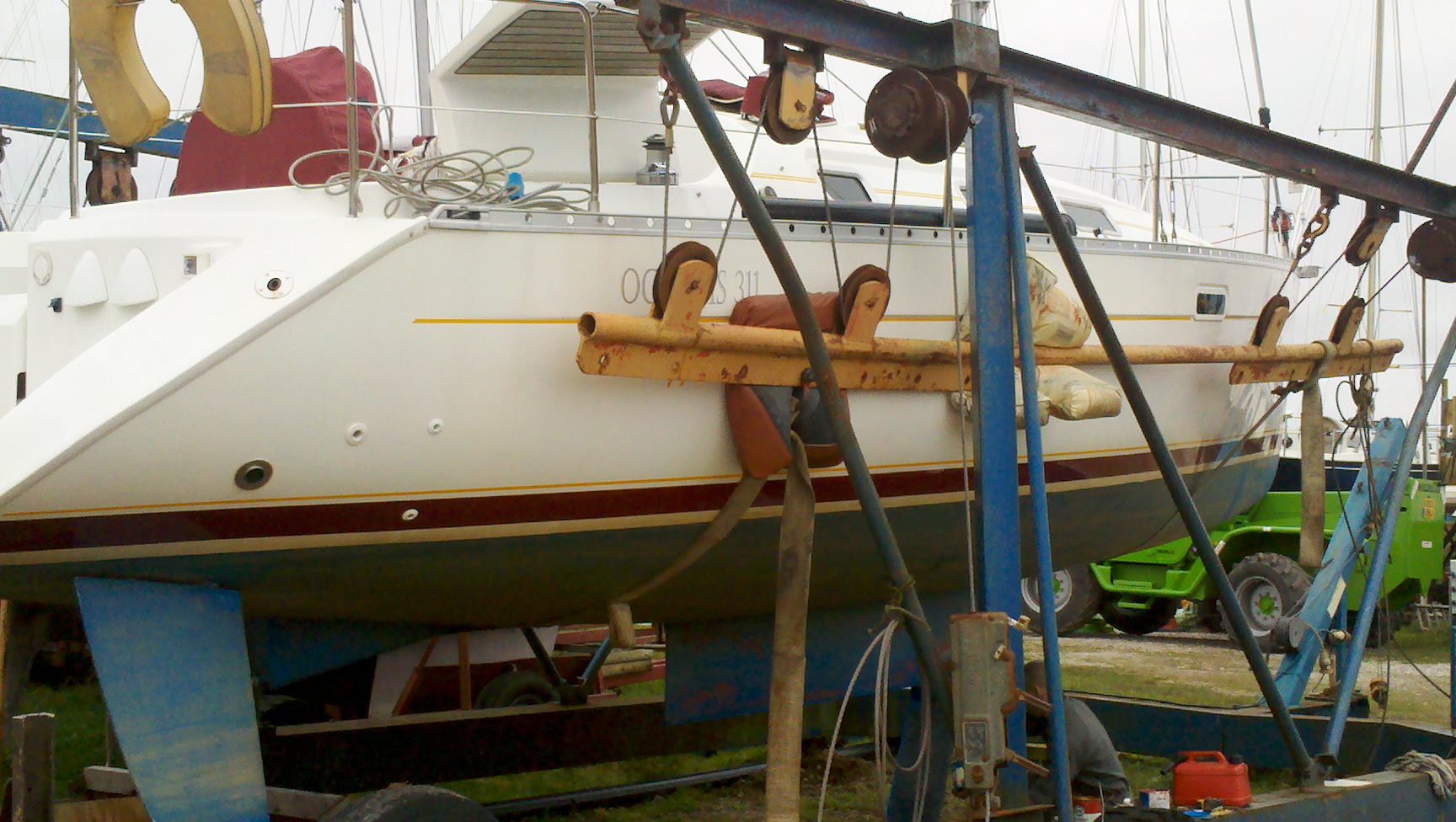

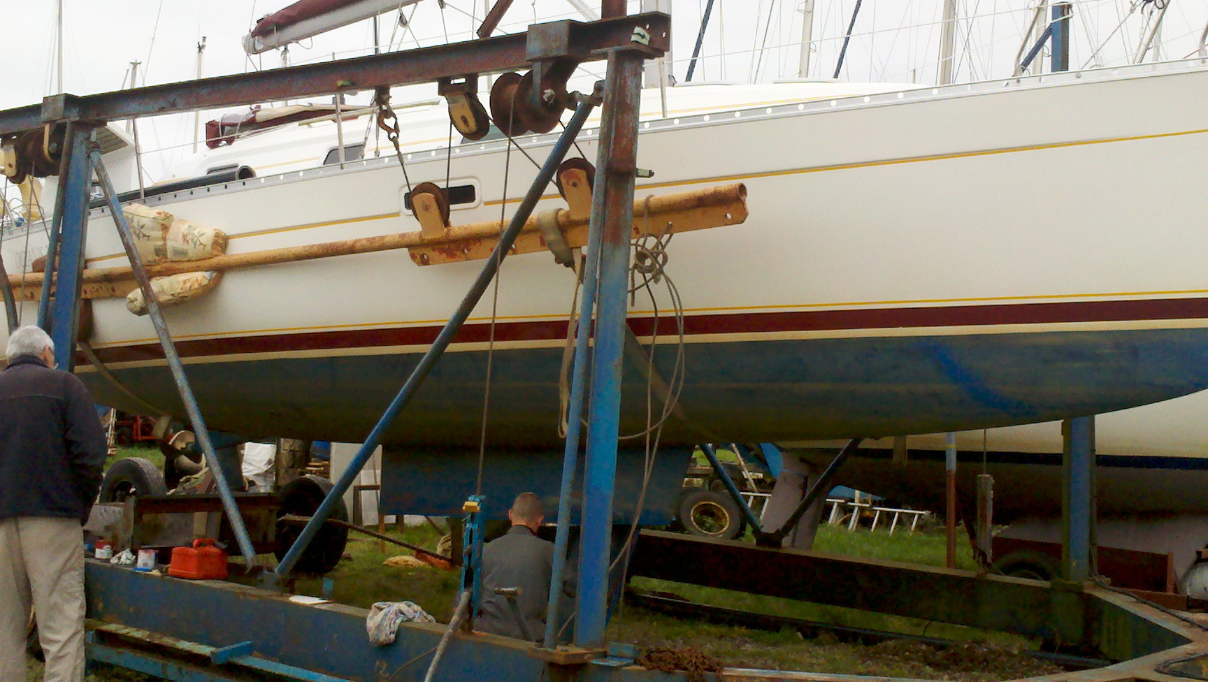

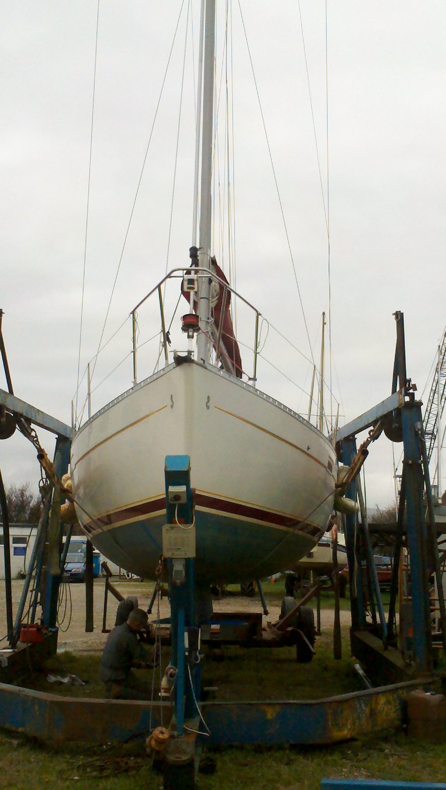

If you do not want cross beams, to stop the two uprights meeting each other under load, do you have enough room for guy lines even if installed only when lifting?
If it is only for this specific boat, concrete in a steel socket a lot closer to the hull and only install the uprights when you want to lift something. That way, the uprights do not need to cope with as much bending stress caused by the 1m overhang.
One winch each end with a couple of jockey pulleys is cheaper than two winches each end and means you only have to control two items, not four, to ensure it lifts level.
no room for side supports of cable or beam. an dyes like the pulley idea, ill take that one
