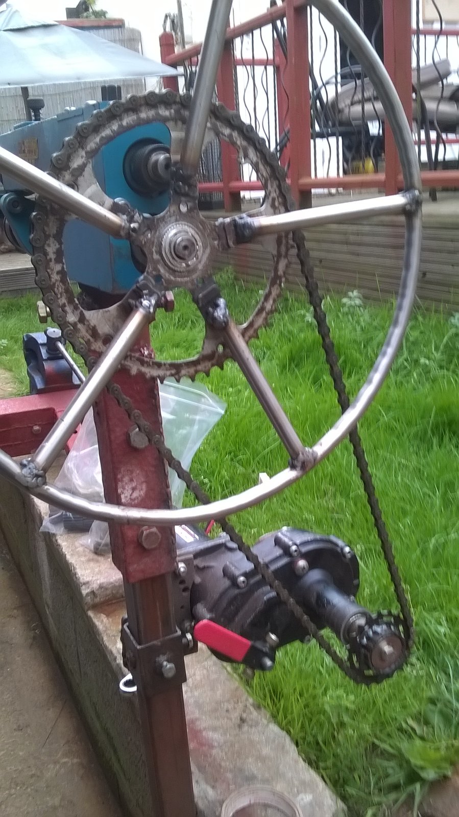

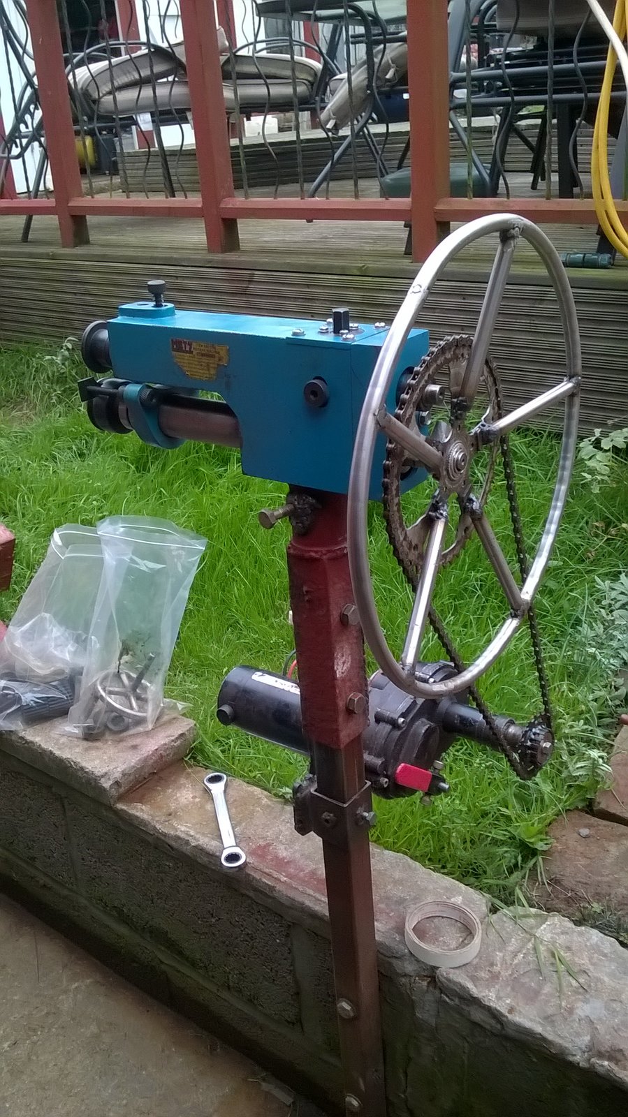

The WNS frame is 8 to10mm thicker than some of the others No grease nipples so expect no bushings (steel to steel) note it also appears to have peg drive formers as well
I am always surprised how much forming tools move about The Edwards wheeling machine cast frame would spring if you just tightened the roller a fraction so think even the WNS frame at 25mm will move.
Bit of a steep up lift-for the heavier frame then + VAT & delivery
