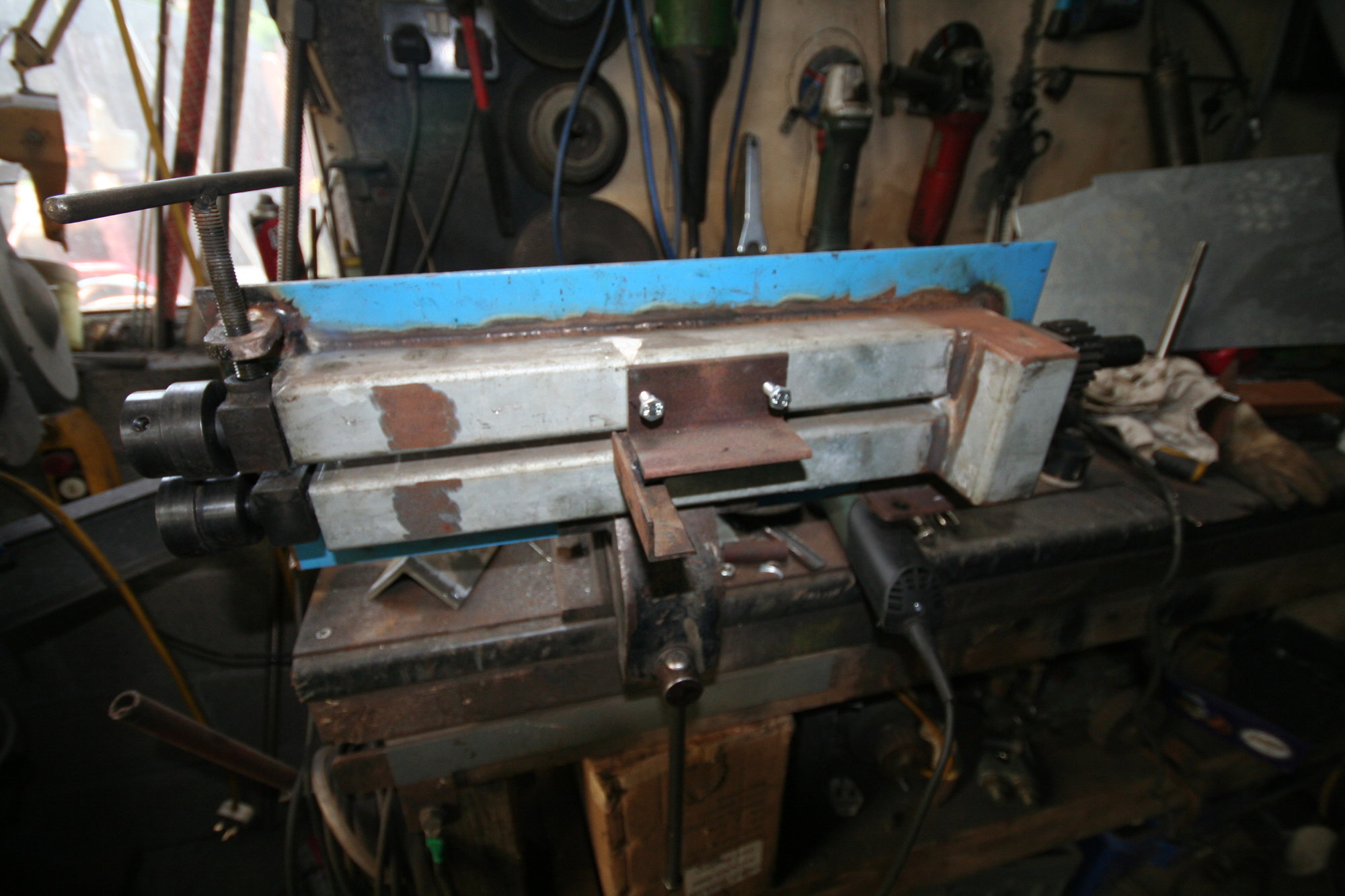

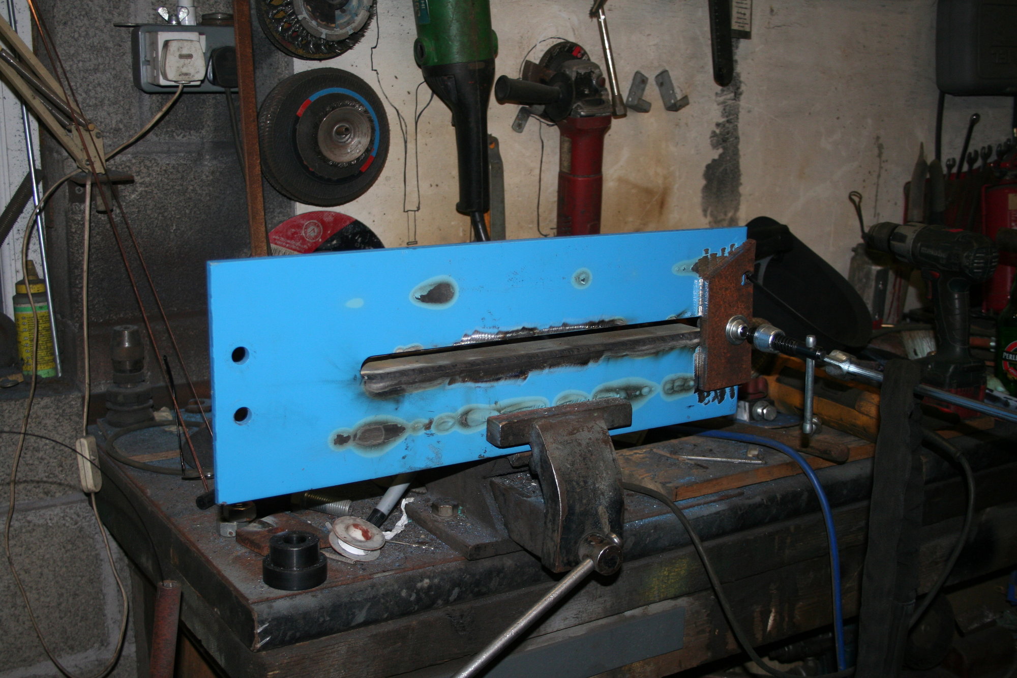

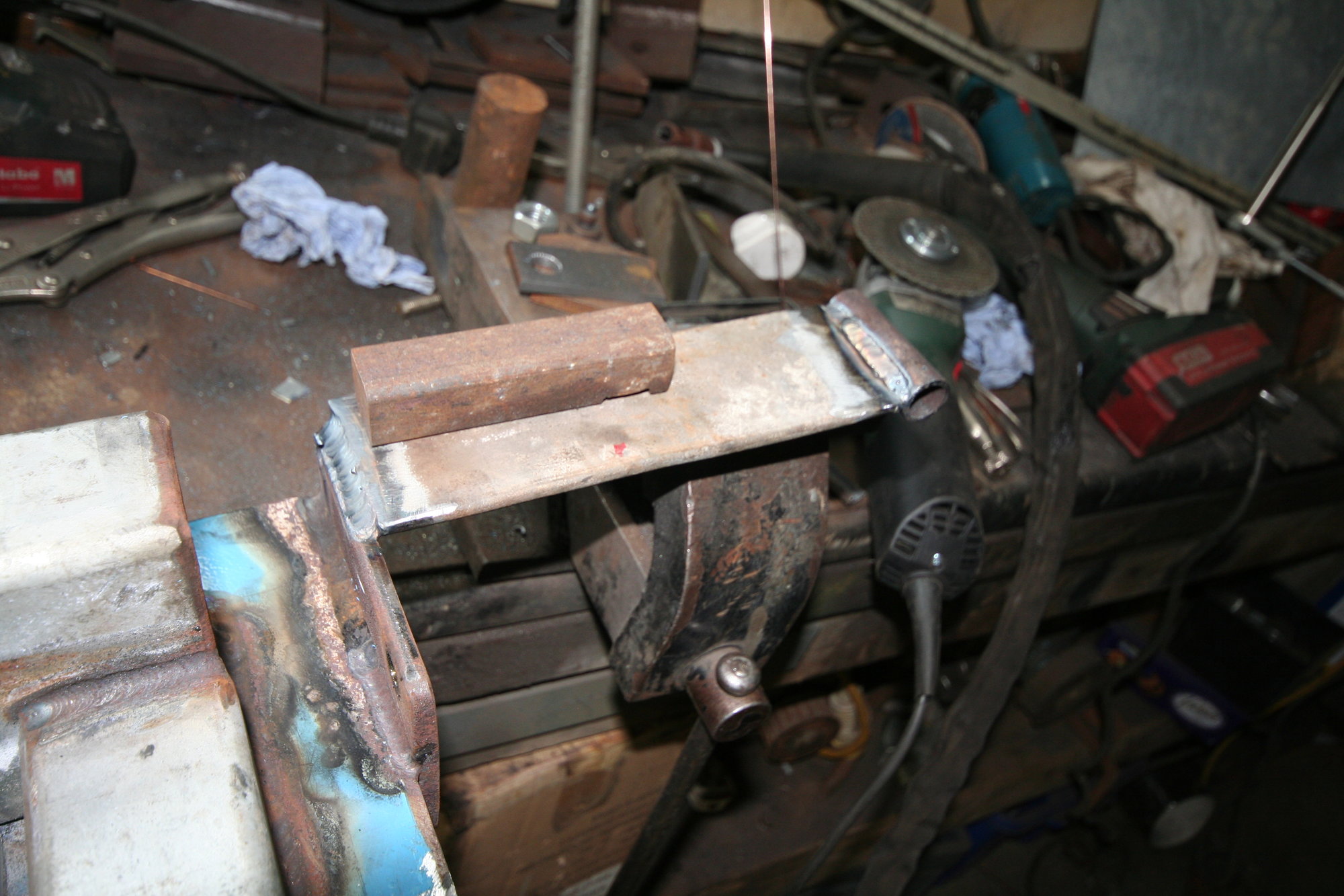

    This is my take on modifying a cheap Metz Chinese bead roller
    There is a lot of chat on the net on how crap Chinese tools in general are and this bead roller in particular is, but I think they can be quite remarkable value for money and opens up specialist tool ownership to the DIY market.
    I think I payed £85 for it on the bay of thieves.
    The frame is pretty useless but there is no way you could make the gears and rollers for the money and the lack of substance to the frame gives unlimited scope for modifications without having to remove any stiffening (as there isn't any).
    I did not try it out straight out of the box as that seemed pointless (the two rollers could be flexed more than an inch by hand without any bother) but I could see the potential.

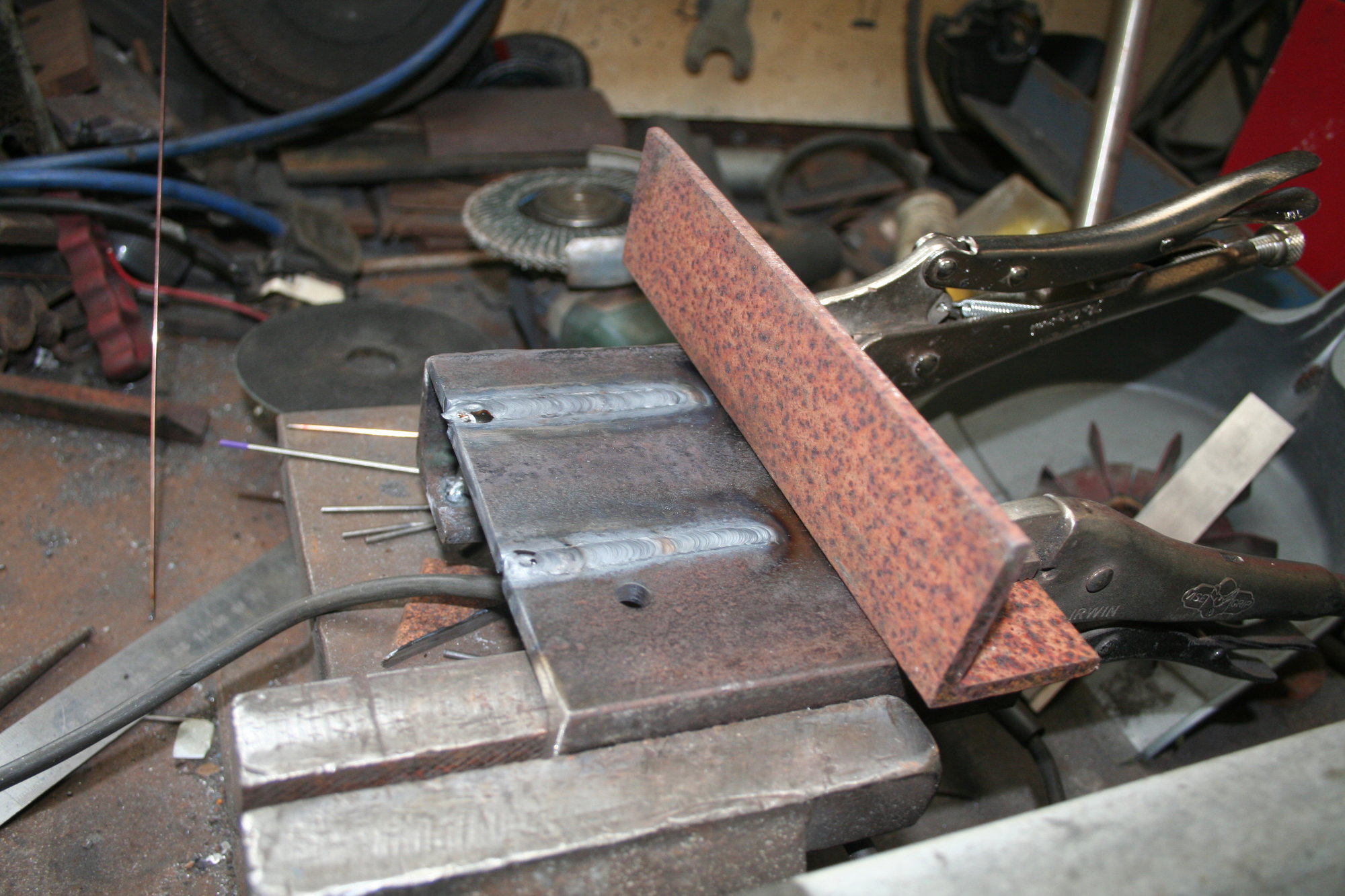

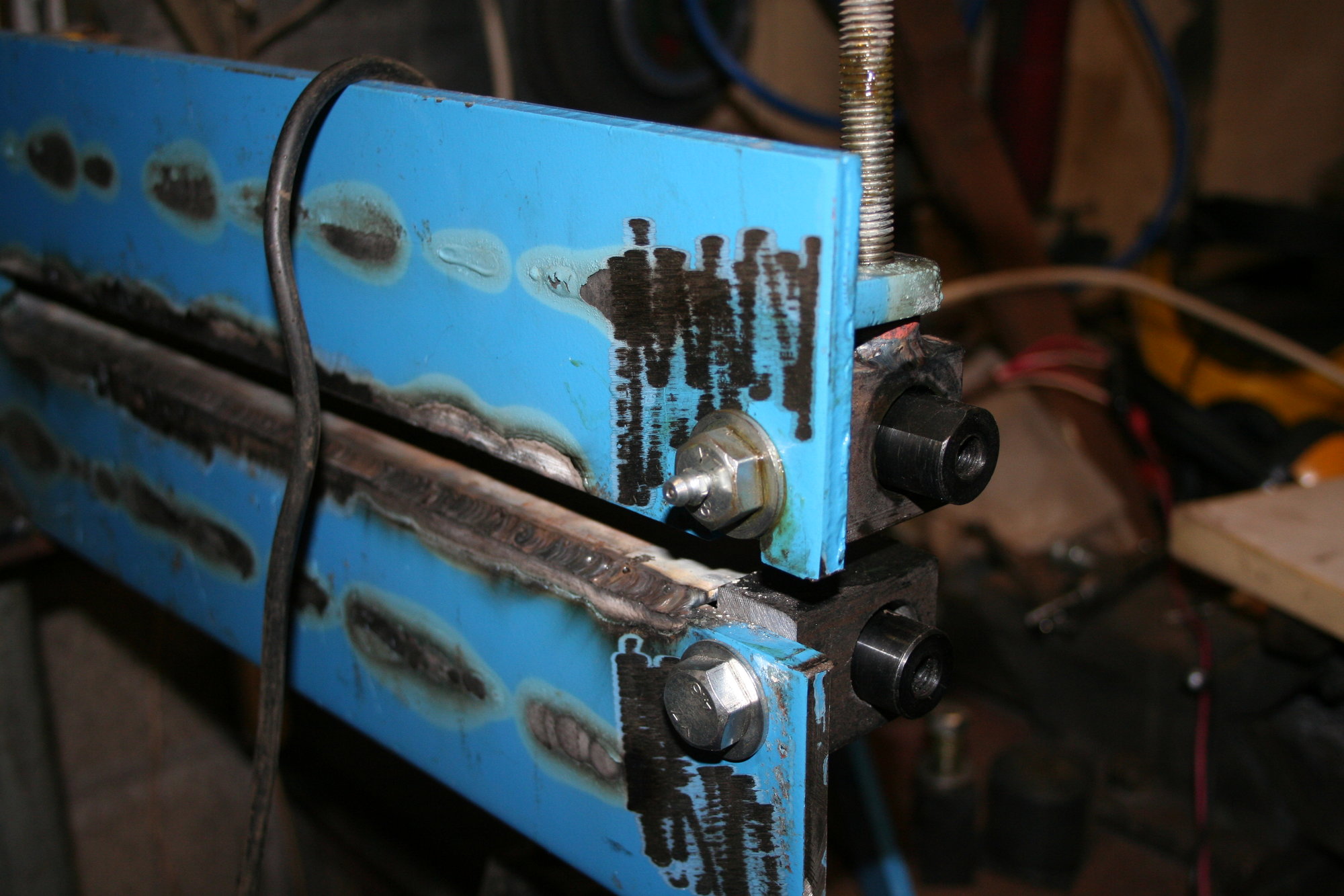

    For the mods I just used whatever scrap and off cuts I had laying about (don't we all?) and found a piece of 4" x 2" galvanized thin wall box that could be used for most of the strengthening mods.

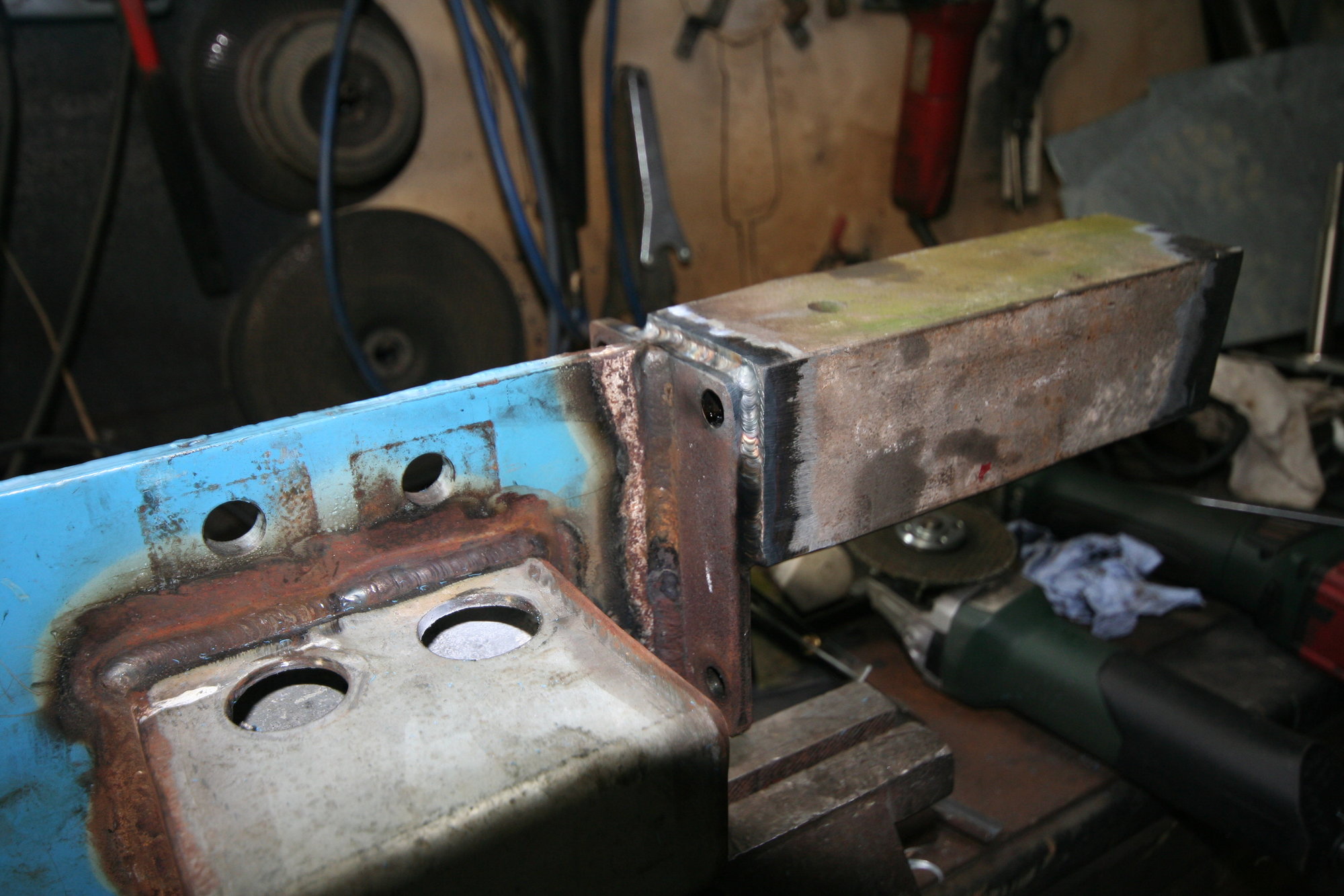

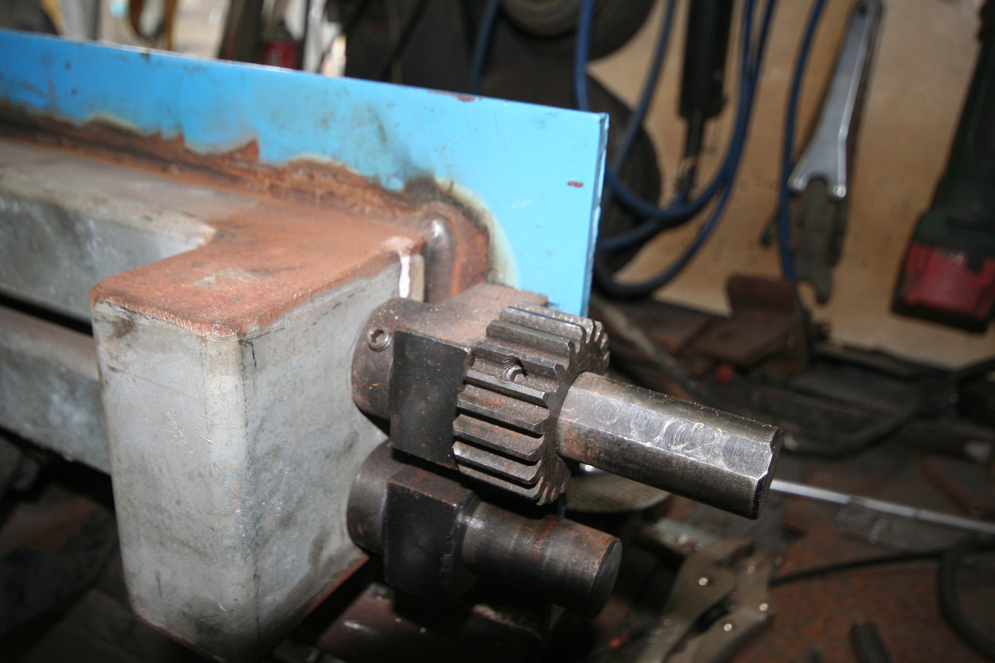

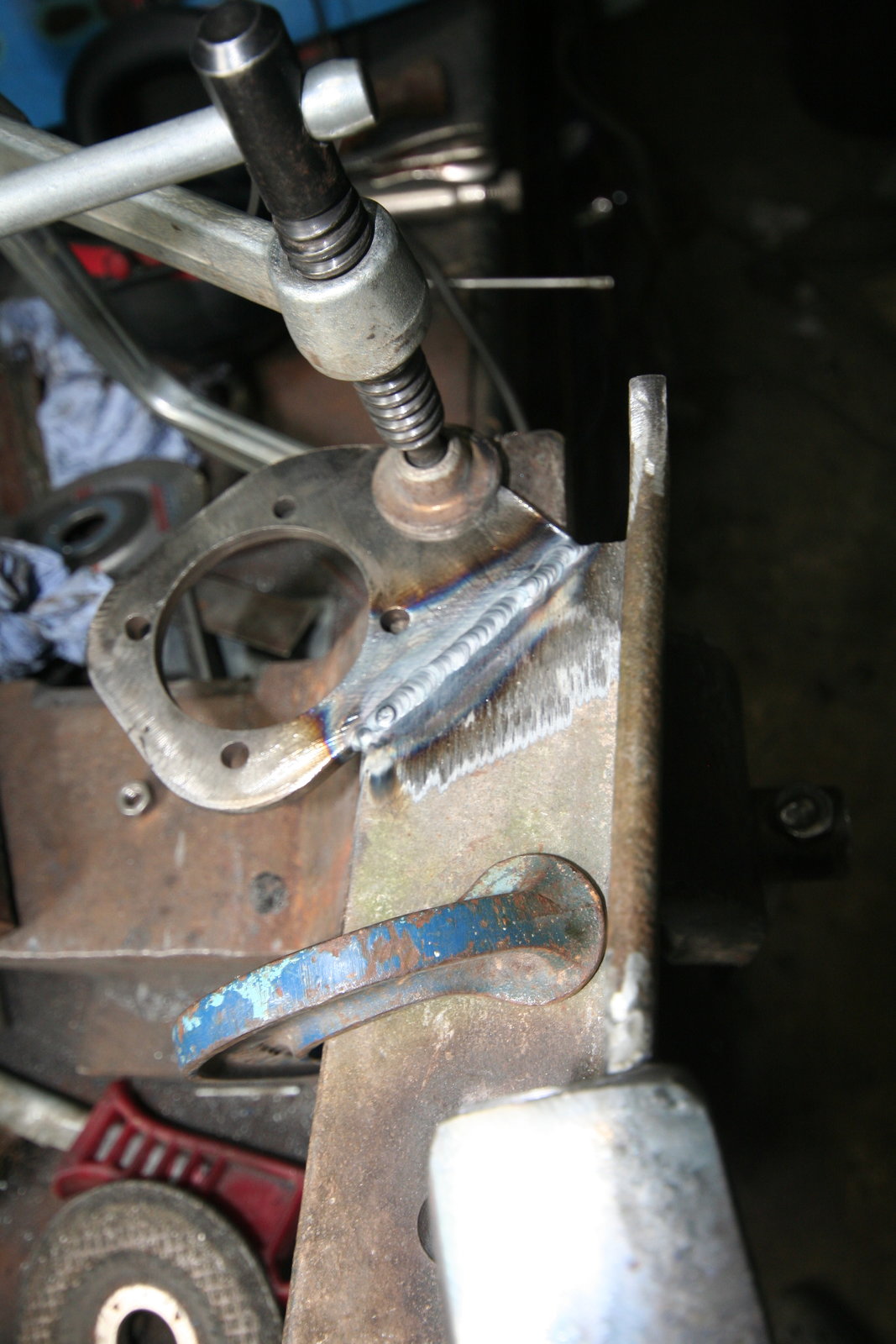

    I wanted to keep the dimensions of the roller as neat as possible so decided to cut the box in half (long ways) and installed each half over a roller drive bar.

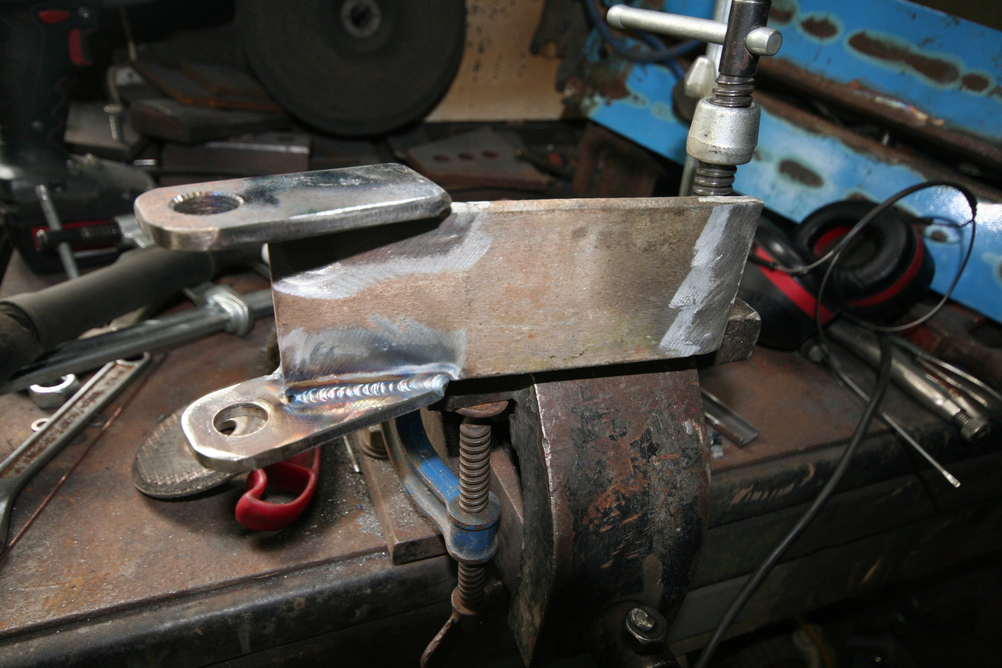

    To provide a moment connection between the two now 2" x 2" bits of box I welded a section of 2" x 4" box with holes drilled in it to allow the roller drive bars to pass through.
    I used tig for the welding (and a lot more than necessary), as I'm trying to learn and I find making something is better practice than just laying down beads on scrap.
    I did grind off the galv before I started welding.
    Even without the health risks, its bad enough welding it with mig or stick but it's almost impossible if using tig.
    Sorry for the long-winded ramble to describe how I got to this

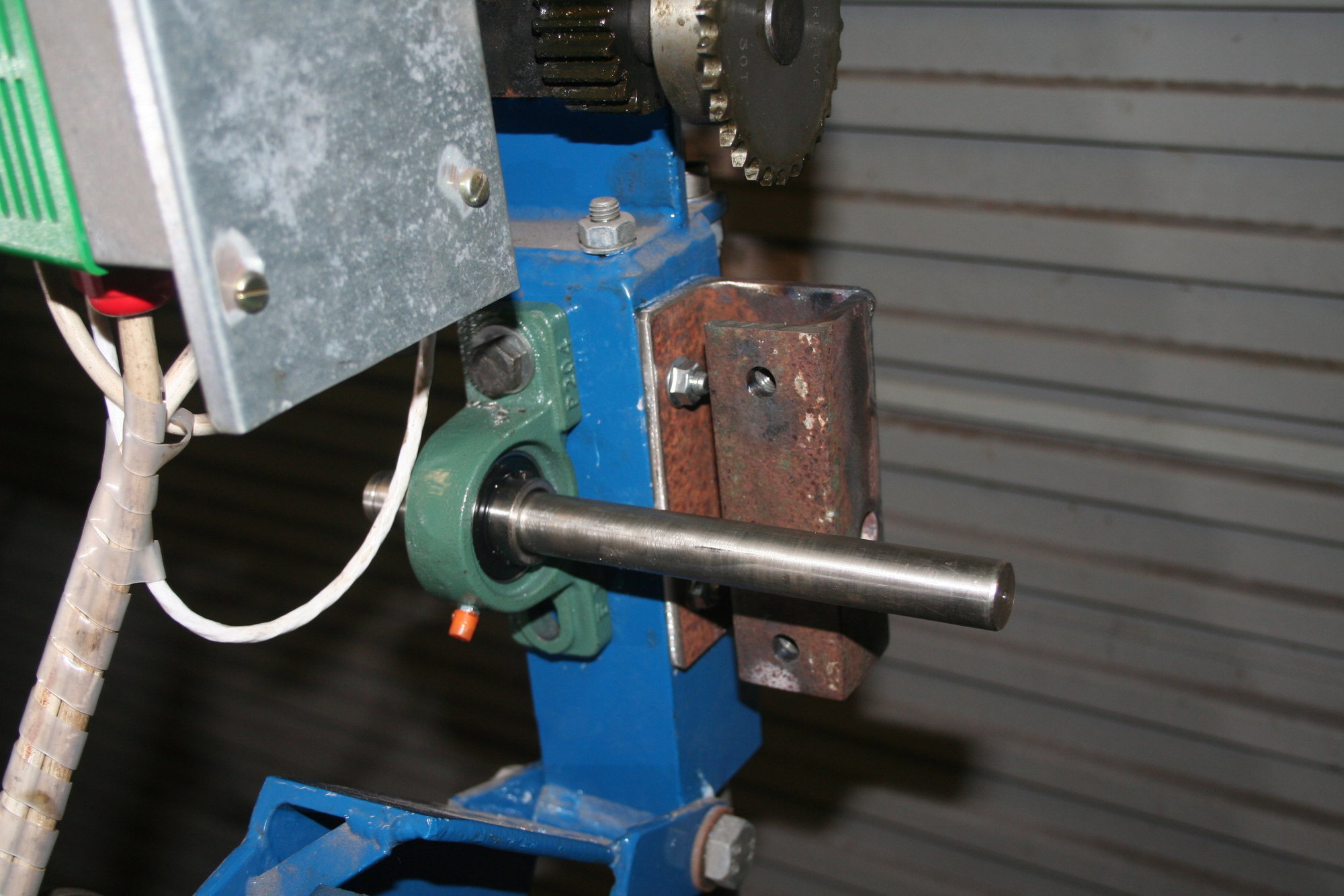

    I tried mine as it came, and then found it it was a bit flexible.
    you might also want to fit grease nipples on the shaft supports and I also tweaked it so that it would lift the bead roller too
    [​IMG]
    I used used 2" square tube stitch welded to it
    [​IMG]
    enclosing the shafts does look neater though, and what are the brackets on the middle for?

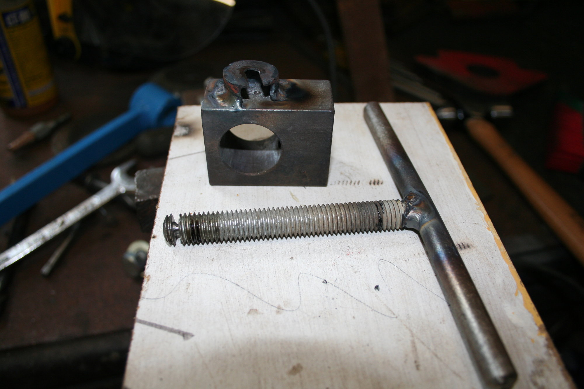

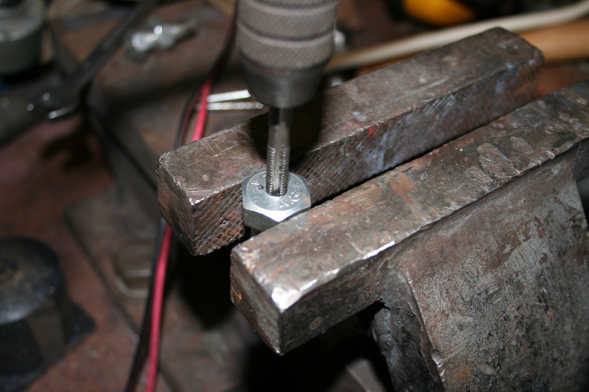

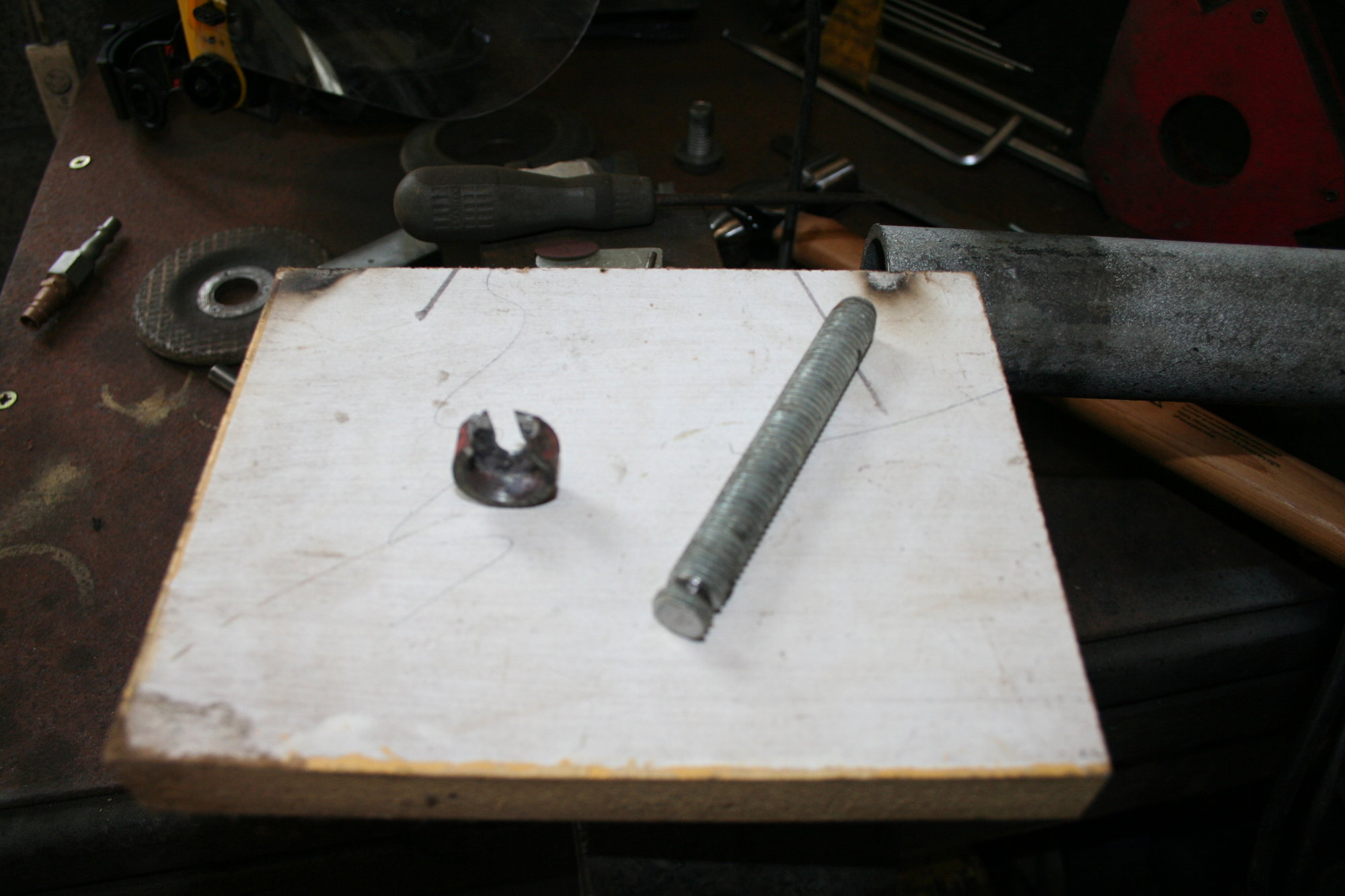

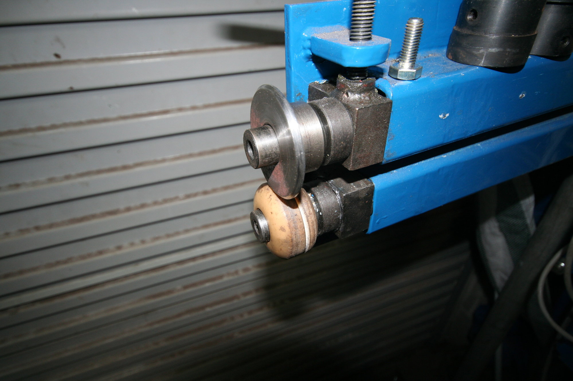

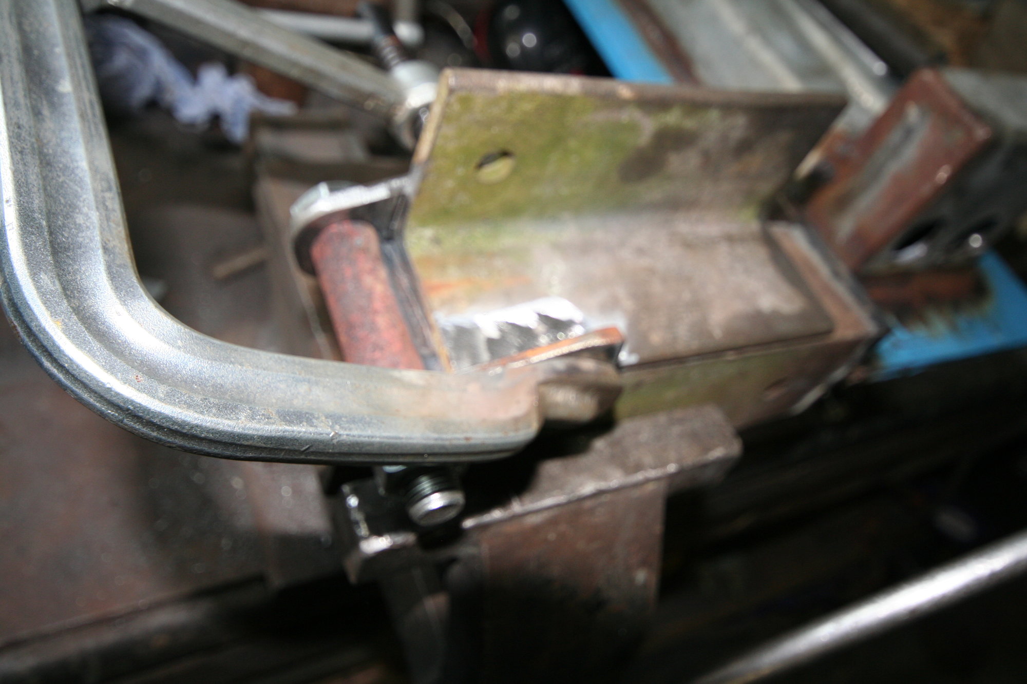

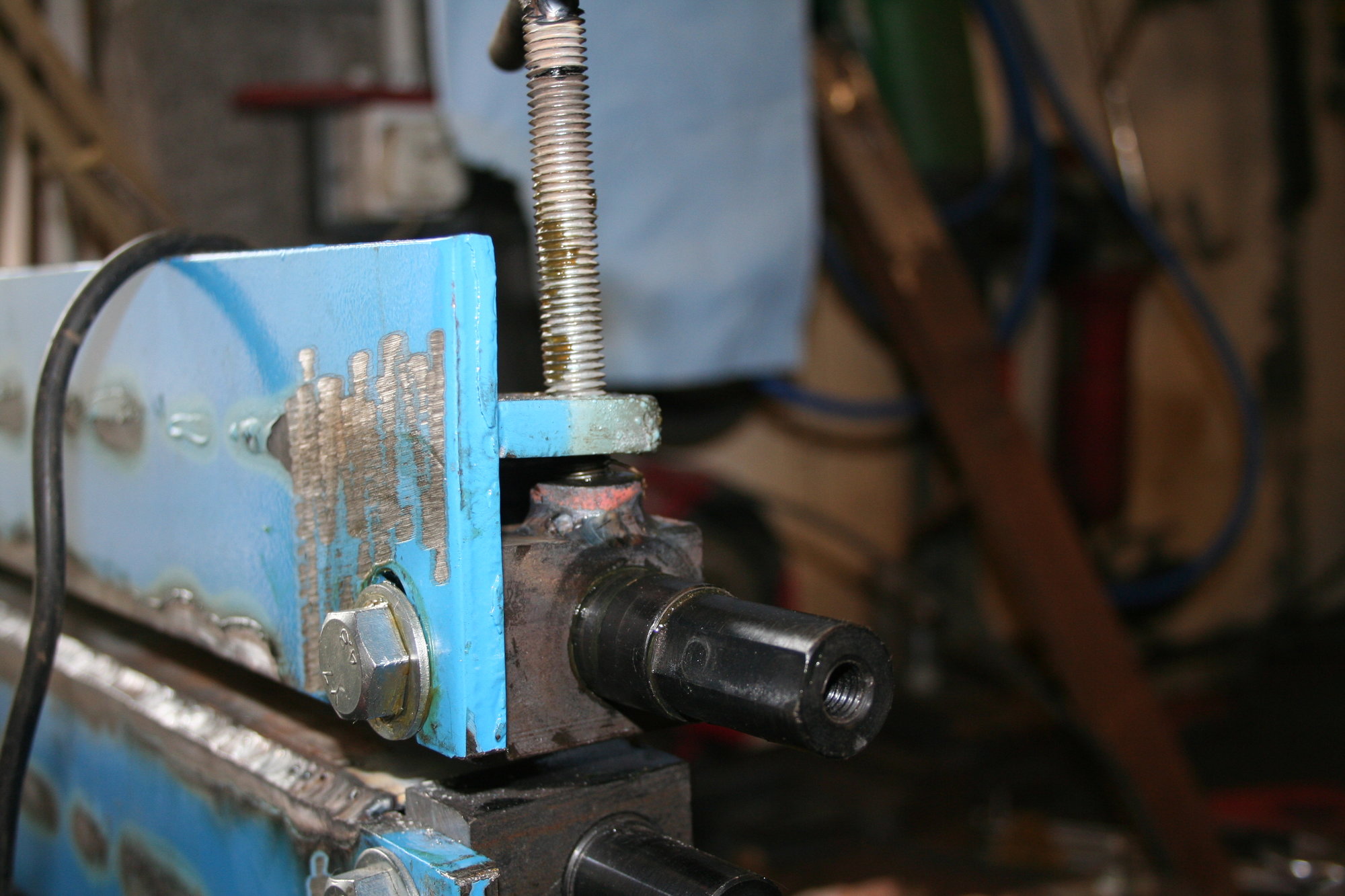

    Hi Optima, very similar approach and I also did install grease nipples and a way of moving the roller up and down. I drilled through the bolts and installed the grease nipples from that end.
    For lifting the top roller I took a similar approach to a G clamp cup and drilled and tapped the thread to M12
    The bracket in the middle is a guide that can be set and used if running multiple beads at different offsets.

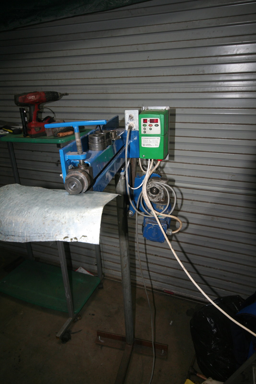

    With these mods the tool works really well but it's still a pain to operate because the handle is at the "wrong" end relative to the business end. (Sort of a function of the design)
    Most people seem to replace the supplied handle with a wheel but that's still just a partial solution.
    If you have help, it's not a problem but that's not a luxury I normally have (the kids or the better half always seem to have better things to do than to stand about in the garage) so another options was required.

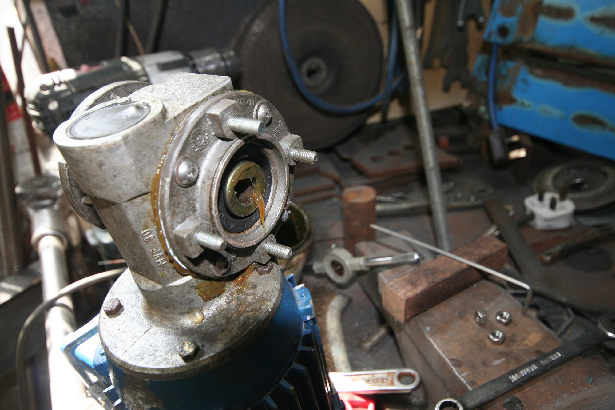

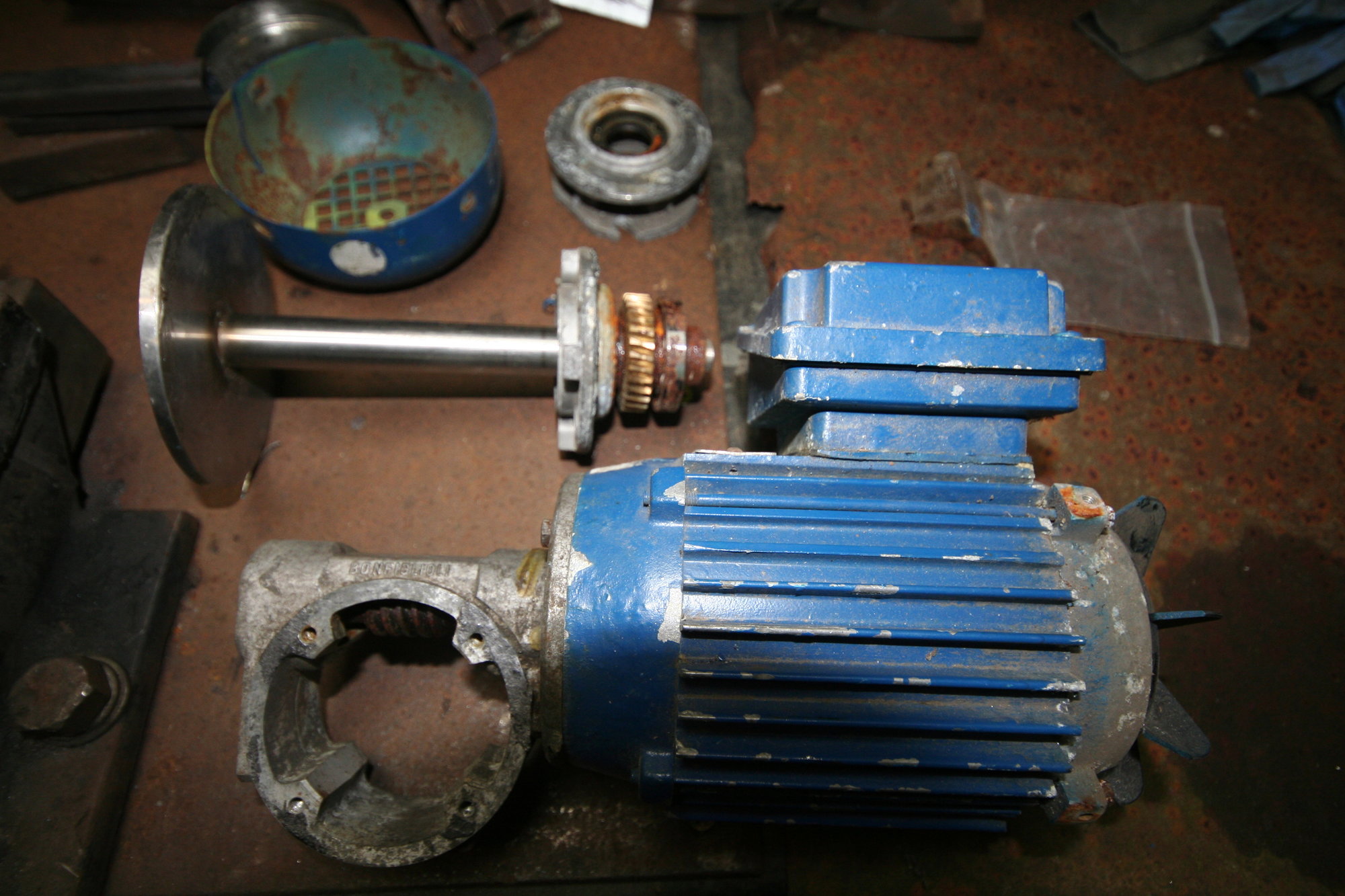

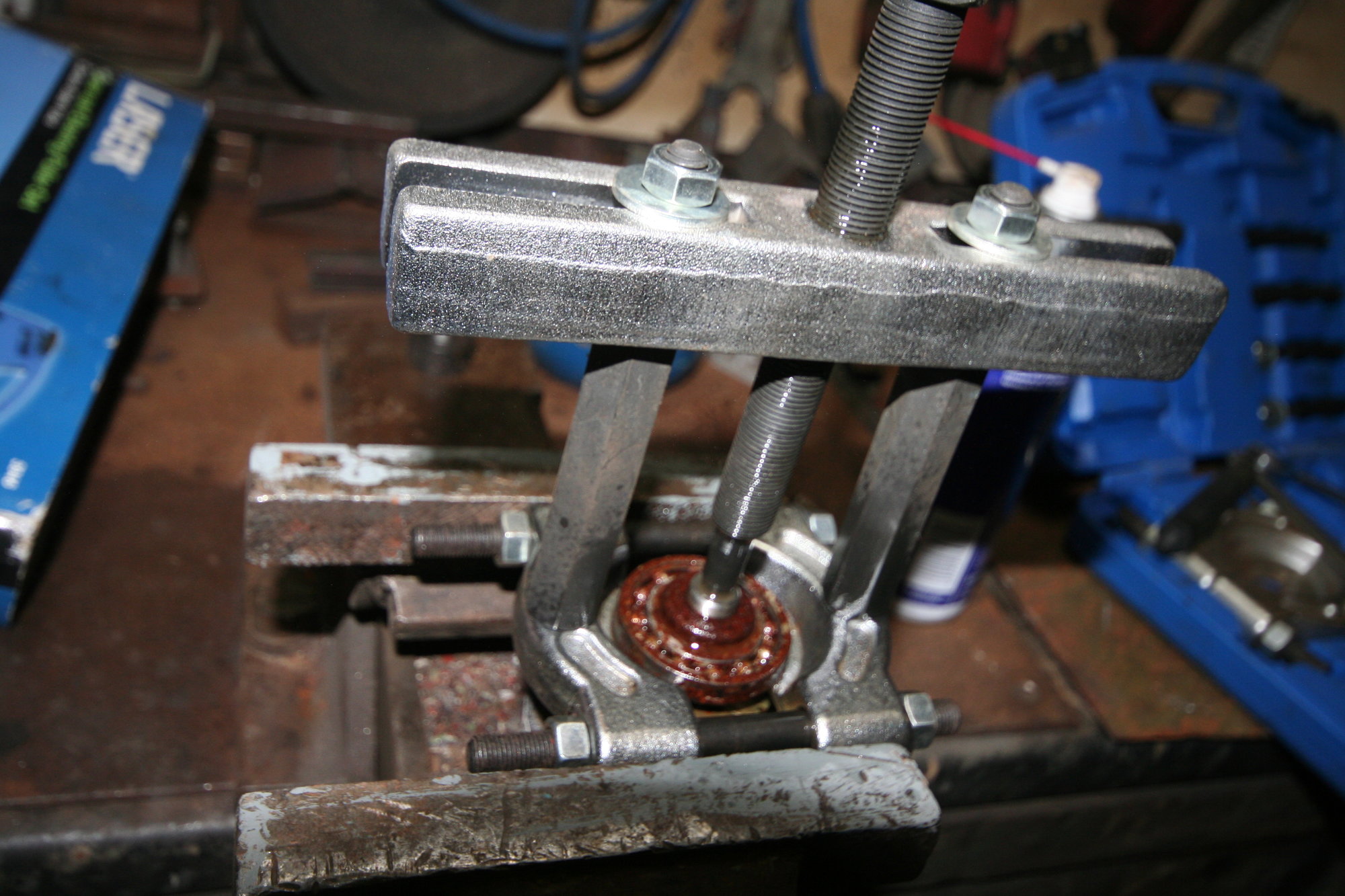

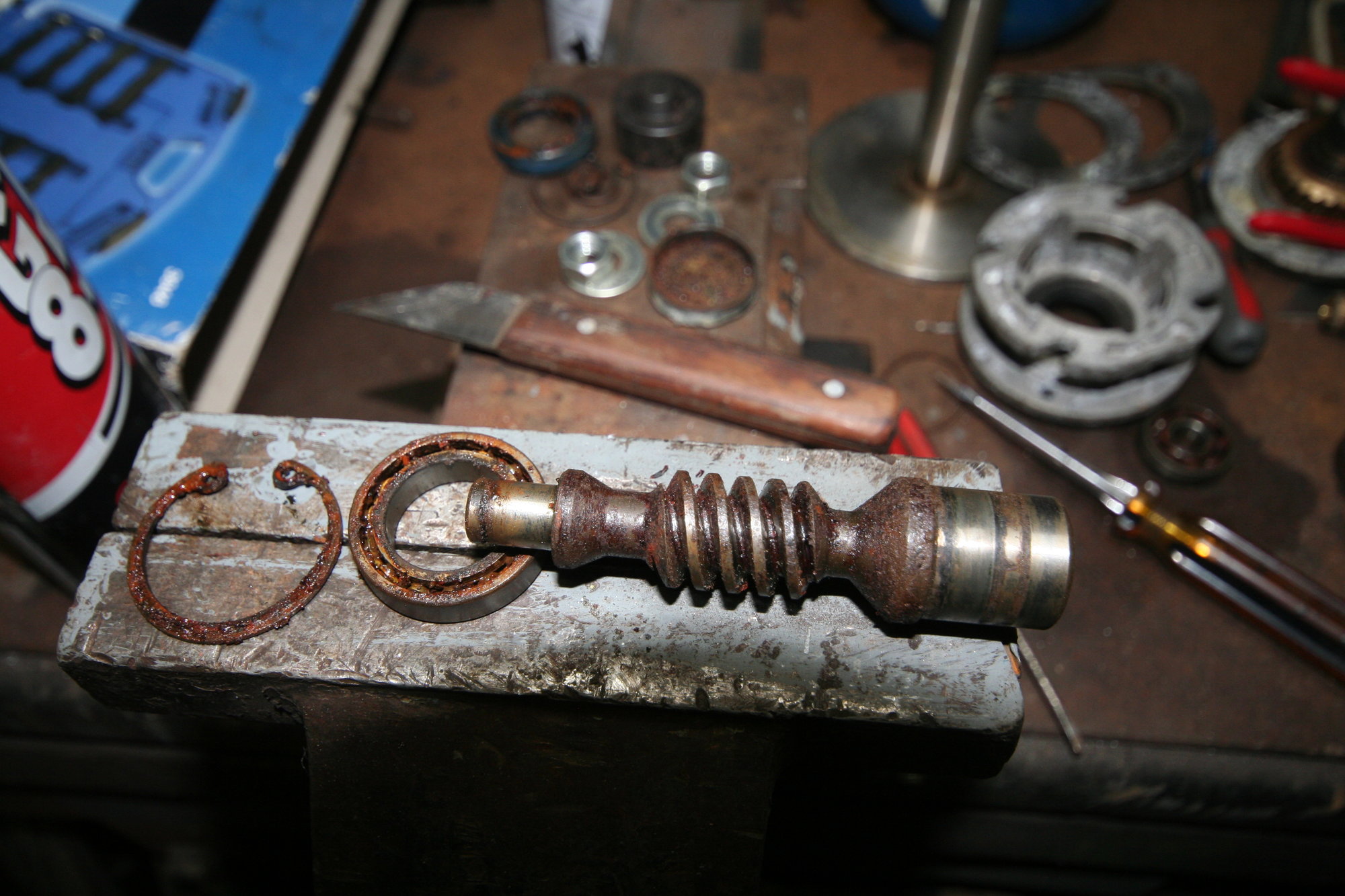

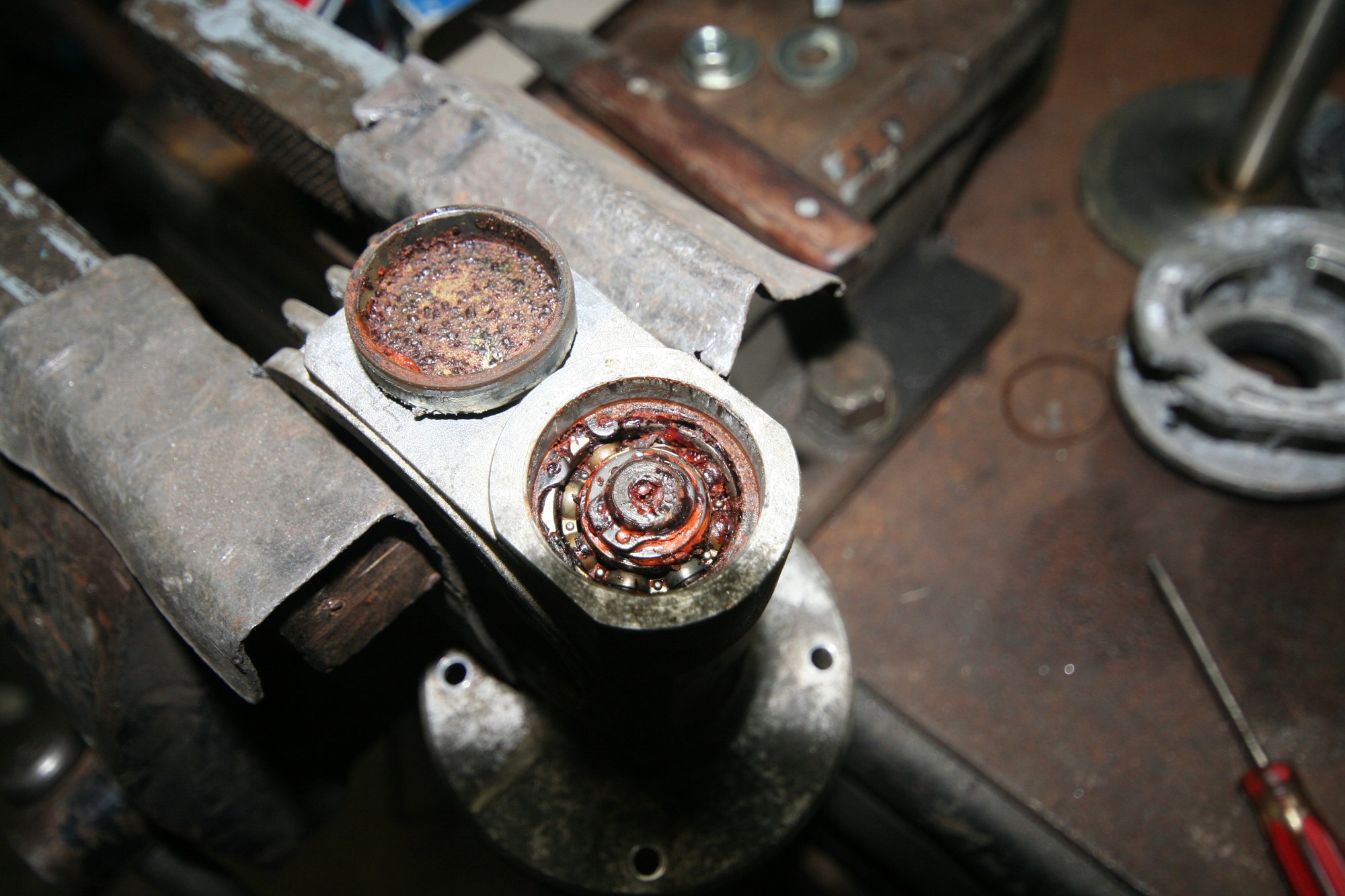

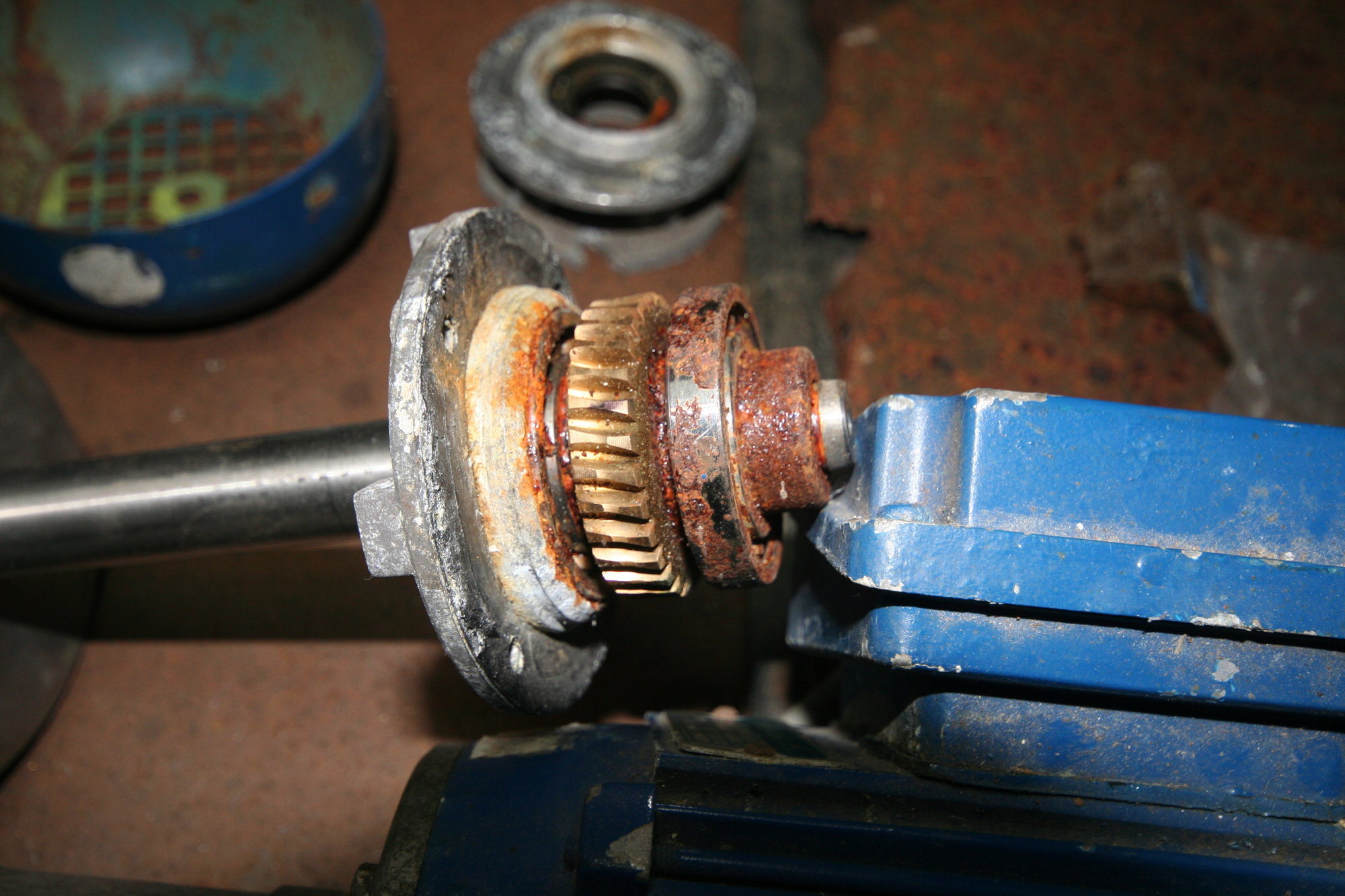

    I has always intended installing a motor to drive it and bought a small 3 phase motor and gearbox from one of the members on here.
    When I bought it he did say it could do with a set of bearings and he wasn't wrong.
    So full strip down and ordered a full set of bearings and seals from Simply Bearings
    Which everything cleaned and new bearings, seals and gaskets fitted and re-assembled it all worked perfectly.
    Next issue was getting the key out of the drive shaft
    It was solid so I welded a bit of flat to it and pulled it out, then a quick tidy up so I could reuse it.

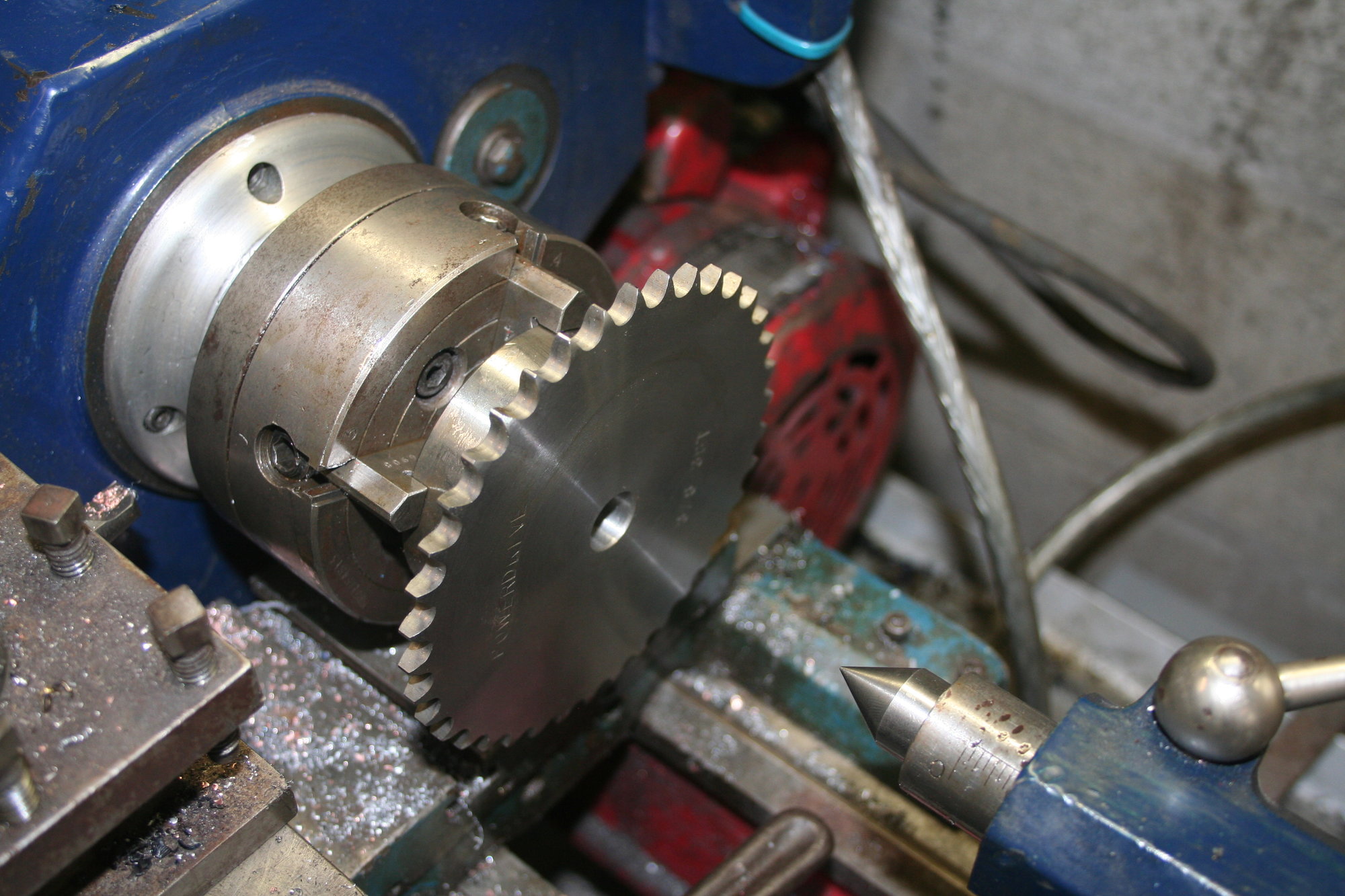

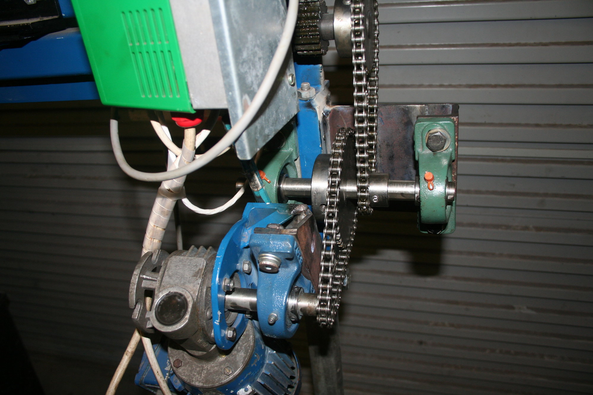

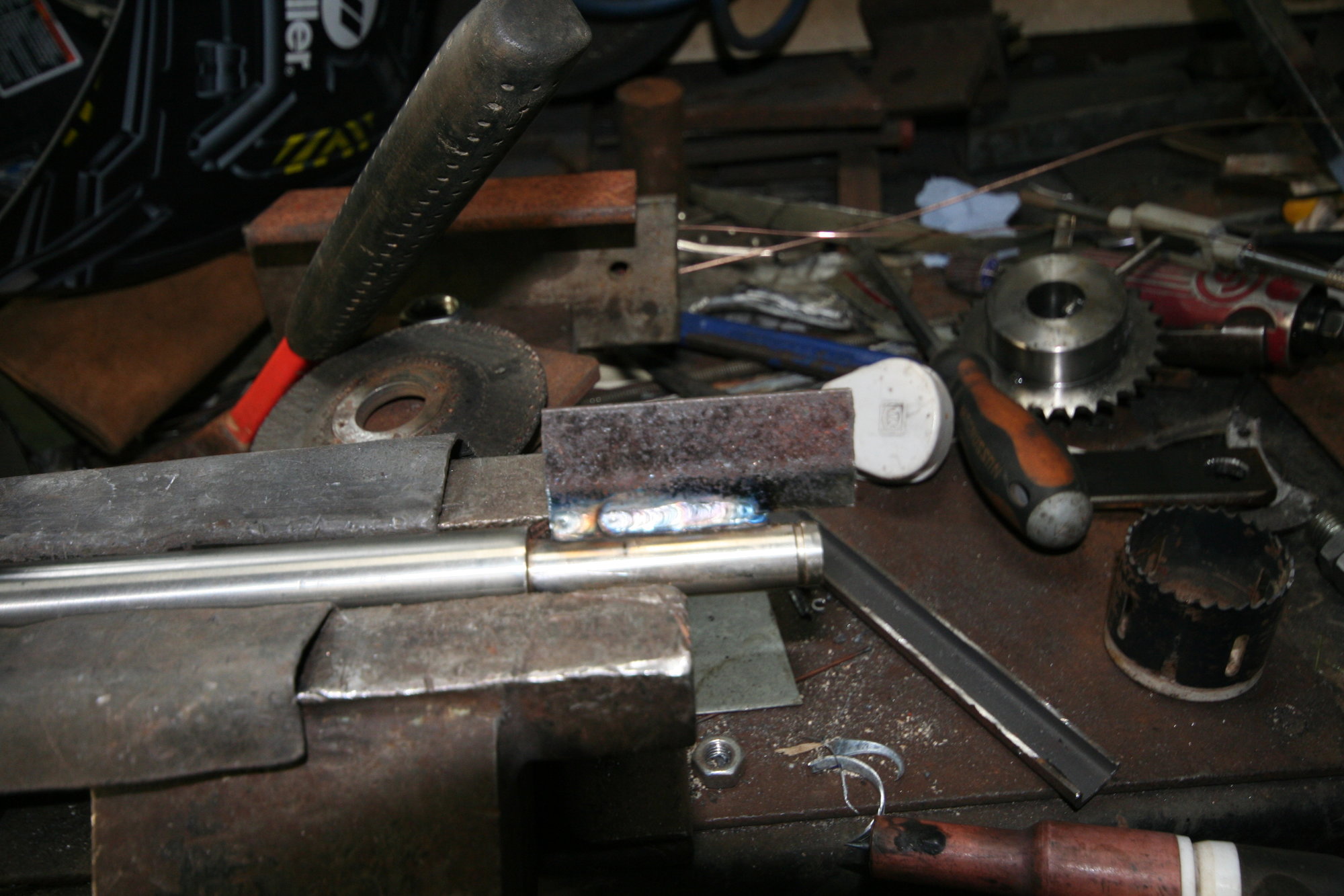

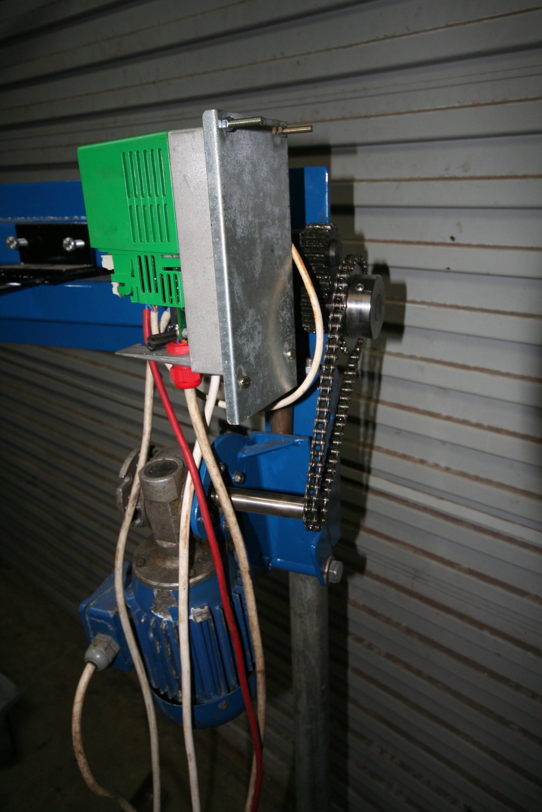

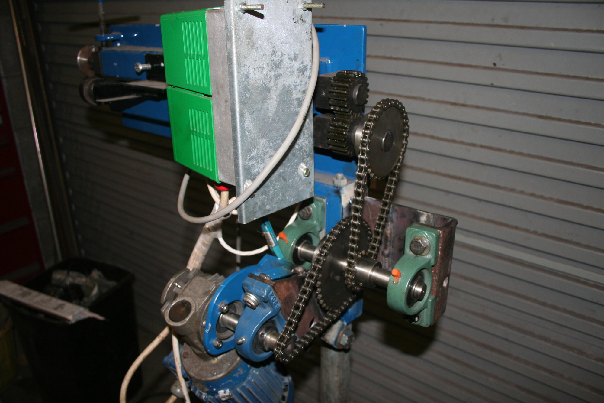

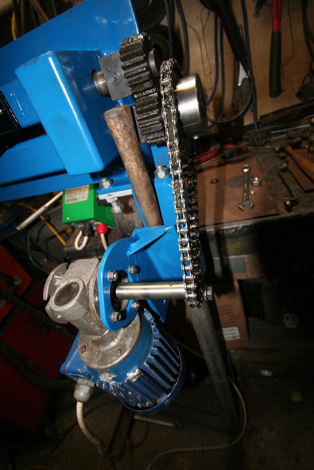

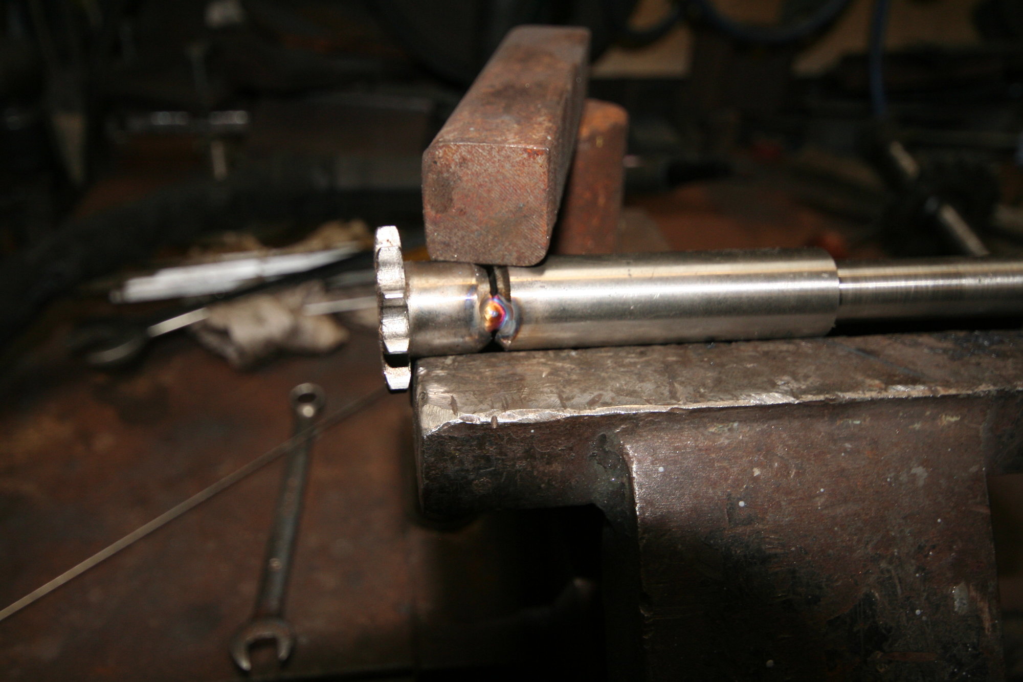

    With the drive sorted I got back on to Simply Bearings and ordered some sprockets and chain.
    The small cog was a good fit for the shaft so I just cut the shaft and welded it on.
    It's a bit off, but good enough for my needs.
    I intend to use the motor and drive part time for a welding rotater / lathe I have in mind, but that's for another thread if I ever get around to making it.
    I then just drilled out the big sprocket and tapped it for a locking screw.
    I didn't have a lath at the time (I do now :laughing:) and I don't think the hole drilled exactly in the center (I just used a blacksmiths drill bit and think it wondered off a bit) but again good enough for the speed involved.

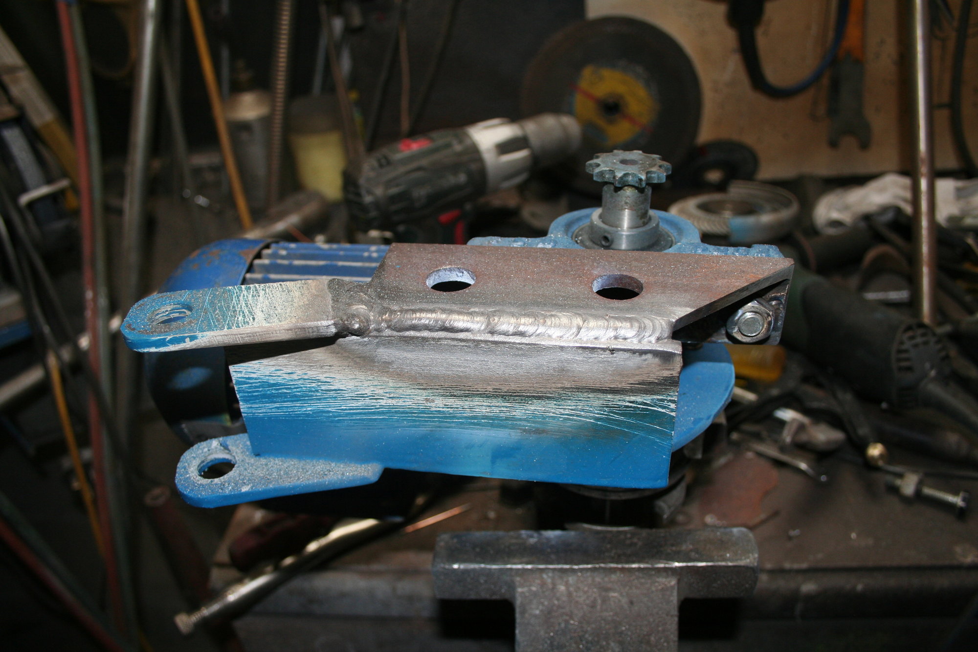

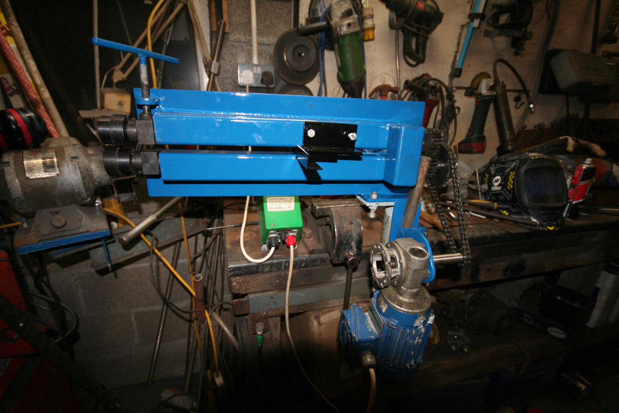

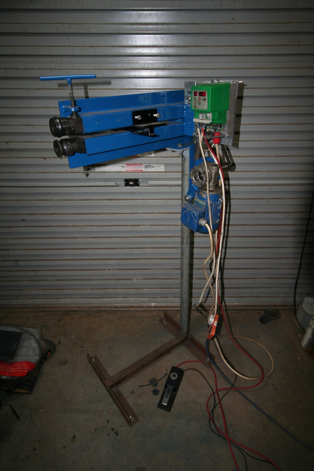

    With these bits sorted I looked about for some way of mounting the motor and with a way of adjusting it.
    Back to the scrap bin and found a bit of 4" angle and water pipe
    Also made up a simple stand out of 2" scaffold tube and angle.
    Cut out a mounting bracket for the drive with the plasma, welded it all together and painted it a nice shade of Ford Tractor Blue

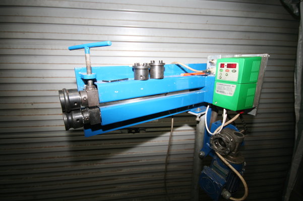

    Assembled up for a trial run with the inverter drive

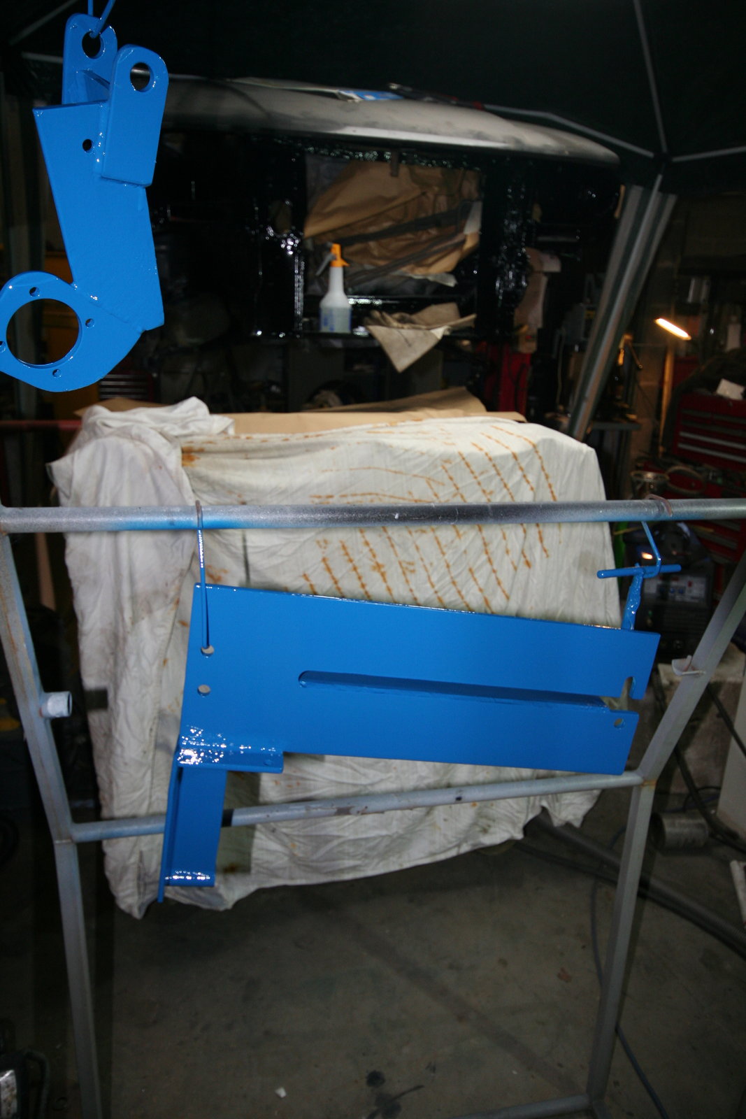

    I think I was too quick to paint it, as I still need to weld a nut on the drive bracket for adjusting the chain tension but the broken hammer shaft works well for now.
    I also had to cut off the roller adjusting bracket and remount it as the mod I did to the adjuster screw didn't allow enough movement but at least I caught that on before I painted it.
    As mentioned earlier the black bit is a guide for running beads a set distance from the edge of a sheet. I don't know how useful it will be (haven't had cause to use that feature yet) and apologies for the mess

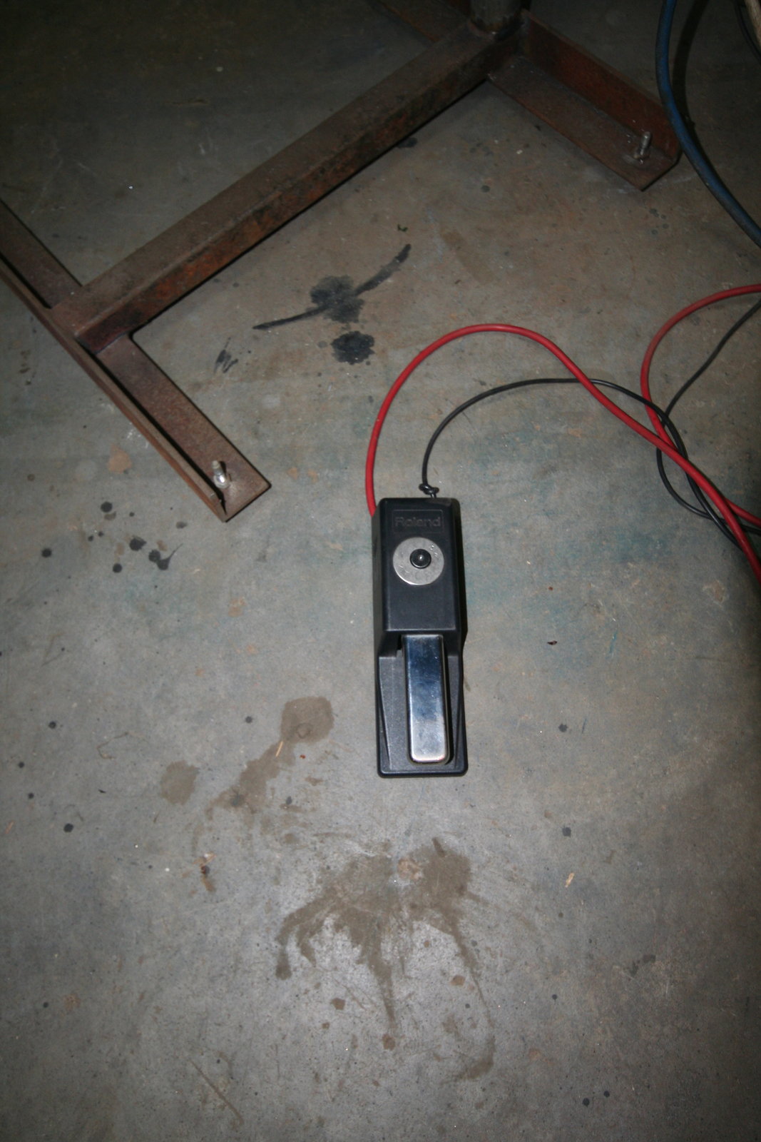

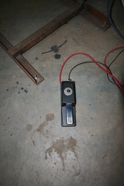

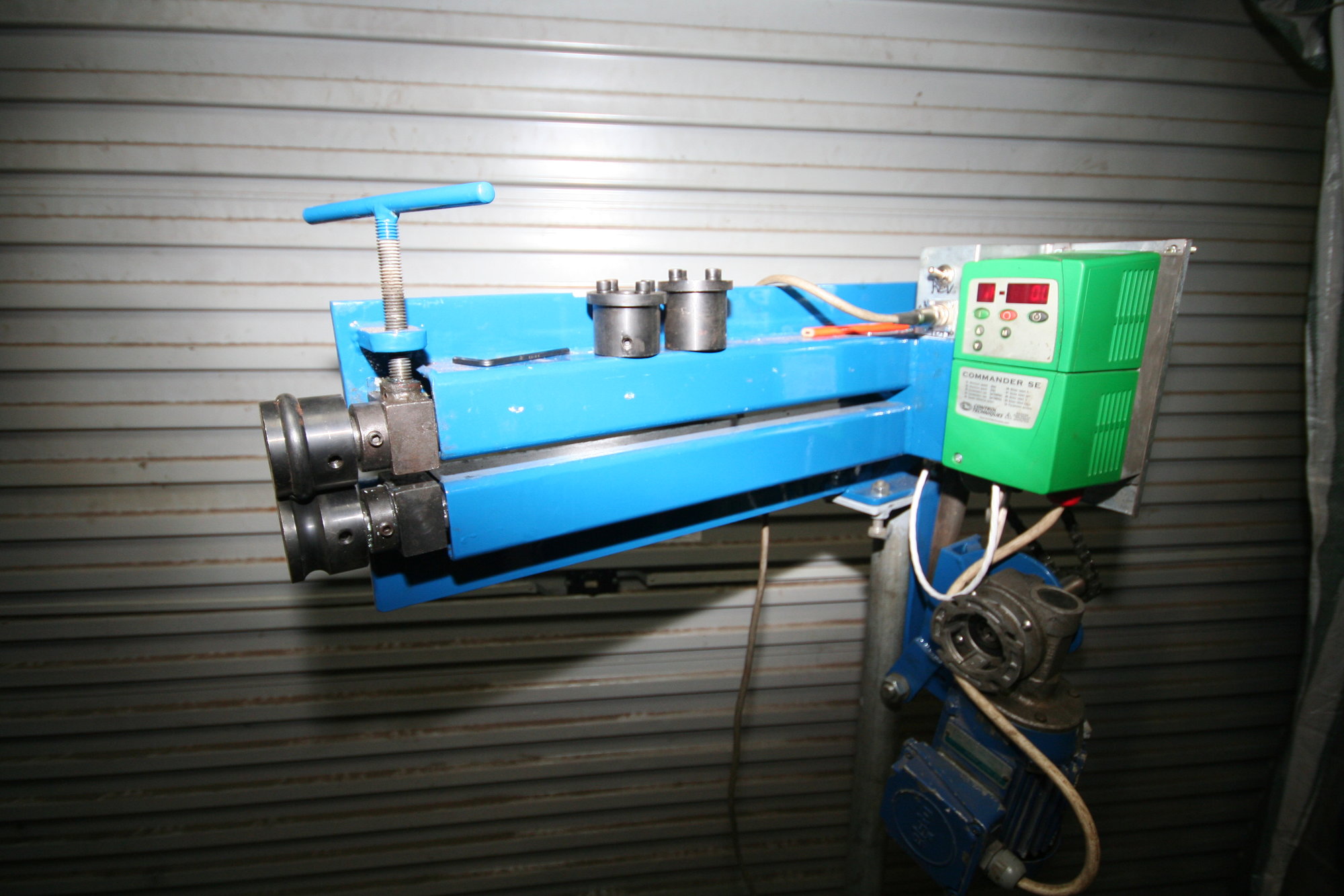

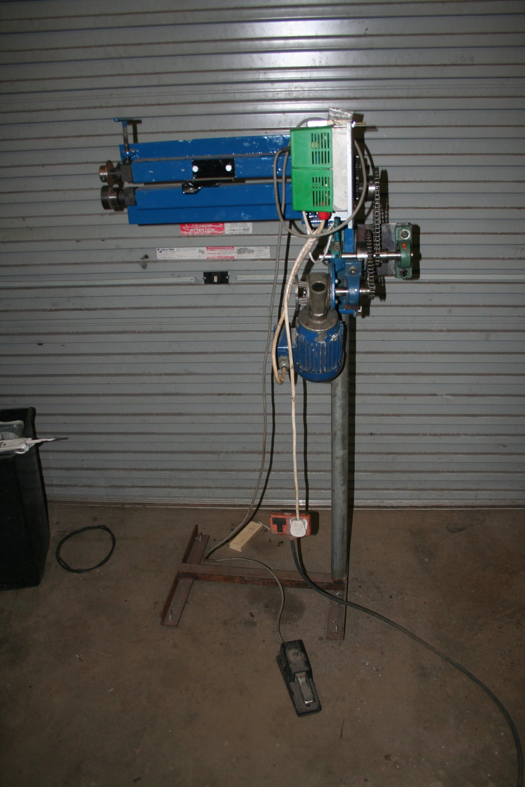

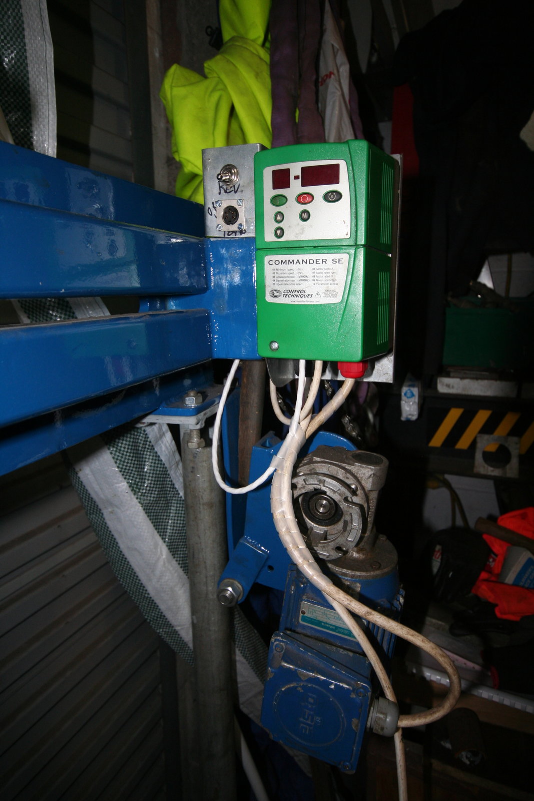

    After a dry run with the inverter, I needed to tidy it up and sort out some speed control.

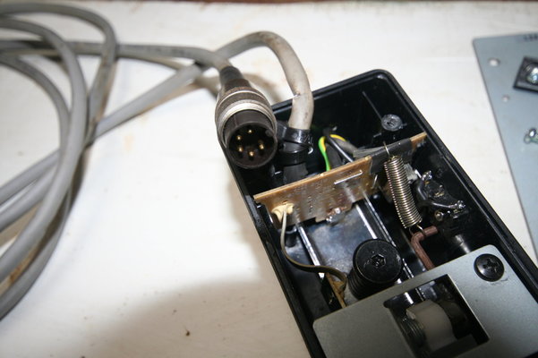

    The inverter needs a 10K pot to control the speed and I thought I had bought a couple, but as usual I couldn't find one. (found them after, when I didn't need them, of course)
    I had a look at all the bits I could think of that might contain a 10K pot e.g. hi-fi, my sons electric guitar and his effect pedals, but I struck lucky with my daughters Roland electric piano.

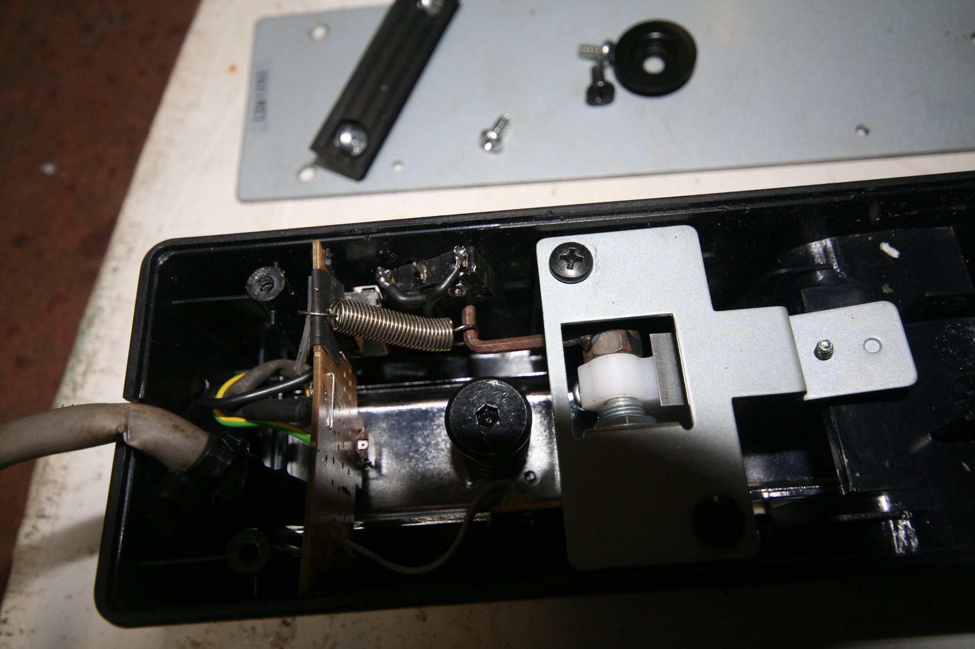

    It has a pedal with an on / off switch and a 10K pot all in a robust case and with a nicely weighted pedal action.
    Another real bonus is they are only £32 new so after checking it would work I ordered new one for the piano.
    Only problem is the switch and pot don't work at the same time (there is another slider switch on the pedal to give either option but not at the same time) also the switch didn't work until the pedal was well depressed, which wasn't ideal so I installed another micro switch and rigged it up with an additional cable. (switch is on the red cable in the photo)

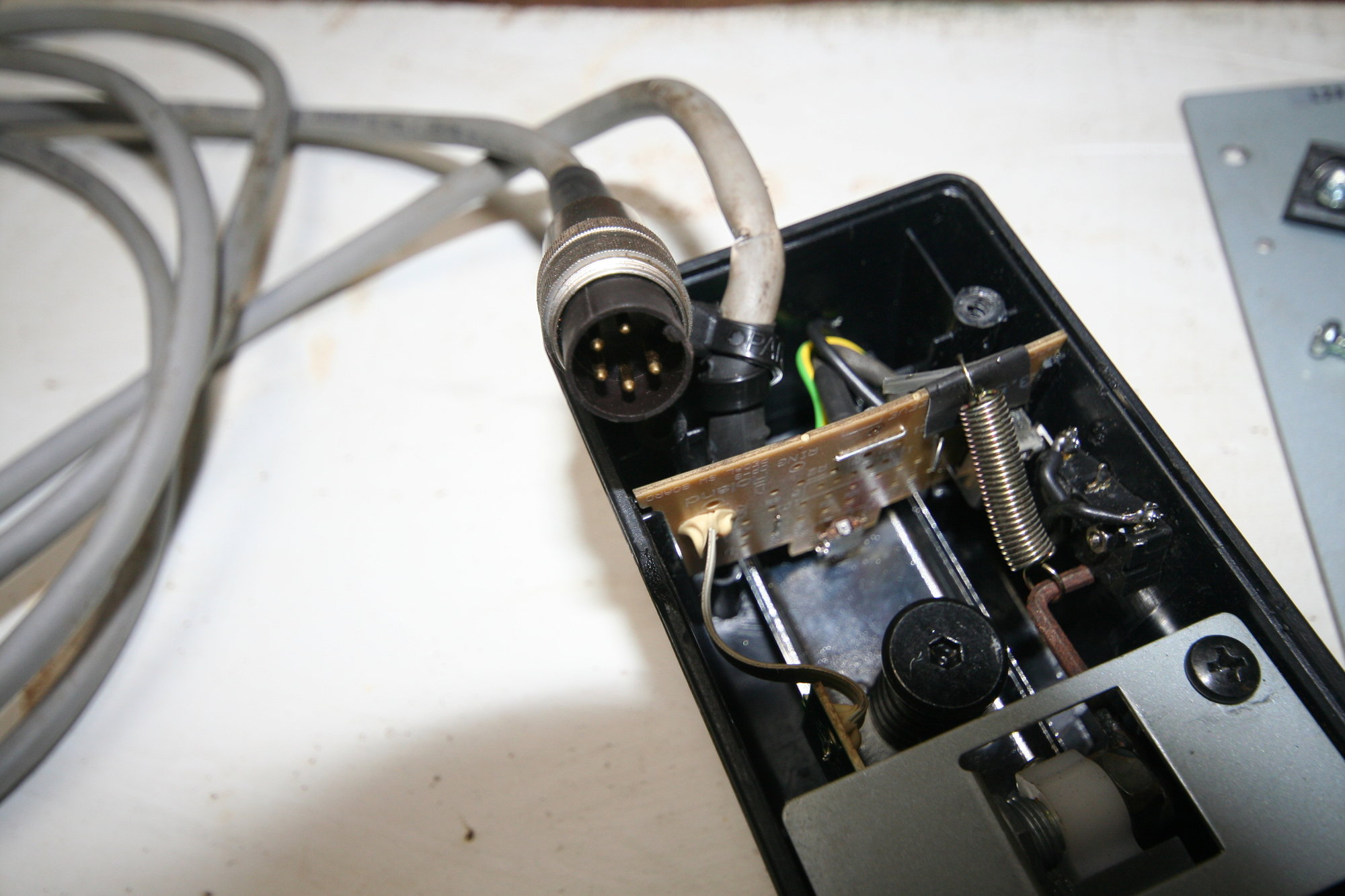

    Worked a treat but the switch was a bit temperamental and I needed to tidy it up.
    Ordered a few din 5 pin plugs and sockets from RS
    Made a simple lever that connects to and operates with the pot and installed the micro switch. The longer throw allows the switch to connect with very little pedal travel.
    Then wired the pot and switch to a 5 pin din plug

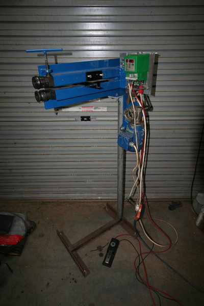

    Also made a bracket for installing the inverter on the bead roller stand and installed a din socket and 3 way switch next to the inverter, so I have forward, off and reverse.
    Still need to install a guard on the chain drive but as I want to reduce the gearing a bit I will do that after I've installed a bigger sprocket.
    Also need to put some proper markings on the switch.
    It's now a brilliant tool with loads of power and control and there is the added bonus that the pedal should work with my tig welder, but I haven't wired that up. yet.
    Thanks for looking.

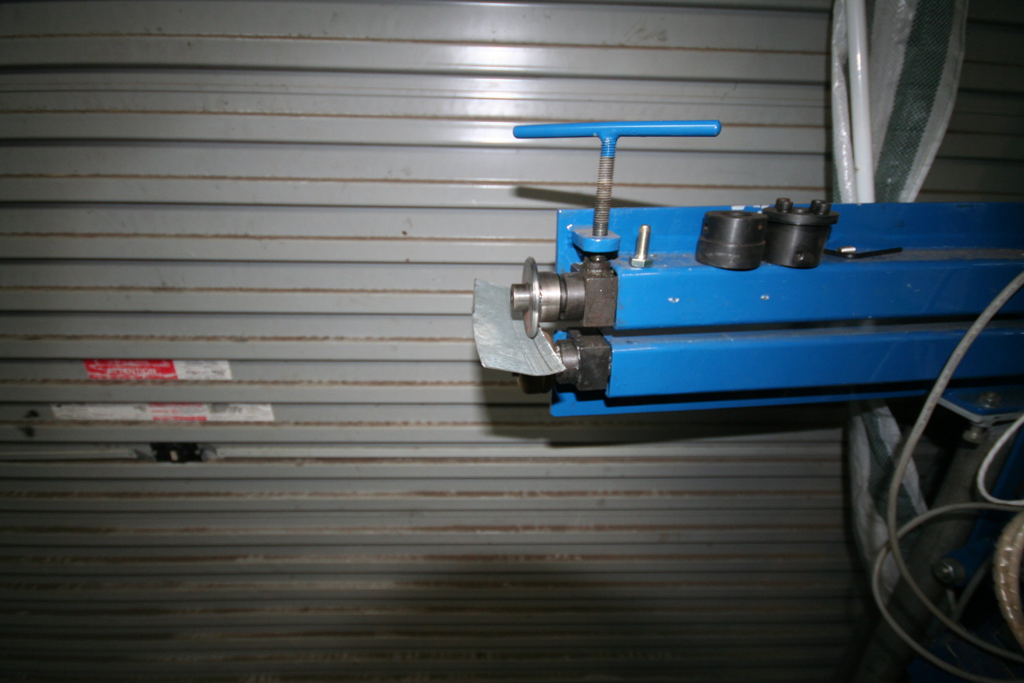

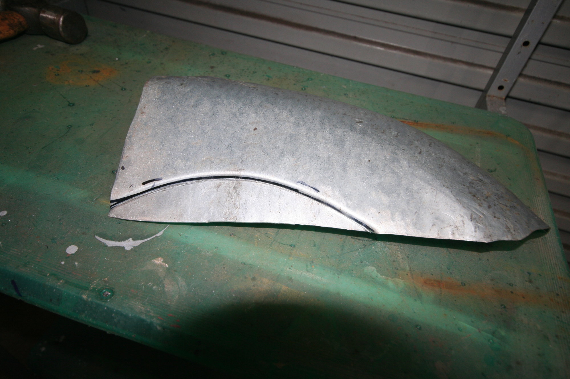

    Still not finished (haven't changed the gearing yet, so still no guard) but been using the bead roller and it makes life soo much easier.

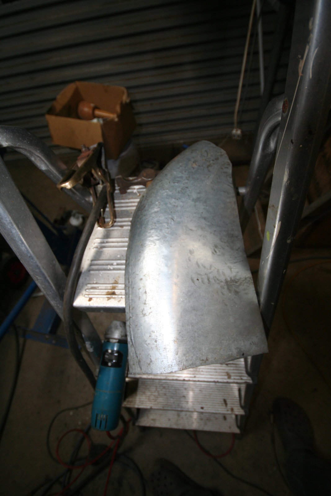

    I made a tipping roller which is great for setting an folded edge on a curved panel, but not convinced with the skate board wheel trick I found on the net.
    It's great for starting a fold and is gives you a definite line to follow but I think I need to make proper male and female (are we allowed to say this now) V rollers to see how that works, but that's for later as I don't need one just now.
    What I do need is to set a curved joggle on a patch for a spare wheel well.
    This is the patch
    This is the joggle being formed
    And this is the almost finished article
    And this is where it's to go
    Still needs a bit of fettling and planishing but I'm quite pleased with the results so far.

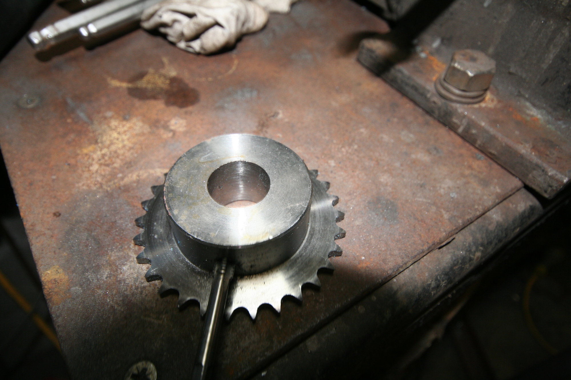

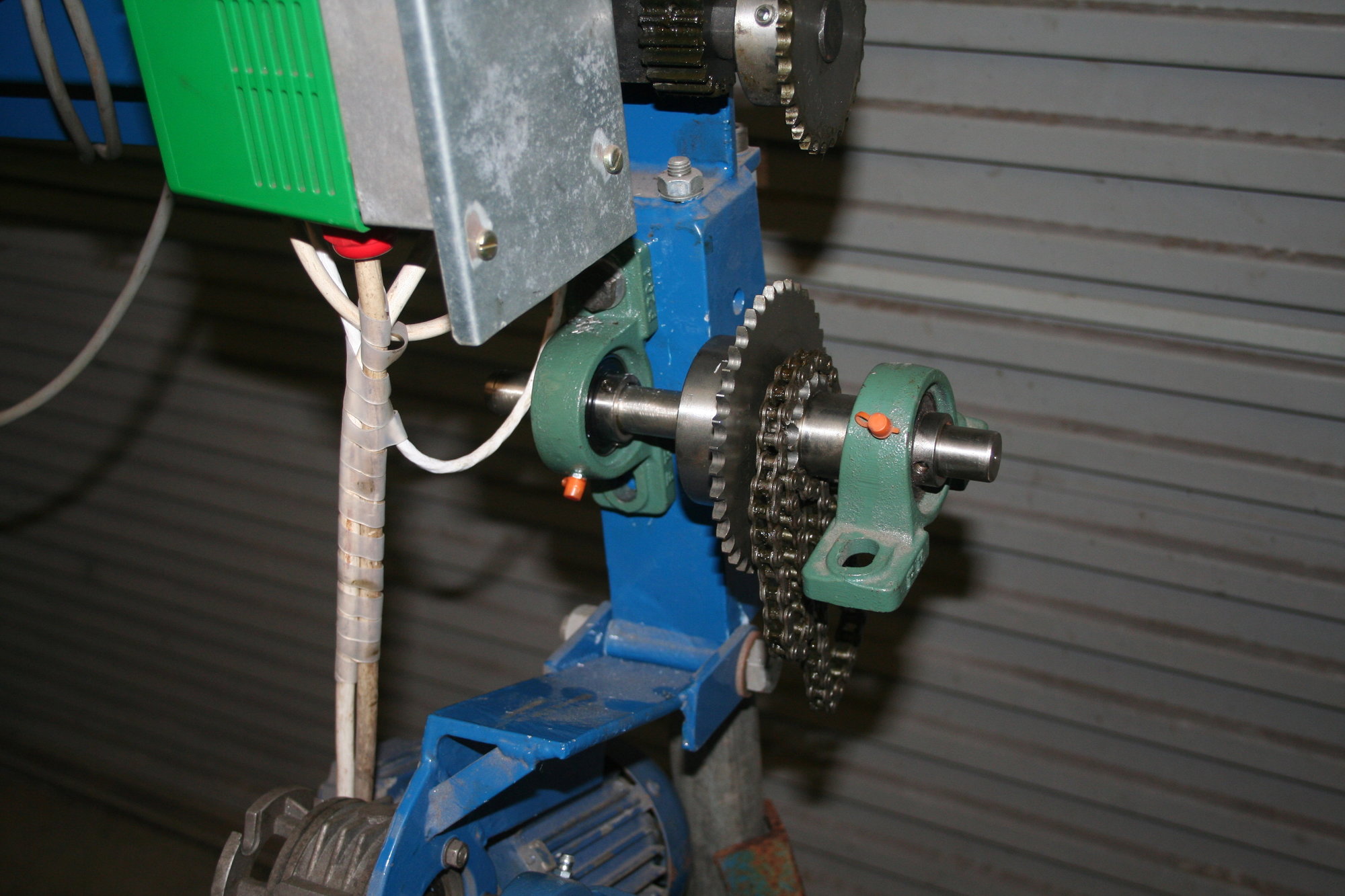

    I got the bits to increase the gearing of the bead roller just after this post and discovered them again after 6 months so thought I should put it together before I lose them altogeather.
    I got my lathe up and running again so used that to enlarge the holes in the sprockets.
    I used one of the MT2 centers kindly donated by @scottmk1 to get the sprocket close to center in the 4 jaw and then the method in doubleboost's videos to dial it in.
    Bits needed were some 20mm shaft, 3 pillow block bearing, a wee sprocket, a big sprocket, chain and a few bit of angle I had laying about.
    First job was to get a rough idea of where it all needs to go in relation to each other.
    Then make and fit a bracket to pickup and support the other end of the intermediate shaft.
    I was trying to keep this compact but it ended up too compact to fit all the sprockets so I had to extend the bracket. (That's what happens when you never plan or draw anything out)
    Hadn't any plate the right thickness so I cut a bit out of the same angle I was using.
    I welded the extension in two half's and clamped a bit of angle across it to stop it pulling. It seemed to work fine.
    I needed to adjust the position of the motor bracket and also added a piece to support the end of the gearbox output shaft.
    Put it all together and spent bit of time lining up the gears starting from the gear on the bead roller and working back.
    It all works a treat and with the motor running at 50 hertz it's a nice speed for bead rolling straight runs.
    I can adjust the minimum and max speed to suit what I'm doing and start, stop and change the speed with the pedal.
    Direction I change with a toggle switch next to the inverter.
    The only slight niggles I have is there is a bit of a delay after pressing the pedal before the motor starts. (I have the ramp up speed set to 0 but don't know if there is another parameter I should be adjusting) and I welded the small sprocket on to the gearbox output shaft slightly off so I need to cut it and re-weld it but it's only a bit of a wobble and doesn't affect the operation of the tool but does flex the motor mounting slightly during operation.
    It still needs a guard, an isolation switch, maybe an emergency stop, a couple of braces to take the spring out of the stand and some more paint.
    Pilzy, indy4x, dobbslc and 3 others like this.
