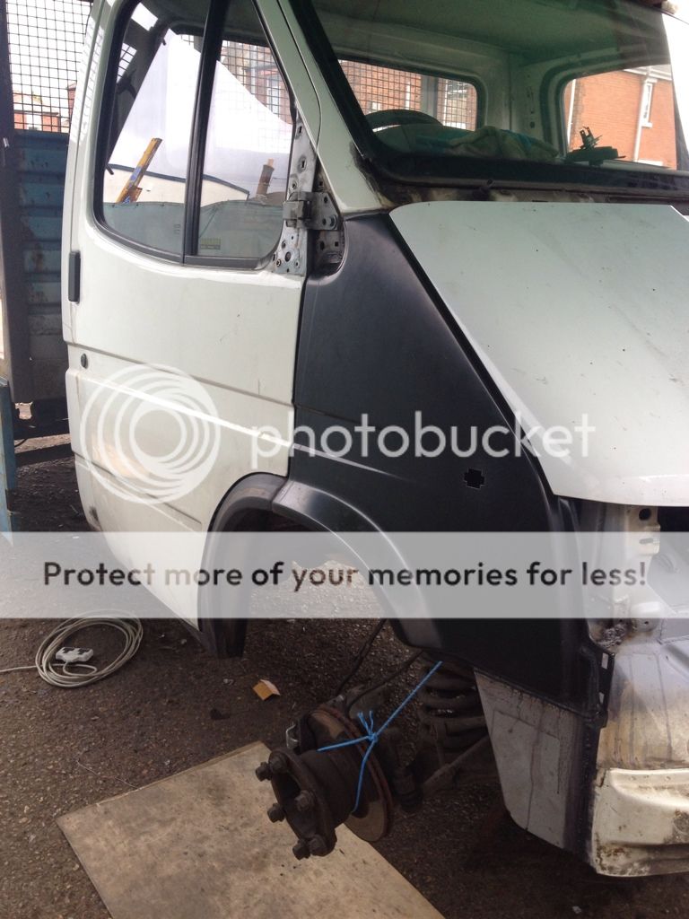

    Those of a sensitive disposition, turn away now.....
    [​IMG]
    [​IMG]
    [​IMG]
    [​IMG]

    Yep, the old Mk 5 is the last decent truck Ford made, light, strong, easy to maintain and cheap to run.
    Plus, and this is the major decider for us, the payload is huge compared to a modern Transit. We hired a 12 plate flat bed twin rear wheel Transit with a tail lift while we took one of our older ones off the road for a week. Got it to a weigh bridge to see how many industrial gas cylinders we could legally carry, 960 kilos was all the payload available, with half tanks and no driver!
    We get 1400kg legally on a Mk 5 by the time we've done the necessary modifications, that's including driver and full tanks too.
    Everyone we've spoken to in the trade says hang onto the old trucks as long as practical as the new breed is much more costly and less suitable for running day in day out loaded to max.

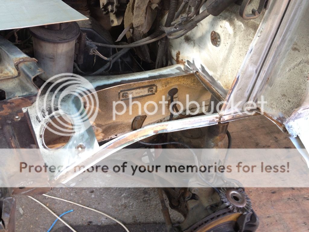

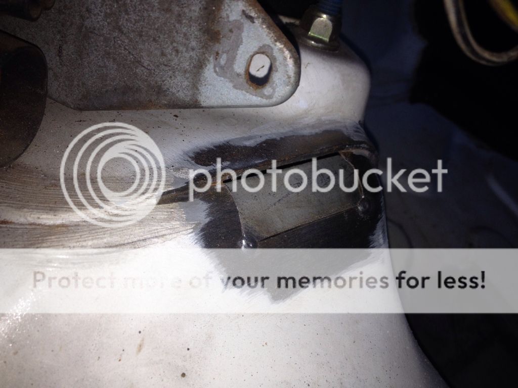

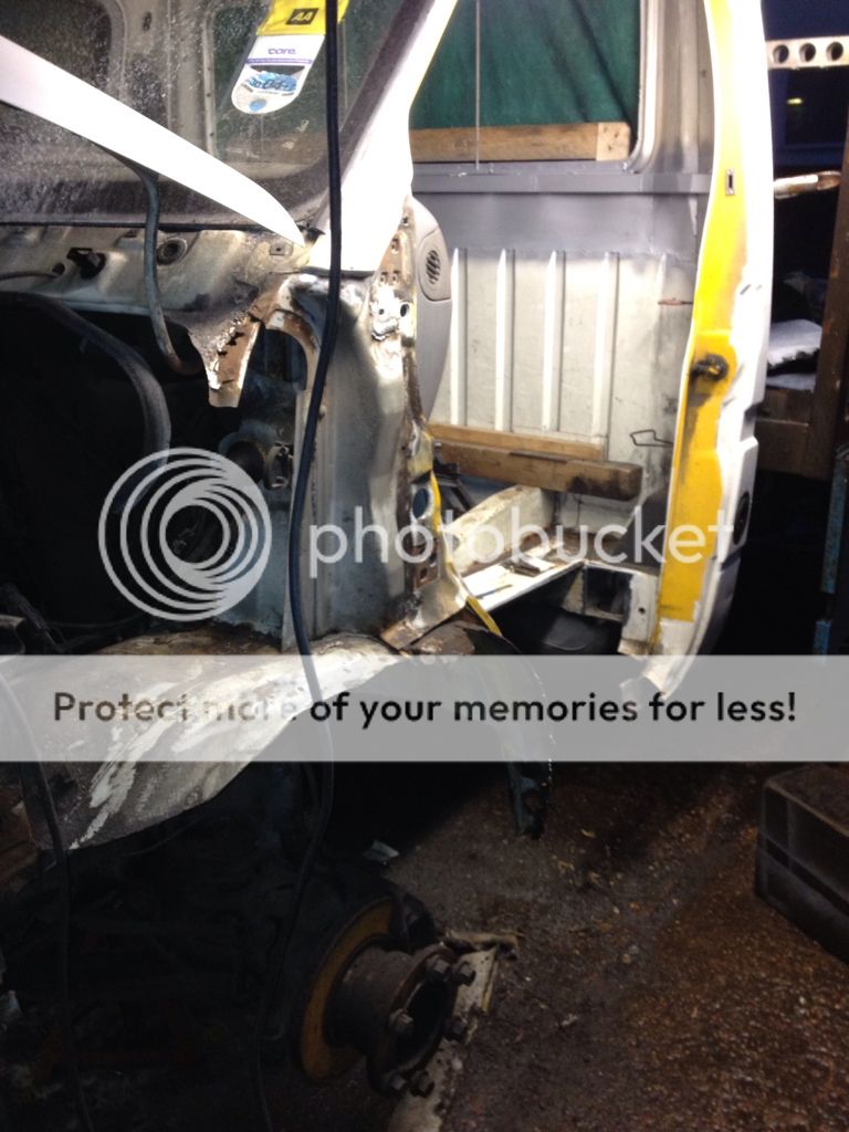

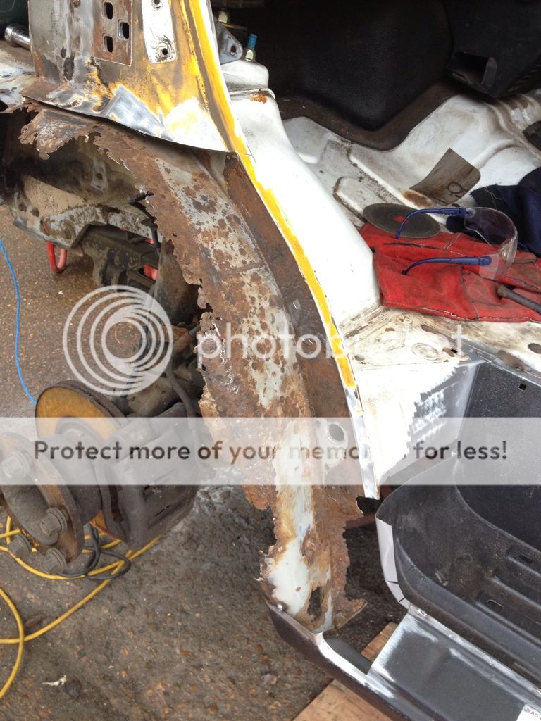

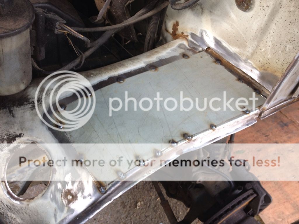

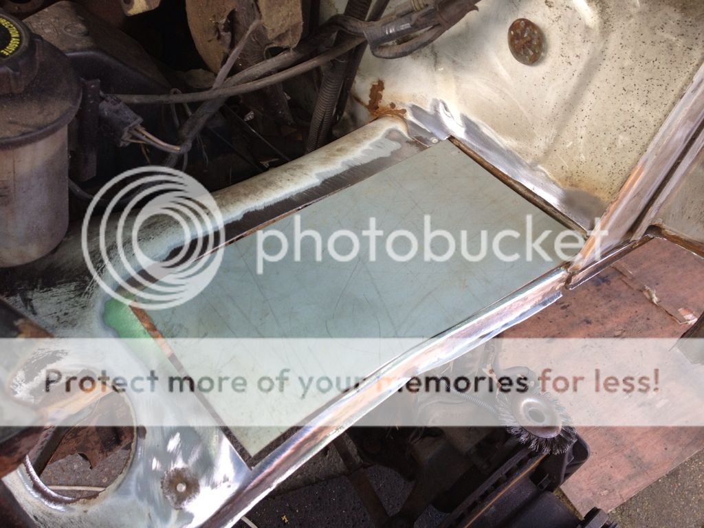

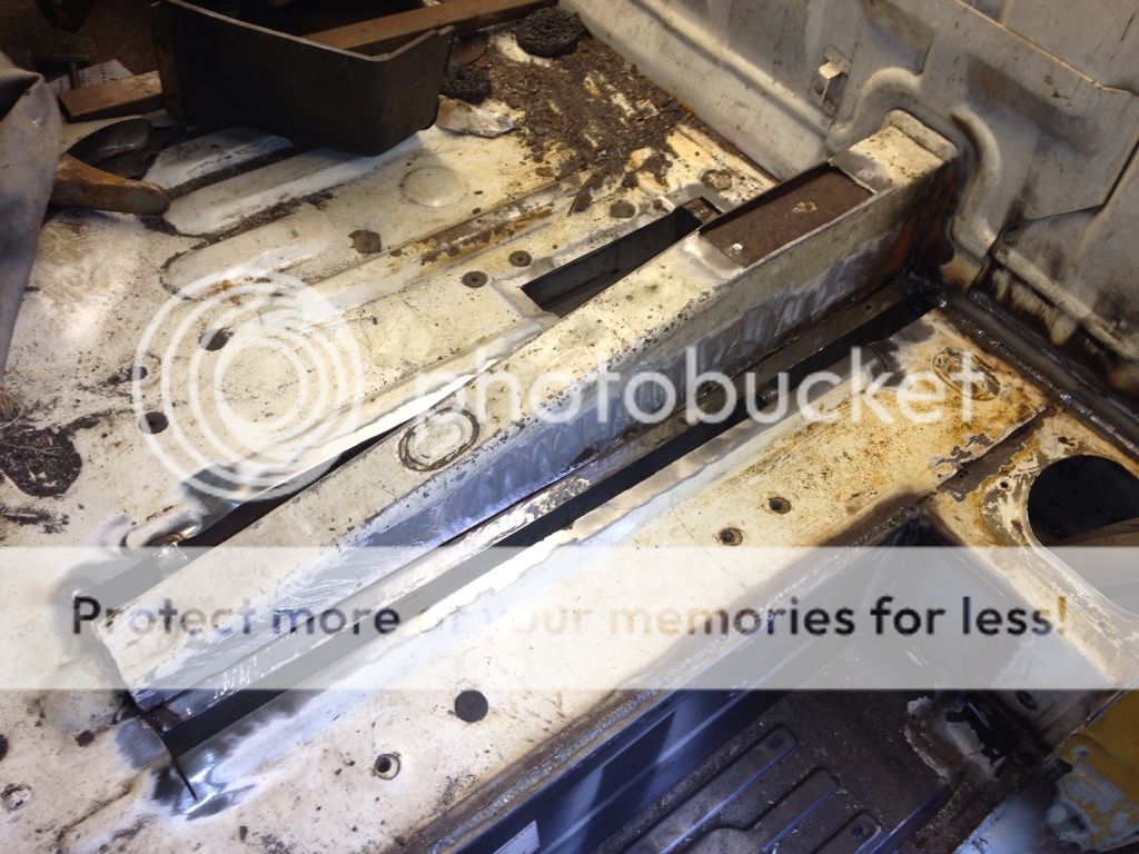

    Pretty much everything up front was rotten in all the usual places, wings, inners and outers, step section, front crossmember, the outriggers, the lot.
    [​IMG]
    [​IMG]
    [​IMG]
    [​IMG]

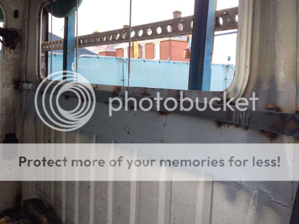

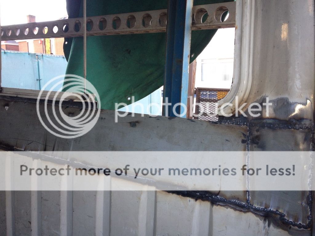

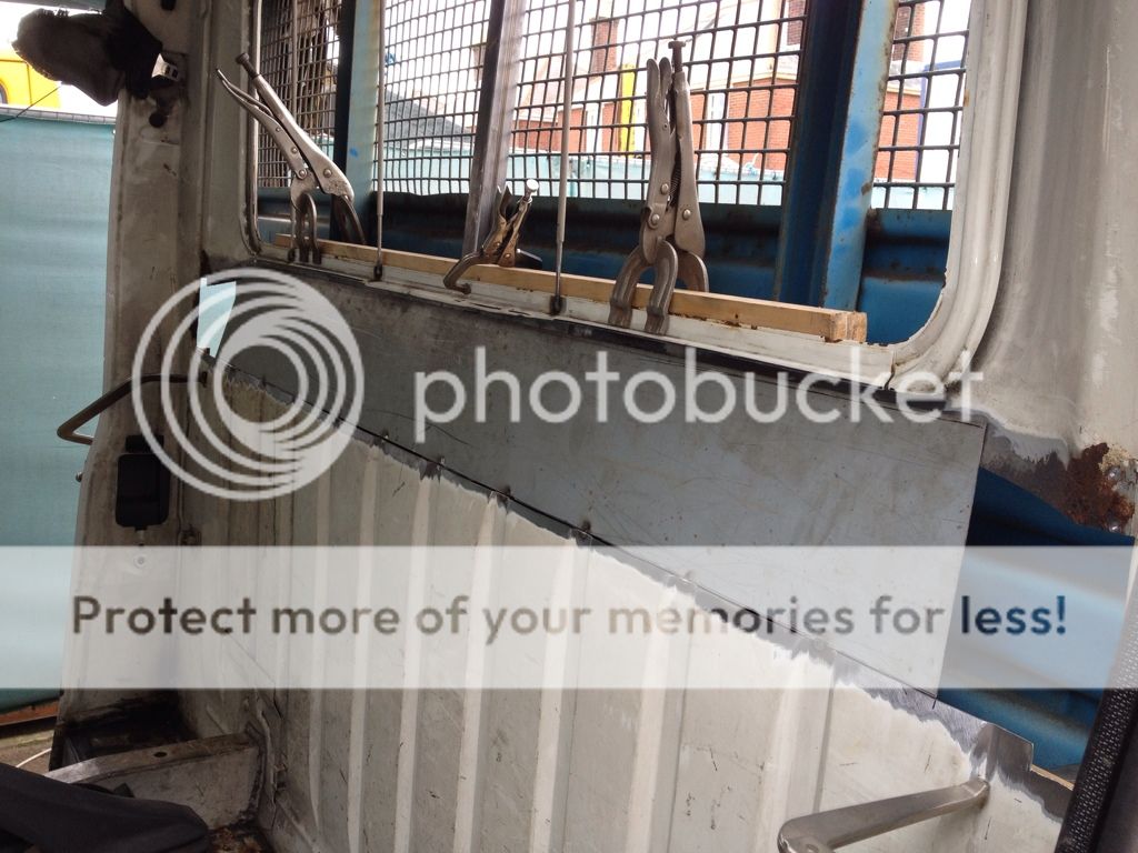

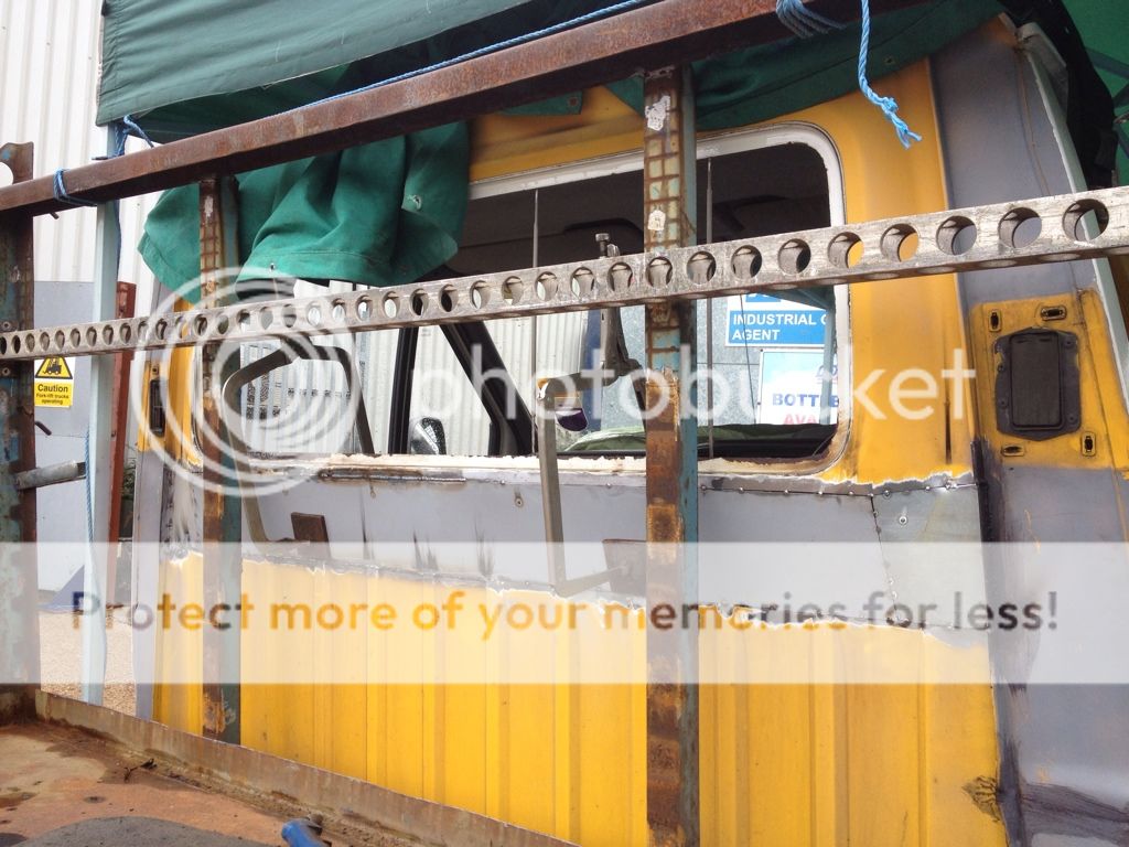

    Back of cab nearly welded out...
    [​IMG]
    [​IMG]
    [​IMG]

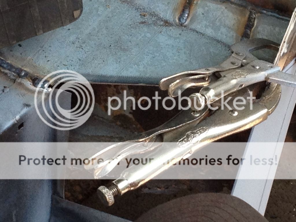

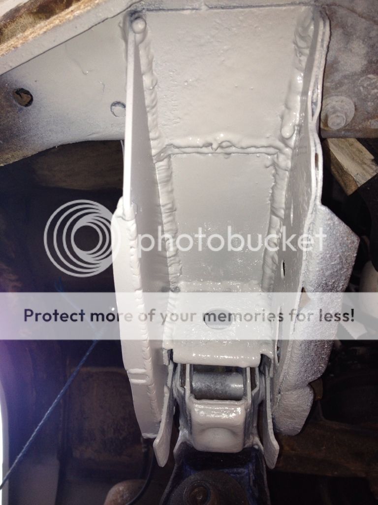

    Front right subframe mount was rotted out, apparently you can buy this section from Ford. People always tell you that after you make one...
    [​IMG]
    [​IMG]
    [​IMG]
    [​IMG]
    [​IMG]

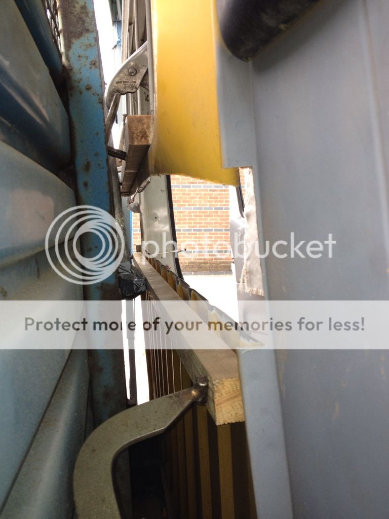

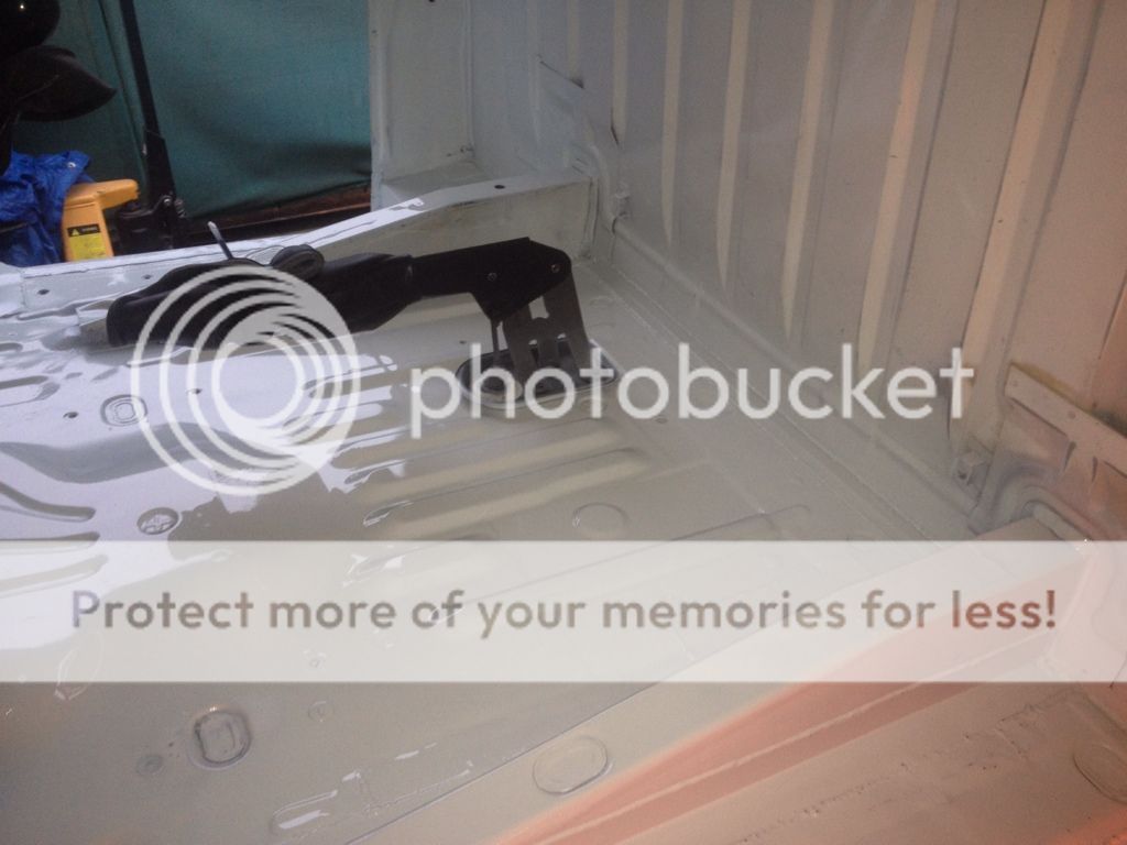

    Had to put some strength back into the rear of the cab...
    [​IMG]
    [​IMG]

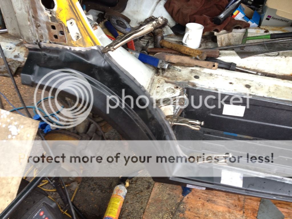

    The nearside arch and step were even worse, accident damage and some really ropey repairs had allowed rust to really go to town...

    Inner wing was rotted all the way round...
    [​IMG]
    [​IMG]
    [​IMG]
    [​IMG]
    [​IMG]
    [​IMG]
    [​IMG]
    [​IMG]

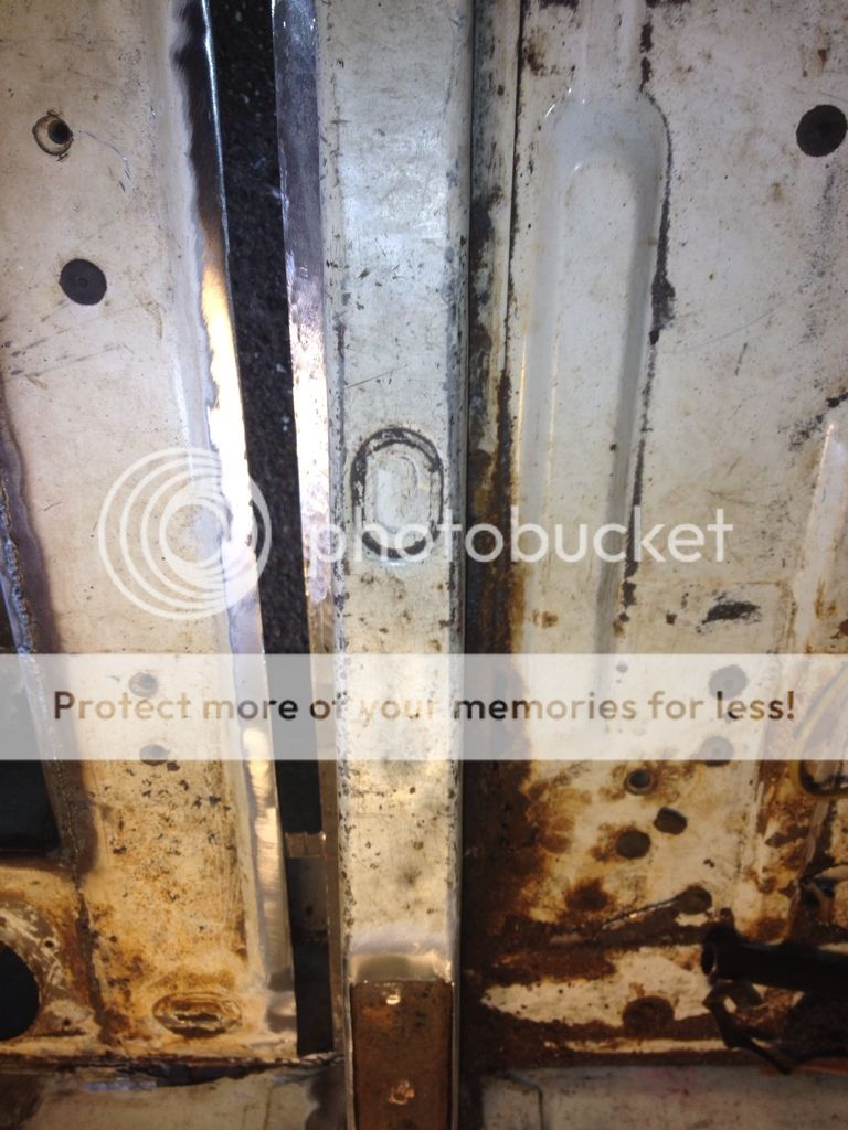

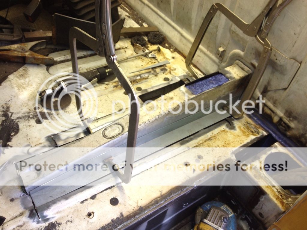

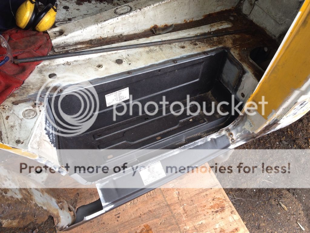

    Floor of the cab around the chassis rails was pretty far gone from wet ratchet straps left in the cab each winter...
    [​IMG]
    [​IMG]
    [​IMG]
    [​IMG]
    Got one of my customers to fold me up some channel to make this repair a little easier...

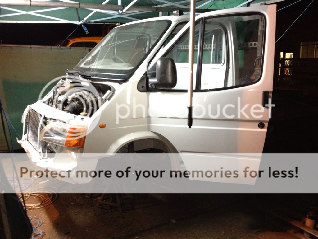

    Skipped a few stages and cab is in paint, this was done in November in a tent, no heated booth for me :/
    [​IMG]
    [​IMG]
    [​IMG]
    Things always seem a little better once you get to the point paint goes back on.

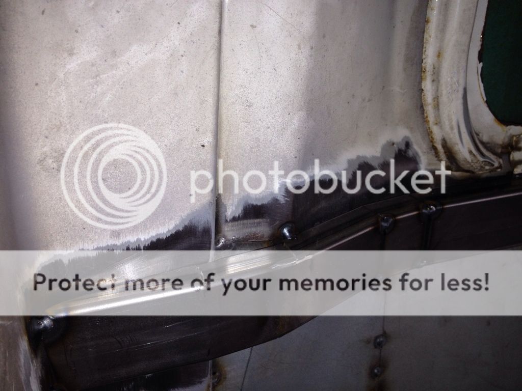

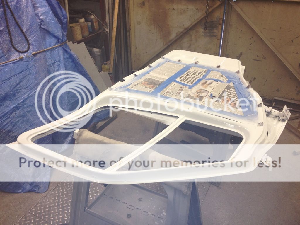

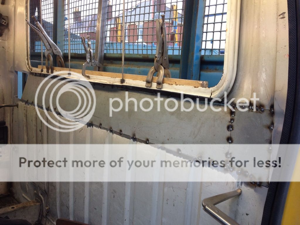

    Next job was to sort the doors, both had some rot and a few big dents so we found some less battered one up the scrappy and set to work, they still had the usuall fatigue crack where the quarterlight pillar meets the door that needed fixing and a few car park dings but nothing major.
    Rust had got into the crack so a fair bit needed cutting out in the end...
    [​IMG]
    [​IMG]
    No picture of it welded but I got a fair bit if shrinkage repairing it like that (this is pretty much my first propper stab at bodywork so I'm learning as I go)
    On the second door I decided to plug weld in a repair patch from behind to reduce the amount of weld and limit the distortion.
    [​IMG]
    Sawed out the rust in the crack and cleaned it all up both sides as best as I could, formed a patch.
    [​IMG]
    And used a Cleco clip to hold it while I got the patch caught in all four corners.
    [​IMG]
    [​IMG]
    Then welded the ****** up, in hindsight I'd wait a little longer and aloe it to cool as I still got a bit of shrinkage which puts a little wrinkle in the door skin requiring laborious filling (which I hate) but at least the crack shouldn't come back.
    [​IMG]
    Door in primer after filling and sanding, primer is a barrier coat as I wasn't sure of the origin of the old paint and didn't want any reactions.
    [​IMG]
    Next some high build...
    [​IMG]
    Then on with the 2K...

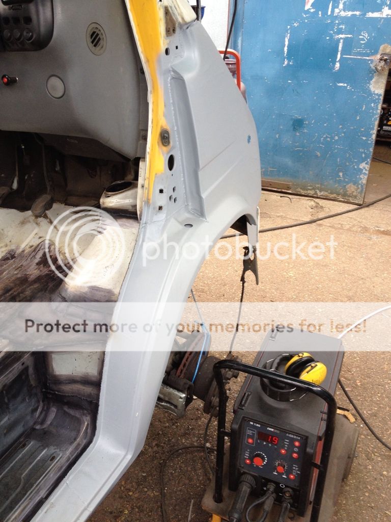

    More reassembly
    [​IMG]
    [​IMG]
    Getting it all to line up after so much welding and a few previous shunts was interesting but the fit ended up ok.
    [​IMG]
    [​IMG]
    Bonnet hinges still aren't right but they were way out before we got anywhere near it.
    [​IMG]
    [​IMG]
    [​IMG]
