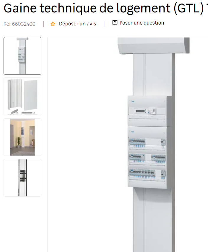

depends, if you'fe following the "consuel" or not, if you are, then the regs define that the house needs a GTL " Gaine Technique Logement", which is basically a consumer unit (and all the telecomms interconnections) on top of a floor to ceiling trunking, so would be plastic as far as I can see. Regs are also pretty specific on where it can be installed, not in kitchens, maximum distance from the incomer meter box, height from the floor etc.... I'll check with my sparky mate tommorrow to confirm.
that said when I did mine for the workshop 3phase, I had a whole new line installed so the consuel was obligatory to get the power on, so to avoid rsing about with the paperwork I just got the local sparks to put it in, and they've used a metal box consumer unit, so probably ok for an outbuilding or workshop, but I'd be wary of using it for a house...

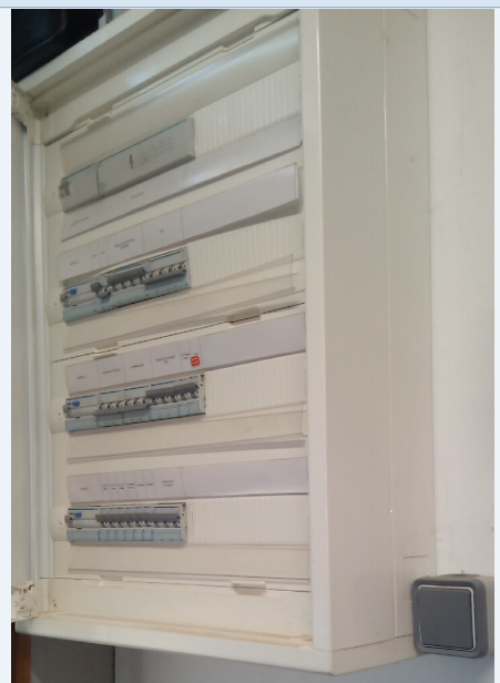

My workshop board 3Ph
