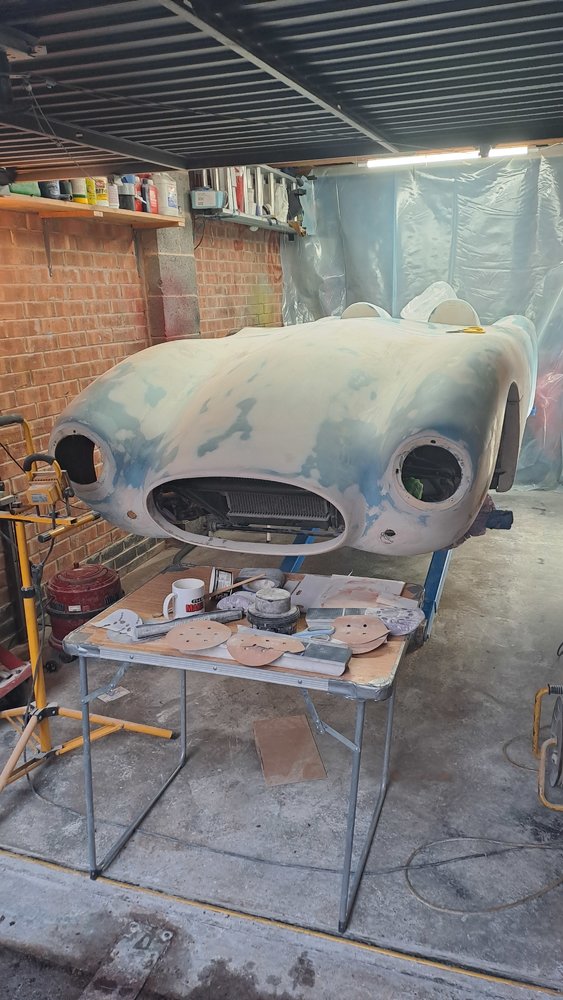

I only used one set of abek2p3 filters on my respray. I did use an isocyanate free 2k though, I fully agree people shouldn't spray isocyanate paints with anything other than proper air fed. The filters were a bit harder to breathe through by the end but I still couldn't smell any solvent (and I was always careful to wear the mask even when just mixing etc so my nose would stay sensitive to the solvent smell).its not as expensive as you might think. air fed mask =£200, 3stage filter=£600

So £35 for one set of filters for one respray (inside and engine bay not painted, just outer panels and shuts).
