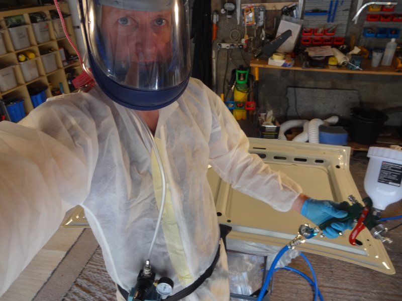

	Looks good dude .. ive been advise that 2k EP primer is not that stinky :-)Some pics, this was the most I did in one go.
Masked up.20137
1.2l of base coat.
1.2l of 2k clear.

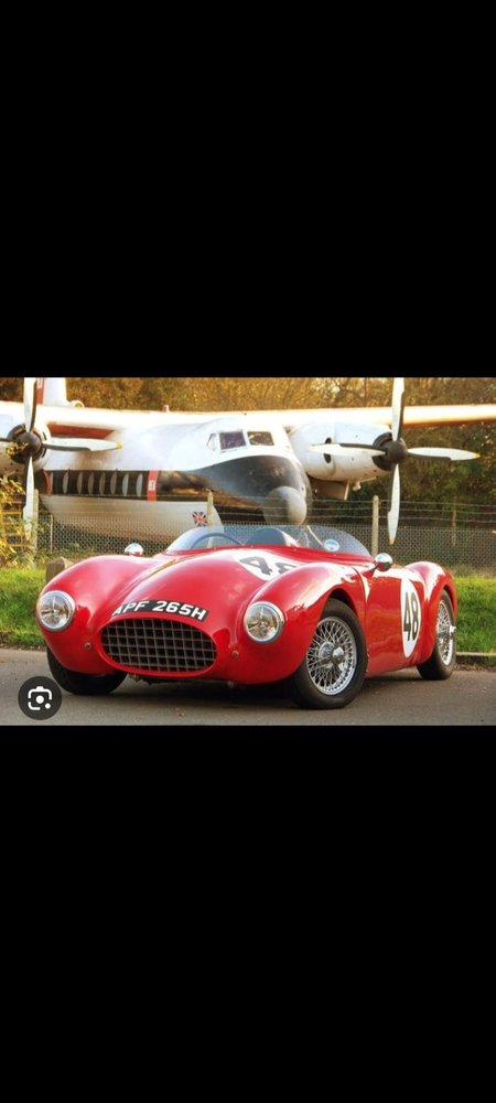

Its a Sammio Speedster .. im hoping to make it into something like this
