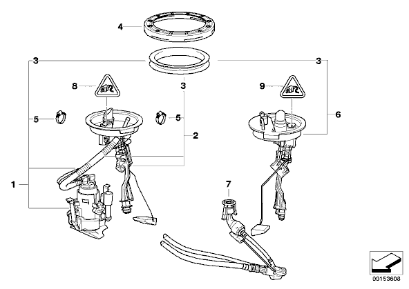

You have on big tank with two half's. It is supposed to push diesel from one tank to the other to maintain tank level. ...I thinkstupid question how much fuel is in the tank??
has it just run out of fuel as you said it runs out before its empty
try putting a few gallons in first
You have on big tank with two half's. It is supposed to push diesel from one tank to the other to maintain tank level. ...I think![]()
I don't use email hardly to be honest. On the invoice tank pump is used double ear clips...PS do not use jubilee clips on diesel pipes they cause all kinds of air leak problems use, either crimp type spring type or proper fuel pipe screw clips, or none at all, just the pipe tightness I have seen it often where the pipe sealed better without a 'jubilee'
Yes that's what I was thinking. .I have one in tank pump with a gauze filter on the bottom. .that's all nice and clean..there in a big black plastic pipe that crosses to the other side with a gauze filter and a one way valve....now the pump side is full of diesel and the other side empty and fuel gauge is registered half tank witch is correct. ...They dont all have two pumps btw some of the earlier types have some kind of splitter system again I did one 320 last year that had only one in tank pump called a splitter jet pump, but two pick ups and somehow it jets the fuel to the front and keeps the two levels maintained possibly by a venturi effect causing a depression on the none pumped side BUT it did not have the pump under the passenger seat floor. It was suffering pick up strainer blockage its Quite a common fault now, the gauze filters blocking, have found quite a few recently, maybe if one gauze is blocked it could cause an imbalance on your system .

that is what i had in the one i did, and stripped both units out and cleaned them.this is what I have in my tank..
I will go through everything again just to make sure. ...that is what i had in the one i did, and stripped both units out and cleaned them.
