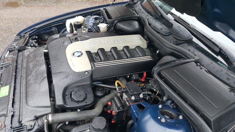

I have just remembered in the splitting or sucking jet pump pipework there is also somewhere a little check valve that sticks, mine had, IIRC and could be allowing the fuel levels to draw unevenly.
Cheers for the information. ..will go have a look after a mug of tea.....I have just remembered in the splitting or sucking jet pump pipework there is also somewhere a little check valve that sticks, mine had, IIRC and could be allowing the fuel levels to draw unevenly.
Yes mate..sat there for ages watching it all...even took it for a spin up the road with it hooked up....Can your code reader/software show you live data?
....bmw part only......will fit back together tomorrow. ....
, if they have to get it from Germany you can be looking at next Tues/Wed before it reaches them - hope I'm wrong though and you have it in you excited palm in the morning.
I picked it up at 3 o'clock this afternoon. ...just never got to fit it..will do in the morning then put it back together and hopeI'd be surprised if they had it on the shelf, if they have to get it from Germany you can be looking at next Tues/Wed before it reaches them - hope I'm wrong though and you have it in you excited palm in the morning.
common fault part, so ready waiting.I'd be surprised if they had it on the shelf
....and dont forget about the end of it in your excited palm!! IE the sensitive bit as I mentioned -------------I am referring to the sensor BTW!!
Behave!!
Fingers crossed that you can enjoy her full potential now.
She been running all day...been out picking up parts....smooth as silk and a lot more throttle response through out the rev range.....just got abs sensors to do and front control arms ..then I can start on my Mercedes![]()
