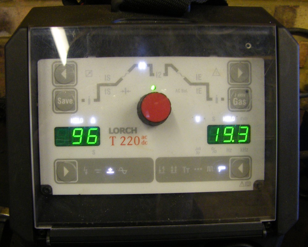

AC/DC inverters
These are normally aimed at TIG welding, and would not be bought for arc welding alone, but they generally have arc welding settings.
Pros:
  • Some rods are AC only. An AC/DC inverter can be used with these.
  • AC is not susceptible to magnetism which can cause stray arcs on DC machines.
  • The TIG welding capabilities.
Cons:
  • Expense: For inverter welders the AC function takes a lot of electronics, so prices of half reasonable machines start at £1000.
Verdict:
Fantastic for ARC welding, but only buy one if you also need to TIG aluminium.
Lorch T220 Control Panel

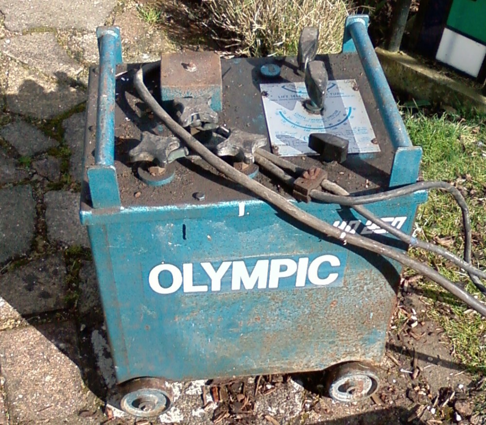

AC oil cooled welders
Pros:
  • Very simple heavily built welders that should last for ever.
  • Normally have both 50V and 80V settings. Smooth consistent arc while welding.
  • Oil cooling results in an excellent duty cycle.
  • It is possible to pick them up cheaply secondhand.
Cons:
  • Not Portable: Oil cooled welders are very heavy, even small units can weigh in excess of 100kg.
  • Starting the arc in AC is more difficult than with DC welders.
  • Can't be used for TIG welding.
Verdict:
Old school equipment that you should never need to replace. Buy one second hand if you are old school, but bear in mind they take a little more skill to use.
Oil cooled arc welder
