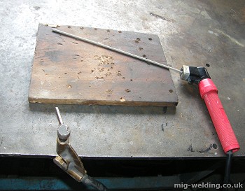

Because the rod is live at all times it needs to be kept insulated from the earth when not in use. In the photo the welding bench is earthed, and a piece of wood is being used to isolate the rod from the bench. After welding the rod is returned to the piece of wood.
Rod resting on insulated pad

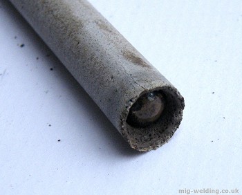

For interest, the photo shows the electrode of a 7018 rod recessed into the flux coating after welding - it illustrates why the flux coating needs to be removed before the arc will start.
Electrode recessed into flux
