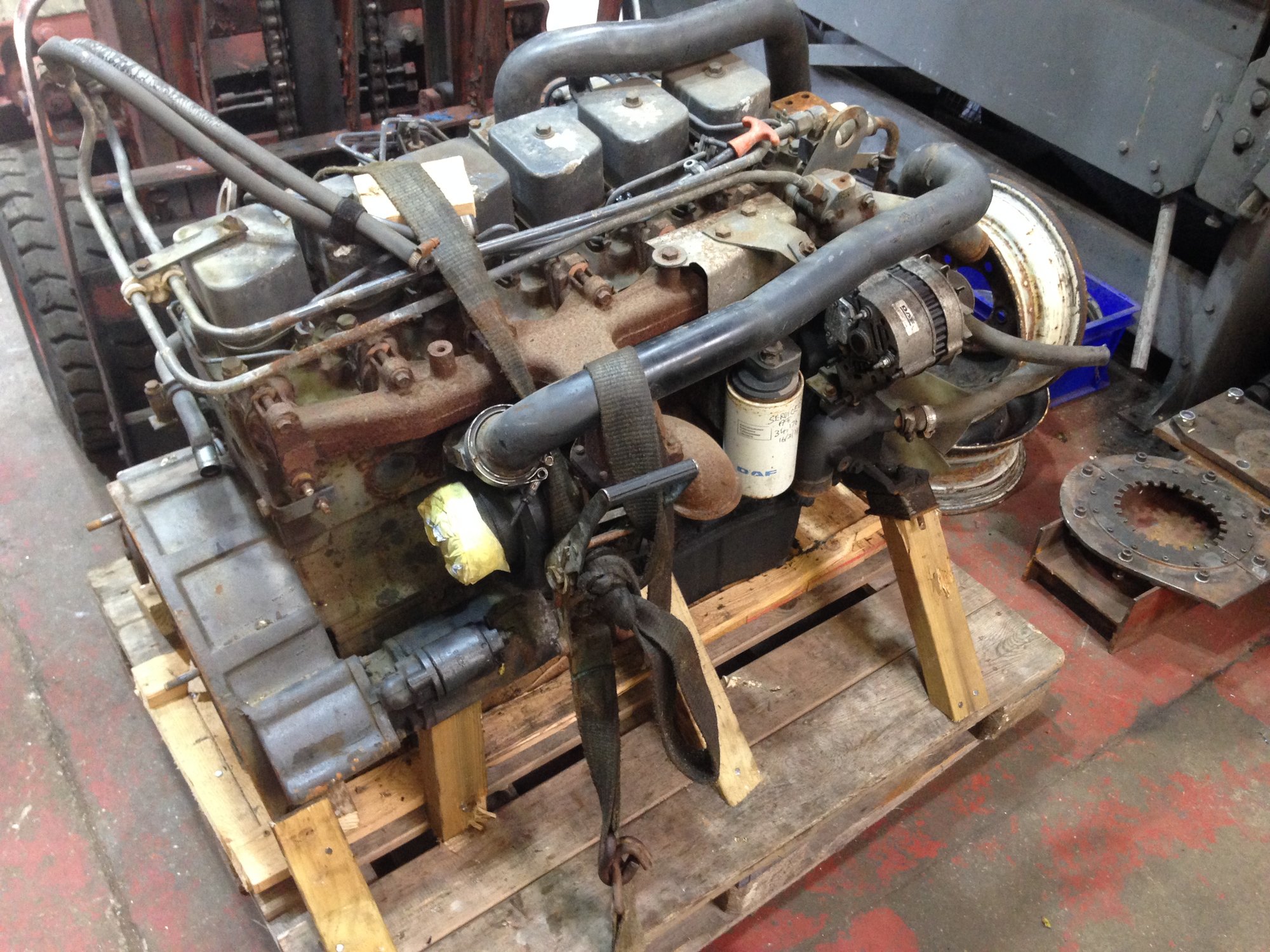

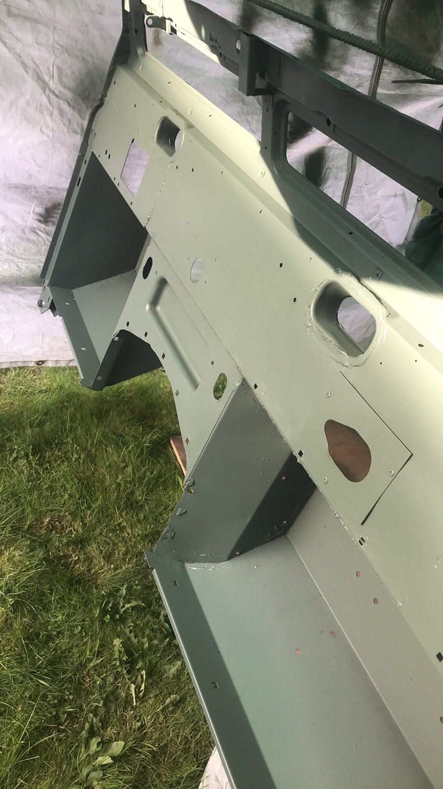

    bulkhead has been repaired and painted, no pictures of the repair work because frankly im useless and only ever remember to take photos after the jobs been done. bulkhead wasnt the greatest internally but itll get a load of cavity wax and live long enough to allow me to save up for a galv bulkhead. ill be raptoring the bulkhead and seat box to dampen resonance through the panels a touch.
    also new is the engine, provided by the absolute hero that is @8ob. its currently at work where itll be steam cleaned and tarted up a bit before being dropped in

    6bt's will see astro mileage if theyre looked after properly, and i trust @8ob when he says its been looked after
    stuvy likes this.
  9. 8ob
    8ob Forum Supporter
    Messages:
    4,555
    Location:
    moscow on thames
    Its fine, been stood a while now so could do with a mock up rad, intercooler pipes joined together and running for an hour. Very few miles on the truck it came out of, dont forget its drained of oil :thumbup:

    It’ll go on the test bed at work for some gentle running. Might even hook it up to the dyno if I’m feeling it :D

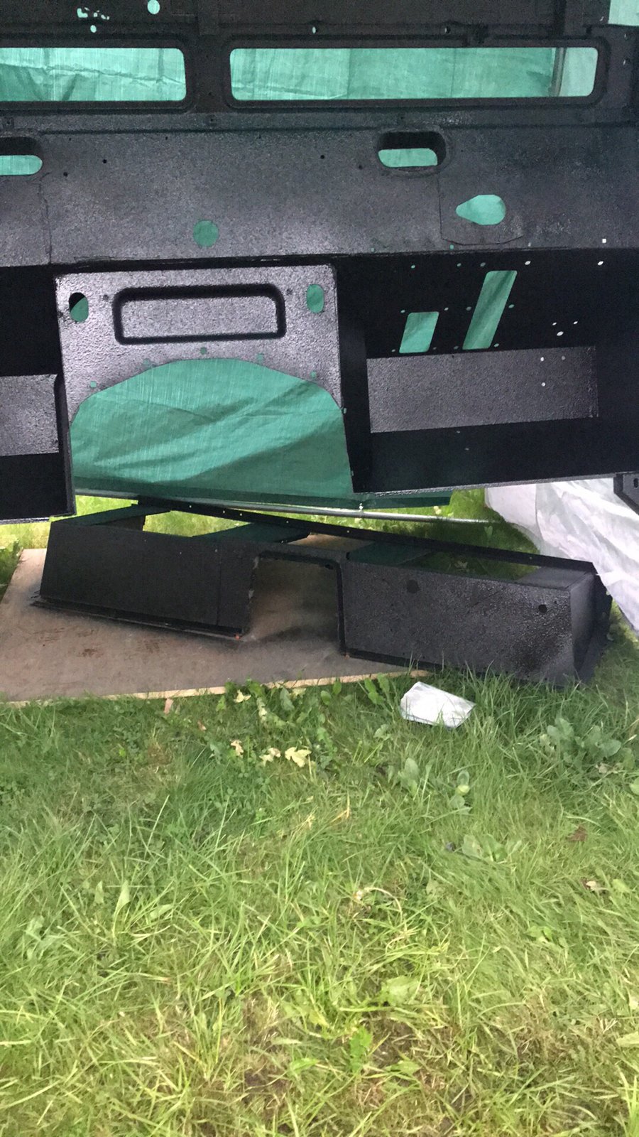

    Seatbox, floor plates and the cab side of the bulkhead now raptored in an effort to reduce panel “drumming”

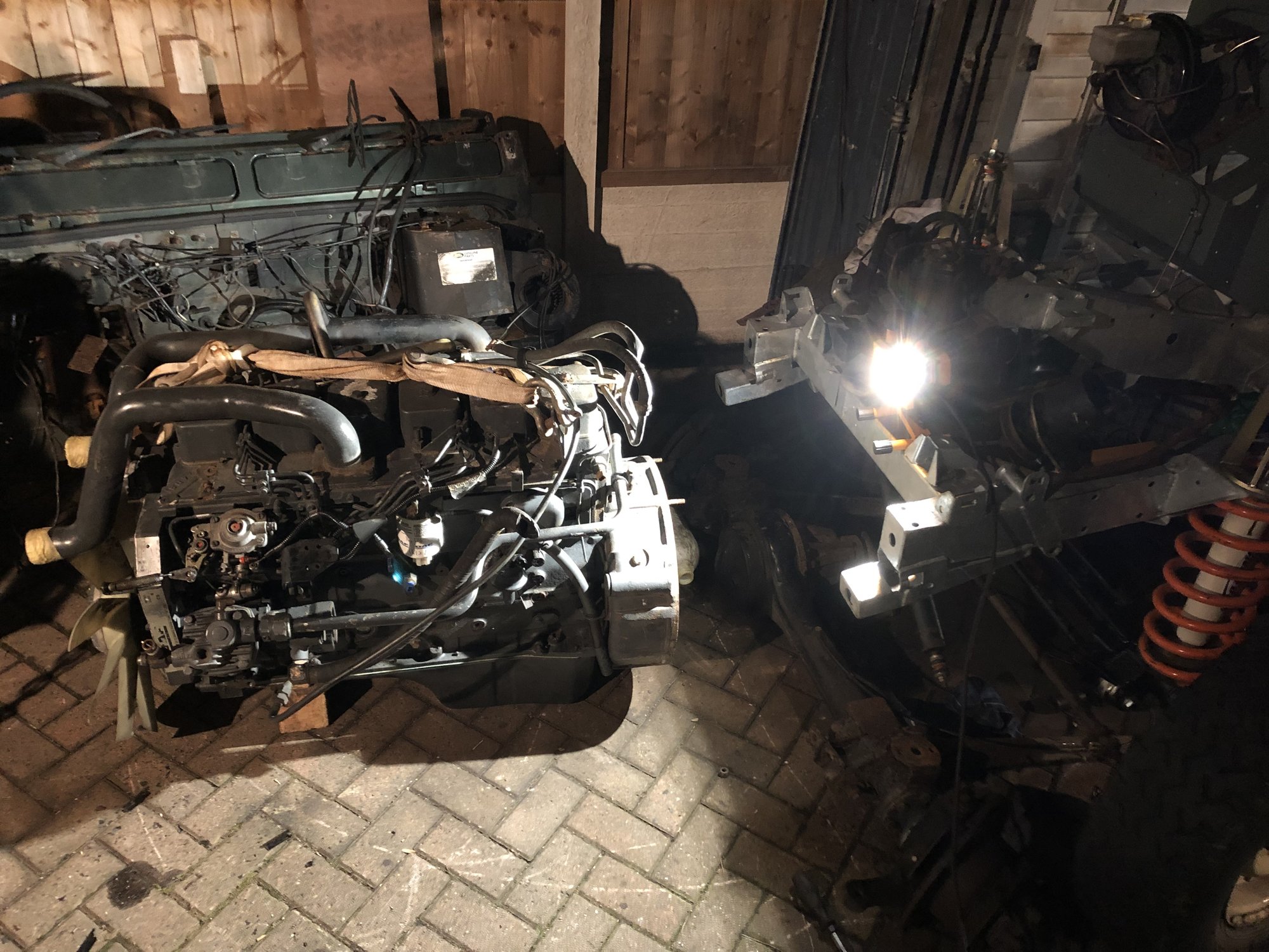

    Another small update, brake lines are now done, and the engine is ready to go in for its first fit :)

    My top top is if you get one, make sure you have a working engine crane to lift it. Nearly killed my self unloading it by hand the other day when I brought it home from work

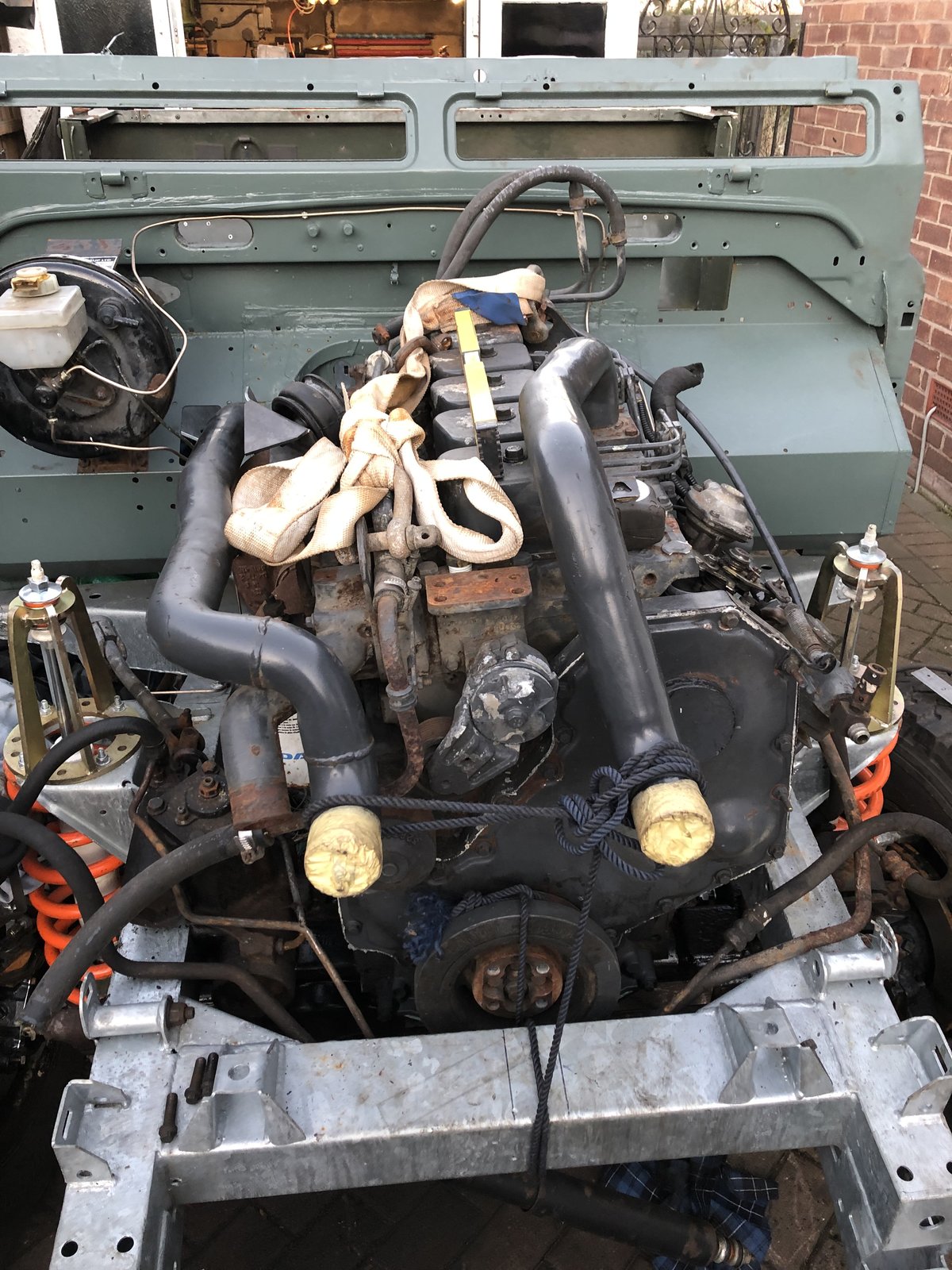

    It’s in.... sort of! Need to tweak the mounts to get it level and offset the right amount

  17. pressbrake1
    pressbrake1 Member
    Messages:
    1,578
    essex england
    get yourself a digital angle gauge or two to set the engine angle , your driveline kinematics will be correct then
    Tinbasherdan likes this.
  18. HopefullySoon
    HopefullySoon Member
    Messages:
    567
    Location:
    Heywood
    Can I ask How do you plan to tweak the mounts ?
    Shim up what's low and remove excess from what's high ? I'd guess if within reason .....
    If not reposition the mount to accomdate the tilt needed ?
    Malc
  19. Tinbasherdan
    Tinbasherdan Bodger in chief
    Messages:
    4,811
    Location:
    Bolton, England
    Crack the tack welds on the engine mounts and adjust them :)
