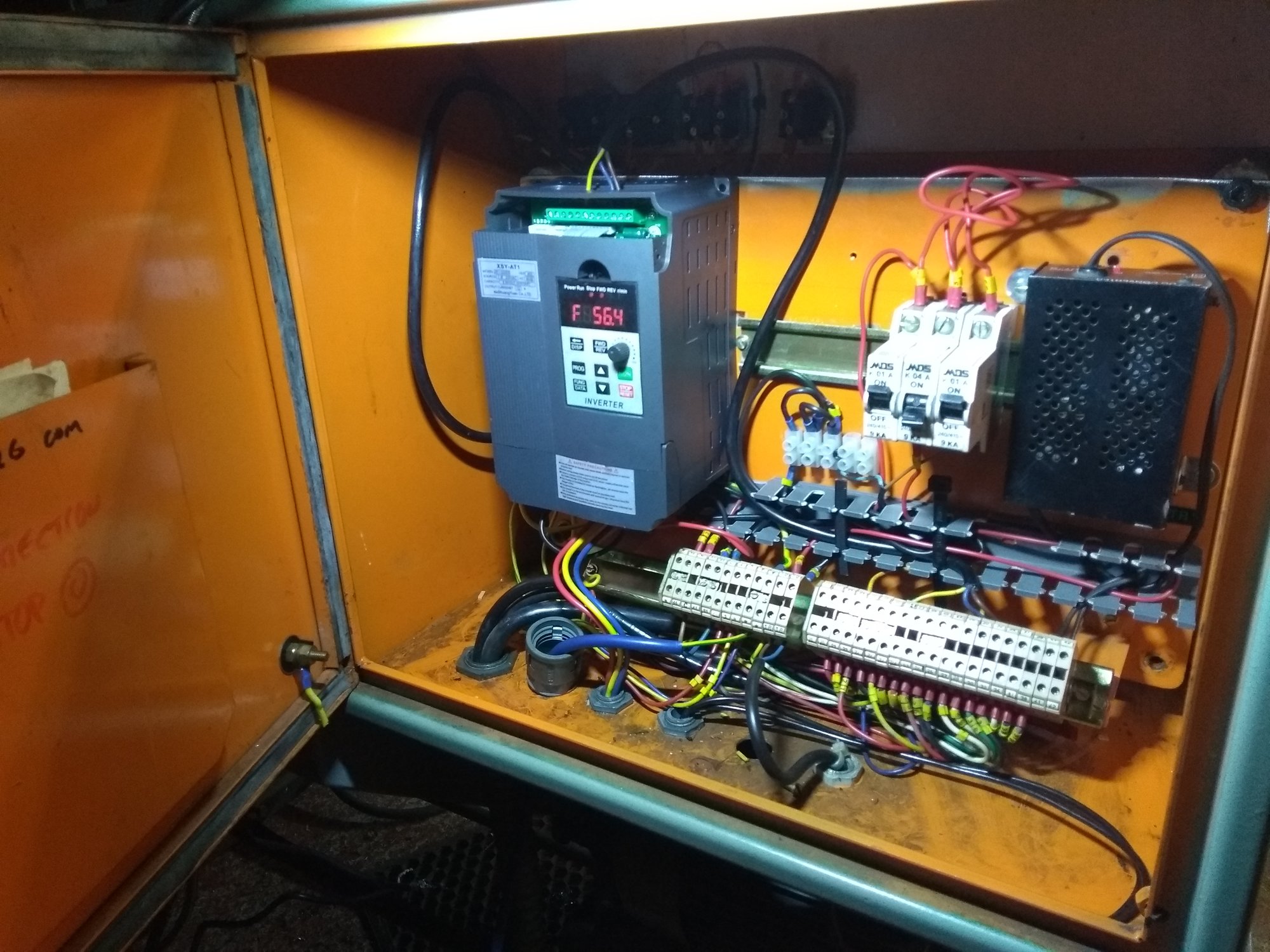

    Yea its huge overkill carl ,
    Have got it all back in the way i think it should be. 3 breakers for lights/pump/dro. 12v power supply for led lights and speed sensor. Will need to buy some glands n crimps to finish it off.

  2. Robbie260 Member
    Messages:
    594
    Location:
    Scotland highland
    Id rather that lot than a vfd personally as i know i can fix that but hey ho thats just personal prefference.

  3. Carl Wilson Member
    Messages:
    1,546
    Location:
    Moray
    Looks good Paul.
    With regard to having the old school set up vs the Vfd, if you haven't got 3 phase power in your shop then it's all redundant anyway, unless you are using a rotary converter.
    I can understand the point of it being easier to see how it works, but you still have to repair it by replacement.

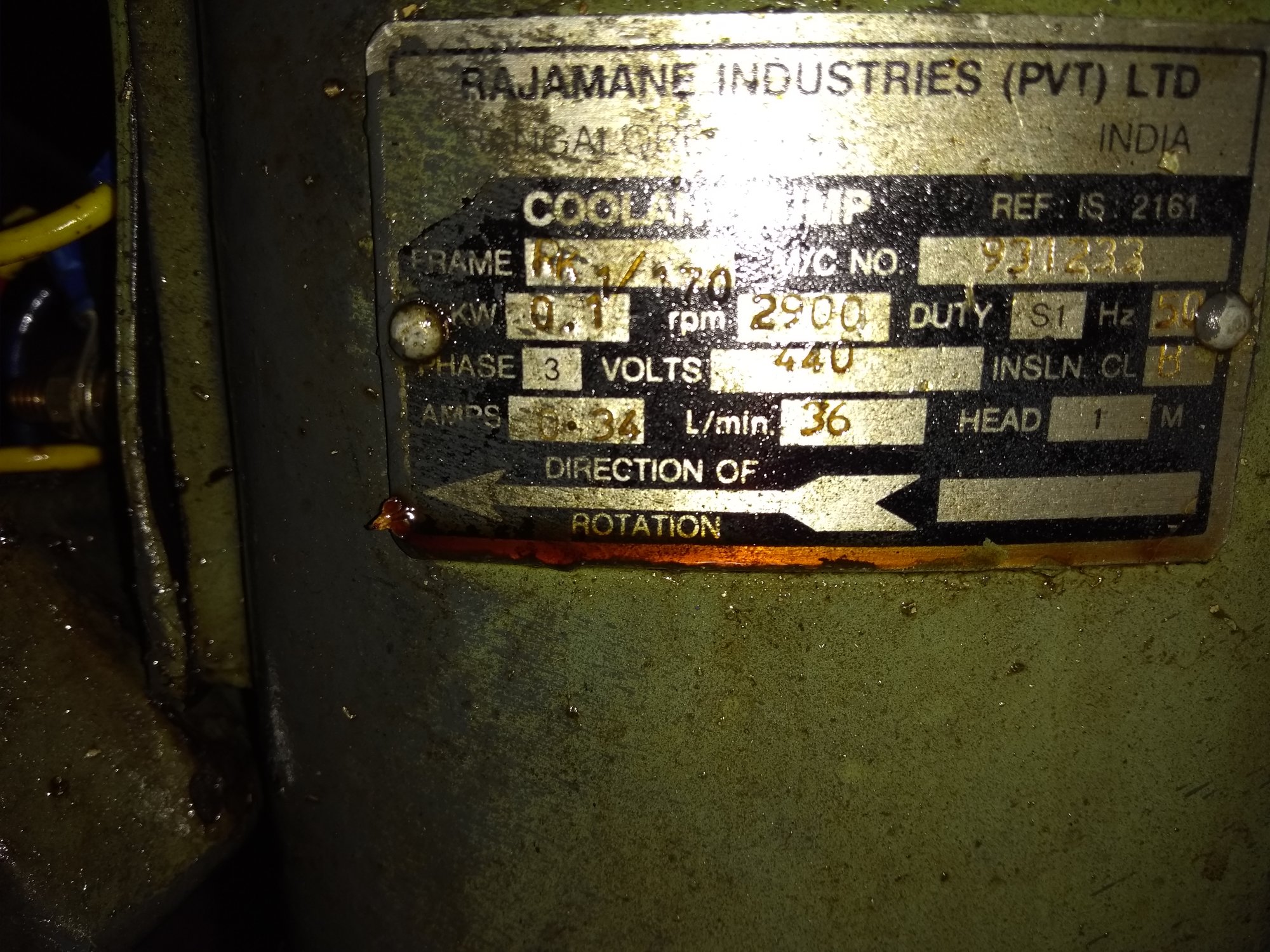

    Anyone throw a guess at what size capacitor i'll need to make this 3 phase sump pump motor into a single phase. Its 440v 0.1kw , going to 240v single phase with capacitor . no real load so might just work
    Or could I just parrallel it to the main motor running the VFD, got a feeling its a dumb idea but you never know

  6. Carl Wilson Member
    Messages:
    1,546
    Location:
    Moray
    So you'll have to rewire the motor to star. Edit.. . I mean delta. What a chimp. The current at 240 volt is 1.73 x the 415 volt current (ie 1/root3), which gives about 0.6 amps.
    To calculate the capacitor:-
    Amps/(2pi x freq x volts)
    So
    0.6/(2 x 3.14 x 50 x 240)
    Gives
    7.96 micro Farads
    Or 8 micro Farads for cash.
    Make the cap at least 270 ish volts working voltage.
    Don't run it off the vfd. One singer one song.

  7. Seadog
    Seadog Forum Supporter
    Messages:
    5,071
    Location:
    NE London - UK
    The motor should be wired in Delta. That is, assuming it is Star at present. If it's 440v Delta then you're scuppered (or put up with a slow pump).

  11. paulhar
    paulhar Member
    Messages:
    27
    Location:
    scotland
    cheers folks , have bought a 8 uf cap to see if it works . unfortunately is permanently wired 440v no star delta options ....so hopefully it has enough oomph to work

  20. paulhar
    paulhar Member
    Messages:
    27
    Location:
    scotland
    Well capacitor took a while to get here but it works , takes a reasonable grip of my fingers to stop the shaft so it should pump OK.
    voltage over the capacitor is 170 v , supply 240v and final phase 380v . Not sure if i need to go up or down in value to get it better ballanced , or if its even worth changing.
