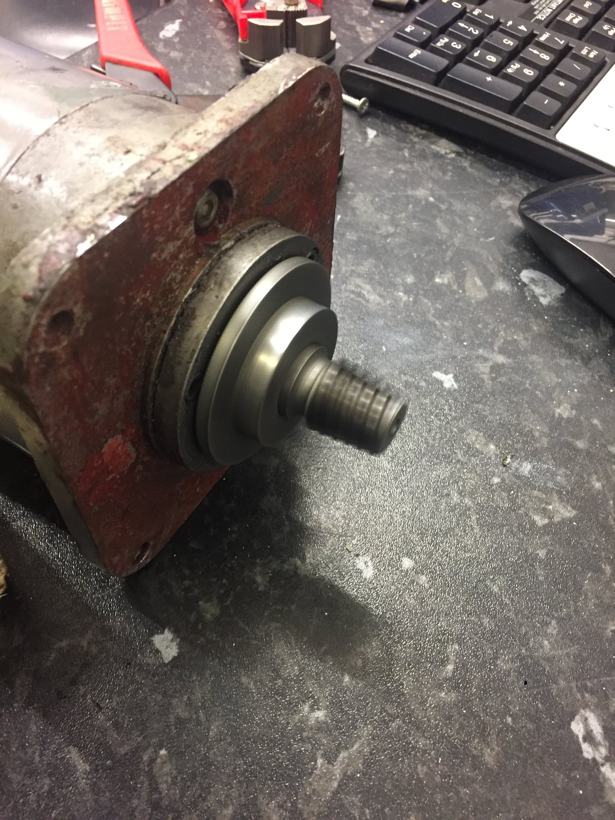

Trouble is i cant get collets for it.I reckon that your mill that doesn’t have a ram even being small is stiffer than a Bridgeport.
I hope to start playing with it in the next couple of weeks..
What taper is it?Trouble is i cant get collets for it.
Pass....lolWhat taper is it?
What mill is it?Pass....lol

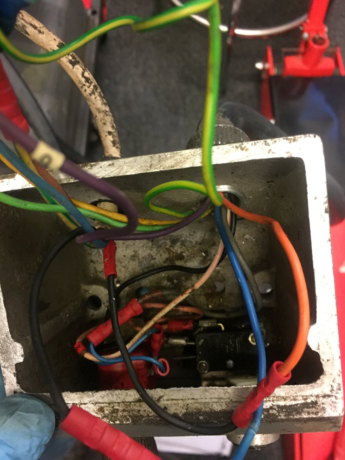

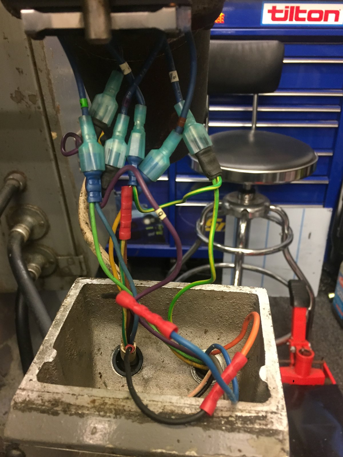

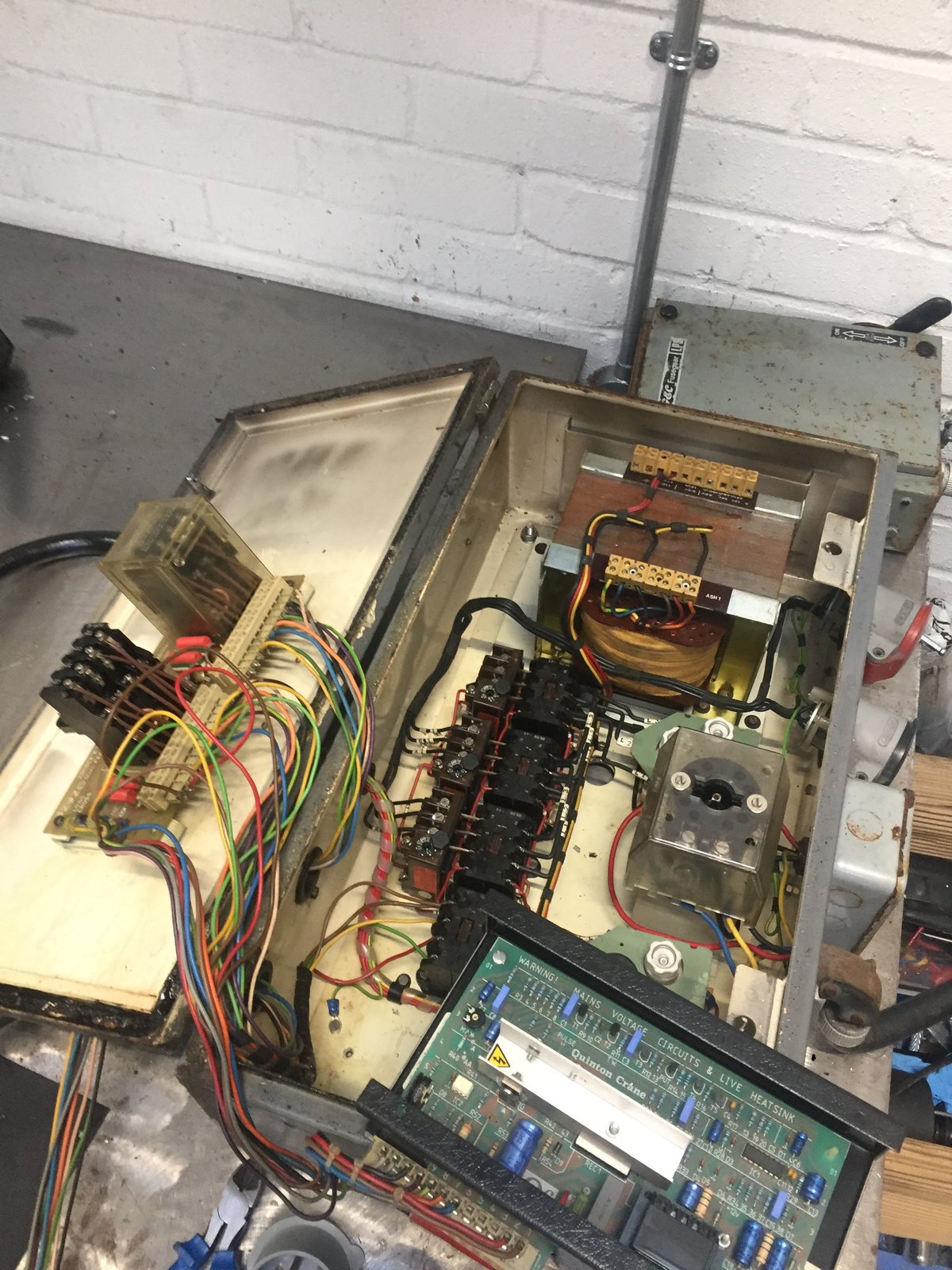

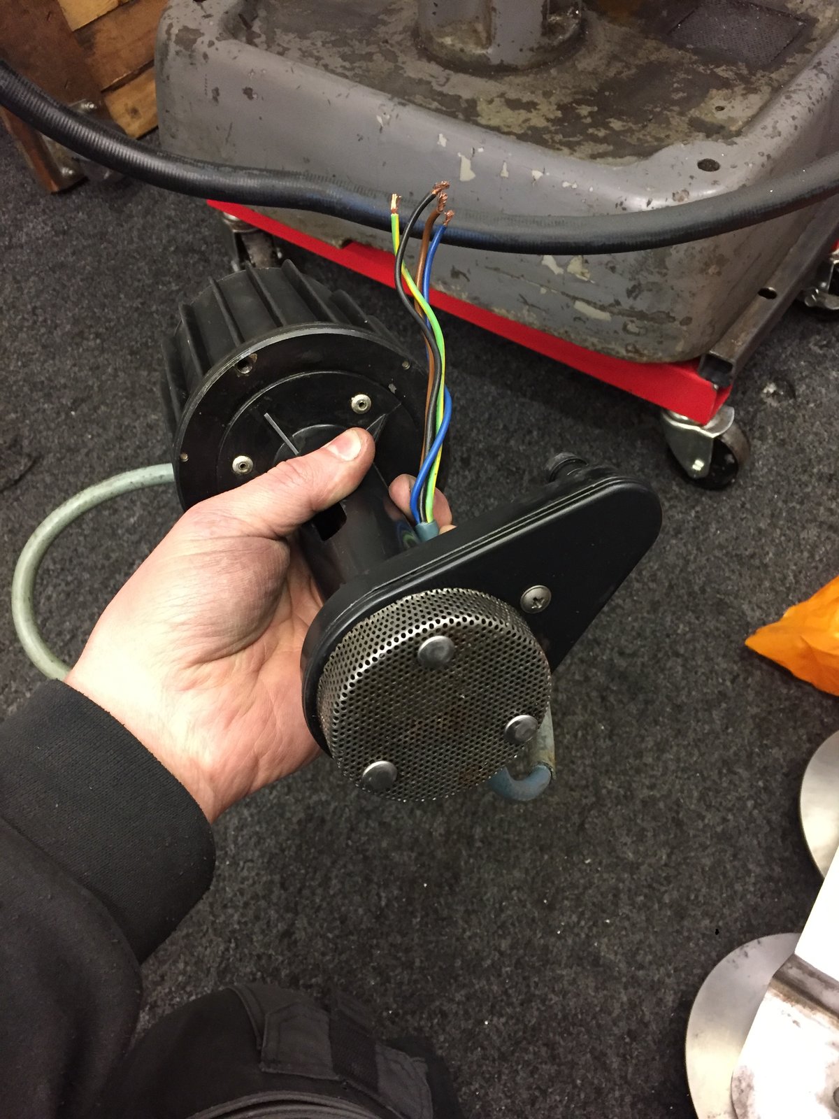

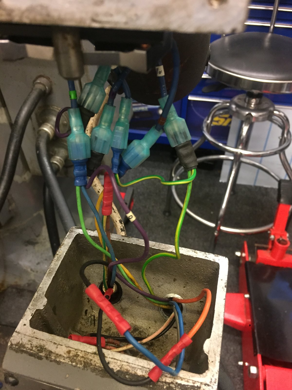

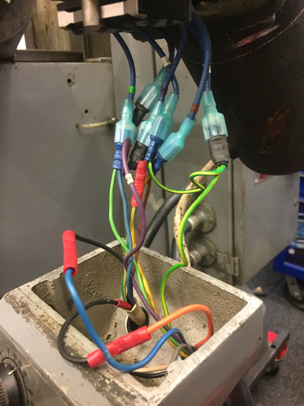

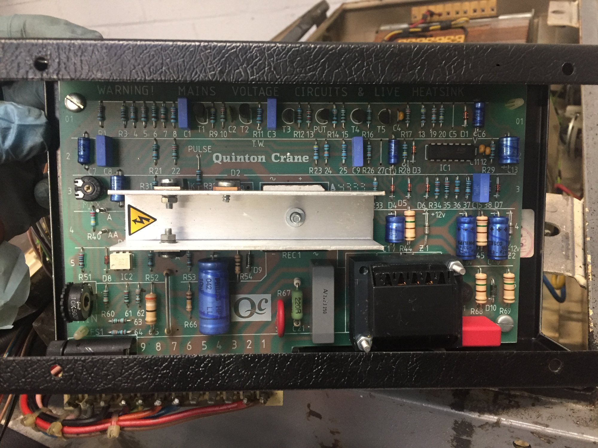

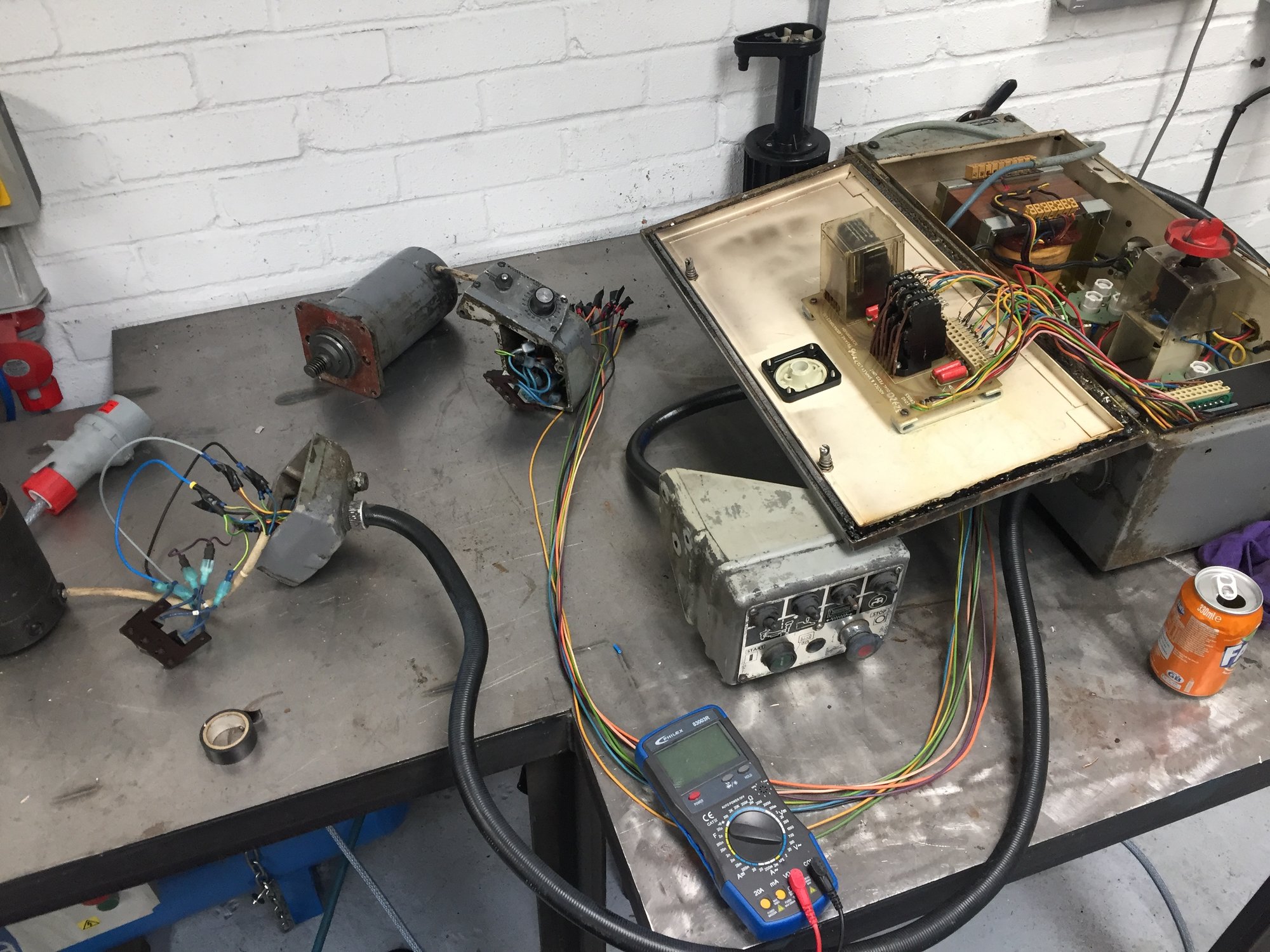

Well I took all the wiring cabinet and feed set ups to work today to run properly from a 3 phase supply and see what works
All the contactors for everything is working

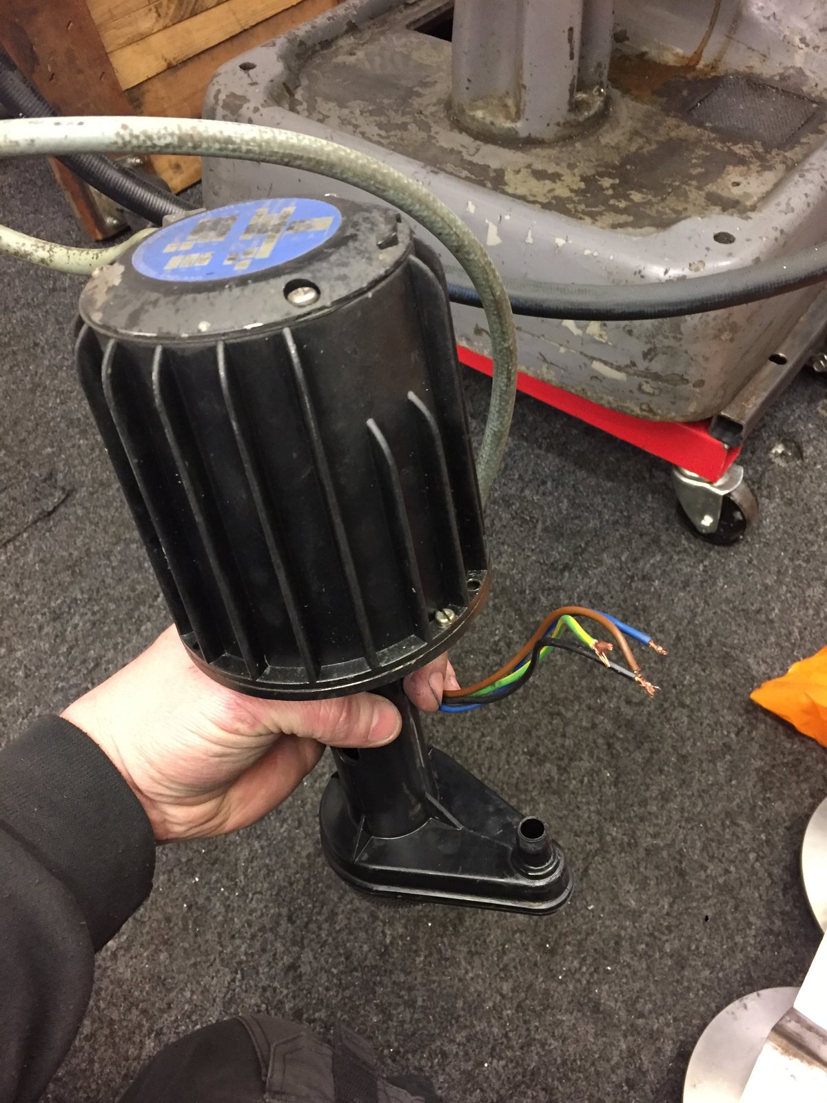

Suds pump works as should
Motor works as it should
Light works as it should
Aux 16amp 415v socket works
Twin 240v domestic sockets work
Contactor for power feeds work

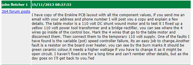

But the feed motors still do nothing! And I have no idea what where when or why as there’s 2 circuit boards and the potentiometers etc and testing that lot is beyond me unfortunately

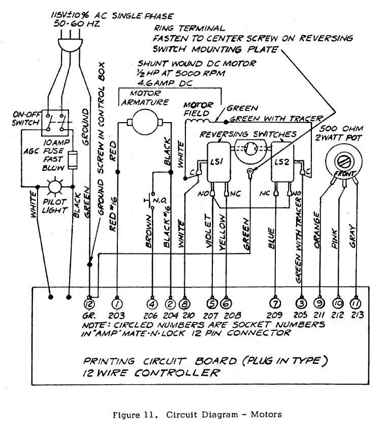

Actually it is the way it is in the manual, I know because I scanned it......It has an incomplete wiring diagram near the end......
