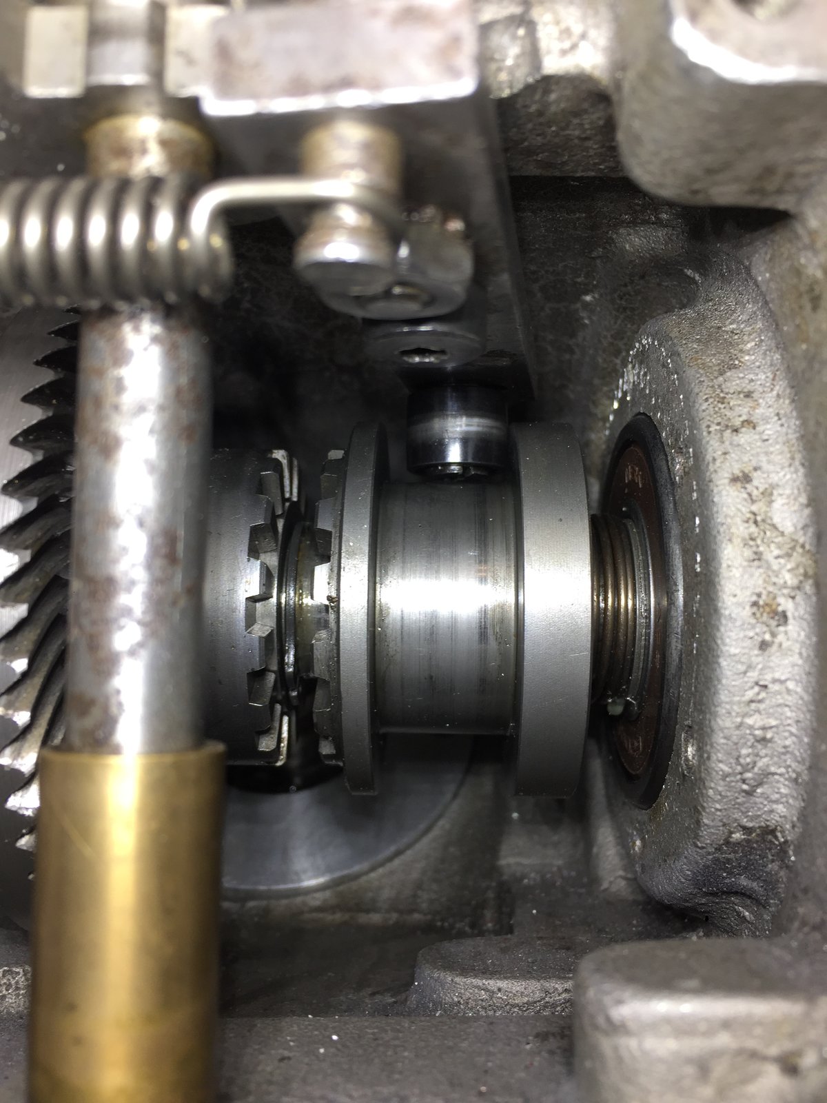

Next up I’ve started on the powerfeeds but to me the motor noisy? Is this normal
My step down transformer is feeding 123v too the motor not 110v could this be the issue as it’s a 90v motor?
Also where I mention the clutch/ dog teeth trying disengage I think this could be solved by a larger dia roller on the pivot armto push the clutch dogs over that little bit more. You can the the roller on the lever pivot arm in this pic and the gap that there is to the left, where the roller bolts is slotted but it’s already adjusted fully left and can’t go any further
