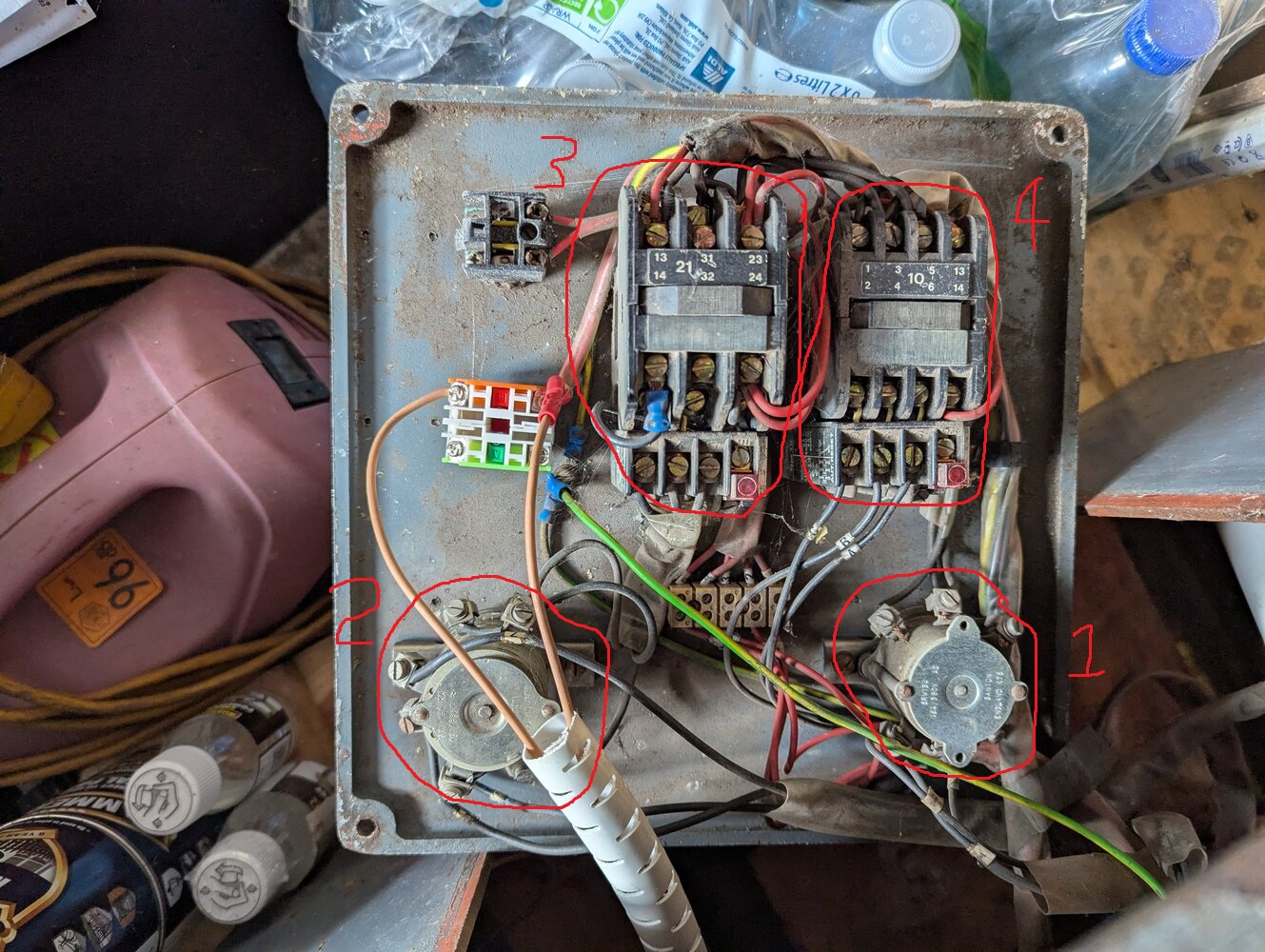

Yes, that's right, the contactor I've marked as 3 is for the spindle, the switch marked 2 is the spindle switch, the coolant pump switch is marked as 1 and the contactor marked as 4 has the black wires labelled A, B, and C which go to the power feed for the table.No need to do that - it's a really simple system.
You've got two contactors, a start button NO, a stop button NC, a spindle direction switch and presumably a coolant pump switch.
The first contactor (with the large numbers 21) is for the spindle by the looks.
The second contactor with output cables A,B,C seems to disappear off into the machine. I'm guessing a table motor for x-axis travel? Must have a separate button or switch somewhere?

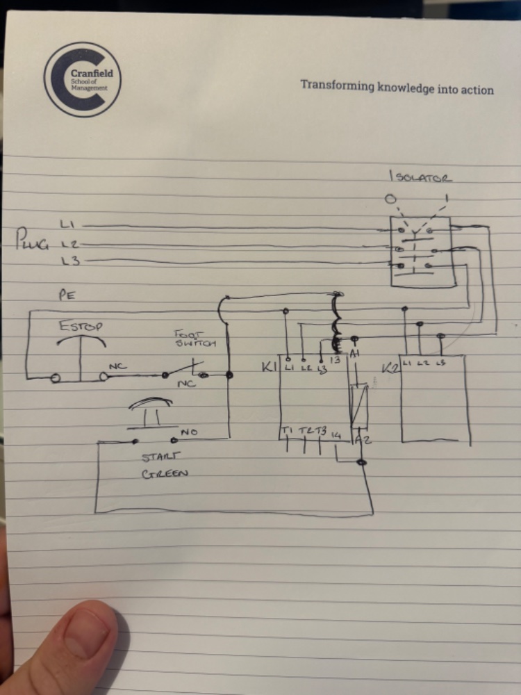

Tell me what the second contactor is for and what sort of button/switch controls it and I can draw you a diagram.

Ha, okay, I'll draw you a diagram okay. Give me a minute.Yes, that's right, the contactor I've marked as 3 is for the spindle, the switch marked 2 is the spindle switch, the coolant pump switch is marked as 1 and the contactor marked as 4 has the black wires labelled A, B, and C which go to the power feed for the table.
This is the switch for the table with the black wires from the contactor above labelled A, B, and C going to it:
