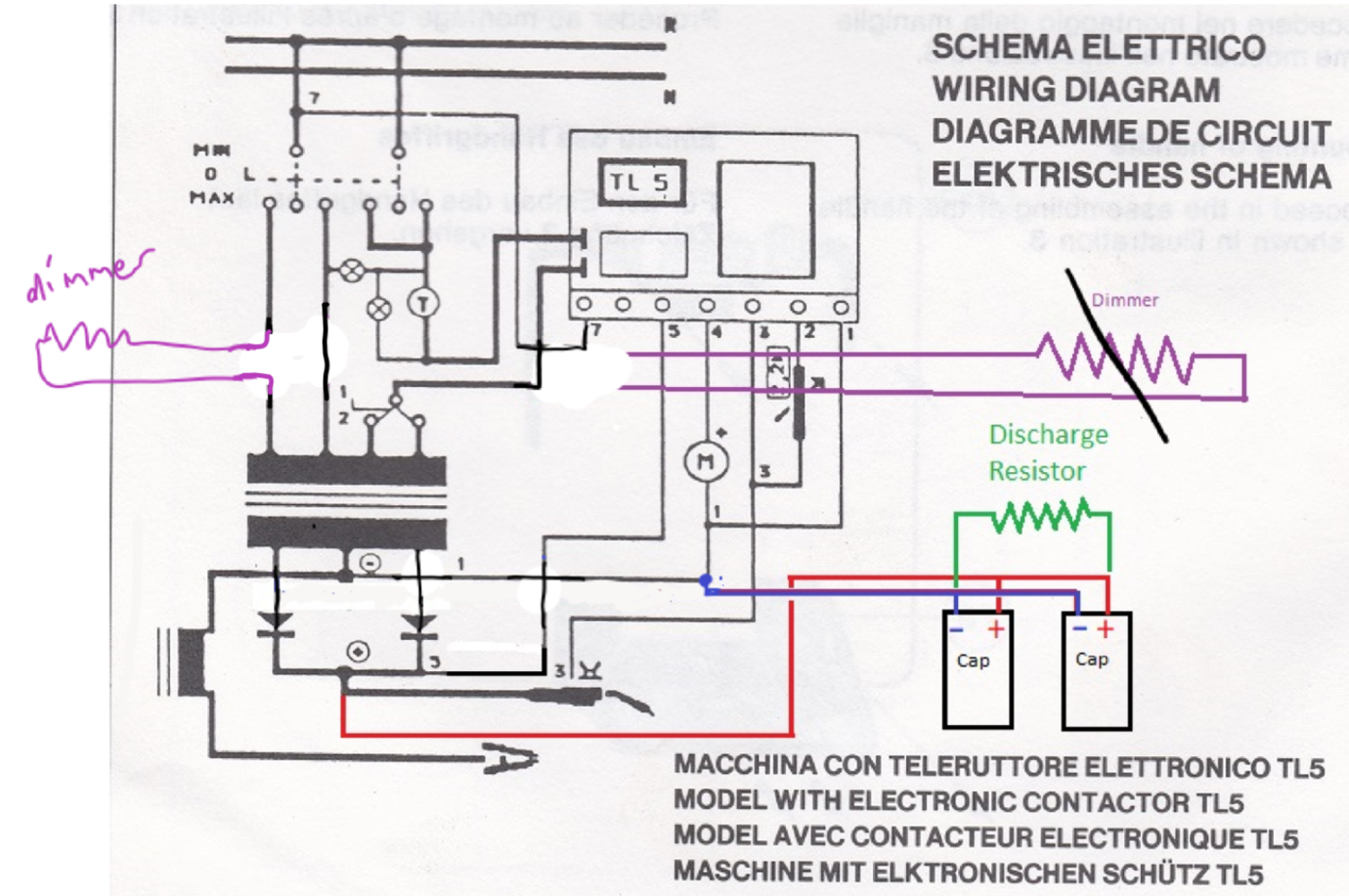

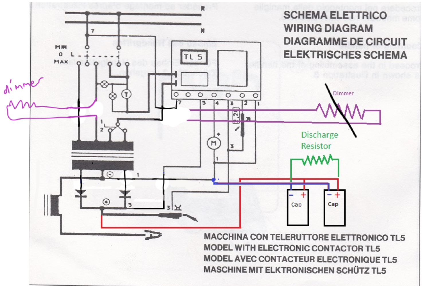

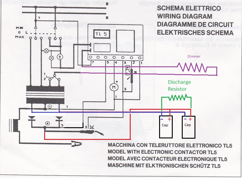

Something to consider in the future:
- adding a bank of high-grade screw-terminal capacitors across the DC rectifier output ( before the inductor ), up to 50,000uF at 50v or more. For example:
- using a "light dimmer" on the transformer primary to fine-tune the power output "sweet spot" between 28 and 40 Amps:
NOS SIEMENS Capacitors 10000uF 100V 4 PCS Screw Mount 63x112mm NOS Quality | eBay
Find many great new & used options and get the best deals for NOS SIEMENS Capacitors 10000uF 100V 4 PCS Screw Mount 63x112mm NOS Quality at the best online prices at eBay! Free delivery for many products!
www.ebay.co.uk
5000W AC Motor Controller Power Controller Stable Durable for Controller | eBay
Find many great new & used options and get the best deals for 5000W AC Motor Controller Power Controller Stable Durable for Controller at the best online prices at eBay! Free delivery for many products.
www.ebay.co.uk
