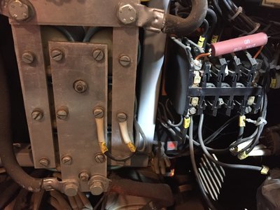

  7. eddie49 Member
    Any MIG welder worthy of the name should already have an inductor ( choke ), normally in series with the welding return lead ( "earth" lead ).
    The added capacitor(s) should be fitted just after the rectifier, across the output, before the inductor.
    Three or four of these capacitors wired in parallel with busbars should be enough:
    https://www.ebay.co.uk/itm/Kendeil-...-Aluminium-Electroltic-Capacitor/222562911534
    Some welders use the clever idea of an extra pair of normally-closed contacts on the contactor to only put the bleed resistor across the capacitors when the contactor drops out, and take the bleed resistor out of the circuit when the welding power is on. That way you can have a lower resistance value, such as 20 to 30 Ohms ( = quicker discharge ), and it doesn't waste power during welding.

  15. eddie49 Member
    You could try just one large one, but most machines that are originally designed to include caps use a bank of medium-value ones:
    There is a thread on here discussing the advantages ( if any ... ) of sharing current across multiple capacitors.
    Are you planning to weld thin steel, or thick ( >3mm ) stuff? If thin, is your current lowest setting OK for you, or a bit too high?
    Bear in mind that capacitors will store energy and smooth the ripple that you normally get with simple rectified AC, thus increasing the average power at each setting. A large value - 50,000 uF - compared to a smaller one - 20,000 uF - may make the lowest setting too high for thin metal.

  19. eddie49 Member
    Without trying it, it would be hard to predict exactly what the effect of adding 5,000 or 10,000 or 50,000uF of capacitors will be, and whether it will be helpful in your usage of the welder.
    With capacitors in parallel, the total effective value is the sum of the individual sizes. If you buy one or a few smaller caps, e.g. 5,000uF, you can start low and keep adding, but if you can get that 47,000uF/50v for a decent price, then give it a try. That 50v DC rating is on the limit - my Sureweld Monomig 140 has an open-circuit voltage of 43v on the highest setting. You can check your DC volts from the torch tip to the earth clamp at the highest power setting.
    For this type of application, the best capacitors are those called "Computer Grade", or "Low ESR" ( equivalent series resistance ), or "High Ripple Current", and with large screw terminals, rather than solder or push-on tags.
