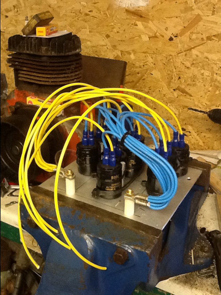

    image.jpeg image.jpeg just replaced the capacitor bank in my old Automig, the cheapest option was good old eBay - unfortunately the closest quality ones I could find were half the value- so I bought 10! Good job the case has plenty of room! It's made a massive difference to the way the machine runs!

    you are actually better having more caps of a smaller size to make up the large value that you want, because they each charge and discharge quicker. That therefore makes the setup more efficient.

    Sheffield UK
    How does that work? A smaller cap will charge/discharge more quickly than a bigger one, but you're using more smaller ones so the resultant charge/discharge time will be the same. Capacitance is a measure of the time a cap takes to charge, so the charge/discharge time should be independent of the number of actual capacitors, I would have thought.

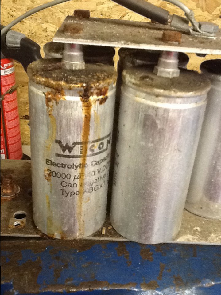

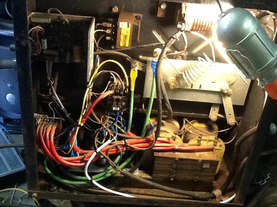

    The welder power seemed to have dropped, when I opened it up I spotted this. I found a nasty looking corroded joint in the output as well.
  17. rtbcomp
    rtbcomp Moderator Staff Member
    Messages:
    18,615
    Location:
    Sheffield UK
    A bit of giveaway!
    Rig Pig likes this.

    Look at the size of those terminals they are huge, are they double ended ie a terminal at either end ?, that would be so that the plates act as heat sinks to rid the system of unwanted and restrictive heat build up.
    Are your leads just push on lucar type terminals, if so you might be better soldering the leads direct to the terminals, because the blue are only good for 15/20 A, you may find that they become hot and burn at that point.
    Again only my view, on mine I used yellow crimps but mine where screw terminal caps to test the principal and they got warm so the blues might be over their limit.

    Yes the connections are push fit, I will keep an eye on them and the banks temperature when I give the Mig some serious use to make certain I don't get any nasty surprises! If the connections are rated 15-20A each I have 150-200A rating, the Mig is 180A max so I hope I won't have a problem.
