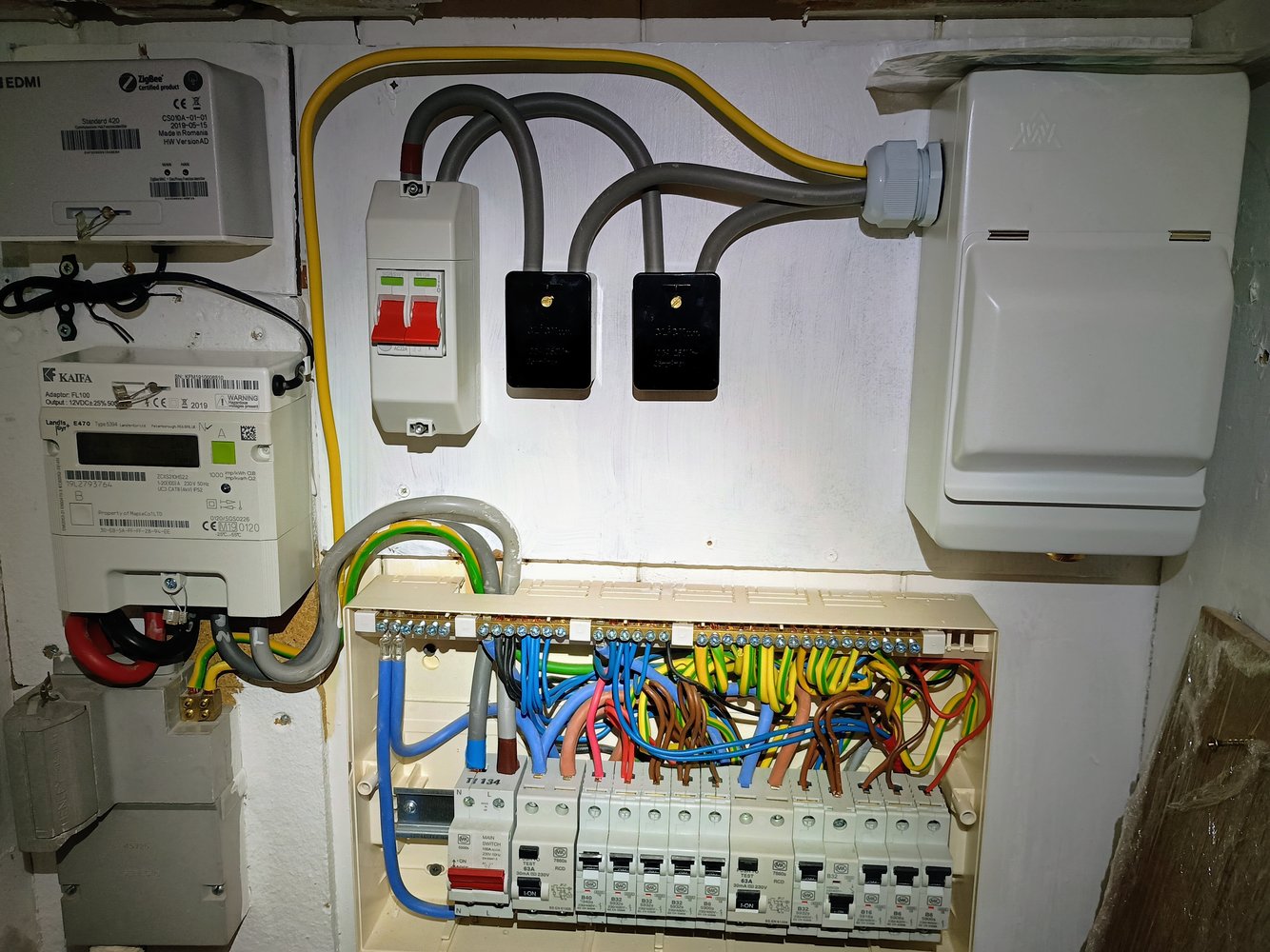

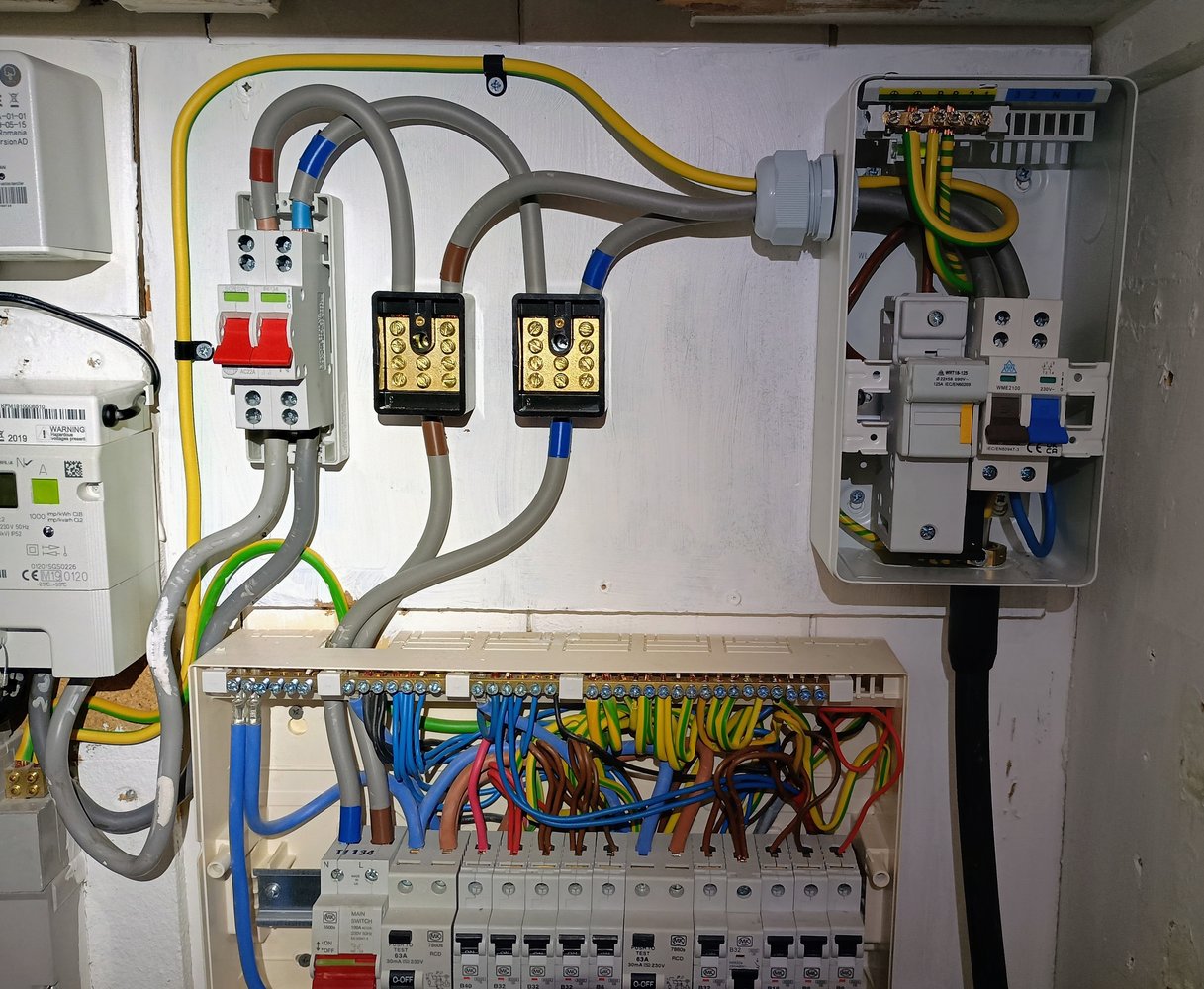

Just remember to isolate everything before you pull the fuse so you're not pulling it under load
i put one in at a pub under load and knew it was comingJust remember to isolate everything before you pull the fuse so you're not pulling it under load![]()

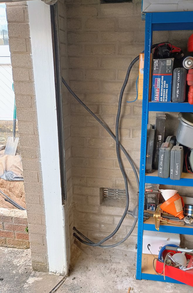

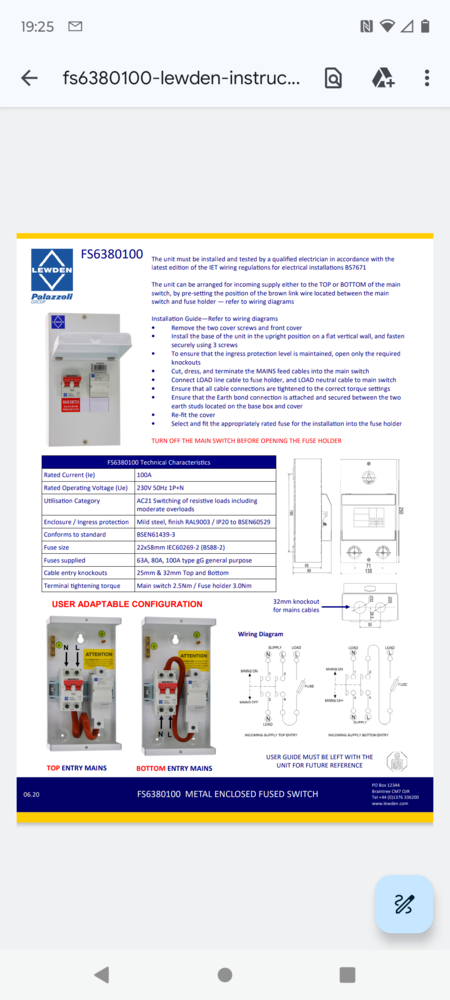

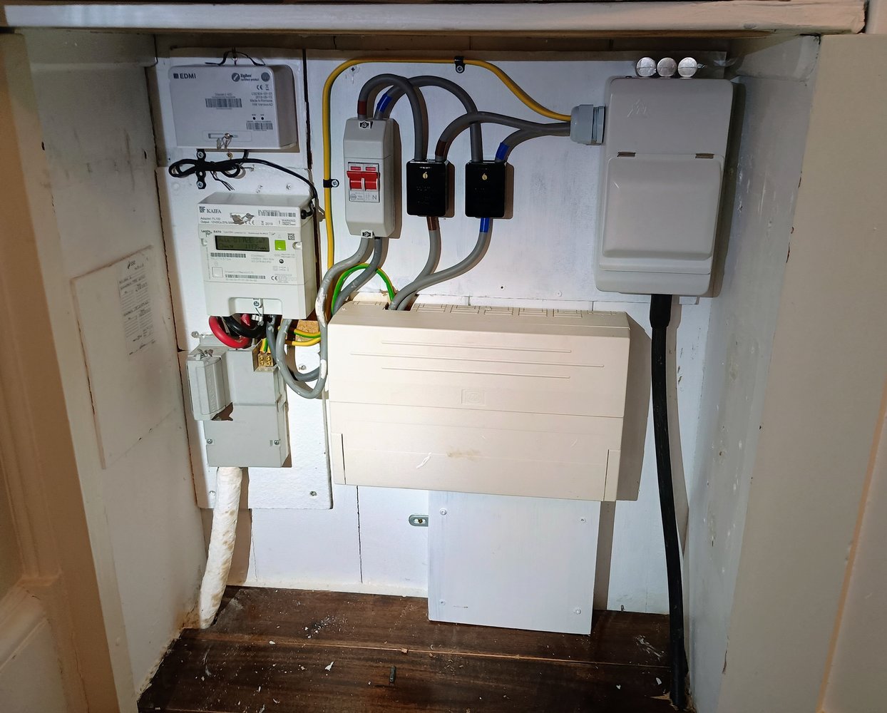

Actually, this one could be OK, if I put it right over to the right and get the SWA access on the right at the base.
Get a Lewden one. They can have in/out either end if that helps. Fitted one recently though I swapped out the DP isolator for a Type S 100mA RCD. (TT incoming and then SWA supplying an outbuilding).

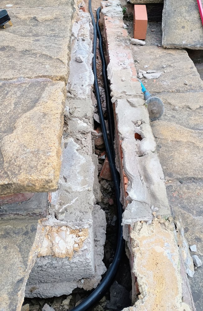

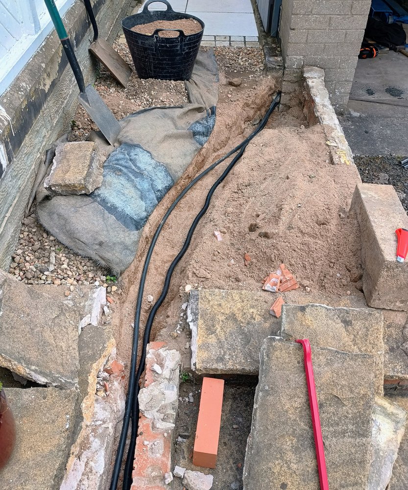

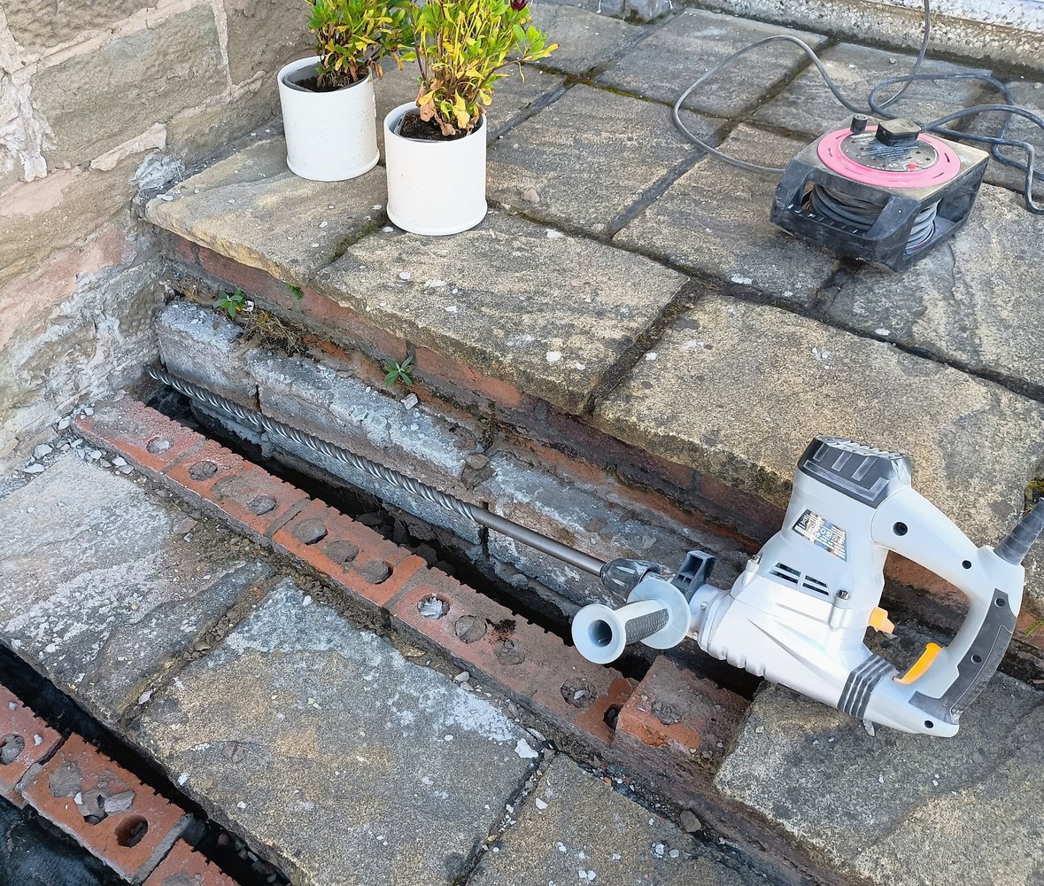

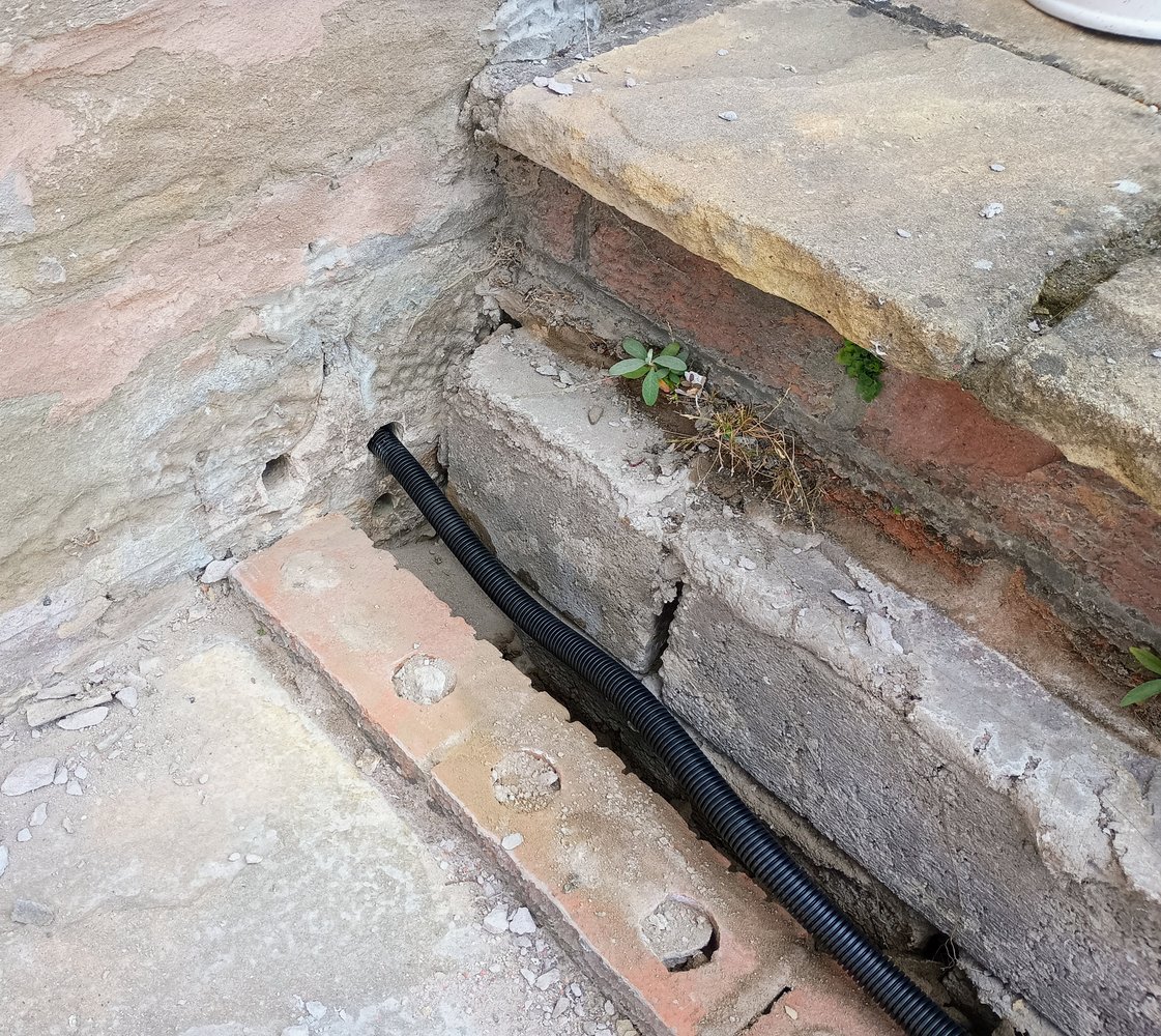

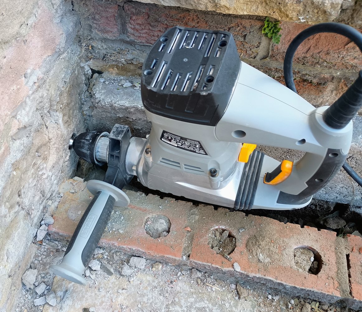

Would have been preferable but crawl space in that area is restrictive. Not too worried about water funnel as it's dry down there.Can you not drill from inside to out? You don't really want a water funnel do you?
Done, second hole for SWA will now easily clear the fireplace foundation, will just have to be chased into the brickwork a bit.

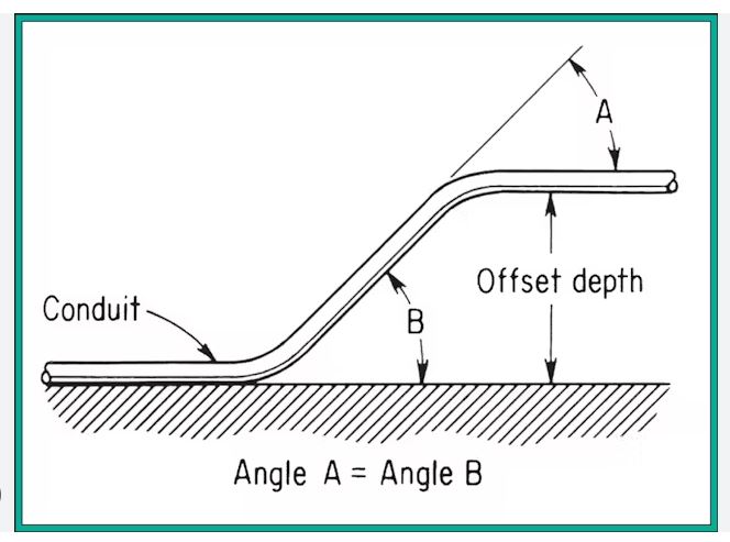

Pull a bit back and bend it to shape like you would with pipe.What's a set? Screw a block to the wall behind and the the SWA clip into it?
