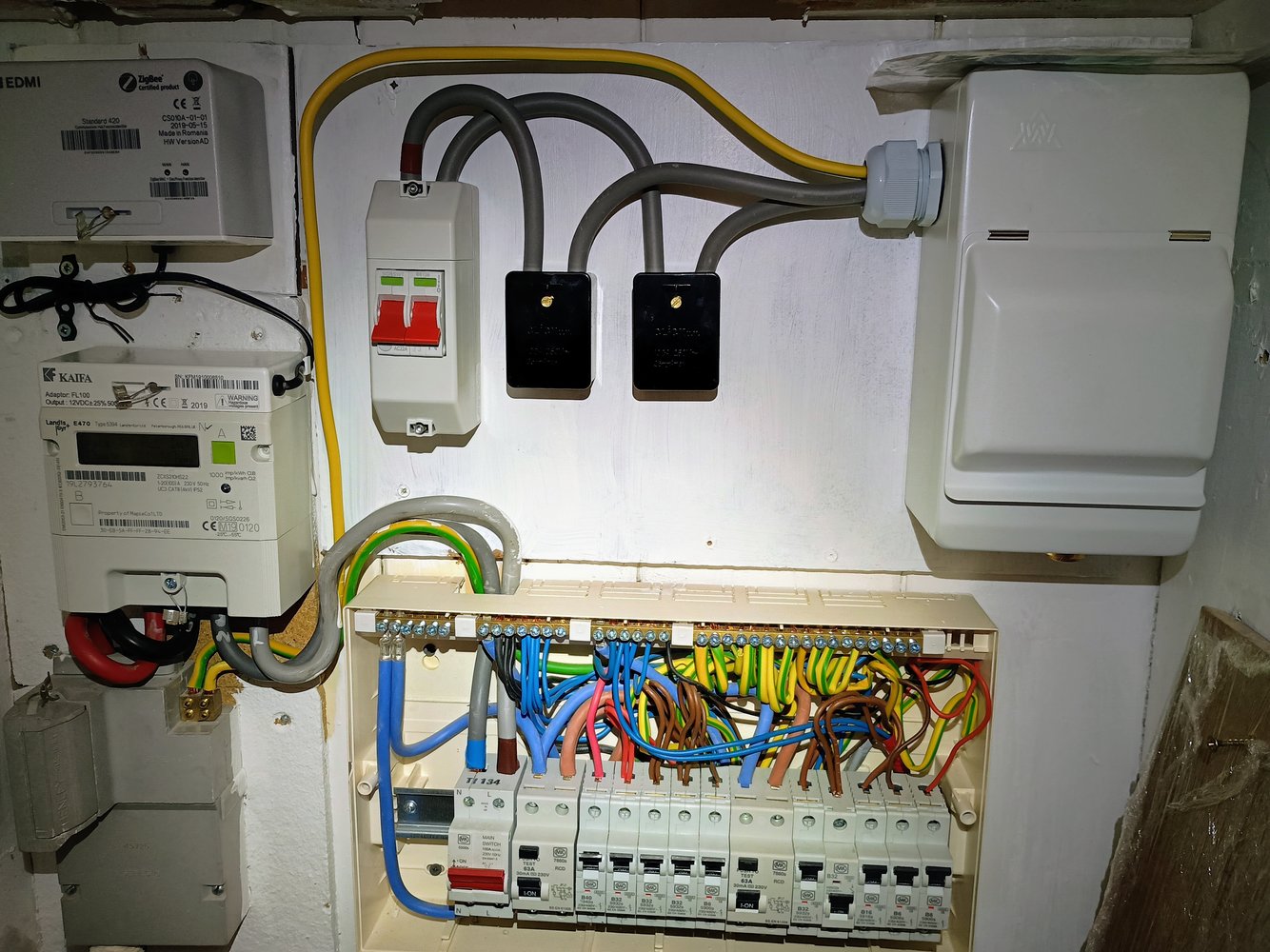

What is that anyway? Comms Hub, or part of it? It's not the actual meter.
Do meter readers actually still exist? Or are they a thing of imagination now, like TV detector vans and policemen.generaly if its the main cutout fuse seal broken the meter reader reports it if he can be bothered and they send someone out to replace it if there not very busy![]()

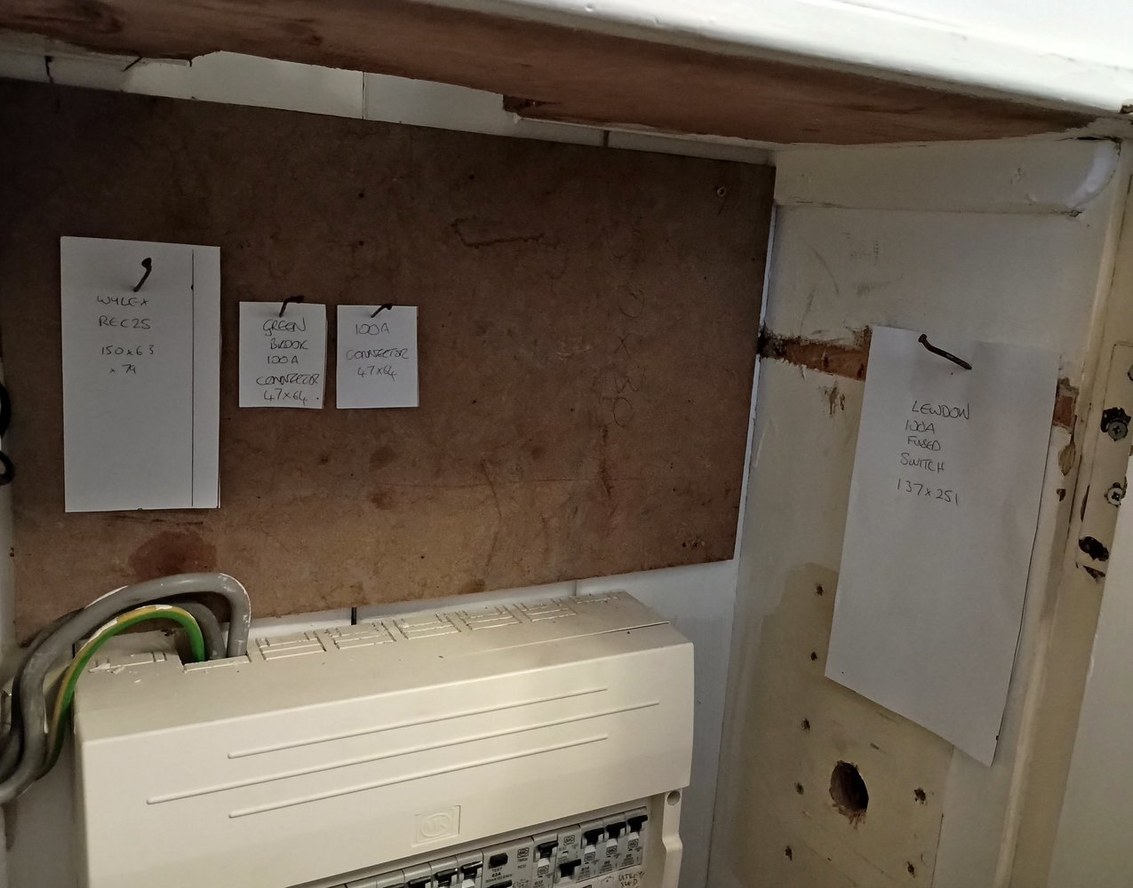

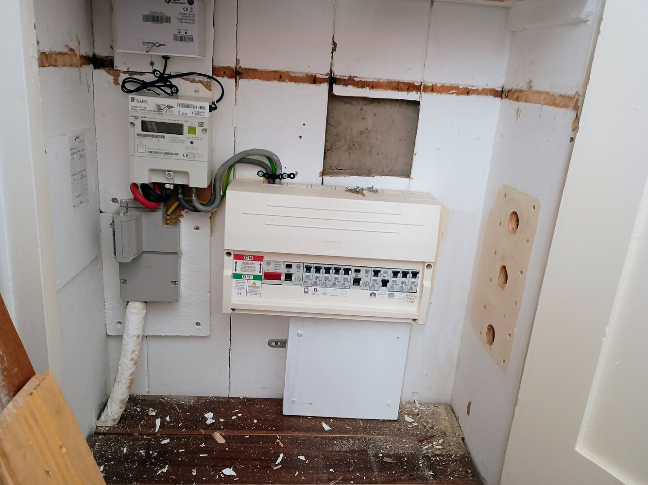

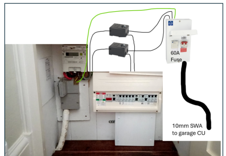

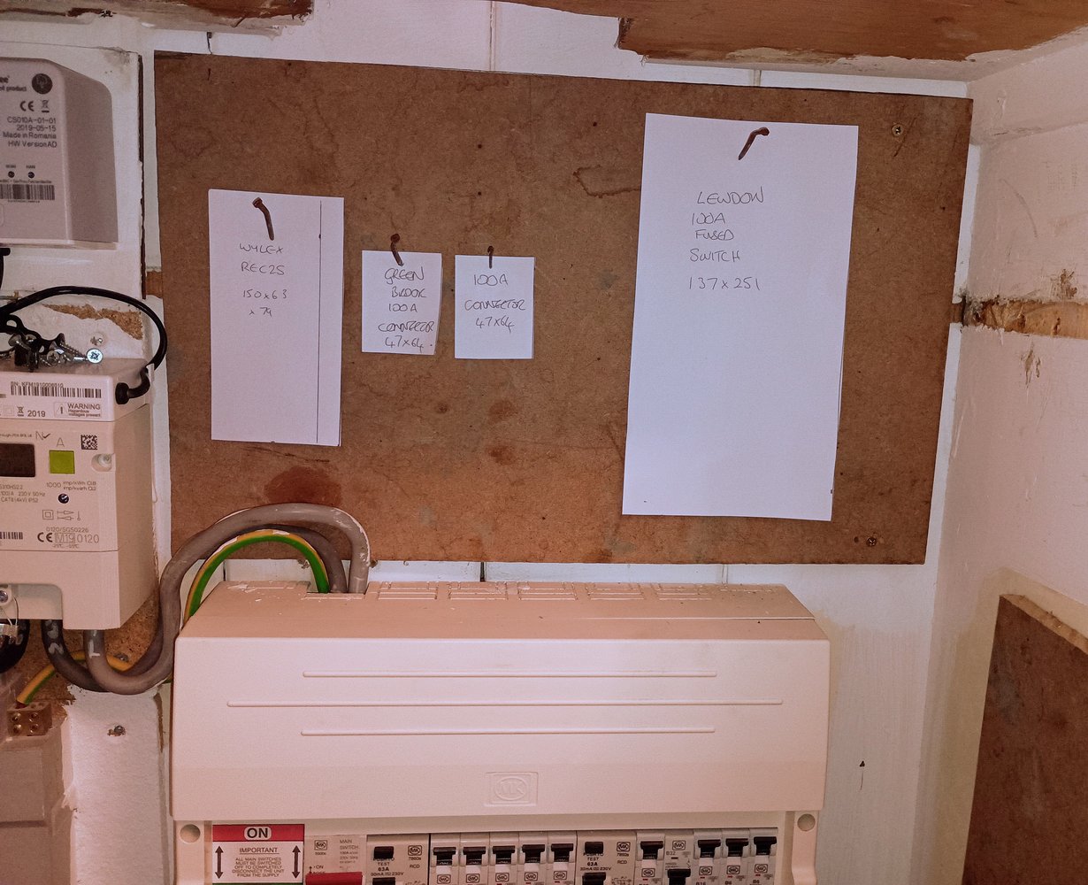

That looks about how my holiday cottage charging point is done. Though if you going to the trouble of T ing at the Tails you might as well fit an isolator up stream too.I'll get back to this job soon, the existing garage CU is fed from the main house CU with 4mm twin and earth. I plan to change that for 10mm SWA. Is the following an acceptable plan.

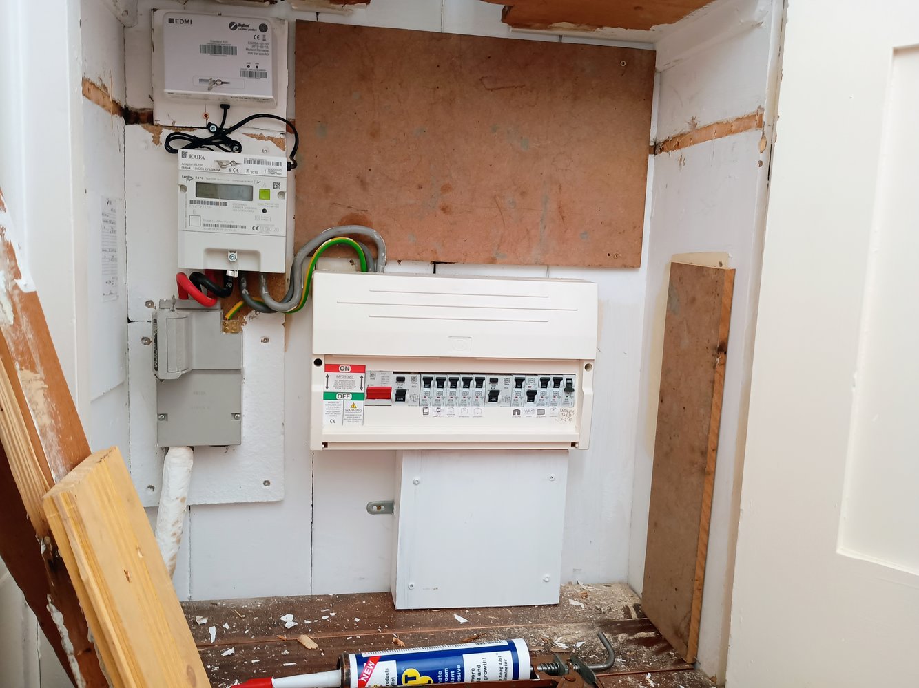

It was too tight to the wall to cut through the screws, so....if its fastened to a wooden board cut round it and refix abovethey have contact switches in the meter covers to stop tampering

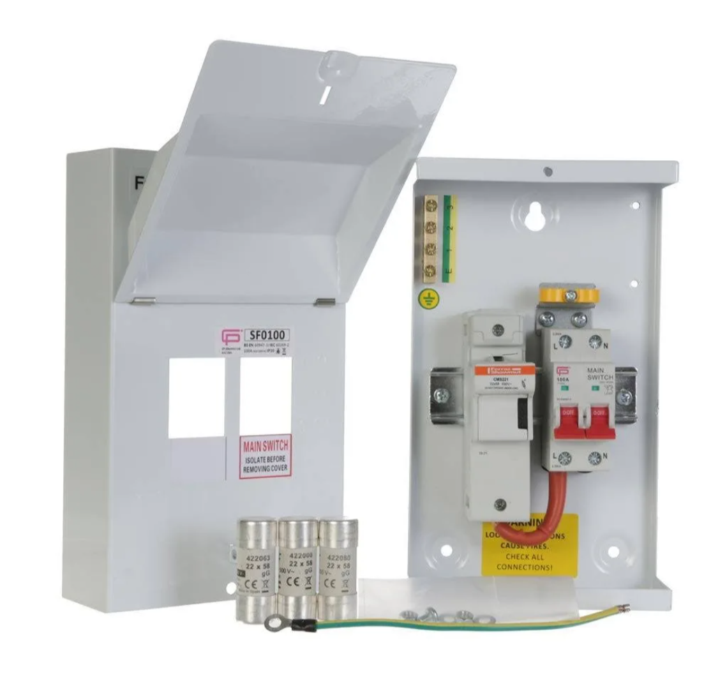

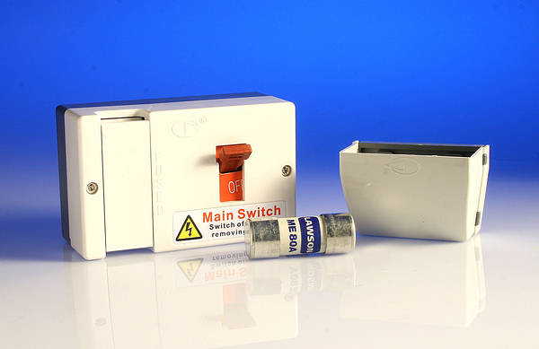

Yep I'd go with this one, they are well made and have plenty of room to sweep the cables round nicely!Actually, this one could be OK, if I put it right over to the right and get the SWA access on the right at the base.
Anyway he's not turned up yet, if he is still a no show by the end of the week I'll do it myself live.
yea it is but the meter cover has a tamper ,switch behind it and signals its been interfered withIt’s also worth removing the meter cover and double checking they're tight after you’ve manipulated the tails into the isolator, it’s surprising how little movement it takes to work them loose.
