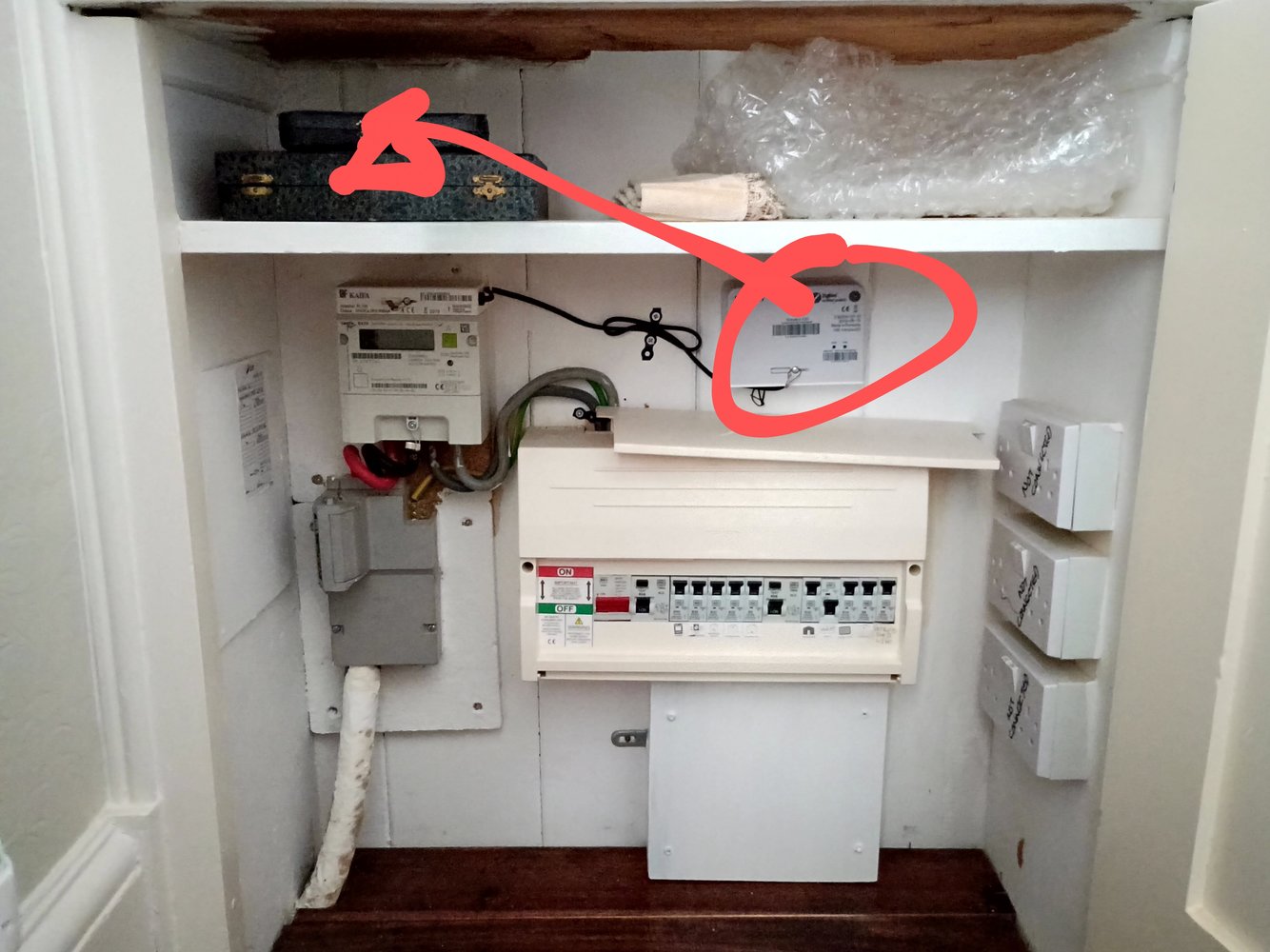

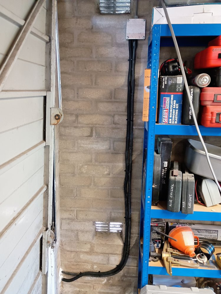

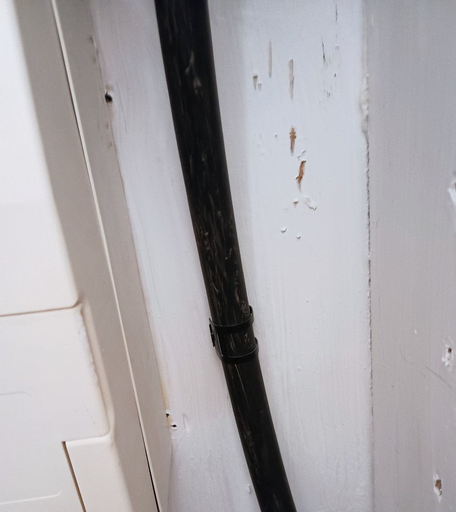

How about just shutting the cupboard door?snould have bent the swa backto wall out of the floorboard then bent up at the bottom of wall then fit a saddle in the middle of cable to support and make it neat . you can still do it if you pull some up out of the floorboards
a bit of farm work thenHow about just shutting the cupboard door?![]()
Matches my farmer welding.a bit of farm work then![]()
Matches my farmer welding.![]()

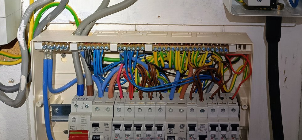

Should mixed colour scheme installations have a sticker on the outside of the CU to warn ?
I think the requirement to warn of mixed colours has been taken out of the latest version of the regsShould mixed colour scheme installations have a sticker on the outside of the CU to warn ?
Thanks.I think the requirement to warn of mixed colours has been taken out of the latest version of the regs
I think it would be better if the paint was cleaned off the old cables. Of course maybe waiting for SWMBO to do the final check.Nice job of that install by the way.
You'll be pleased to hear I thought the same thing and spent 10 minutes scraping it off.I think it would be better if the paint was cleaned off the old cables. Of course maybe waiting for SWMBO to do the final check.![]()
That's what made me delay, could be 10 or 20 years before I get an EV.The regs have literally just changed!
Mainly to do with uni or bi-directional RCBO's I think, I haven't really bothered looking into it just yet.
