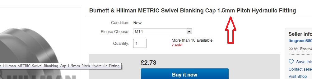

Ok thanks. I have a mk1 Golf GTi so it just got me thinking. There is probably a difference between the parts though so maybe no good for the golf.
After seeing the picture, I would use just a union nut from a believe a straight 10mm pipe connector and then a ball bearing to the seal the end.
