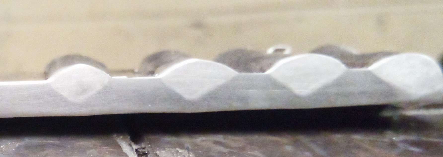

    Yes, obviously I have never done X Rays however I have done quite a few chops/etches and don't see much in the way of porosity. Having said that I did get some in the tests the last day with the Cebora, not sure what wire it was as it didn't have a name on it but the supplier said he reckoned it was SWP. Can't say for sure whether it was the wire that was the problem though as I was using a burnt shroud and possibly had too much flow for the small torch, hopefully I can do some more tests next week to see if I can find the problem.

  5. Hood
    Hood If it walks like a duck....
    Messages:
    12,613
    Location:
    Carnoustie, Scotland
    This was the one the last day, was happy enough with the profile and penetration (the wee Cebora is impressive ) but mightily pee'd off when I saw the bubbles :(
    As said I have not found the issue yet for sure but the wire is the prime suspect.

  6. TechnicAl
    TechnicAl Member
    Messages:
    8,258
    Location:
    Rotherham
    You always get porosity with Aluminium welds....its the quantity that varies

  8. Hood
    Messages:
    12,613
    Location:
    It is very rare that I see porosity in an etch, I am sure it will be there but it is not really visible to the naked eye or at least not to me. I did once get plagued with a porosity problem that was driving me daft but I eventually traced it to a tiny pin hole in the gas hose.

  10. Hood
    Messages:
    12,613
    Location:
    What are you talking though? Big bubbles as above or tiny ones that can hardly be seen?
    I have on occasion seen some close to the surface but the one above dismayed me because they were deep down.
  11. TechnicAl
    TechnicAl Member
    Messages:
    8,258
    Location:
    Rotherham
    both or either............Aluminium attracts moisture to its surface.....so unless its perfectly clean there will be porosity........and you cant really clean it to that level....except in certain circumstances

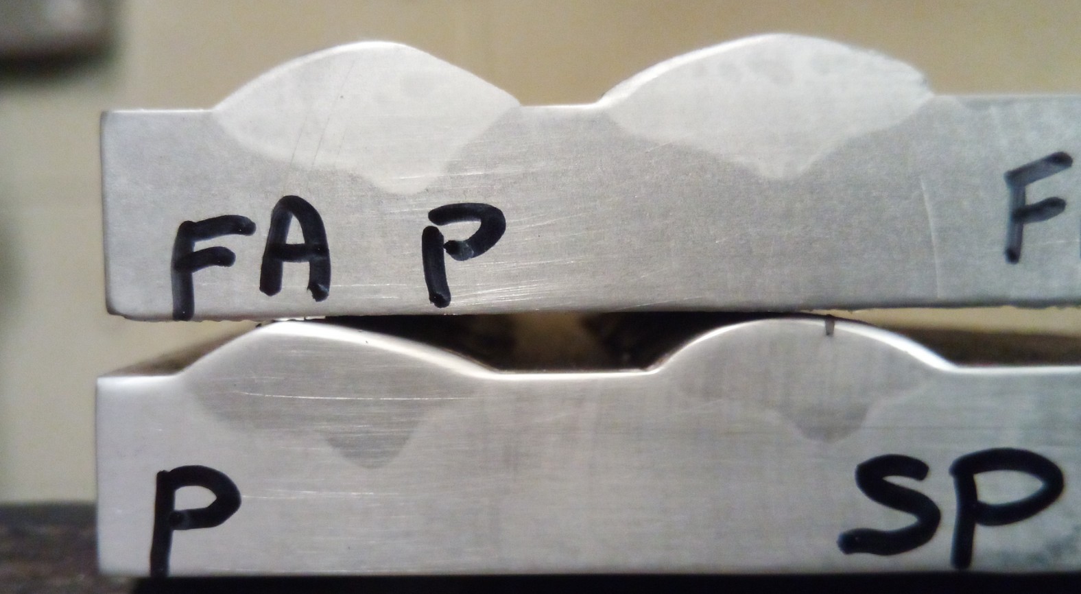

  13. Hood
    Messages:
    12,613
    Location:
    Oh I believe you as I know it to be true as well but when I see ones like I posted above I am not happy, normally the etches are nice with very tiny bubbles if at all.

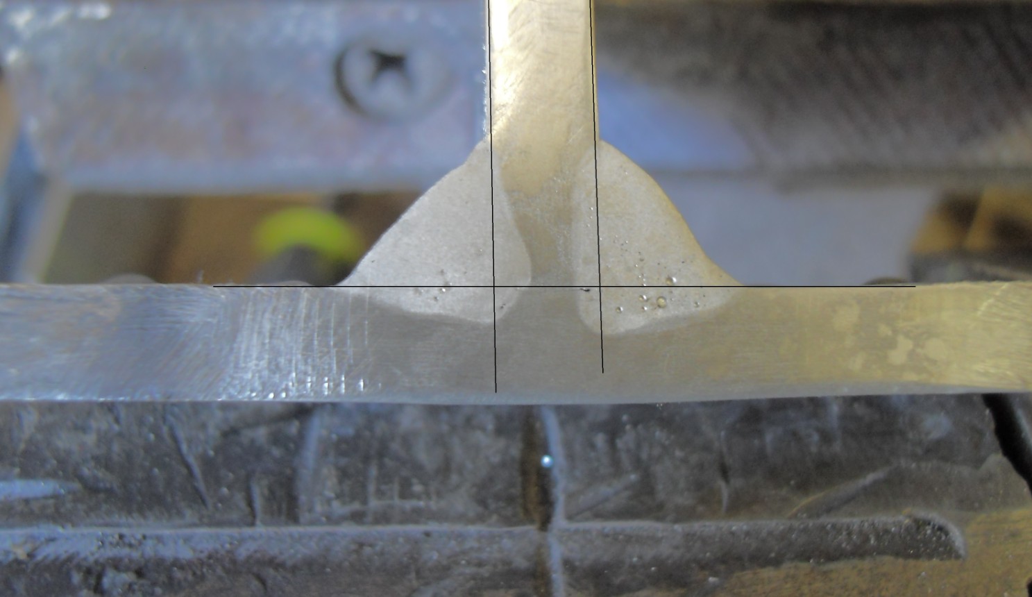

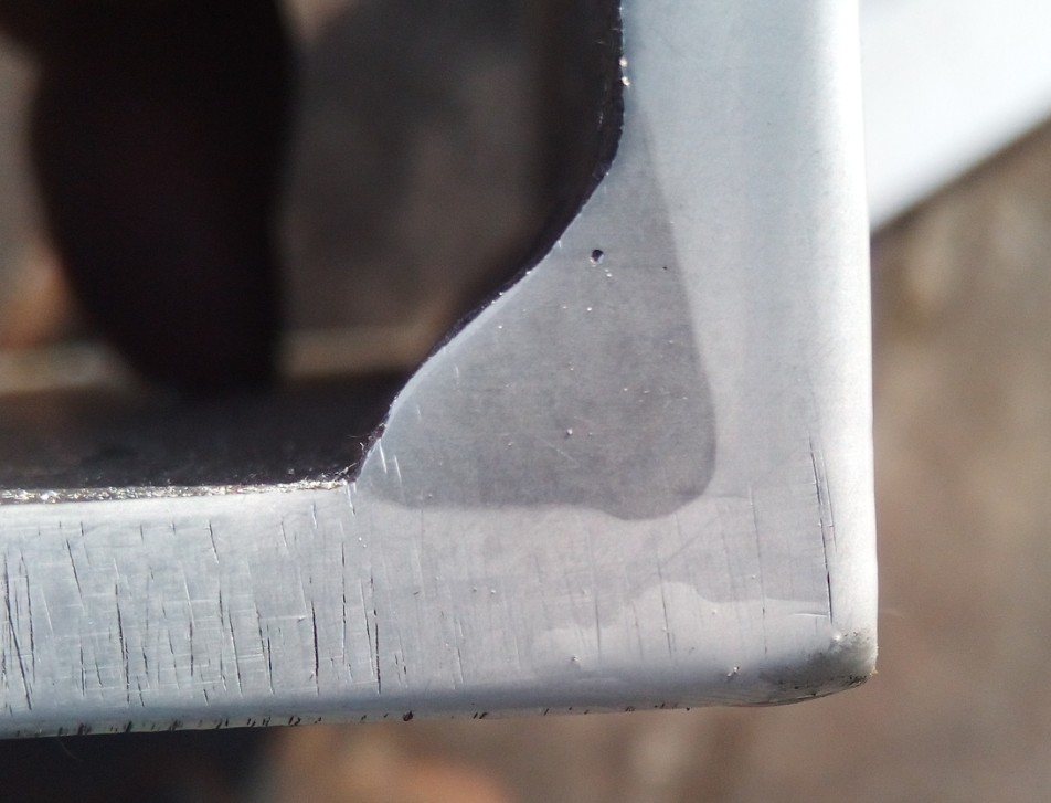

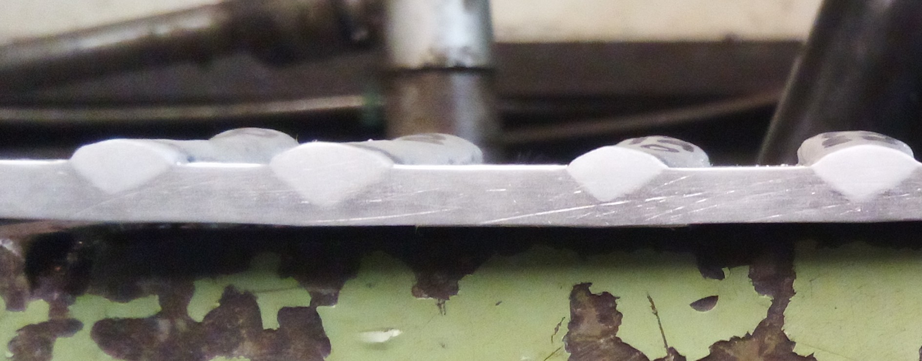

  14. Hood
    Messages:
    12,613
    Location:
    This is what I see normally.
    ScreenHunter_1621 Jun. 03 01.01.jpg ScreenHunter_1622 Jun. 03 01.01.jpg ScreenHunter_1623 Jun. 03 01.02.jpg
    On occasion I do see some bubbles such as here which was done with a spool gun with Super6 wire on the Cebora and I was having gas coverage issues as can be seen in the last pic.

  15. TechnicAl
    TechnicAl Member
    Messages:
    8,258
    Location:
    Rotherham
    well done....they look good

  20. henry Kadzielski Member
    Messages:
    922
    Location:
    Australia Wollongong
    Good morning Hood.
    I have my sample of welds put down on a flat plate of alli with Safra 5356 1.2mm, and I agree no bubbles at all in all the welds put down. However when I did my alli weld test fillet and overhead butt weld, in the fillet there was porosity. Had the results emailed back to me from the testing agent which stated it was a class 2 weld and that class one is not obtainable with mig process due to the porosity. They stated that they look at the size and location of the porosity to determine the weld quality.:thumbup: They gave me :thumbup::thumbup: no problems
